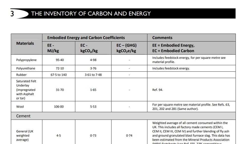

SteamyTea Posted November 11, 2020 Share Posted November 11, 2020 4 minutes ago, Jeremy said: doesn't involve fossil-fuel extraction Many PUs are, as they now say, plant based. Many Welsh sheep farmers drive inefficient vehicles. Many people will tell you to use 'lime' on old buildings. That is fine, as long as you are happy that your grandchildren are one ones to see it properly dry. I am not sure about old buildings, renovation is a tricky thing. But when they were built, one open fireplace was the norm, not central heating. In a modern building, the moisture comes from the inside and condenses at the first place that the dew point temperature is conducive. This is why vapour barriers are used. The internal air is then mechanically vented out the building and the energy is recovered. So a different solution to air bricks, which I think were to stop wooden joists rotting (and they failed anyway). You can easily work out the heat losses though a material, thickness in m/W.m-1.K-1 you will soon see that you need a lot. I would not bother with a thermal camera, just a candle will do to find the holes. Link to comment Share on other sites More sharing options...
