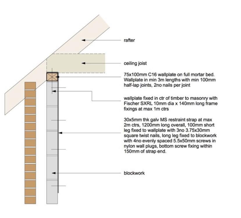

MortarThePoint Posted November 10, 2020 Author Share Posted November 10, 2020 19 minutes ago, Dave Jones said: you dont have to keep up, you can cut them all soon as the first block is laid as you have your wall lengths at that point. Should have but didn't. It's going in on Thursday and I've a busy day tomorrow. 20 minutes ago, Dave Jones said: As others have said strap them down the same day, our chippy just ran 55mm wood screws straight into the thermolite blocks to hold them. This article suggests drilling and fixing once the mortar has set: https://www.practicalarchitecture.com/blog/how-to-detail-a-wallplate Link to comment Share on other sites More sharing options...
Dave Jones Posted November 10, 2020 Share Posted November 10, 2020 the way they did it was, rest the straps on the newly mucked plates. Drill them into the walls. When roofers came the following week they had a paslode gun that shot twist nails and they shot all of them into the plates as they put the trusses on. The point being by screwing to the wall the plates cant bow in the meantime. Not that that matters anyway from the tolerances on the trusses. 1 Link to comment Share on other sites More sharing options...
PeterW Posted November 10, 2020 Share Posted November 10, 2020 From that article linked, this is exactly how I do it as it’s quick and simple. You can cut a half lap joint with a circlular saw and a chisel in about 2 minutes. And the full bed doesn’t need to be thick - just enough to take the unevenness out of the blockwork. Link to comment Share on other sites More sharing options...
MortarThePoint Posted November 10, 2020 Author Share Posted November 10, 2020 According to the article BS 8103-5 also advises that lap-joints should be 100mm long, twice nailed and that butt joints with proprietary fixings are also acceptable. Does anyone know of such a proprietary fixing? I would like to explore the option. I know lap joints should be possible but I'd like to consider something else Link to comment Share on other sites More sharing options...

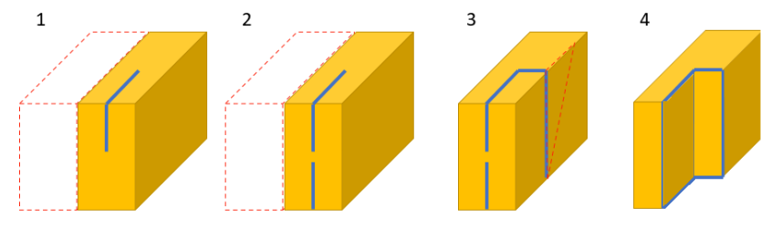

MortarThePoint Posted November 29, 2020 Author Share Posted November 29, 2020 I did the lap cuts and it ends up being pretty quick and accurate once you get a technique going. A full depth circular saw cut into each side of the timber and then a half depth cross cut on the flat of the timber. Hammer and chisel to remove the chunk and clean up. Top tip: don't bother making bits for the gables. I got carried away and made a short section for one gable by mistake ? Link to comment Share on other sites More sharing options...

MortarThePoint Posted March 6, 2021 Author Share Posted March 6, 2021 I had cause to do this again this week and I quite enjoy it now. The way I do it is below for anyone who is interested. In steps 1 and 2, I clamp another piece of 4x2 along side to provide more surface for the circular saw to ride on and stay square. In step 3, I clamp a speed square on to the timber and follow that, it's actually 30mm away from the cut as that is the gap between my saw's blade and edge of its base. Step 4 is just some easy clean up with a chisel. My circular saw's blade isn't quite deep enough to cut half way in steps 1 and 2 hence the way it is shown. Important to remember to adjust the blade between steps 2 and 3. 1 Link to comment Share on other sites More sharing options...
