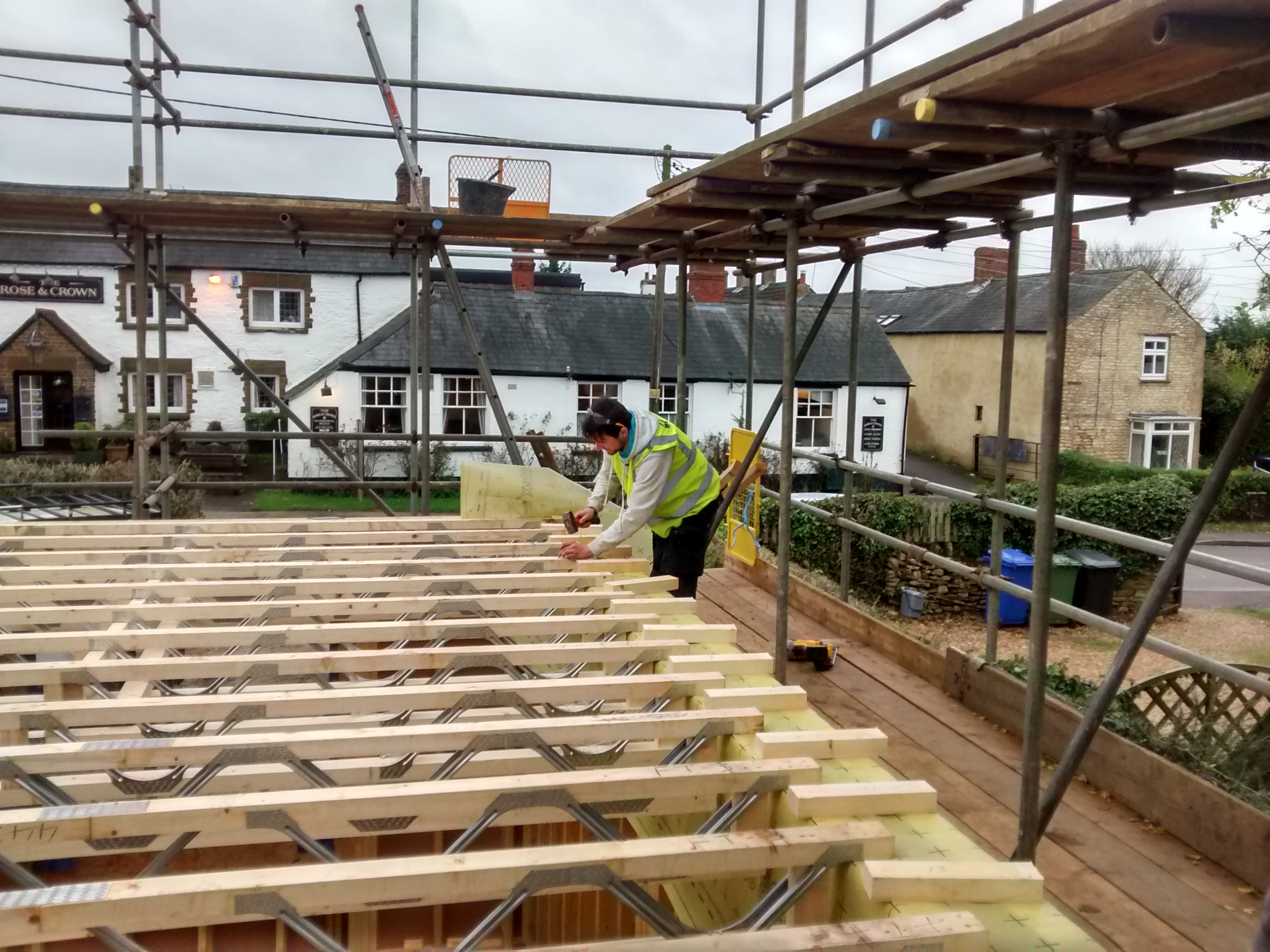

TerryE Posted January 20, 2017 Share Posted January 20, 2017 To be honest, I not the expert here. I was just relating of detailed conversations with a couple of crews who worked on my timberframe house (both of which had a lot of experience of erecting passive house class both blockwork and timberframe constructions, and these crews essentially gave the same message that Tony described in his blog here, and this was that trying to achieve airtightness in the floor void zone was a real PITA if you didn't do something to actively address this (such as the sock method that Tony used). Whether you sit your joists in the block skin or use hangers the material interface invariably causes separation of the mortar at opens many cracks through the blockwork. These are structurally insignificant, but can really impact the overall airtightness. Essentially the house will leak like a sieve. As JSH once mentioned, if either of our houses was totally airtight except a 1" diameter hole somewhere, then it would fail a 0.6 ACH airtightness test. Just out of interest, here is how they did it on our TF build: the floor was decked out to the external perimeter and the airtighness membrane looped back onto it before the next storey cassettes where craned into position. I am not saying that everyone wants or needs to achieve an 0.6 ACH figure, but more that some though about how you seal the internal floor void surface of the exterior walls will have a major impact on the actual airtightness achieved. Link to comment Share on other sites More sharing options...

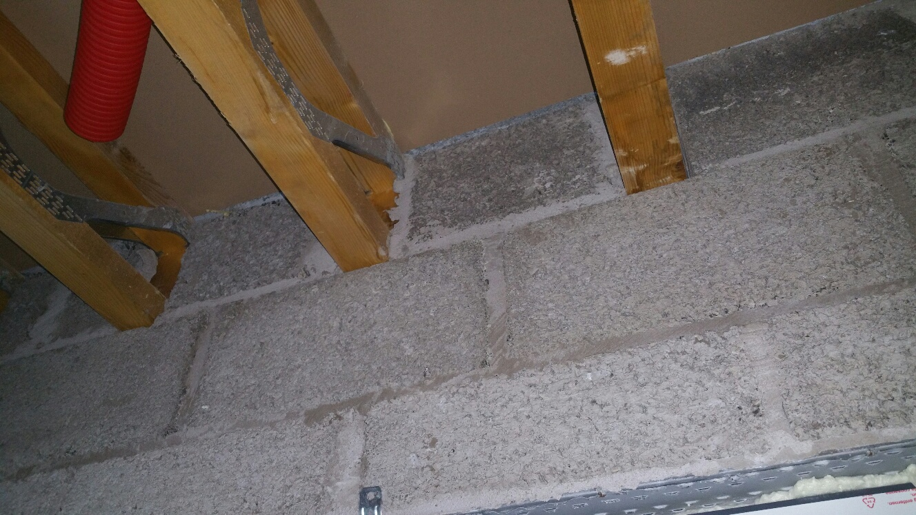

JamieM Posted January 21, 2017 Author Share Posted January 21, 2017 Cheers guys. I didn't (as I was too late/unorganised) get the chance to put in the tony trays between the joists when they were installed which is a shame as it looks like a great idea. Is there anything I can do now to rectify it (I know there's possibly no perfect way to fix it)? Floorboards are in but the plasterboard isn't on yet. Or would it make any sense to tape the floor boards at all the joins? Currently they are glued. My joists are built in to the inner wall with cement round them. We don't have attic trusses. Thanks for all your comments and thanks @Declan52 for the description of what you did. Going to look at that website and associated videos now. Link to comment Share on other sites More sharing options...
Declan52 Posted January 21, 2017 Share Posted January 21, 2017 Over time the joists flex as they shrink and expand so the cement will crack. You could put tape all the way round each gap or even cut some pir insulation and stick it to the blocks and then tape the edges. You will have to tape from you floor above to the wall and then plaster over this to seal it in. The window tape on that link can do this. It will take a fair bit of time to do it right but would be well worth it. Are you filling the joists with rockwool??? 1 Link to comment Share on other sites More sharing options...
JamieM Posted January 21, 2017 Author Share Posted January 21, 2017 Yes, there will be Rockwool in between the joists. Good point about the joists flexing. Calling down to site later today. Will have a look at the joists properly and look at the amount of tapping that would be required. Does sound like a lot of work. Link to comment Share on other sites More sharing options...
Declan52 Posted January 21, 2017 Share Posted January 21, 2017 Not hard work just time consuming. A good two days cutting and taping. You don't have to do it and just accept the heat loss, your call. Just use any insulation you have lying about. Can be sheet insulation or even cavity wall boards. 1 Link to comment Share on other sites More sharing options...
joe90 Posted January 21, 2017 Share Posted January 21, 2017 Sorry I am late to this thread but I am dealing with this issue myself on our build and we are doing it this way. We are using Finn joists and using built in hangers on block work ( the builder is already aware of air leakage through timber shrinkage if joists are inserted in a wall) I am getting the builder to parge an area equivalent (plus a bit) to the joists, so that when the house is plastered this airtight layer is continuos behind the first floor. I would like to seal the hangers where they penetrate this parged layer but not sure if air leakage would be much of a problem as steel does not shrink and warp like timber. Link to comment Share on other sites More sharing options...
Declan52 Posted January 21, 2017 Share Posted January 21, 2017 Just put some tape or sealant all around where the hanger exits the wall. 1 Link to comment Share on other sites More sharing options...
joe90 Posted January 21, 2017 Share Posted January 21, 2017 Thanks Declan, I thought sealant, can anyone recommend a good sealant that won't shrink, stay elastic etc etc. Link to comment Share on other sites More sharing options...
TerryE Posted January 21, 2017 Share Posted January 21, 2017 Yup,Tony also mentioned the alternative of using hangers plus sealant, but be aware that you can get air leaks particularly in the risers between blocks if not fully filled; that's why the render suggestion is made. Alternatively is you haven't hung the joists just hang a strip of air tightness membrane around the wall at floor void level and punch the hangers through it and seal each one. 1 Link to comment Share on other sites More sharing options...
