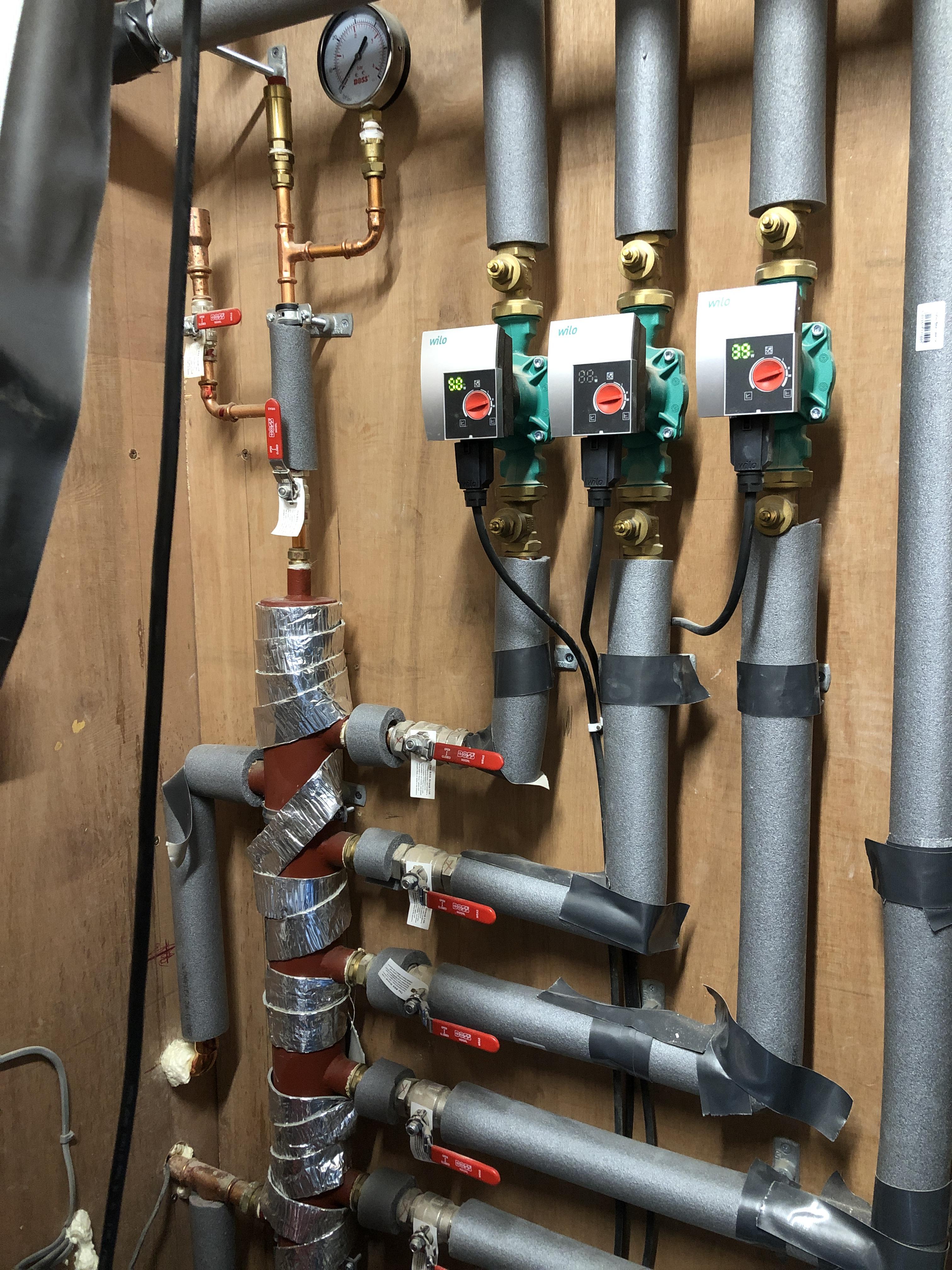

Annoyingly I can usually look after something if I know how it works but despite numerous requests no one would talk me through the heating system and anything I had to do maintenance wise.

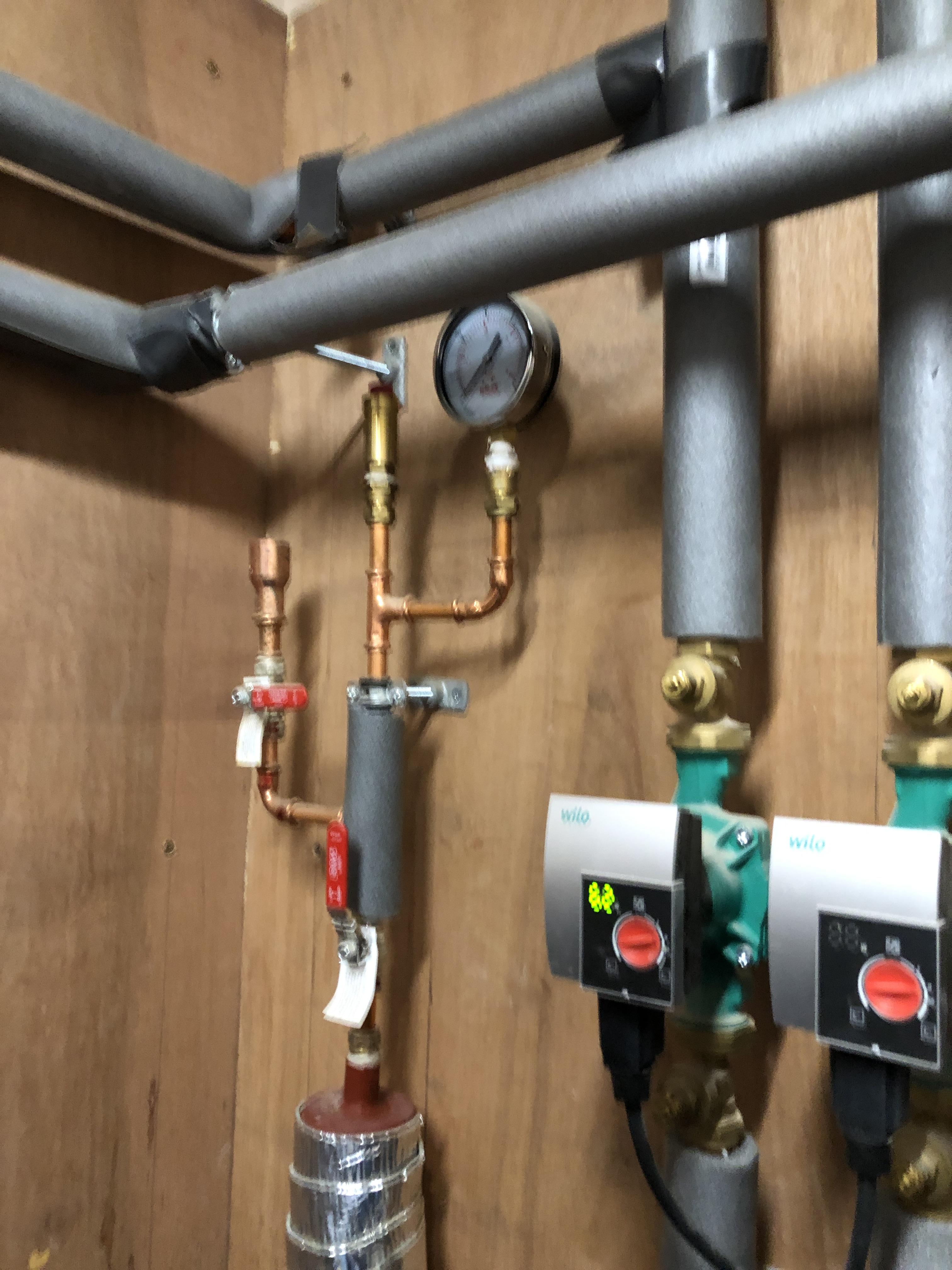

There is a low loss header in the plant room. This is the only place anywhere on the system I can see a pressure garage and it is reading basically 0. Does this suggest that the system needs to be repressurised or am I misunderstanding it?

Looks like this was the issue.
Broight pressure up to 1.3 bar. Water flowing and a lot less noise.
I specifically showed the guy who did the boiler service the UVC, heater etc if he wanted to check them all out and he didn’t seem interested at all.
Anyway now I know it needs to be repressurised and how to do it.

2. The pressure on the low loss header has to be periodically checked and topped up. The taps to top it up were fairly obvious, but only because it looked like my old system. I surely should have been told this. As I said no one told us in our last house either, we also stayed in an Airbnb where the boiler kept tripping out and I eventually figured out it was due to low pressure in the system and fixed it.
3. The things that look like temperature probes on the manifolds are exactly that and if you turn the flow temperature above 48C they will cut off the power to the pump.
I am going to label the low loss header for topping it up.
100%. All sealed systems will eventually lose this head of pressure so topping up is a part of the end users basic maintenance regime.
FYI, that pressure is not just the pressure in the low loss header. It is one huge unified body of water so that gauge value is representative of the entire system pressure.
When there is zero at ground level, you’ll have a deficit on any levels above. The risk there is, that air will be sucked in through the air vents you mention ( they operate in both direction unfortunately ) and the the UFH manifolds will start to take in air and send it around the loops.
Due to the minuscule flow rates in each UFH loop, getting that air out usually requires a purge with cold mains pressure to ‘blast’ all the air out and replace with all water.
Check for acceptable heat output throughout the floor serviced by the upper manifold to check this has not happened and that you caught it in time. Air locked loops will run cold as there will be no flow on that loop if so.

5 minutes ago, PeterW said:
Odd that the LLh is at zero. Did the plumber check the expansion vessel in the boiler ..? Or is it a separate one ..??
It is a separate expansion vessel.
I am almost certain he let the pressure out when servicing the boiler and forgot to top it up. Thinking back, the weird noises from the heating started a few weeks ago after the service. No sign of it falling since I topped it up yesterday, but I will keep an eye on it in case it is something else.
