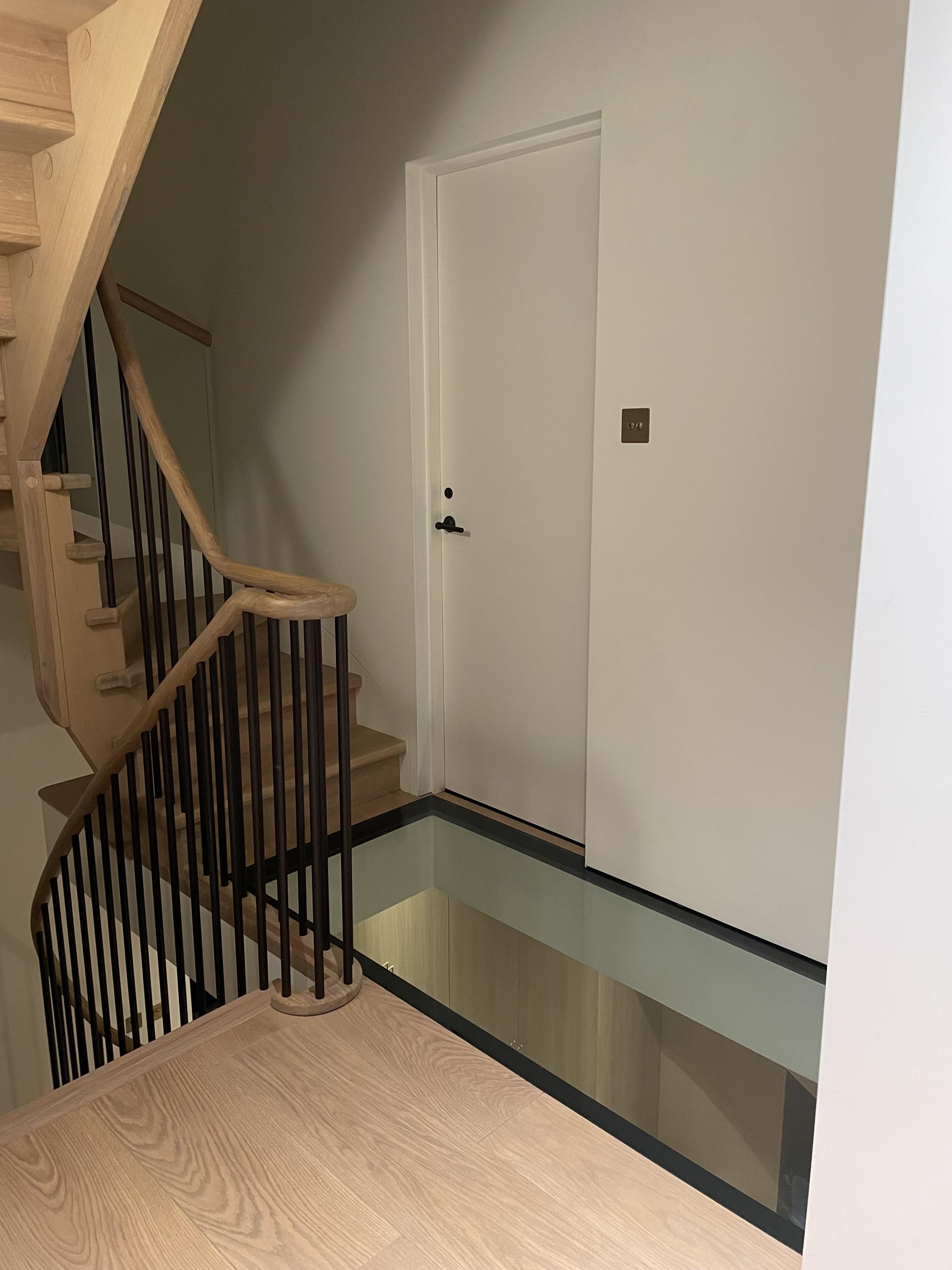

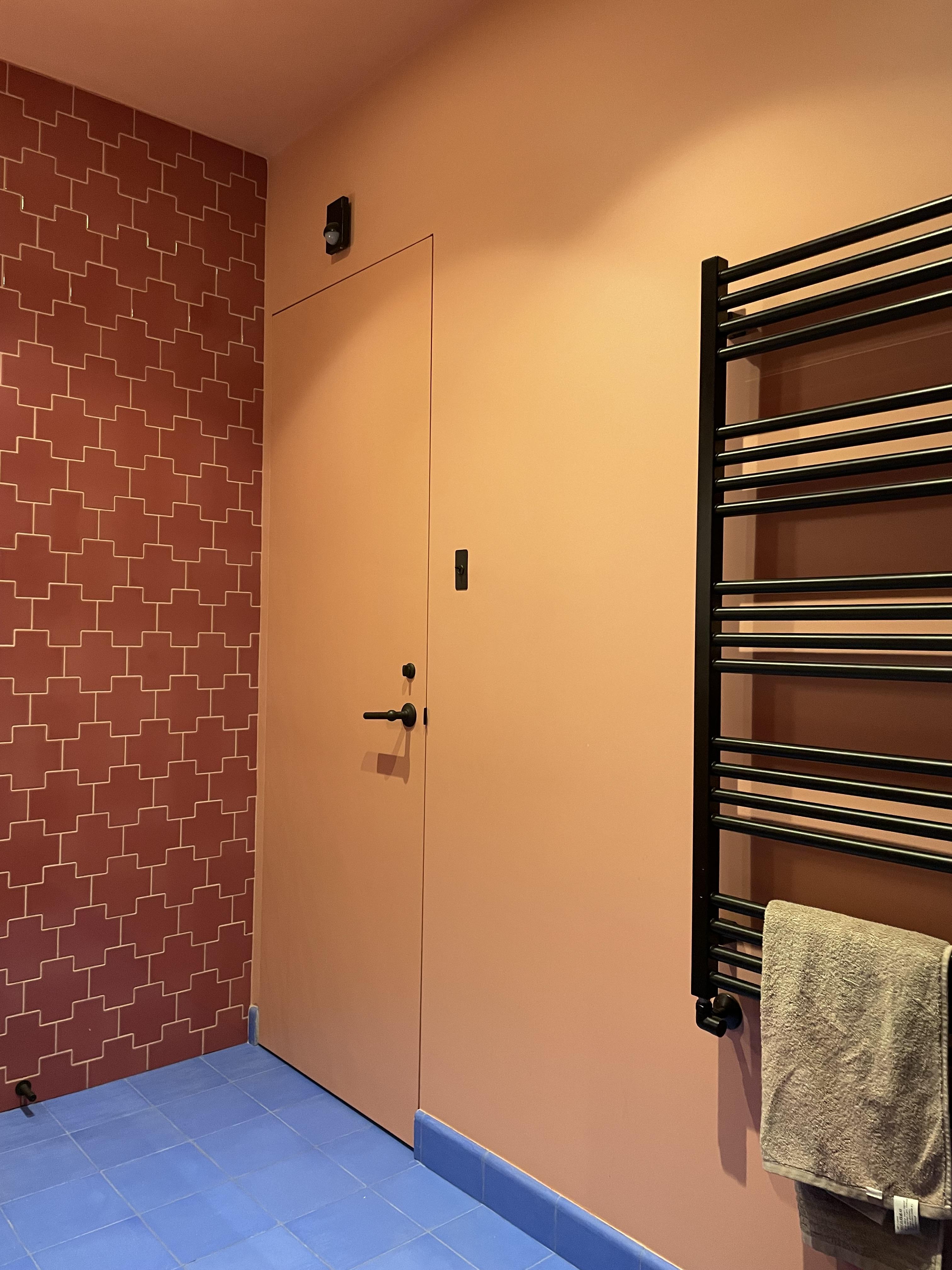

Adsibob Posted March 28, 2024 Share Posted March 28, 2024 (edited) We did this in our hallway and did half of this in our kids bathroom. Would have preferred not to have any skirting tiles, but with the kids throwing water around in here, felt like that was asking for trouble. You only notice the skirting when you look right down. I will try and post a pic of the hallway wall on the other side of this door, which has no skirting or architrave. Edited March 28, 2024 by Adsibob Link to comment Share on other sites More sharing options...
Adsibob Posted March 28, 2024 Share Posted March 28, 2024 (edited) Will look better once the tiny plinth of wooden floor between the door and the bathroom is stained black to match the framing of the walk on glazing, but this is low down on the “to-do” list… Edited March 28, 2024 by Adsibob 1 Link to comment Share on other sites More sharing options...
