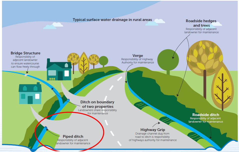

Yes we did.
When we applied for PP there was a condition requiring us to submit plans for surface water drainage. Our only option was a "piped ditch" that runs along the verge of the road. Decades ago it would have been an open ditch but was piped and covered by tarmac when the road was made up decades ago.
I proposed putting surface water into the ditch and the planners forwarded my letter to the EA. They responded saying that they "wouldn't want us to make local flooding worse". The planners simply forwarded the EA letter to me. In response I proposed a rainwater recycling tank with overflow to the ditch and the planners agreed it (possibly without asking the EA again). That despite a rainwater tank not providing attenuation when its full.
PS If it was once an open ditch I believe you may have a right to allow surface water to run off into it if the land slopes that way? I didn't investigate that aspect though.
Google found..
https://www.herefordshire.gov.uk/downloads/file/16062/guidance_on_landowner_responsibilities.pdf
Quote
Roadside Ditches and Watercourses There are three categories of roadside ditch:
• A ditch in the field side of a fence or hedge taking land drainage as well as highway drainage which is the responsibility of the Riparian Owner(s).
• A ditch on the road side of a fence or hedge taking land drainage as well as highway drainage, which is also the responsibility of the Riparian Owner(s).
• A ditch created by the Highway Authority for the sole purpose of draining the highway. The Highway Authority is responsible for the ditch.
Most open ditch drainage systems are the responsibility of the Riparian Owner(s) but the Highway Authority has prescriptive powers to drain the highway in to them. Riparian Owner(s) are those who own the land adjoining the highway. The duty to keep all roadside ditches clear, with the exception of those created by the Highway Authority for the sole purpose of draining water from the Highway, falls to Riparian Owner(s). This duty extends to the entire width of the ditch. The Highway Authority has powers to cleanse and restore the profile of these ditches, however the exercise of these powers does not relieve Riparian Owners of their duties, who may still be charged.
snip
Who is a Riparian Owner? The owner of land or property that adjoins a watercourse, such as a roadside ditch, is known as the Riparian Owner. Although the Highways Authority is responsible for the highway, we do not own the ‘sub-soil’ of the highway. The owner of the land or property adjoining the highway is normally the sole Riparian Owner.
I don't know what happens to riparian rights when a ditch of the second type is piped and covered over.
