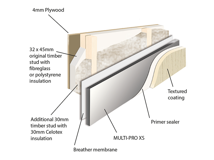

Temp Posted October 24, 2020 Posted October 24, 2020 https://www.prestigedevelopments.com/cavity-wall/ Celotex - breather - Millipore XS....but then render not timber cladding.
ADLIan Posted October 25, 2020 Posted October 25, 2020 Prestige Devs deal with park homes. Requirements here very different to ‘normal’ houses having to comply with Building Regs so the linked diag may not be relevant.
