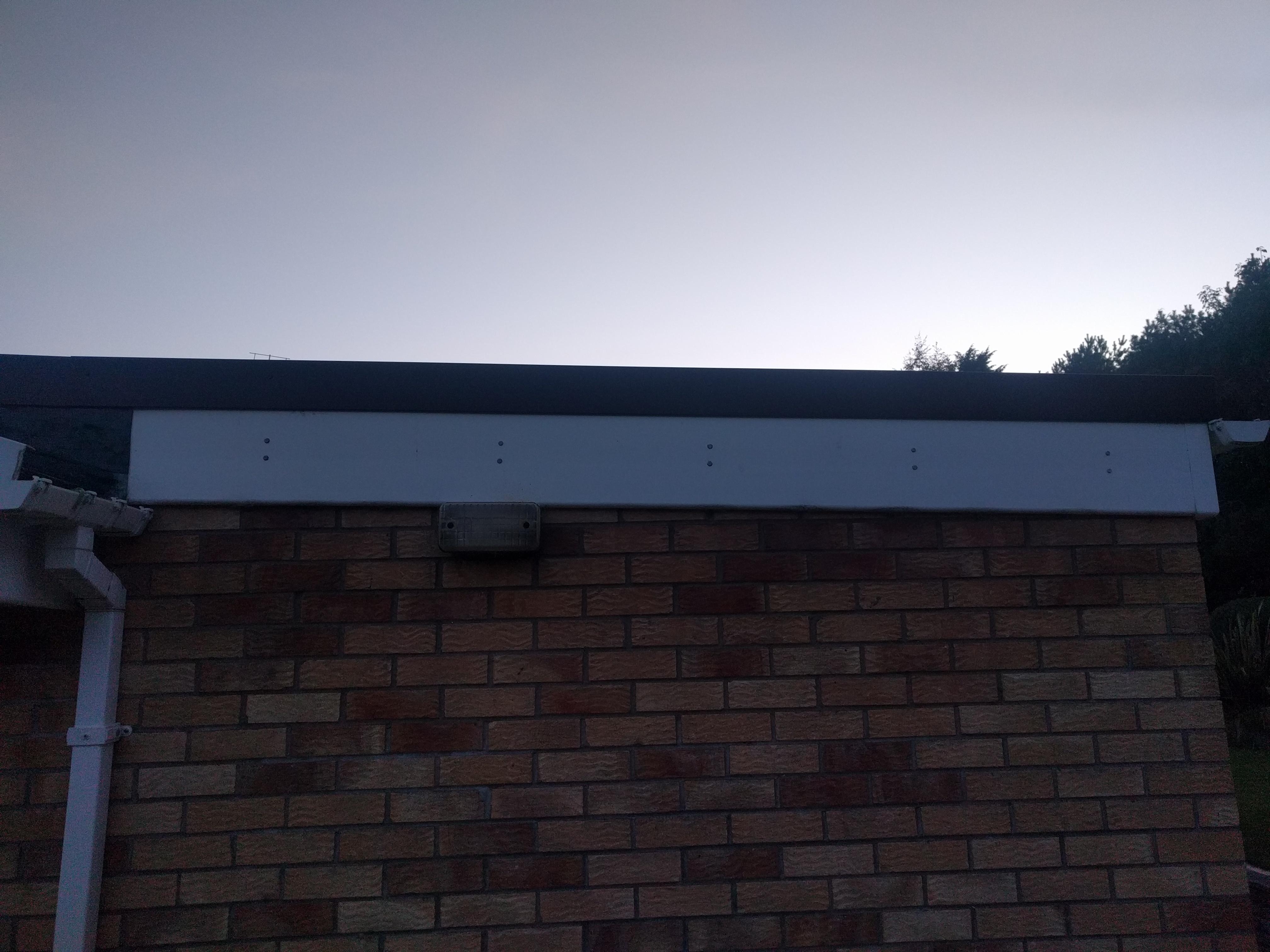

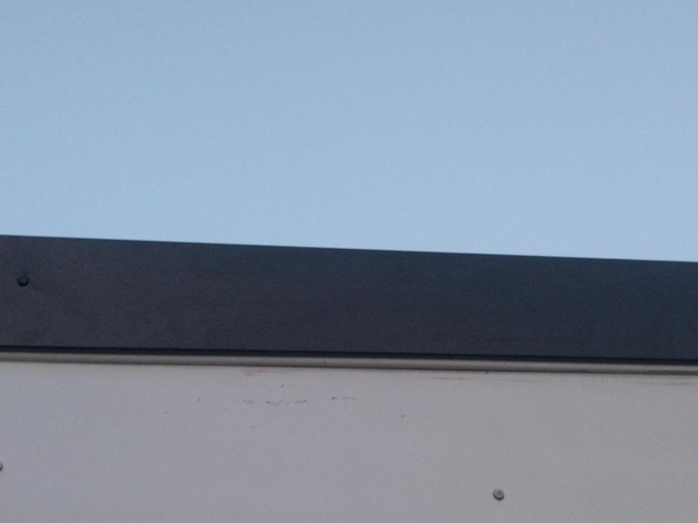

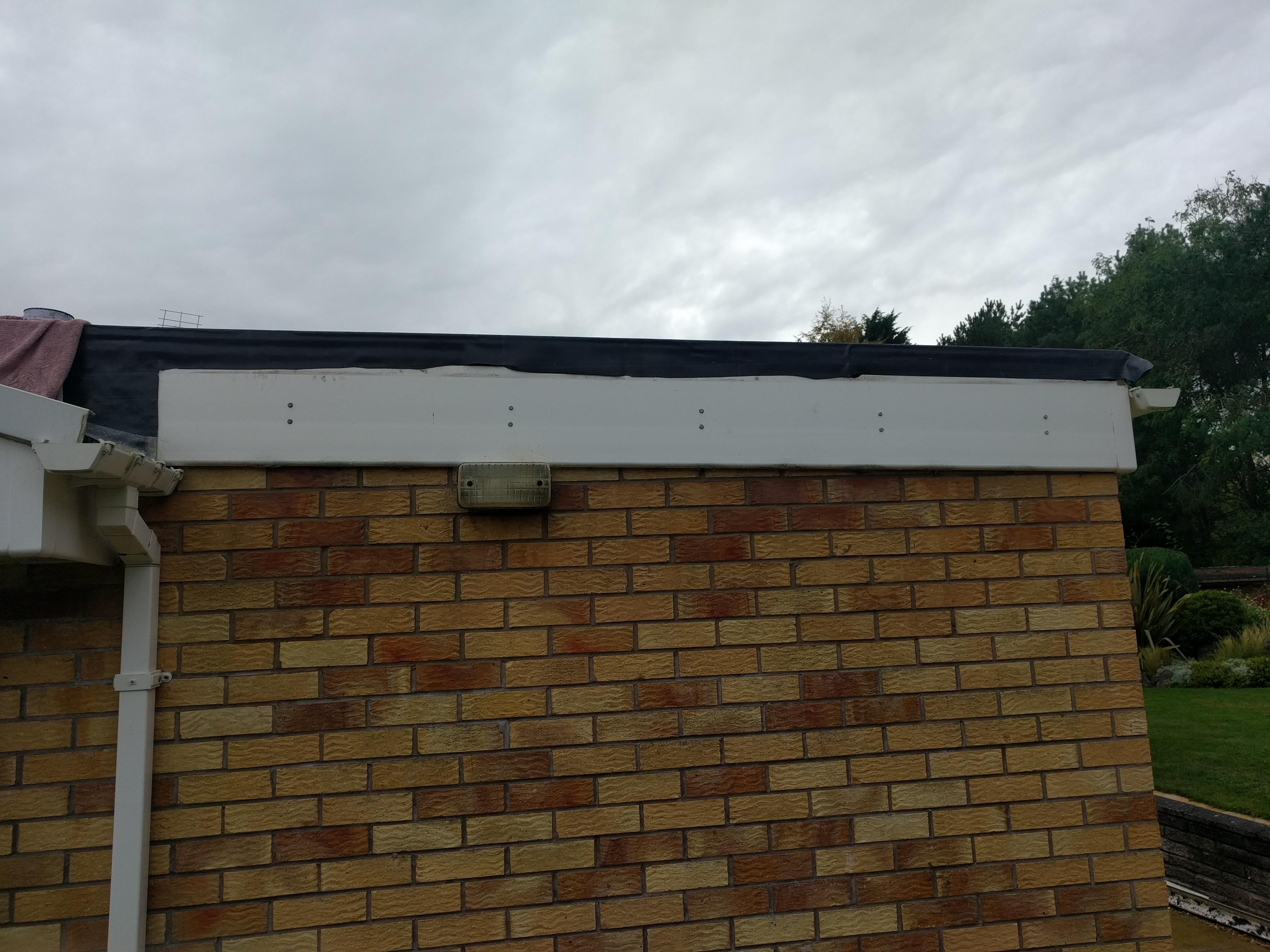

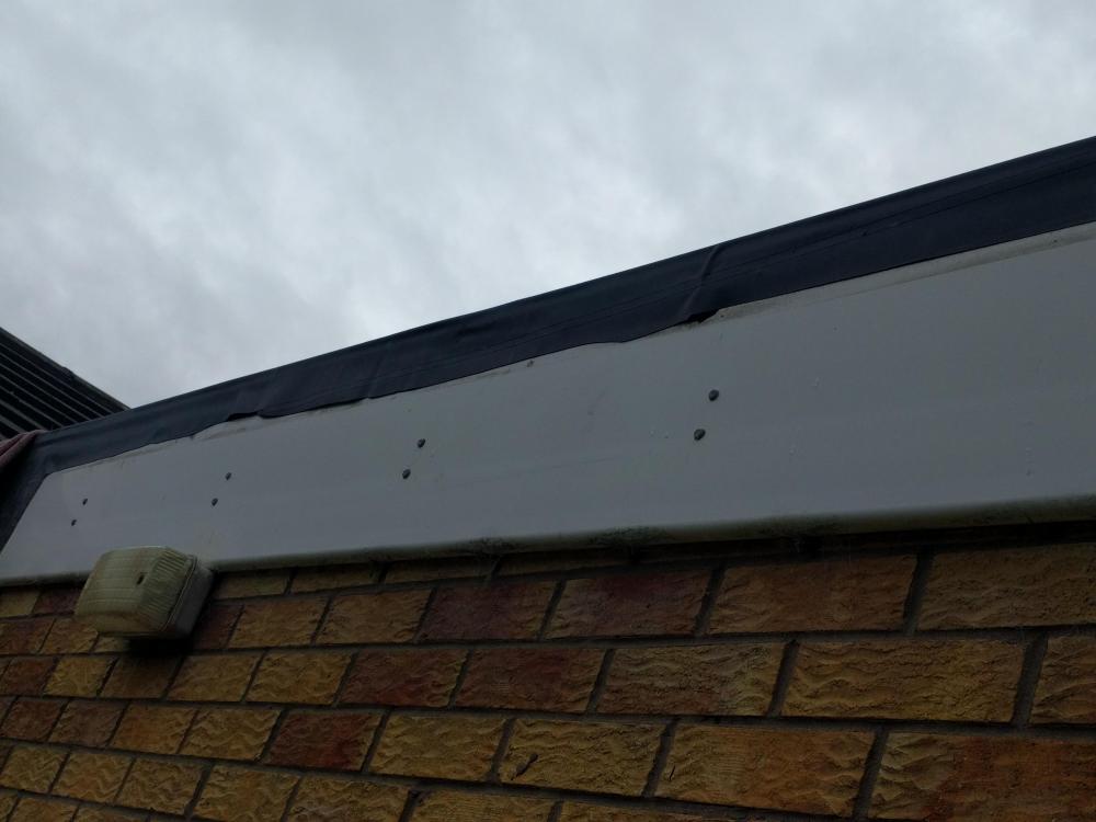

BobAJob Posted October 23, 2020 Share Posted October 23, 2020 Having our botched rubber roof fixed and noticed the new guy has done this at the edges. Seems to have cut the rubber at random length because he cut it while he was up on the roof instead of standing on the floor. I think he's planning to fit a facia board on top of it. Is it a problem? Thanks Link to comment Share on other sites More sharing options...
nod Posted October 23, 2020 Share Posted October 23, 2020 Doesn’t inspire confidence Link to comment Share on other sites More sharing options...
BobAJob Posted October 23, 2020 Author Share Posted October 23, 2020 38 minutes ago, nod said: Doesn’t inspire confidence My thoughts exactly. Why are there so may incompetents around? It's really not that difficult to spend a few more minutes getting it right. Link to comment Share on other sites More sharing options...
nod Posted October 23, 2020 Share Posted October 23, 2020 You can usually tell the quality of a trade by the finishing Your right to be concerned Link to comment Share on other sites More sharing options...

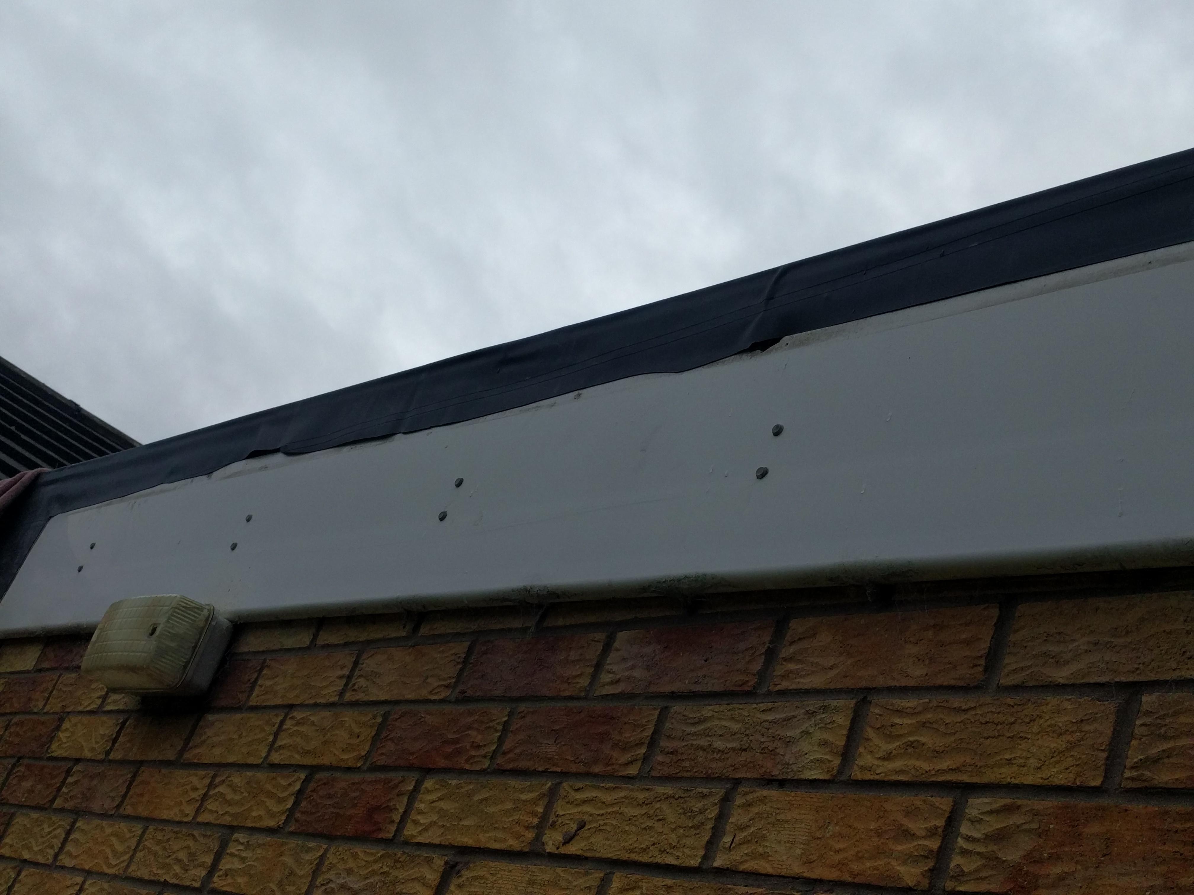

BobAJob Posted October 23, 2020 Author Share Posted October 23, 2020 14 minutes ago, nod said: You can usually tell the quality of a trade by the finishing Your right to be concerned He's whacked a fascia board over it, so you can't see it anymore. Unfortunately, I don't see a way of fixing it after you've cut it too short. Perhaps stick another bit of rubber underneath it, so it all ends up on the white board underneath. He told me it was glued underneath the board but I don't believe him. Time will tell. Link to comment Share on other sites More sharing options...
Vijay Posted October 23, 2020 Share Posted October 23, 2020 so rainwater will drip down behind the second fascia board???? Link to comment Share on other sites More sharing options...
Mr Punter Posted October 23, 2020 Share Posted October 23, 2020 They do all sorts of edge trims and drip profiles to finish this off at verges and eaves. You don't need loads of rubber overhang. I hope he is not claiming that it is finished. 1 Link to comment Share on other sites More sharing options...
BobAJob Posted October 23, 2020 Author Share Posted October 23, 2020 1 hour ago, nod said: You can usually tell the quality of a trade by the finishing Your right to be concerned He's whacked a fascia board over it, so you can't see it anymore. Unfortunately, I don't see a way of fixing it after you've cut it too short. Perhaps stick another bit of rubber underneath it, so it all ends up on the white board underneath. He told me it was glued underneath the board but I don't believe him. Time will tell. Link to comment Share on other sites More sharing options...
BobAJob Posted October 23, 2020 Author Share Posted October 23, 2020 (edited) 29 minutes ago, Mr Punter said: They do all sorts of edge trims and drip profiles to finish this off at verges and eaves. You don't need loads of rubber overhang. I hope he is not claiming that it is finished. He now says he has finished. You can see the fascia boards he was put on top of the rubber overhang and the white upvc boards. Edited October 23, 2020 by BobAJob 1 Link to comment Share on other sites More sharing options...

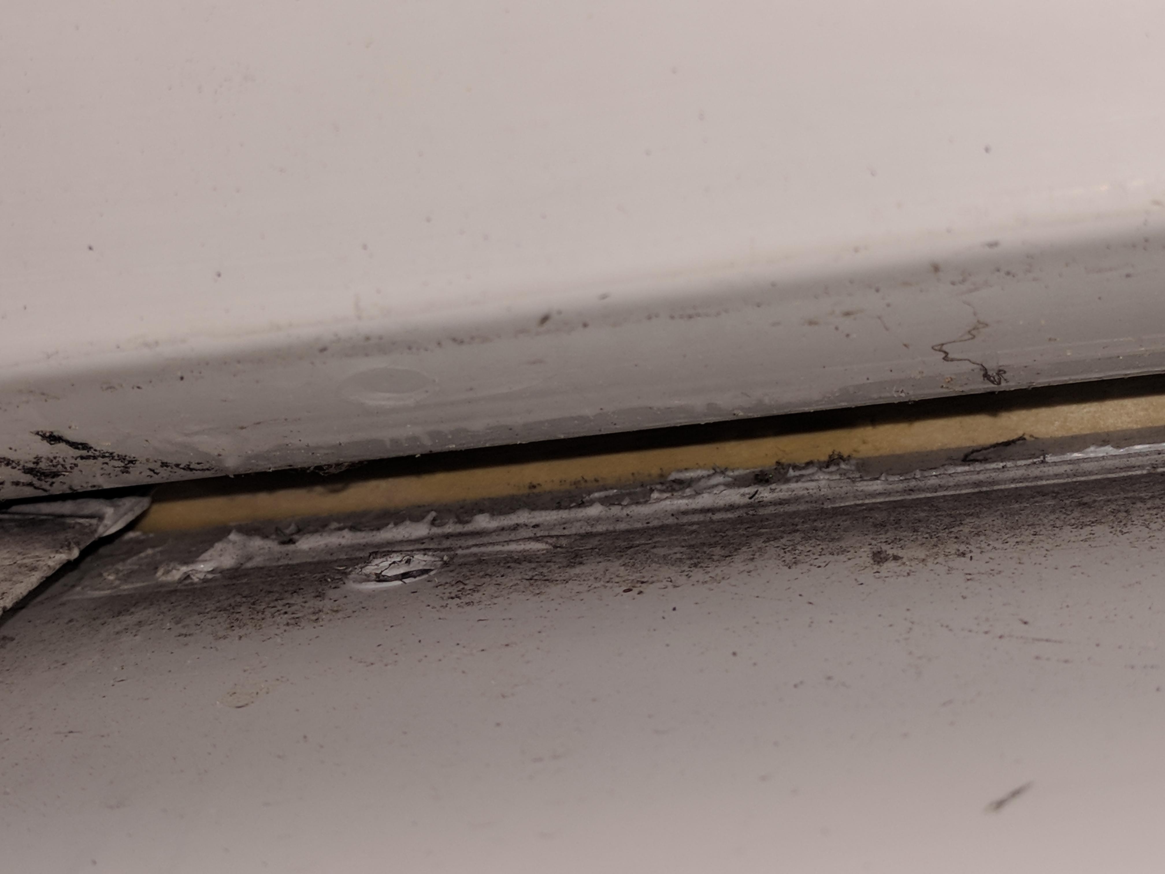

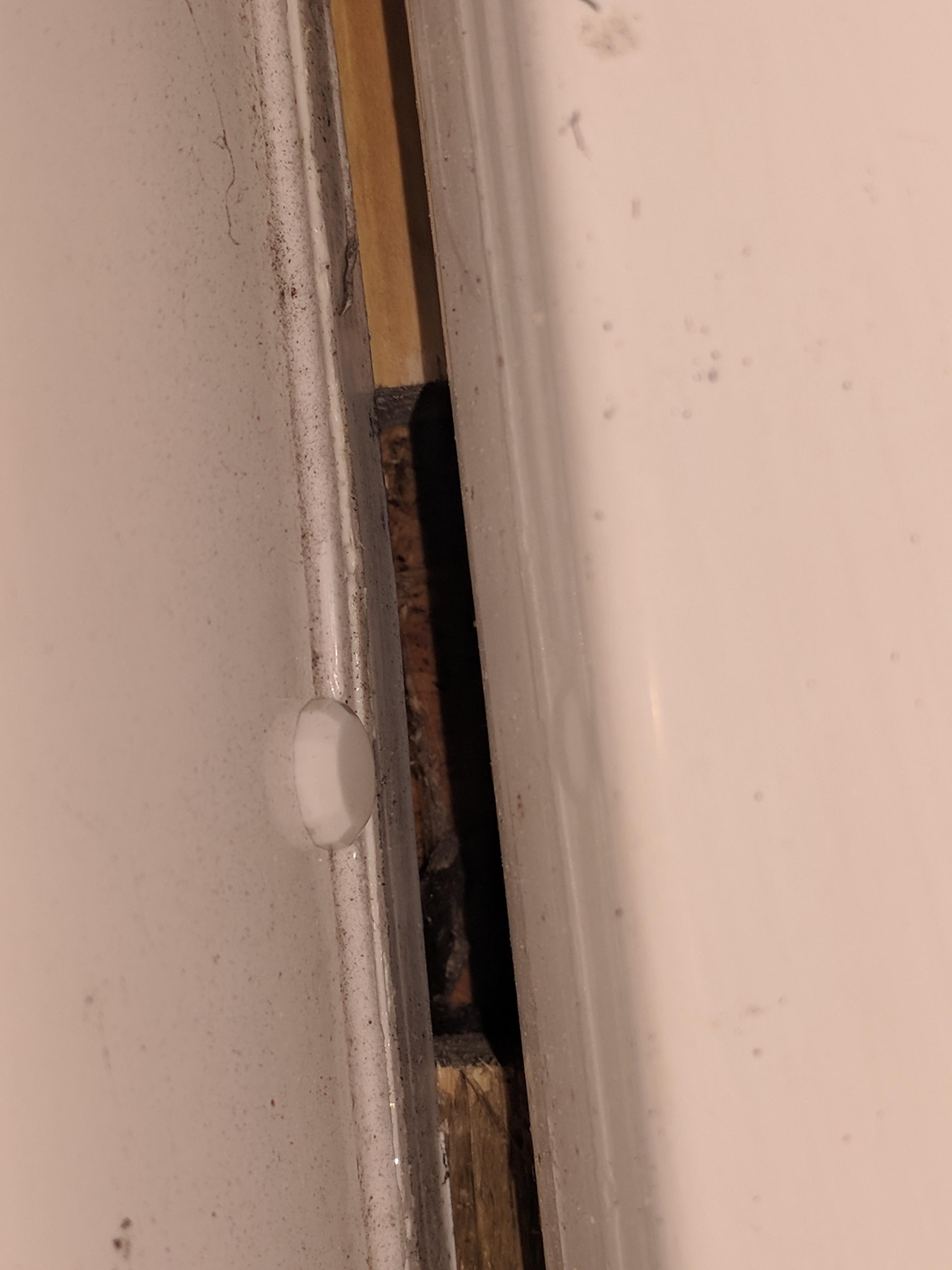

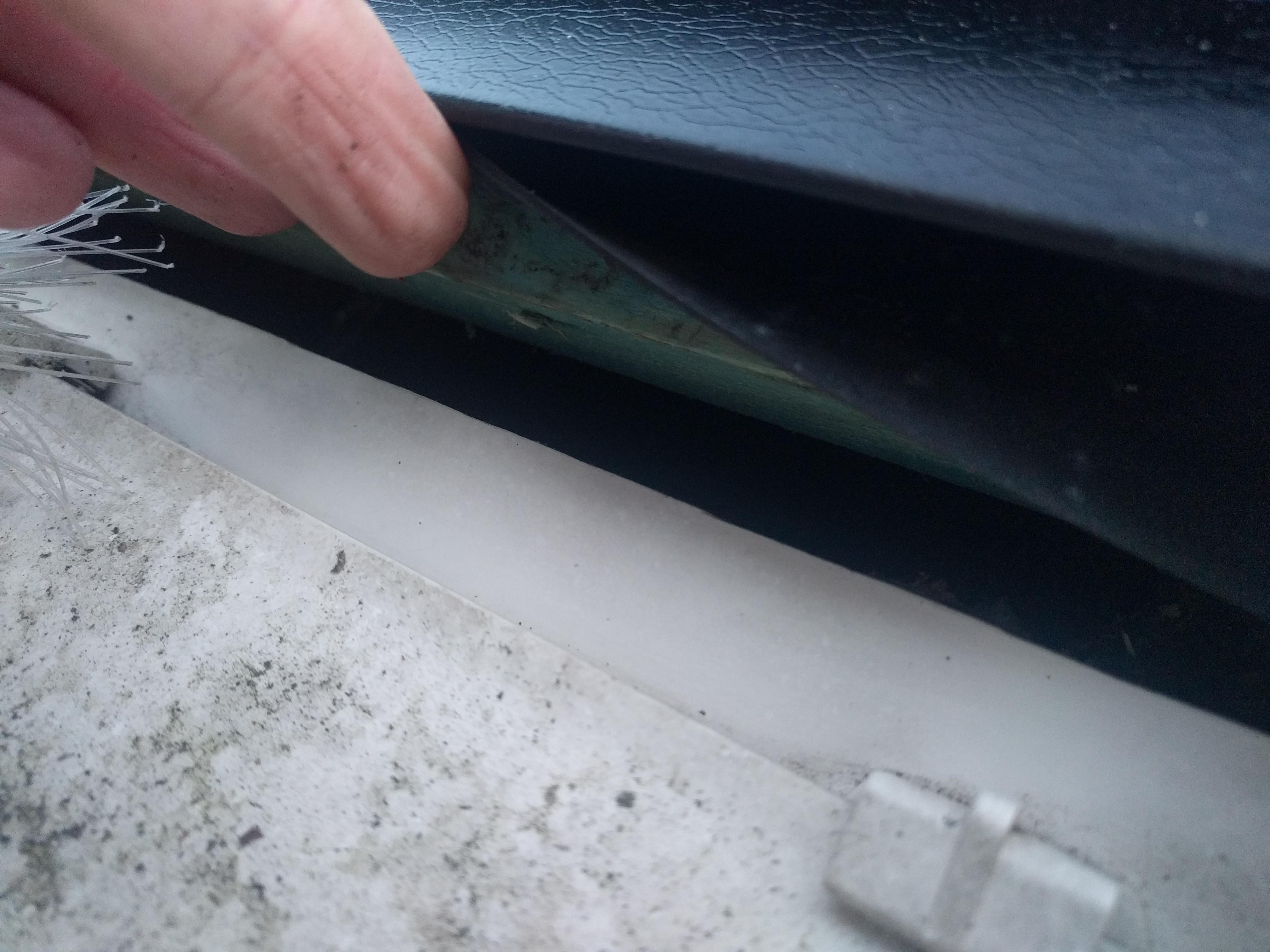

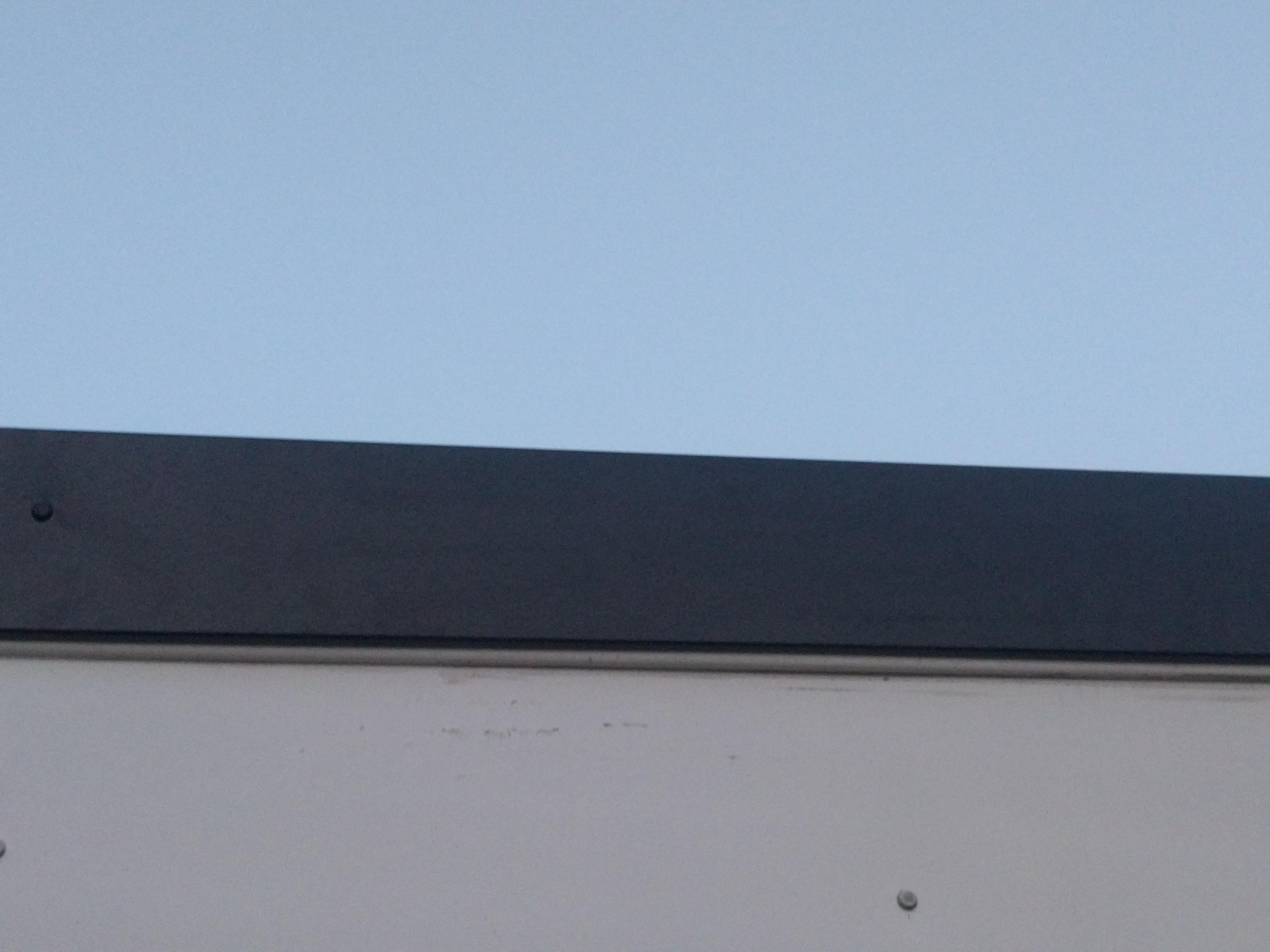

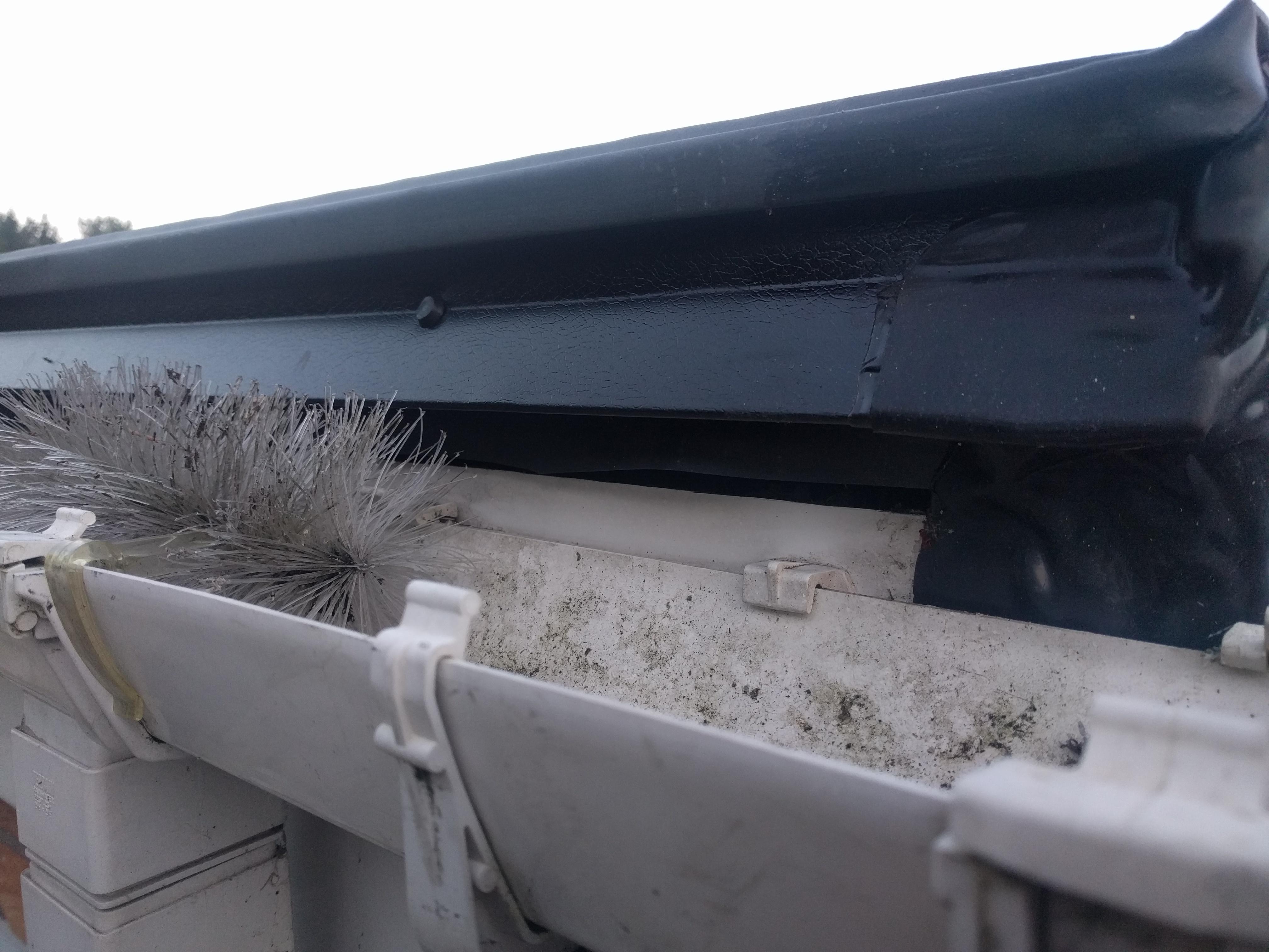

BobAJob Posted October 23, 2020 Author Share Posted October 23, 2020 I have noticed a potential problem though. Where the flat roofs have the guttering attached he has fitted a strip to feed the rain water into the gutter but behind that the roof structure isn't weather sealed. There's an overhang of rubber of slightly varying length. If you lift the rubber you can see the wood attached to the side of the roof, so moisture and snow can get into it. It looks like some kind of edging should be nailed to the wood to properly seal it. There used to be an edging strip there on the old roof and you can still see the silicone sealant on the upvc behind the guttering brackets. Link to comment Share on other sites More sharing options...
BobAJob Posted October 24, 2020 Author Share Posted October 24, 2020 So how should the guttering edge of a rubber roof be finished? Should the rubber be left loose or should it be nailed or glued to a board? Thanks Link to comment Share on other sites More sharing options...

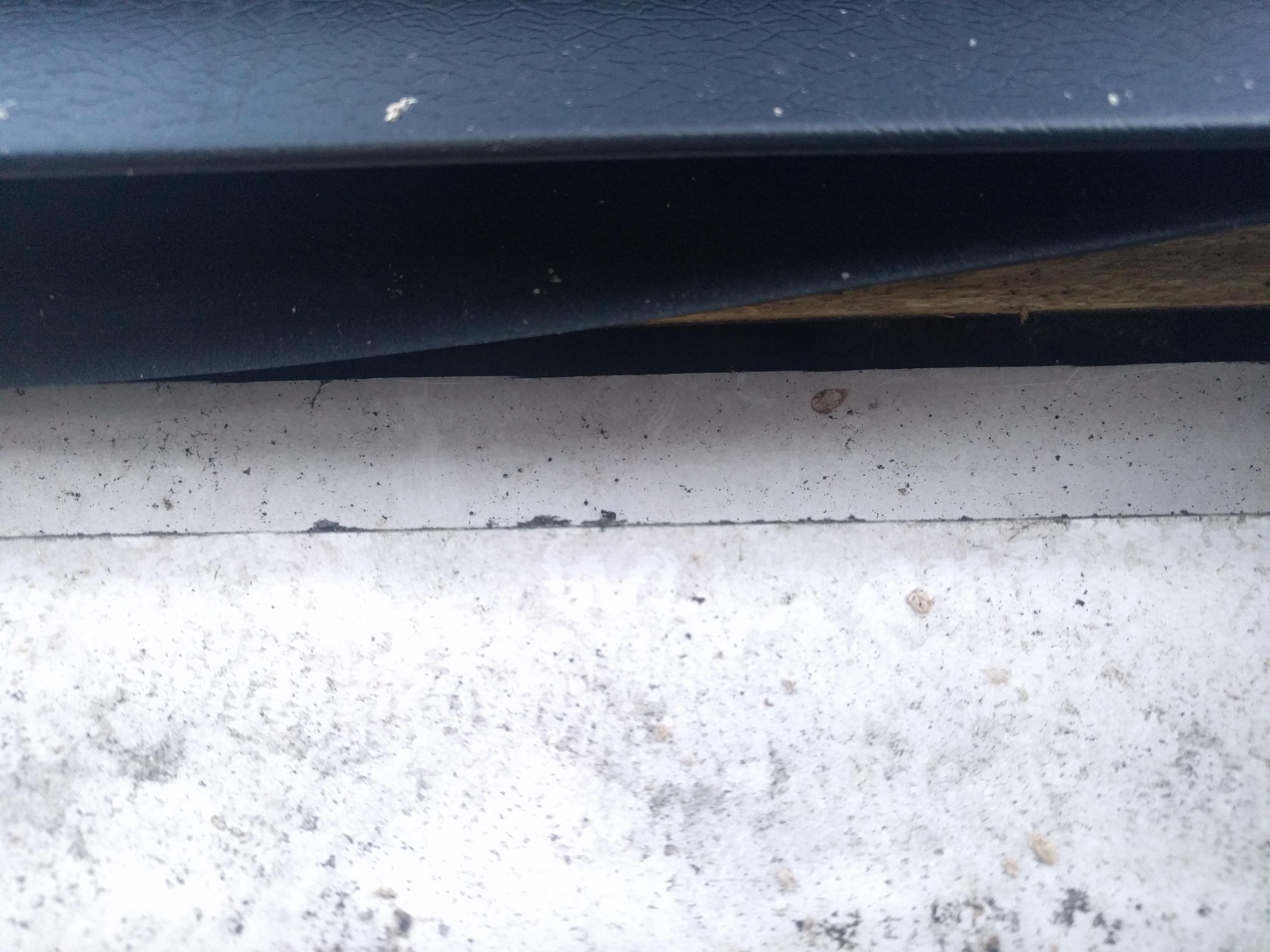

BobAJob Posted October 25, 2020 Author Share Posted October 25, 2020 On 24/10/2020 at 09:21, BobAJob said: So how should the guttering edge of a rubber roof be finished? Should the rubber be left loose or should it be nailed or glued to a board? Thanks And how are you supposed to integrate a flat rubber roof with a pitched roof allowing any water that gets on to the felt under the tiles to drain off onto the rubber roof? My roof has put a lay board under the rubber but it is about 2 cms higher that the felt layer and he has fitted a batten in the dip between the felt and rubber sections, so I can't see how it's possible for water to get under the batten and onto the rubber. The roofer has put an unattached batten board under the pitched roof tiles to stop them touching the rubber. He says this is a sacrificial piece of wood but to my mind it stops any water on the felt and rubber under the tiles getting out and onto the rubber roof. Please can someone show me some good examples of how the junction between a rubber roof and a pitched roof is supposed to look? Thanks Link to comment Share on other sites More sharing options...
PeterW Posted October 25, 2020 Share Posted October 25, 2020 You shouldn’t really get water running down felt, the way it should work is as he has done it with a board running up under the first row of tiles then some run the rubber up that and bond it and push the excess further still. Underfelt is draped over the top. You will then have a kicker batten to stop the tiles rubbing the rubber membrane. Water running down the under felt would indicate a leak further up the roof in the tiles. Link to comment Share on other sites More sharing options...

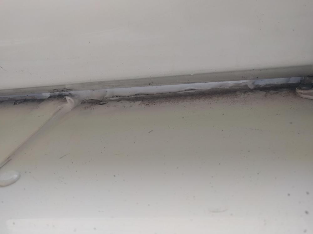

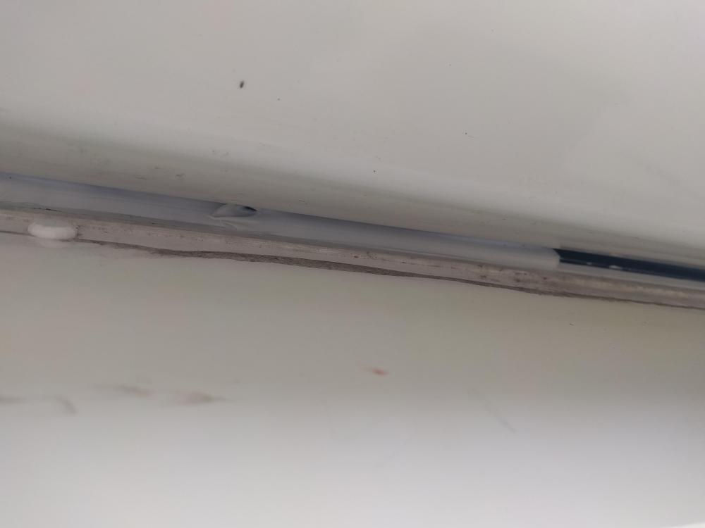

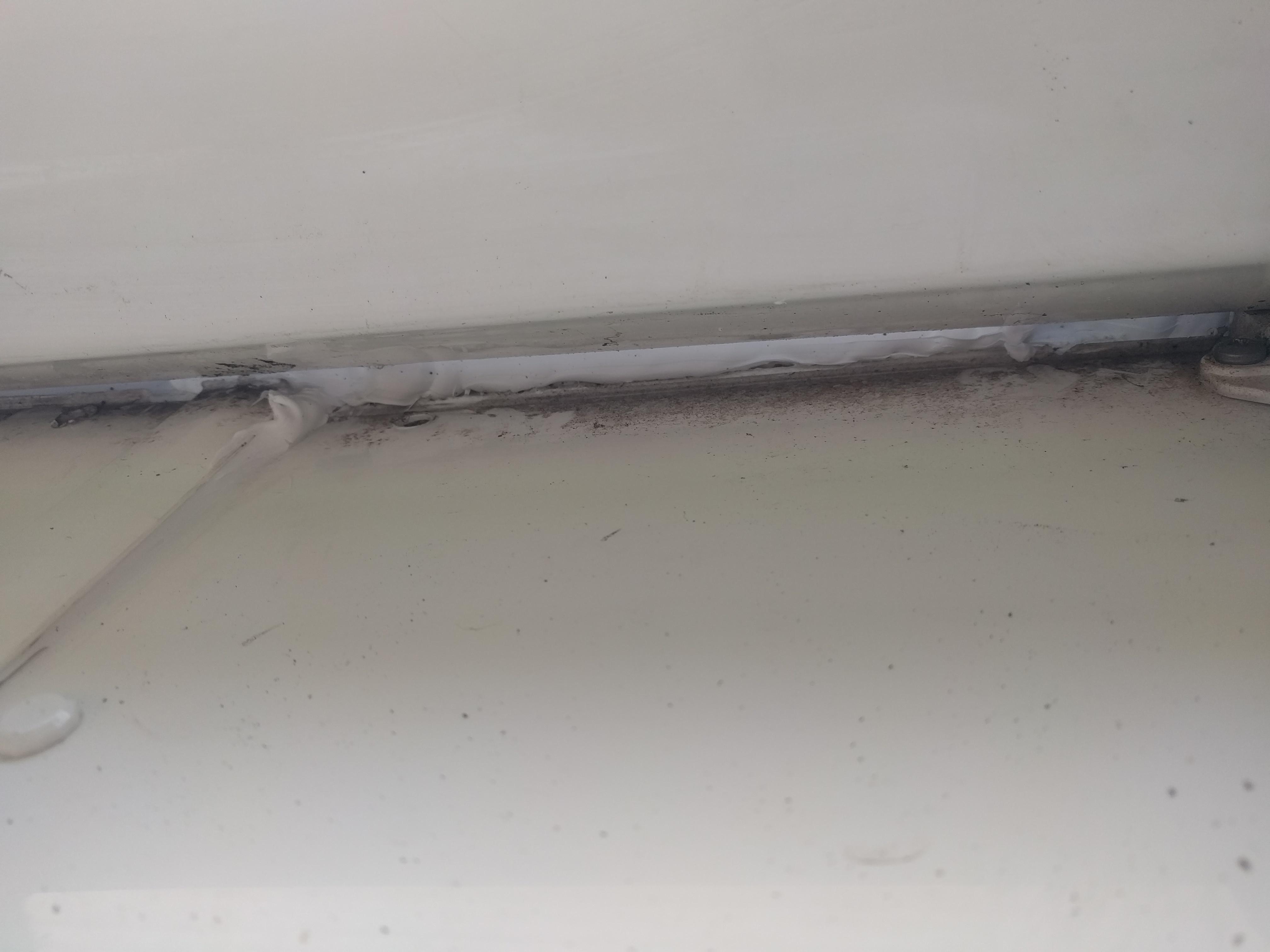

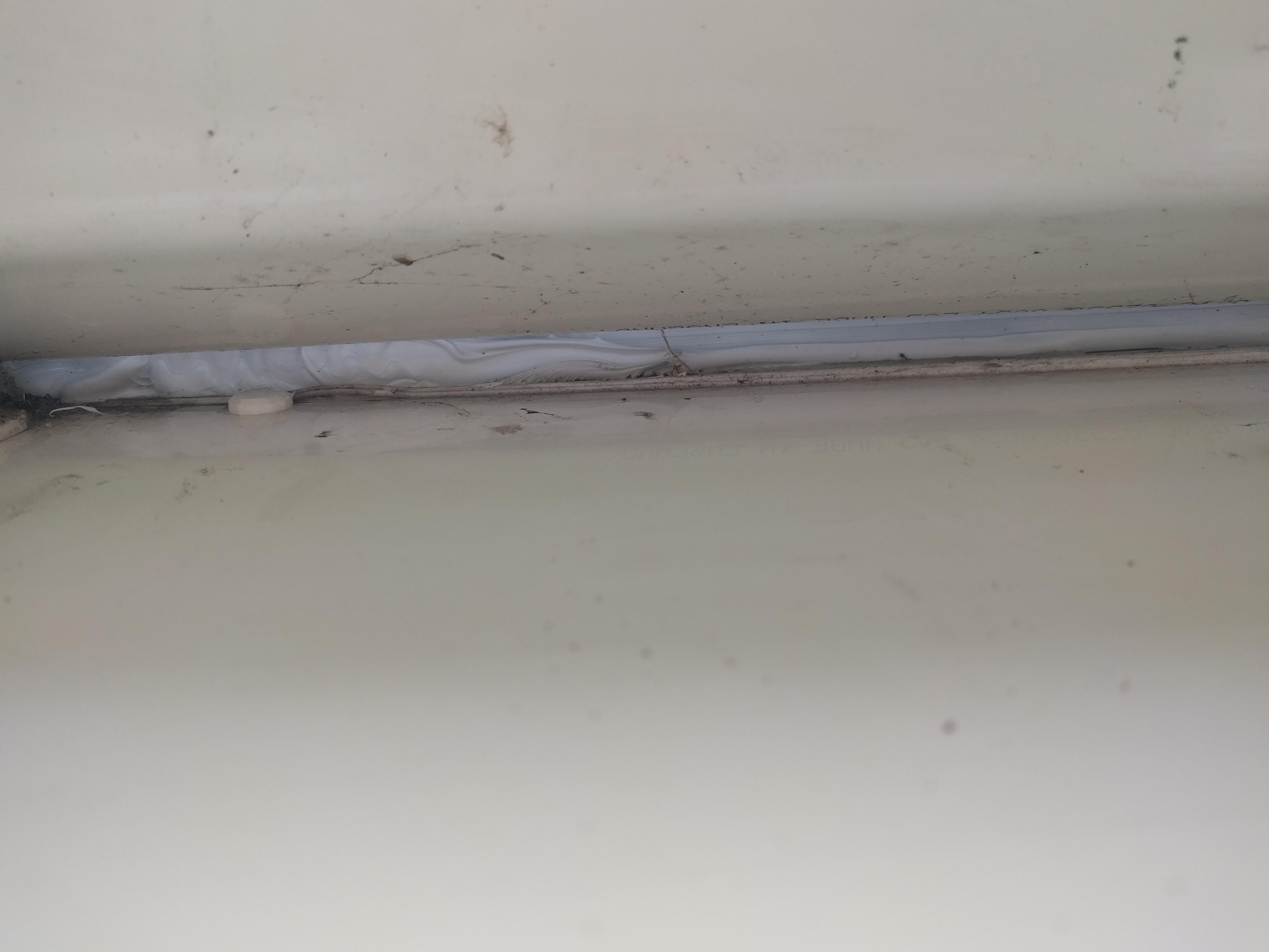

BobAJob Posted October 27, 2020 Author Share Posted October 27, 2020 (edited) Is this a bodge by my roofer? I think put some of the wood under the roof boards in the wrong place and now the trim on the edge of the roof bows out and stops the roof being sealed, so he whacked a load of silicone it. He tells me it's the fascia boards that are causing the problem and they need replacing. Edited October 27, 2020 by BobAJob Link to comment Share on other sites More sharing options...
BobAJob Posted October 27, 2020 Author Share Posted October 27, 2020 I told him I didn't want a load of silicone on it and he went ahead and did it anyway, so now I have to try to undo it. Link to comment Share on other sites More sharing options...
BobAJob Posted November 4, 2020 Author Share Posted November 4, 2020 My understanding is that roofs should be connected to the building and then fascia boards attached to cover up the junction of the building and roof and to provide a means of attaching guttering. Our roofer has attached some of the rubber to the fascia board, so if we ever need to replace the fascia board we have to cut the rubber patches he has stuck to the rubber membrane and the fascia board. I challenged him on it but he told me it was the only way to do it. I've since discovered that there's a piece of bare wood behind the fascia board. Water can't run on to it but potentially rain could be blown up into it. Not sure how I protect that piece of wood. He also seems to have glued the rubber hanging down on the sides of the roof to the fascia board, so again how do you change the fascia boards without cutting the rubber? He's also not used lead to seal the joins between the pitched roof and the flat roof. He has used big rubber patches which he has stuck to the roof tiles. In my opinion he seems to have done the job quickly but not the best finish and potentially left us with problems we didn't have before. We wanted it done right not quickly. Link to comment Share on other sites More sharing options...

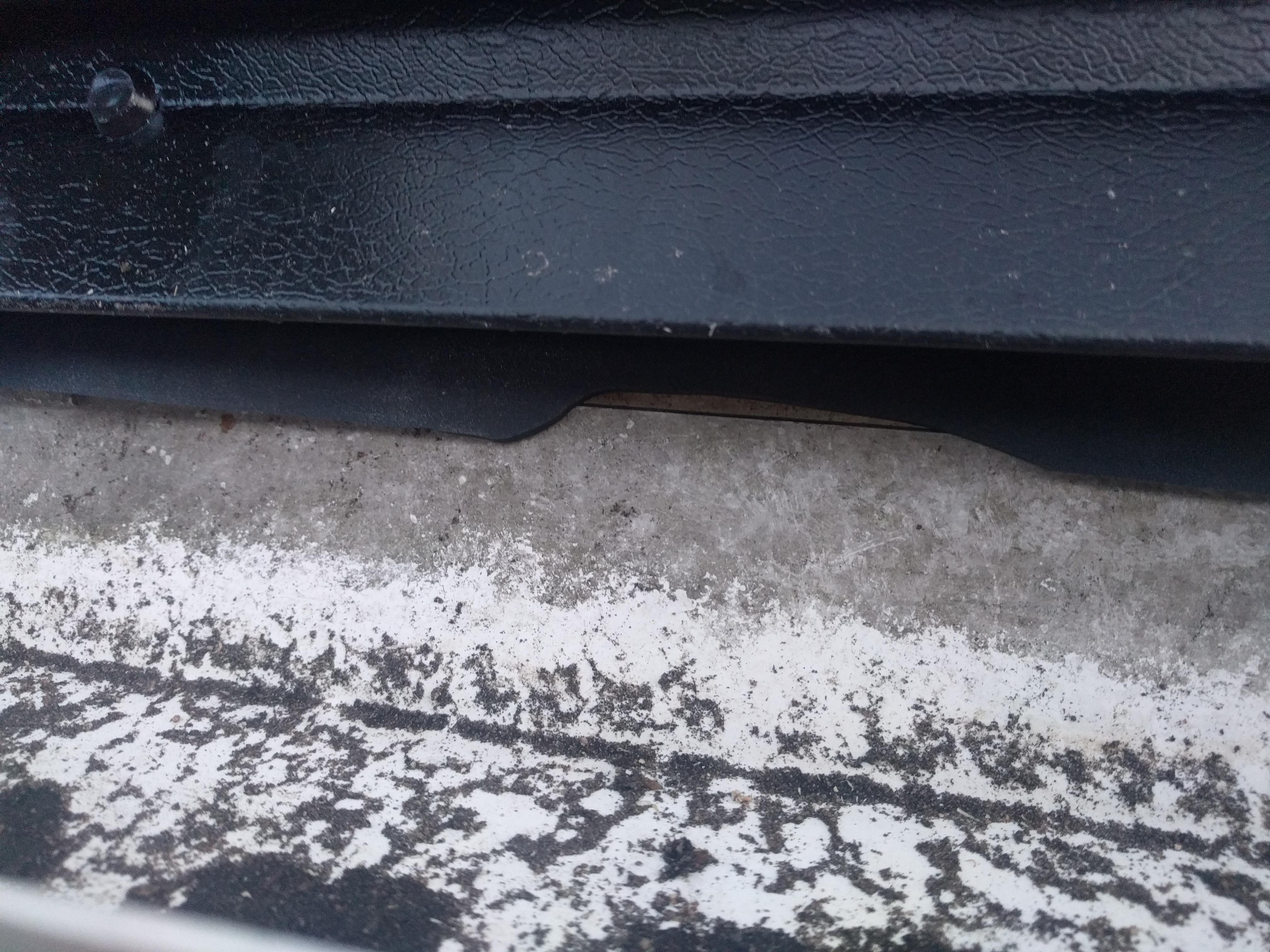

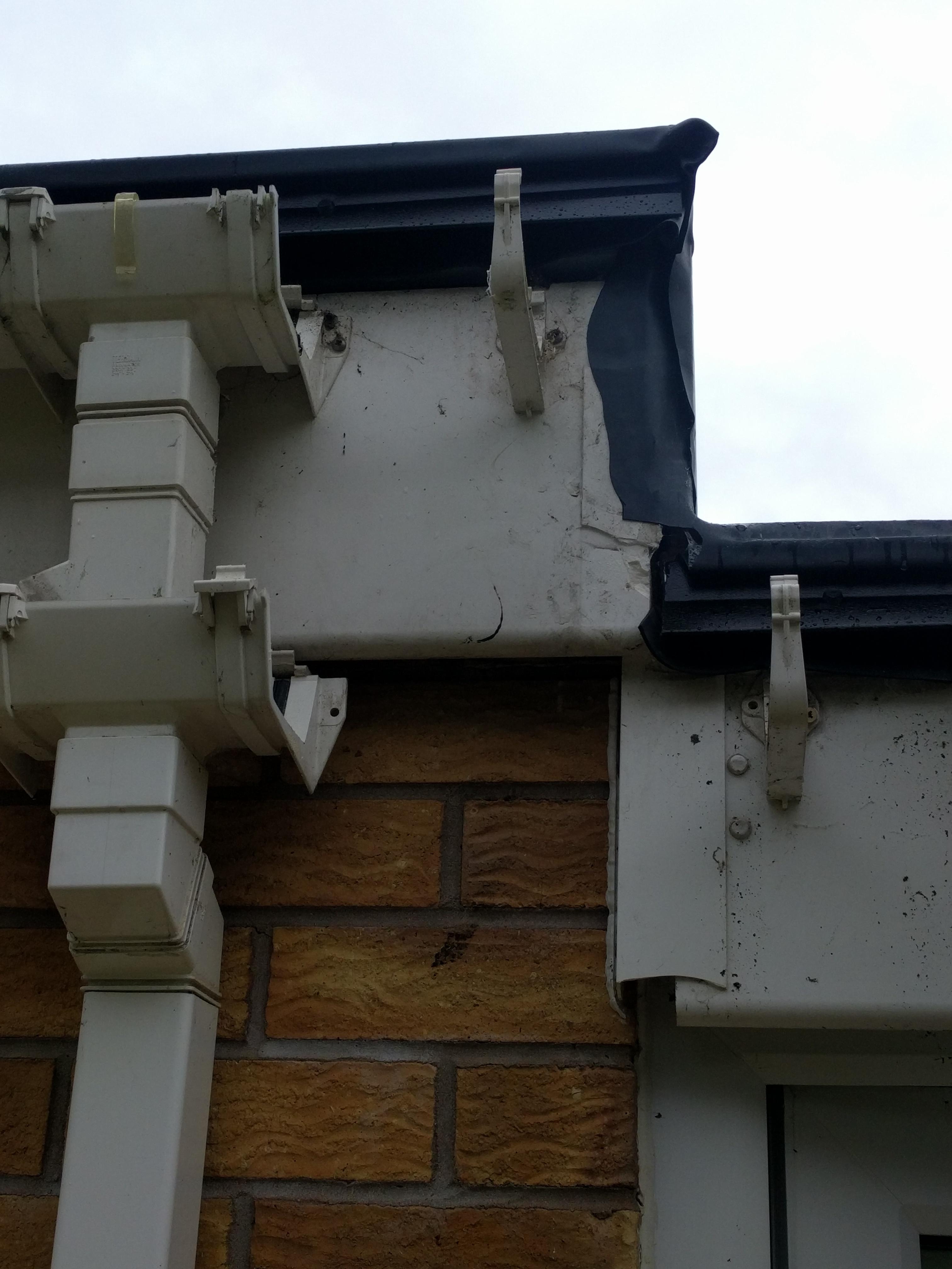

Gav_P Posted November 7, 2020 Share Posted November 7, 2020 It’s should have a drip edge fitted shouldn’t it? Something like this https://www.ebay.co.uk/itm/251194139964 google epdm drip edge and you will see plenty of examples. They are 2 part systems. I bits gets fixed to the edge of the roof and the rubber is laid over it and tucked in. The second part should just clip in to the first. Securing the edge of the roof and ensuring the water drips away from the facia into the gutter. Link to comment Share on other sites More sharing options...
Gav_P Posted November 7, 2020 Share Posted November 7, 2020 Oh and the sides of the roof should have slightly raised slopes (kerbs) to ensure water falls to the lowest edge (where the gutter is). Link to comment Share on other sites More sharing options...
BobAJob Posted November 7, 2020 Author Share Posted November 7, 2020 53 minutes ago, Gav_P said: It’s should have a drip edge fitted shouldn’t it? Something like this https://www.ebay.co.uk/itm/251194139964 google epdm drip edge and you will see plenty of examples. They are 2 part systems. I bits gets fixed to the edge of the roof and the rubber is laid over it and tucked in. The second part should just clip in to the first. Securing the edge of the roof and ensuring the water drips away from the facia into the gutter. Yes, the two roofs he did have that. However, what should the wood under the rubber skirt left under the drip edge look like? We have one roof and then another roof connected to it with about a foot difference in height. It's the joint between these two where he has attached the rubber to the fascia board instead of the roof. I'll take some photos tomorrow. Link to comment Share on other sites More sharing options...
Gav_P Posted November 7, 2020 Share Posted November 7, 2020 It’s really difficult to understand what some of the pics are showing. But I can see lots of corners that are sticking up, flapping about in the wind. Which is clearly unacceptable. In addition, the bottom corner from the vertical to the lower roof, there is a real shoddy cut leaving it open to weather and probably ripping over time. note: I am in no way any kind of building professional... I have just done my own epdm roof in the past. It’s not that difficult to get right if you plan it properly and if you don’t rush. Link to comment Share on other sites More sharing options...
