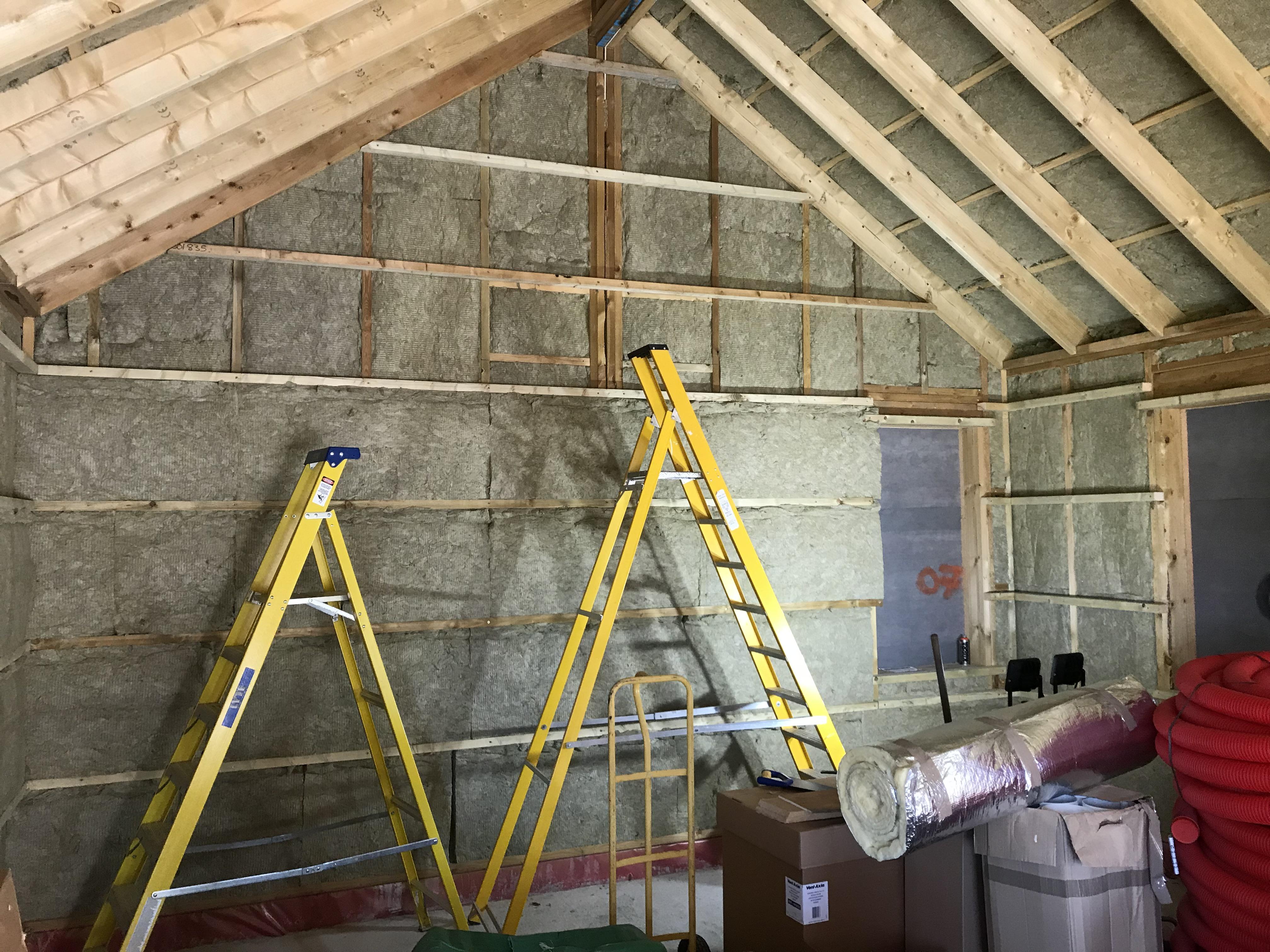

Nestor Posted December 5, 2020 Posted December 5, 2020 I used 3 layers of Rockwool slabs, cross layered. 140mm,70mm and 50mm in the walls. Also 40mm Pavatherm on the outside of the studs. In the photo you can see the 70mm being fitted horizontally. The slabs are very manageable with zero waste. 3

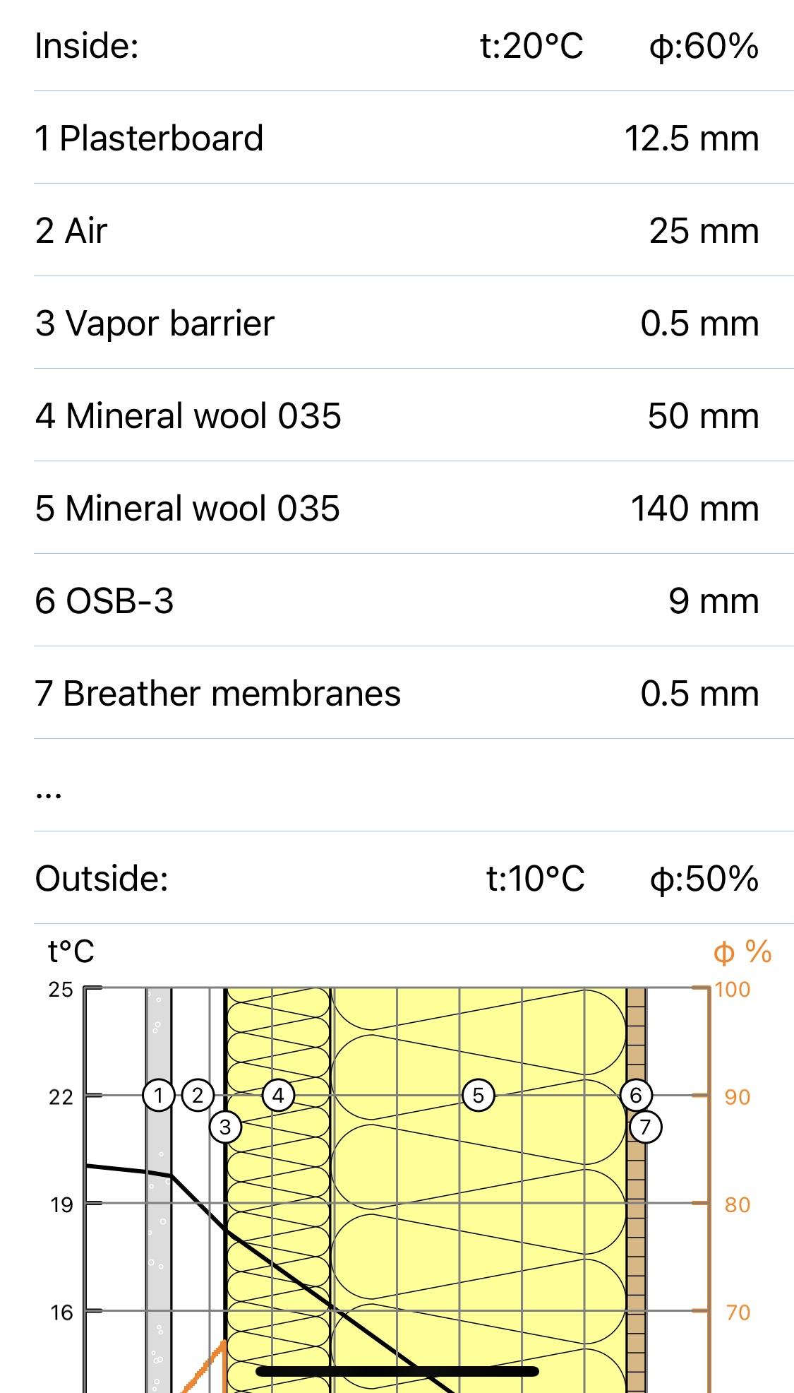

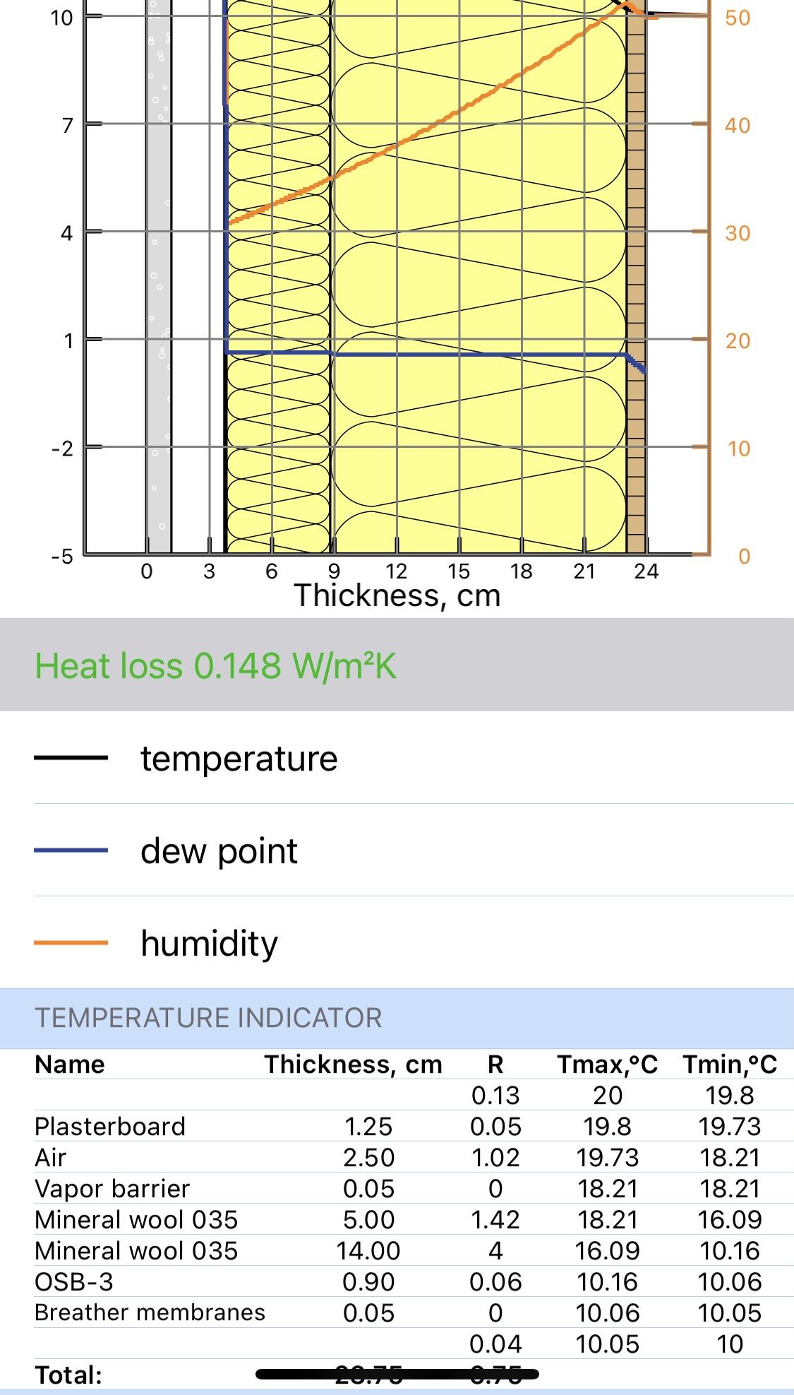

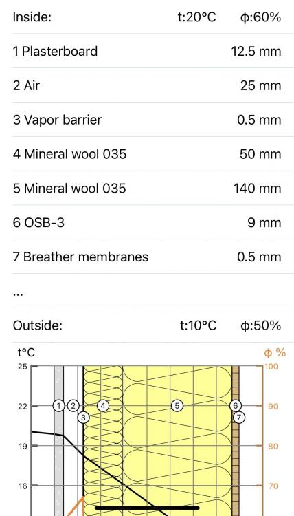

BartW Posted December 5, 2020 Posted December 5, 2020 1 hour ago, JamesP said: I used 3 layers of Rockwool slabs, cross layered. 140mm,70mm and 50mm in the walls. Also 40mm Pavatherm on the outside of the studs. In the photo you can see the 70mm being fitted horizontally. The slabs are very manageable with zero sounds and looks good My target is 0.15. The plan is to get the TF company to fabricate and erect the structure, lay osb and vcl externally, and then take over from there. Would I do inner layer of earthwool, then inner vcl, then service cavity? I did a quick calculation in a piece of simple ios app, but when I add the “air” layer it reduces the U by quite a bit. All well and good, but timber battens add quite a bit being a cold bridge. see below for comment please:
Oz07 Posted December 5, 2020 Posted December 5, 2020 1 hour ago, JamesP said: I used 3 layers of Rockwool slabs, cross layered. 140mm,70mm and 50mm in the walls. Also 40mm Pavatherm on the outside of the studs. In the photo you can see the 70mm being fitted horizontally. The slabs are very manageable with zero waste. interesting birds mouth detail or are they nogs between rafters?

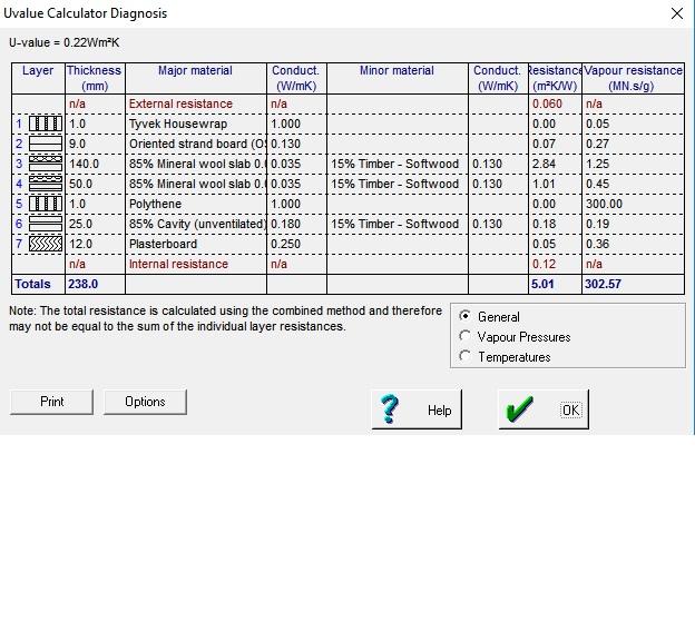

ADLIan Posted December 5, 2020 Posted December 5, 2020 Re U value. Thermal bridge in layer 5 at 15% timber will have a big impact. Resistance of 25mm airspace is wrong, should only be 0.18 (not 1.02)

A_L Posted December 5, 2020 Posted December 5, 2020 (edited) 1 hour ago, BartW said: see below for comment please: as for ADLIan, only more so, there must be timber in your layers 2, 4 & 5. (or more elsewhere). I have copied your table and added 15% timber to 2, 4 & 5. Result - U value falls to 0.216 adding a cavity and brick façade reduces U to 0.205 Edited December 5, 2020 by A_L tidy up
BartW Posted December 5, 2020 Posted December 5, 2020 Thanks guys. How do the TF suppliers manage to back their back up their claims as to uValue then? And is there a more accurate tool I could use to calculate my target U? (PS. mac user here).

ADLIan Posted December 5, 2020 Posted December 5, 2020 Get the insulation manufacturer to do them. They tend to have the correct software and know the conventions that must be used
