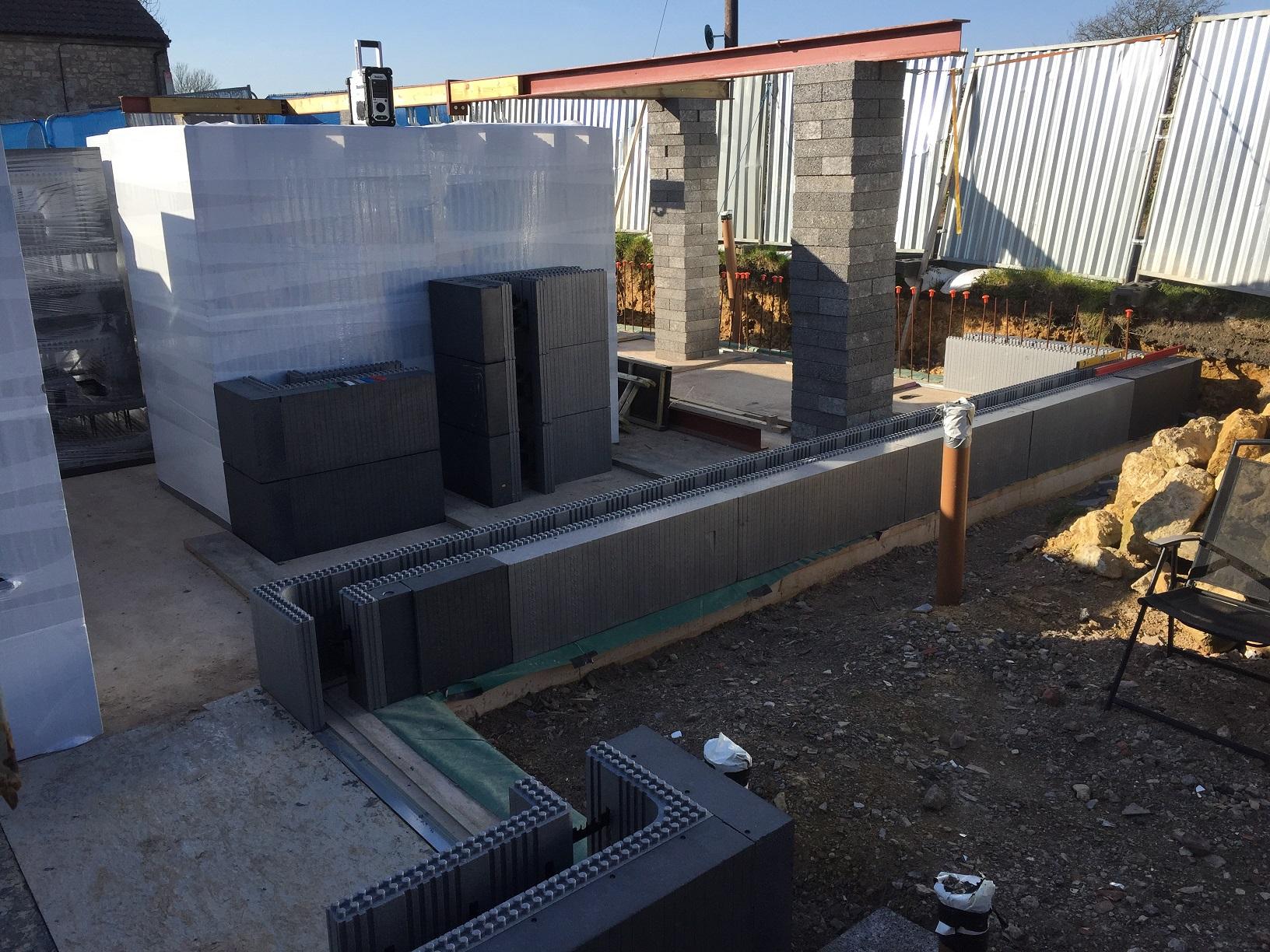

willbish Posted October 21, 2020 Share Posted October 21, 2020 4 hours ago, mjward said: 3) Pipes/services...which of these (if any) need to be cut in pre-pour? I'm guessing due to diameter, waste pipework pre-pour would make life a lot easier, but do you need conduits for the other services or simply cut in post? I sleeved MVHR prior to pour. Everything else has been drilled through after. If you can, design out waste pipes going through the exterior wall and send them all down through the slab. 4 hours ago, mjward said: 4) regardless of ICF product, are people using that same ICF for their foundations or are there cost savings by moving to a pre-formed block etc? Insulated raft for foundation, works really well with ICF 4 hours ago, mjward said: 5) for the DIYers... how long did it take you to assemble your ICF blocks ahead of the pour? (be super useful to have idea of no. of people helping + sqm/ft of the floor) Blocks arrived 26/03/19, first pour 29/04/19 to 2.8m. Just me. Also working day job 50% of the time. So 18 days for groundfloor 88m2. 4 hours ago, mjward said: 6) at the show I noticed that rebar was only used to help form lintels whereas some of the YouTube videos for the same manufacturers showed them being used for the full course of the build. Is this just a geographic thing, i.e. not needed in UK as this isn't earthquake country or is rebar needed in more places than just the window/door openings? Yes you've got it. Vertical rebar for any retaining walls 4 hours ago, mjward said: 8 ) again the curse of YouTube... I have noticed on some videos that the builders are adding an additional layer of insulation on the outside of the ICF and then cladding the whole thing. Is that just for those in Alaska or potentially needed in a UK build too? Potentially for UK too. I think it makes it more economical to buy a standard ICF product then add additional insulation. And cutting 200mm ICF blocks is a no fun. 4 hours ago, mjward said: 9) Internal walls...do people continue with the ICF product or switch to breeze block etc? what would sway the decision other than cost? Didnt even consider ICF for the internals, too costly, waste of insulation. I went with 100mm concrete block. 4 hours ago, mjward said: 10) Joists...looks like the wall plate is the best option, the put the joint hangers directly onto that. With the large bolts for the wall plate, are people fitting those pre-pour so that the concrete cures around the bolt or drilling into the concrete afterwards? Yes pole plate with bolts cast into the concrete. If I was doing it again I think I would drill and resin. Fixing a pole plate to EPS and then pouring concrete behind resulted in a little more movement than I was happy with. Has been made good now but was a bit of effort. 1 Link to comment Share on other sites More sharing options...

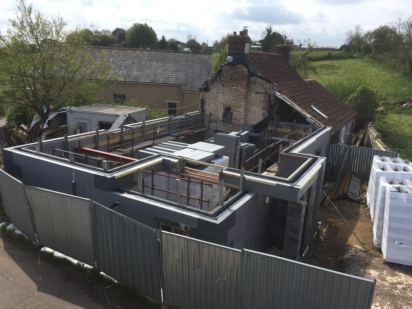

mjward Posted October 22, 2020 Author Share Posted October 22, 2020 22 hours ago, Pm1987 said: We used Durisol and braced the corners and vertically ever couple of meters. I didn't have the bottle to pour the maximum height suggested by dursol and generally poured ever 1.5m - 2m.The openings are a simple box around the opening we used scaffold boards with props in the centre. Sounds sensible. I suspect the cost of the extra pours is negligible vs the it going wrong scenario if you build too high 22 hours ago, Pm1987 said: We used batons inside to allow for service voids. I think it will take you just as long to trace the walls for cables etc but could be wrong. The block is very easy to attach onto with wood screws. Did you baton all walls or just for services? Was wondering about thermal efficiency with the void vs dot and dab. 22 hours ago, Pm1987 said: Ours went through the foundations. We had to core some small holes for the air source and lighting cables but this again was pretty simple. I felt it was easier to drill the block rather than try to allow holes through beforehand. makes sense i.e. pre-plan for the larger intrusions but don't fret if you have to cut anything post 22 hours ago, Pm1987 said: We started the ICF build in Mid / Late Aug 2019 and completed the last pour in middle of Nov. This was myself and a mate who worked full time and had about two week annual leave. The house is 18m x 8m (ground and first floor). Thanks for this. Seems at the higher end of what I've seen but I will take from your pour figures that you are similar to me and would rather take a bit more time if it means getting it right! 22 hours ago, Pm1987 said: Due to me being close to a MOD site we had specialist blast loadings applied to the house (not through choice) which meant we had to have rebar 250mm centres horizontally and vertically around the whole external walls. This was onto of the rebar used within the lintels. Was wondering why your blocks looked so much bigger to what I had seen 22 hours ago, Pm1987 said: Our internal walls downstairs are durisol which we poured at the same time as the external walls. Originally the engineer had them planned for the upstairs walls (not sure if durisol were giving him a little bung) but these were changed to timber partitions as easier and quicker to install. I'm thinking solid internal walls for both ground and first floor (sound/strength angle) so I suspect I either do both via ICF or standard breeze block. Most pictures I've seen have builders using breeze for the internal so guessing a noticeable price difference but given the DIY approach I wonder if for me it will net out to much of a change and thus easier to ICF the lot. 22 hours ago, Pm1987 said: Wall plate as you said with the plate installed prepour and the concrete setting around them. Perfect, that clears that up thank you! Link to comment Share on other sites More sharing options...

mjward Posted October 22, 2020 Author Share Posted October 22, 2020 19 hours ago, willbish said: I sleeved MVHR prior to pour. Everything else has been drilled through after. If you can, design out waste pipes going through the exterior wall and send them all down through the slab. good tip! 19 hours ago, willbish said: Insulated raft for foundation, works really well with ICF 3/3... think the raft needs to be added to my notes 19 hours ago, willbish said: Blocks arrived 26/03/19, first pour 29/04/19 to 2.8m. Just me. Also working day job 50% of the time. So 18 days for groundfloor 88m2. that is seriously impressive. 19 hours ago, willbish said: Yes you've got it. Vertical rebar for any retaining walls Potentially for UK too. I think it makes it more economical to buy a standard ICF product then add additional insulation. And cutting 200mm ICF blocks is a no fun. From the U-values I saw from Isotex, you can get 0.15 with their 380mm block which is the one that appeals to me. That seems good enough for the UK 19 hours ago, willbish said: Didnt even consider ICF for the internals, too costly, waste of insulation. I went with 100mm concrete block. Do you have a ballpark what your sqm of concrete block came to? Did you build that yourself? The insulation angle I would like is more of an acoustic rather than thermal one so prepared to pay a premium for that, it just depends how much we are talking really. 19 hours ago, willbish said: Yes pole plate with bolts cast into the concrete. If I was doing it again I think I would drill and resin. Fixing a pole plate to EPS and then pouring concrete behind resulted in a little more movement than I was happy with. Has been made good now but was a bit of effort. Interesting to hear. I wonder if this is a poly vs woodcrete issue ie the poly doesn't hold it as well whereas perhaps woodcrete would? 19 hours ago, willbish said: Link to comment Share on other sites More sharing options...

mjward Posted October 22, 2020 Author Share Posted October 22, 2020 59 minutes ago, Pm1987 said: Used batons on all internal walls and plasterboarded over. This time scale was basically us just working weekends, nights and two weeks. Included in this time was erecting scaffolding, installing first floor posi and caber and waiting for the pump availability. You will find some people using the icf externally but blocking internally may give you a false sense of speed if you intent to use them internally. Please also do not underestimate the weight of the durisol blocks. They are easy to lift and fit at the lower levels but once you start on the second floor and gables (especially if they are wet) you will start to feel the pain. Throw in some wind, rain and snow it get depressing pretty quickly. The blocks we used are the D365 externally and D170 internally. I didn't feel the need to use the larger blocks internally and as someone else has stated they do take up a larger footprint. Good to hear you went the posi route, only discovered it last week and seems a no brainer for the modern build and all the pipework/ducting it includes. Hear you weight of the blocks, I lifted one up last week (yes just the one ) and it's a completely different kettle of fish to the poly ICF. Thanks for you help, massively appreciated Link to comment Share on other sites More sharing options...

Andy H Posted January 30, 2021 Share Posted January 30, 2021 On 21/10/2020 at 18:41, willbish said: Blocks arrived 26/03/19, first pour 29/04/19 to 2.8m. Just me. Also working day job 50% of the time. So 18 days for groundfloor 88m2. That sounds like you were productive. Which ICF supplier did you use? Kind regards Andy Link to comment Share on other sites More sharing options...
