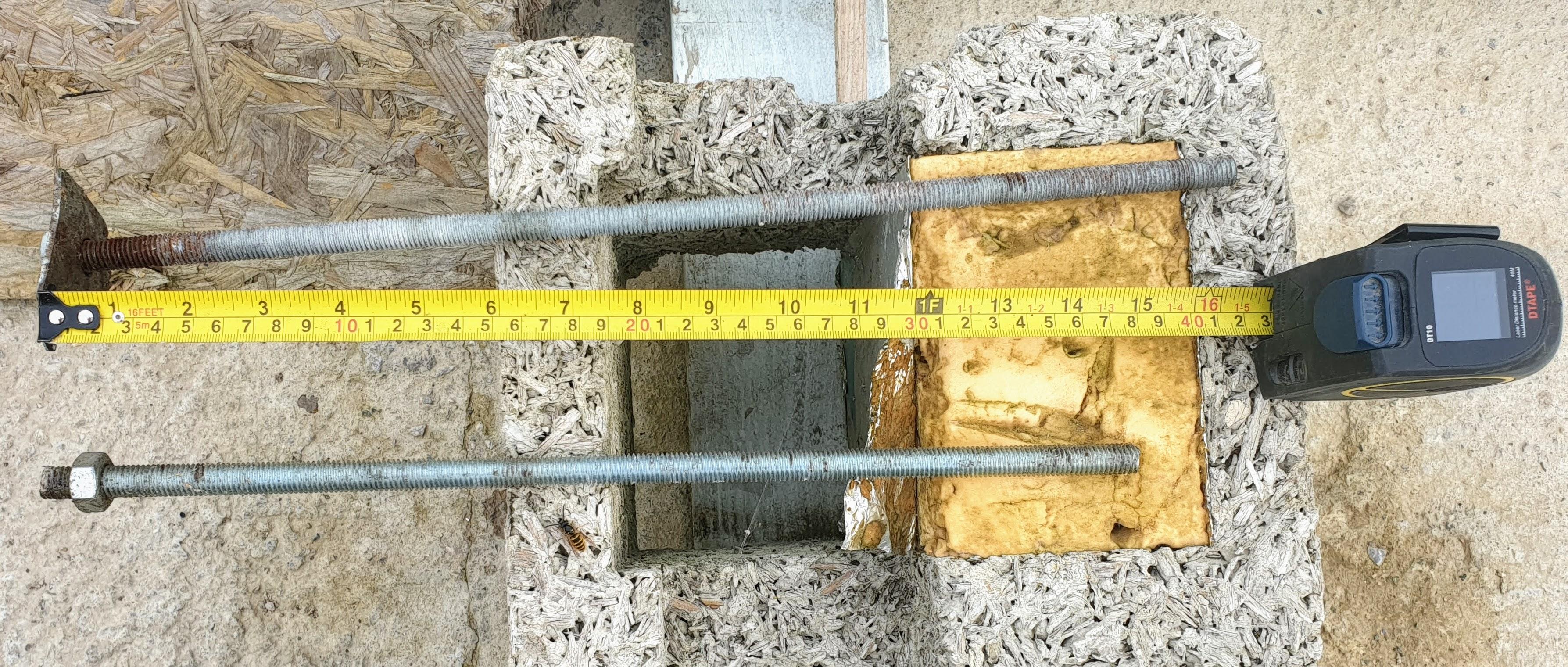

ToughButterCup Posted October 19, 2020 Author Share Posted October 19, 2020 Ok folks. I ppreciate the caution. I know it's my responsibility. To calm your nerves, heres what I propose, demonstrated on an empty block. This is a plan view. The concrete is I00mm thick, (the empty space).Theres 40mm of block - I propose a 150mm shelf supported by the M12 threaded bar embedded in at least 90 to 100 mm of concrete and 40mm of block. To me, the highest risk is of drilling the holes in the block wall where two blocks join. So I'll do some pilot holes to make sure I hit concrete. Then embed the M12 in the shelf last. Link to comment Share on other sites More sharing options...

Mr Punter Posted October 19, 2020 Share Posted October 19, 2020 2 hours ago, ToughButterCup said: Ok folks. I ppreciate the caution. I know it's my responsibility. To calm your nerves, heres what I propose, demonstrated on an empty block. This is a plan view. The concrete is I00mm thick, (the empty space).Theres 40mm of block - I propose a 150mm shelf supported by the M12 threaded bar embedded in at least 90 to 100 mm of concrete and 40mm of block. To me, the highest risk is of drilling the holes in the block wall where two blocks join. So I'll do some pilot holes to make sure I hit concrete. Then embed the M12 in the shelf last. There is a wasp in this picture. Exercise caution! 1 Link to comment Share on other sites More sharing options...
