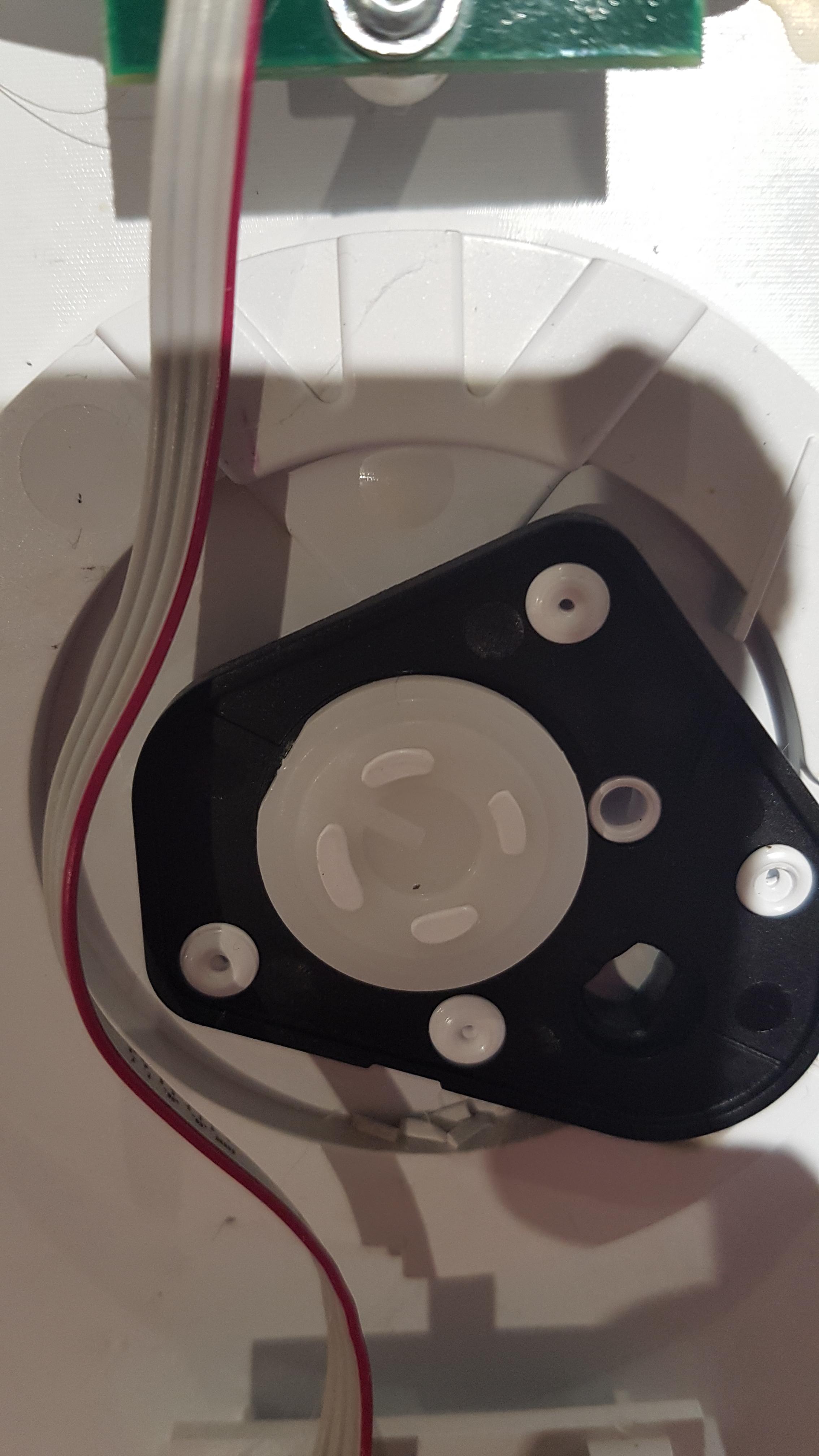

Some showers have a little toothed belt to connect between the knob and the actual flow control, check that has not snapped.  Can you post a picture of the mechanical bits around the temperature knob?

Boom, I think you have solved it, just taken a picture of the back of the knob. This white bits I presume the broken teeth!

What "teeth" are you referring to? those 4 prongs?
Can you post a picture of the part the knob mechanism mates to?
What's that slightly trapezoidal hole just down and to the right?  Is that where a spindle engages?  if so that should turn as you rotate the knob and there is either a gear or belt between them.

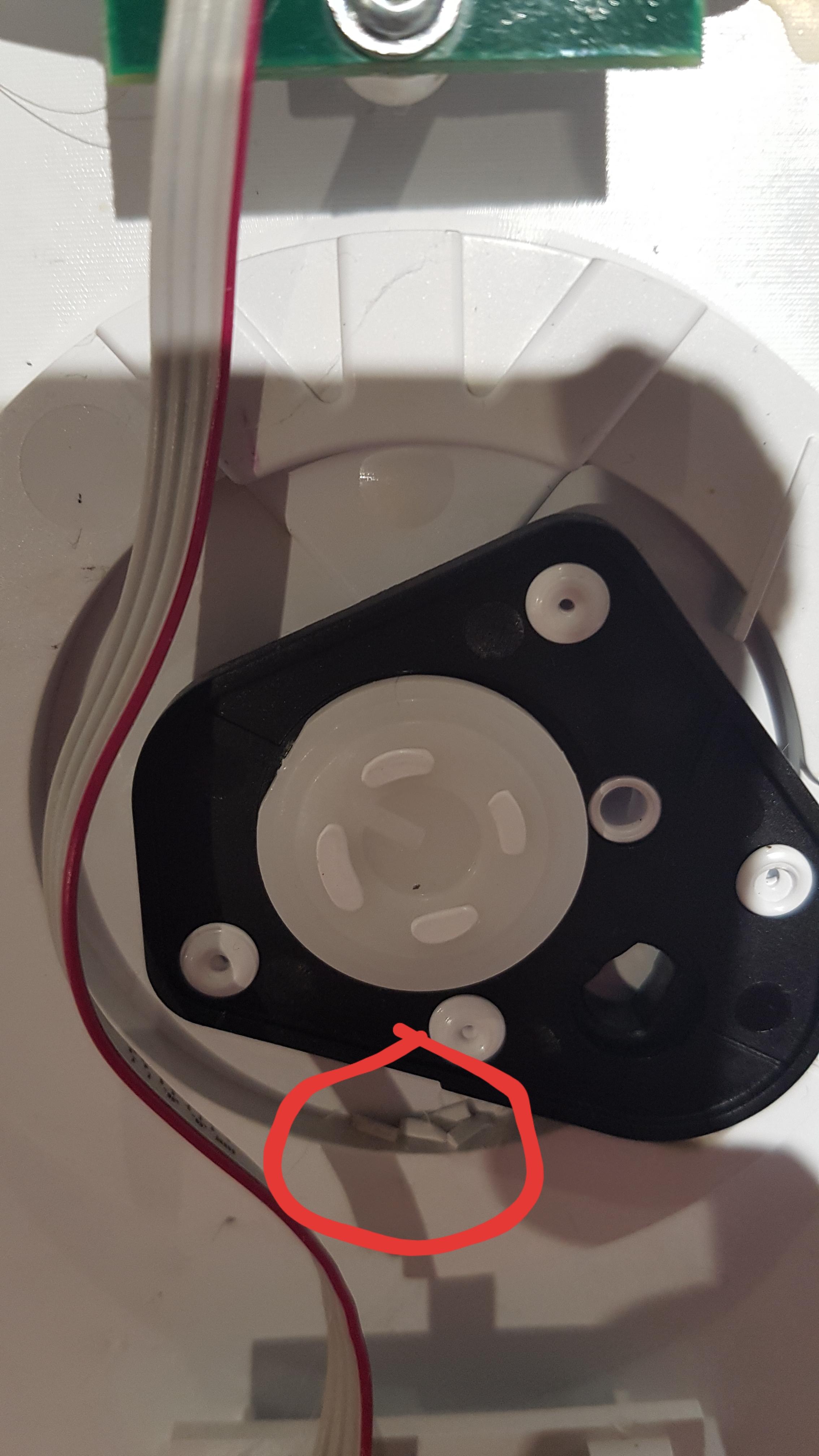

At the bottom of the control the are a number of white bits of plastic, which I presume have come from the control mechanism, see the red circle below.
When I turn the temp control the trapezoidal hole turns but has gaps in its rotation (stops) even though the temp control is still moving.
I think it is  this control that hasn't got the full range of movement to turn the shower to it's highest heat
wedge something in the trapezoidal hole and then apply some "load" to it and see if it rotates when driving a load.
Can you see anything in the gap between the front and the black "plate" or is it totally enclosed?
It does not immediately look like that is meant to dismantle.

No it doesn't so it looks like the temp control nob won't turn the spindle to control the flow, so it looks as though it is the control nob that is knackered.
I have just turned the flow spindle on the unit 90 degrees, and fitted the front cover, now it has a decent heat to the water. So it was definitely the mechanical control of the the temp that was broken rather than anything internal.
From a quick google it looks like you are right and i need to buy a complete face plate, ah well at least the problem is found and a temp solution found.
Thank you very much, i had completely over looked the mechanical side of it!
This can sometimes mean the flow control valve has failed or is scaled up. They become stiffer and then the control dial pins sheer when it needs too much force to move the flow valve.
At this point if you’ve replaced PCB and now need new front cover and potentially the flow valve I would be swapping the whole unit.
