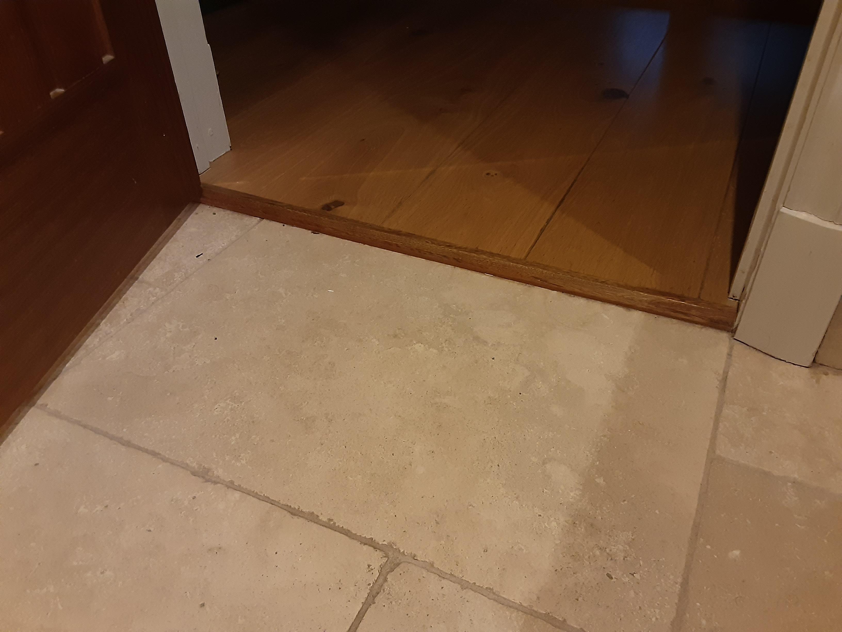

PS We have a small difference in levels at our bathroom door between a stone floor in the bathroom and wood floor outside. It's not been an issue although our step is going up as you leave rather than enter. The step is about 10mm high.

what do you guys do about the raised height though, a small step into the room?
