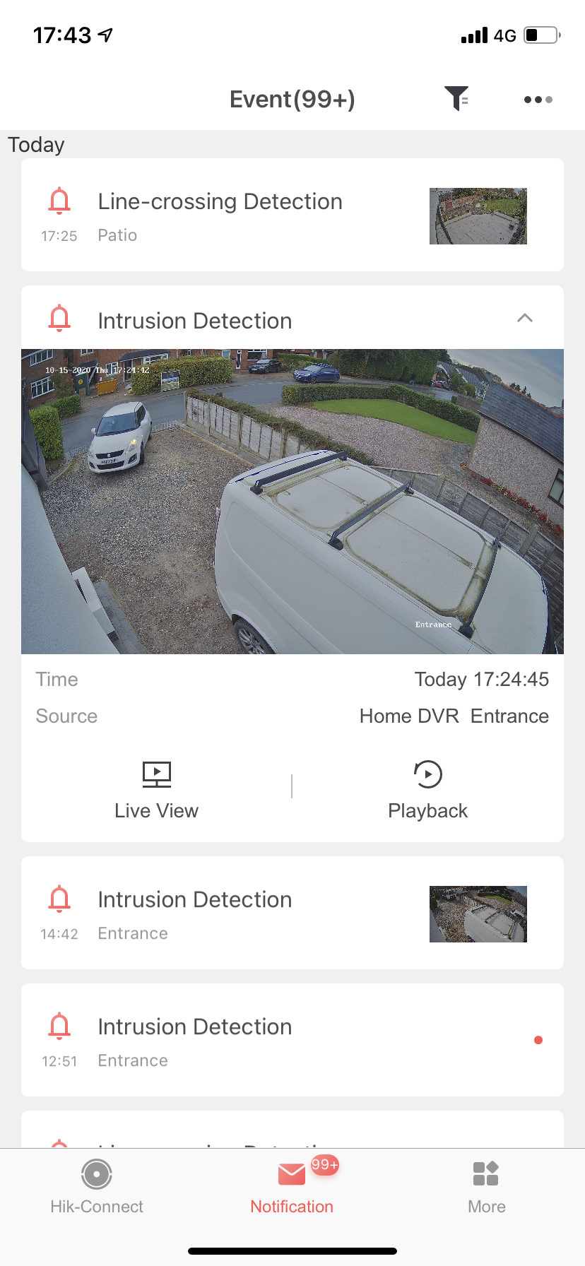

Rmawdsley Posted October 15, 2020 Share Posted October 15, 2020 I ran cat6 cables to places I potentially wanted cameras from a central location which I knew I would put my DVR whilst the sparky was doing the 1st fix. A 100m box of cat6 doesn’t cost a great deal! And then I bought a hikvision DVR and have gradually added Poe cameras to the system. No batteries required, no potential issues with WiFi signal and no subscription. The latest cameras hardly ever give false detections/alerts either. 1 Link to comment Share on other sites More sharing options...
