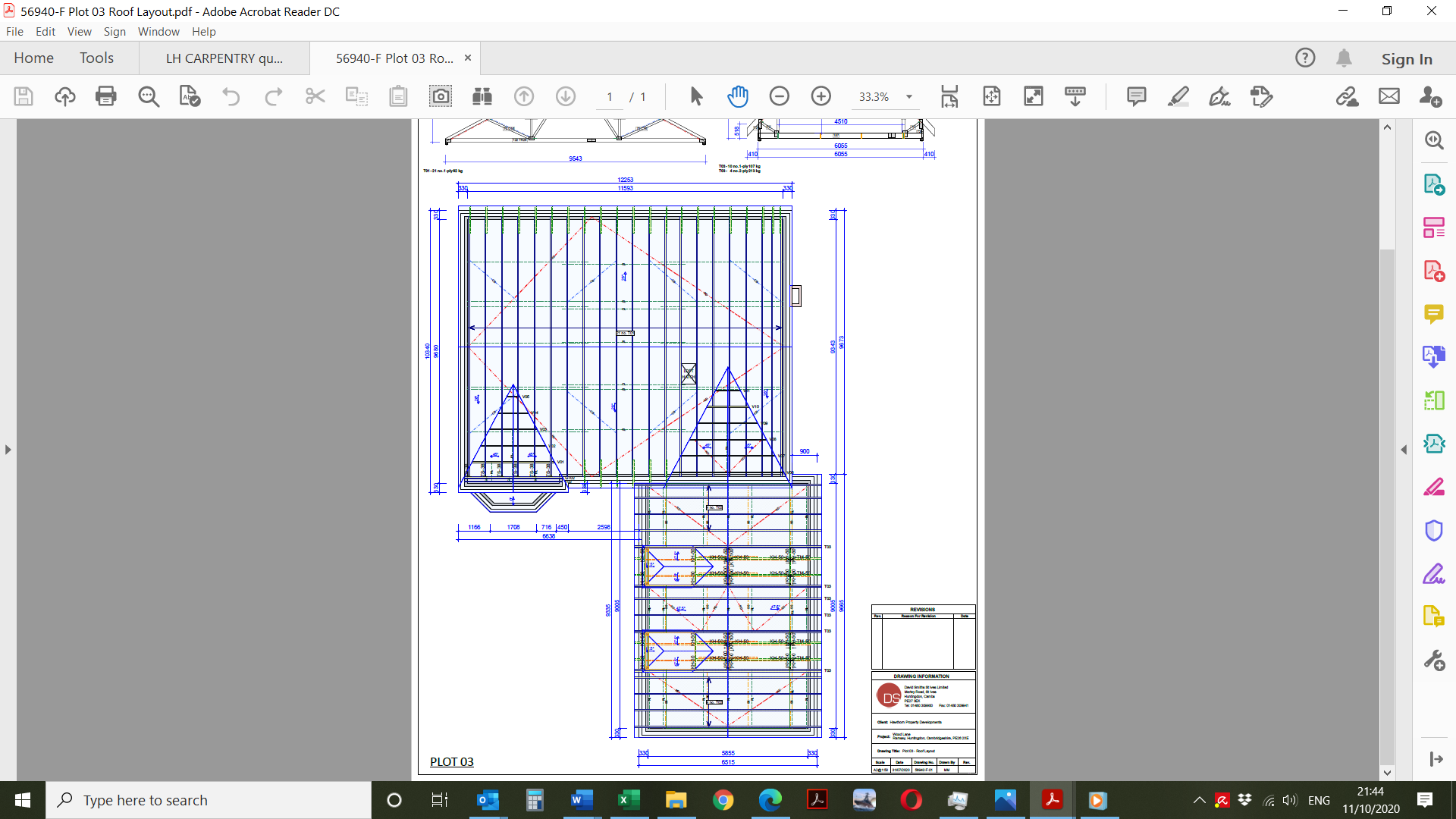

MortarThePoint Posted October 11, 2020 Posted October 11, 2020 I've had some truss designs from some suppliers and they have all gone with 600mm centres. As I understand it that's the normal way to go these days. Does anyone go for 400mm centres any more? There is a housing estate near us that has lots of slate roofs and they look bad after 5 - 10 years. Not due to the slate, but looks like the underlying timber has shifted over time. We're going for plain clay tiles, but this has made me think about whether too many savings are being made on trusses. It's interesting to see the sizes of timbers chosen by the suppliers for the top chords (i.e. the actual roof slope). One supplier has designed based on 47x147, another used 47x197 and the third used 47x222. There was more agreement over the bottom chords with the same first one going for 47x197 and the other two going for 47x222. The one with the slighter timber wasn't the cheapest either.
nod Posted October 11, 2020 Posted October 11, 2020 Nothing to stop you But not necessary As you say all the designs are 600
Vijay Posted October 11, 2020 Posted October 11, 2020 Yep, found the same thing, every supplier was 600 but some varied in depth of timber too

Faz Posted October 11, 2020 Posted October 11, 2020 Mine designed at 600mm centers - can't see a problem tbf and we get the wind ripping across the Fen!
Oz07 Posted October 11, 2020 Posted October 11, 2020 Have trusses ever been at 400 centres or are you referring to rafters? I bet it's more common than you think people using 19mm batten with 60p centre spacing which would likely cause a roof to look bumpy.
Gus Potter Posted October 11, 2020 Posted October 11, 2020 Sometimes, if you have no sheeting (sarking / ply) on the top of the rafters then if the roof is fairly big you want to fix wind bracing to the underside of the rafters. If you have a roof that can say get some snow drift off a higher roof this inceases the load locally. To make this work you decrease the spacing of the trusses where the higher loads are. This way you keep the rafters the same depth and it makes it easier to fix the wind bracing as the underside of all the rafters are in the same plane.
