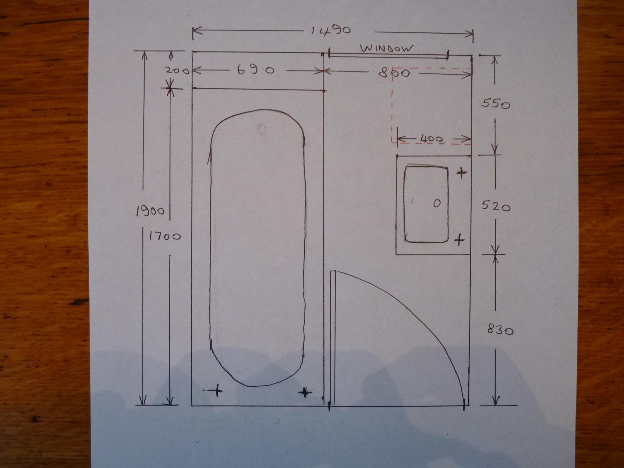

howplum Posted October 2, 2020 Author Posted October 2, 2020 I am unable to provide pictures, but have attached a scale sketch of the current layout, which I hope helps. As you can see, the bathroom is very compact. 19 hours ago, ProDave said: Assuming the external hopper into which the sink and bath waste drain to, connects to the SEWER (not a rainwater soakaway) then It would not be hard to connect an external 110mm stack to that to take a proper toilet and well as the bath and shower waste. The trap that the grey water and rainwater currently discharge into is below the bathroom window, which is convenient. Based on the assumption that the drain connects to sewer system then perhaps the trap can be replaced by the correct connection for a soil pipe, connected to the (presumably) underground clay pipe. Can the rainwater also discharge into the soil pipe? I should explain that the lady who lives there, on her own, is quite keen on the idea of a macerator toilet, having seen a neighbour's installation, although that's probably based on the belief that a sealed system is not required. We have selected the Sanicompact because of it's dimensions, which are 390mm wide and 435mm deep. Even short projection conventional toilets, with a cistern, start at 600mm deep. Part of the plan is to rehang the door to open outwards and perhaps move the washbasin a little nearer to the door. The toilet can be either on the same wall as the washbasin, or under the window, although in the former case there is limited room in front of it. I understand there should be at least 50cm clear space in front of it. Taking the long term view it would be best to keep the bath, because it's potentially a family home, although changing it for a shower would free up a lot more room and make it easier for the current occupier, who has some mobility issues. That's another question, but I think the focus here is to see if a toilet can be included without costing thousands to connect it to the sewer.

Ferdinand Posted October 2, 2020 Posted October 2, 2020 (edited) My thoughts: ? Looking at the plan, I wonder whether it might be easier to just hinge the door the other way which would save hacking around with the frame - a 762mm door should hinge fine into 830mm. I would possibly put a "catch and hold" door holder-opener on it, like this: https://www.amazon.co.uk/gp/product/B07CLWN3CS/ For the loo, I think I would put it under the window facing along the bathroom, as even with the Sani Compact the 400mm clearance to the bath is still really tight - I think they like 750, and 510 is the required minimum (though no one is going to jump on you for it unless it is subject to rental regulation in one of the more tickboxy places). And I think I would fit a pedestal basin to give for leg clearance when sitting on the loo, and then a carefully chosen wall cabinet for storage. And perhaps a shower over the bath, plus a screen. Is there somewhere to hang a towel, and a radiator? (Might be an argument for outward-hinged door). How are you ventilating? One of my hobby horses is fans with a backdraft shutter. Ferdinand Edited October 2, 2020 by Ferdinand 1
Nickfromwales Posted October 2, 2020 Posted October 2, 2020 (edited) A number of faux pas here chaps. 1, you can’t discharge yesterday’s vegetable madras into a gully pot as it will have a trap. 2, you cannot connect to the existing waste pipe work as they’re all gravity and the SF discharge at ~0.7 bar. 3, Also, look at the Saniflow installation instructions. Page 5 and you’ll see that when you pipe down independently to the ground level ( after altering the groundwork’s to accept the foul discharge directly ) you will need to have a vertical riding pipe also with a suitable air admittance valve to stop the chuffing thing syphoning out ( ever heard the noise a kid makes in McDonalds when they get to the end of the milkshake )....,. And how did you arrive at the 4-figure sum fir the stack? Did you get a quote or is the old ‘assumption’ being made? That’s a 4-figure job, including adding the rising soil pipe and alterations to the groundwork’s so the rainwater can still have a trapped fully, but £1500-1800 max. Edited October 2, 2020 by Nickfromwales 1

Nickfromwales Posted October 2, 2020 Posted October 2, 2020 (edited) 3 hours ago, howplum said: I can see that might be an issue, although that's exactly what has been happening for several decades. The gulley pot (nice to know the correct terminology) accepts waste water from the downstairs WC basin, kitchen sink, upstairs bath and washbasin, as well as rain water. Had it been taking foul ( black ) water eg ??? If it’s only been taking kitchen sinks / other bathroom wastes then that’s ( grey ) aka non foul discharge. Big, lumpy, drain blocking difference there Edited October 2, 2020 by Nickfromwales
Nickfromwales Posted October 2, 2020 Posted October 2, 2020 3 hours ago, howplum said: That sounds like a better figure. Are you saying the rainwater needs to be separate? Yes, as that needs to discharge into a trapped gulley, eg so stench doesn’t emit from ground level. The black / foul connection needs to be unhindered flow to the sewer and any rising stench needs to be dealt with by the ( new ) foul stack getting to the upper floor to collect the new WC but then continuing upward to soffit height and then being open to atmosphere to 1) vent the sewer gasses, and 2) allow an influx of air to alleviate the vacuum deficit created in the pipe by flushing the upper WC. That air admittance stops any connected traps ( including the water level in the WC itself ) from being ‘sucked’ dry by said vacuum. Easy this plumbing lark, ain’t it 1
Nickfromwales Posted October 2, 2020 Posted October 2, 2020 3 hours ago, howplum said: For obvious reason I assume a soil stack/pipe would not have a trap, but could it accept all of the above, plus toilet waste? Yup. Then you can just have one external pipe that accepts anything and everything waste wise. You’d still need a rainwater down pipe though. 3 hours ago, howplum said: What are the implications? You’re connected traps ( bath and basins ) turning into ? emitting crop sprayers every time the SF pumped out. 3 hours ago, howplum said: I get the general consensus about macerator toilets, but I'm trying to establish the viability of modifying the current waste system to accept toilet waste. Employ a plumber to tell you ?
