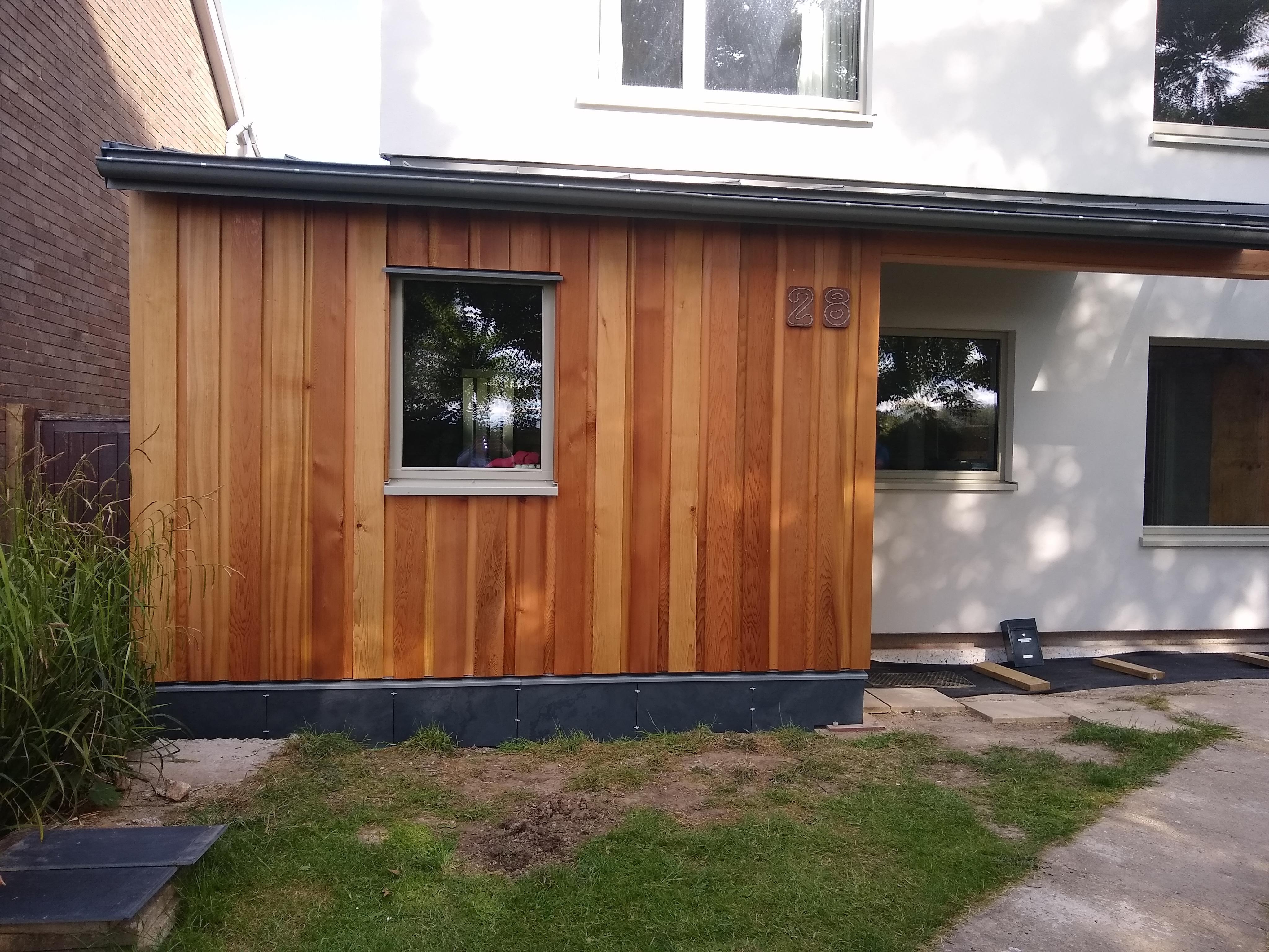

We need to get the EPS upstand of our house covered before the paving can be done. It will have a gravel margin next to it & cedar cladding 150mm above for the majority of the perimeter, the exceptions being the thresholds of doors, which are level with ACO drains in front.
Our options seem to be cement board with thincoat render, powder coated aluminium or the composite panel as used by @worldwidewebs
What are the experiences of others? I imagine it is difficult to get a good render finish tight up to the cladding - but would it be noticeable? This sounds the most durable. The other 2 options sound as if they would initially at least give a cleaner finish, but what happens over time?

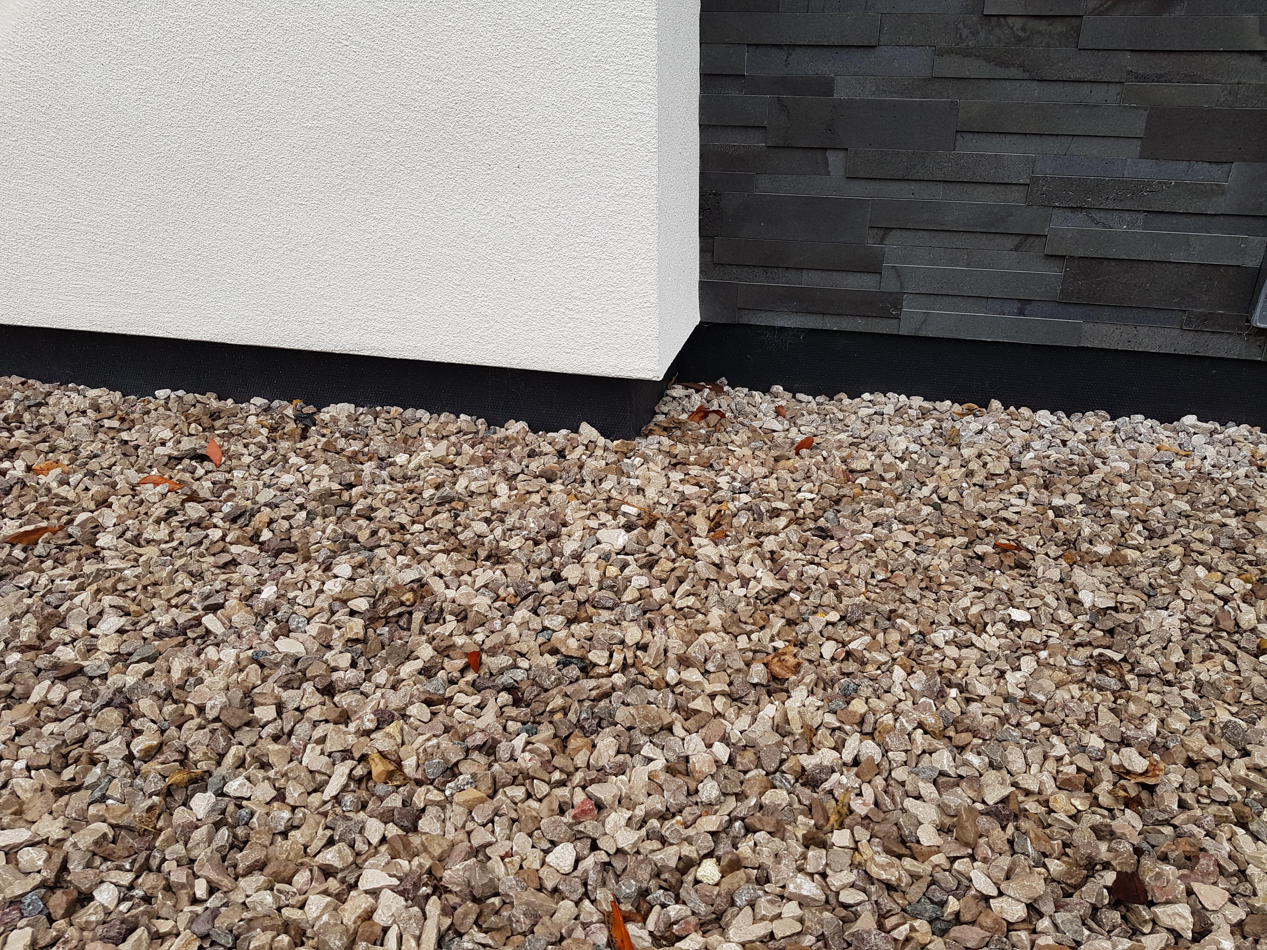

We used slate tiles - external tile adhesive directly onto the EPS.  Only been done a few months so can't vouch for longevity,  but seems pretty robust.

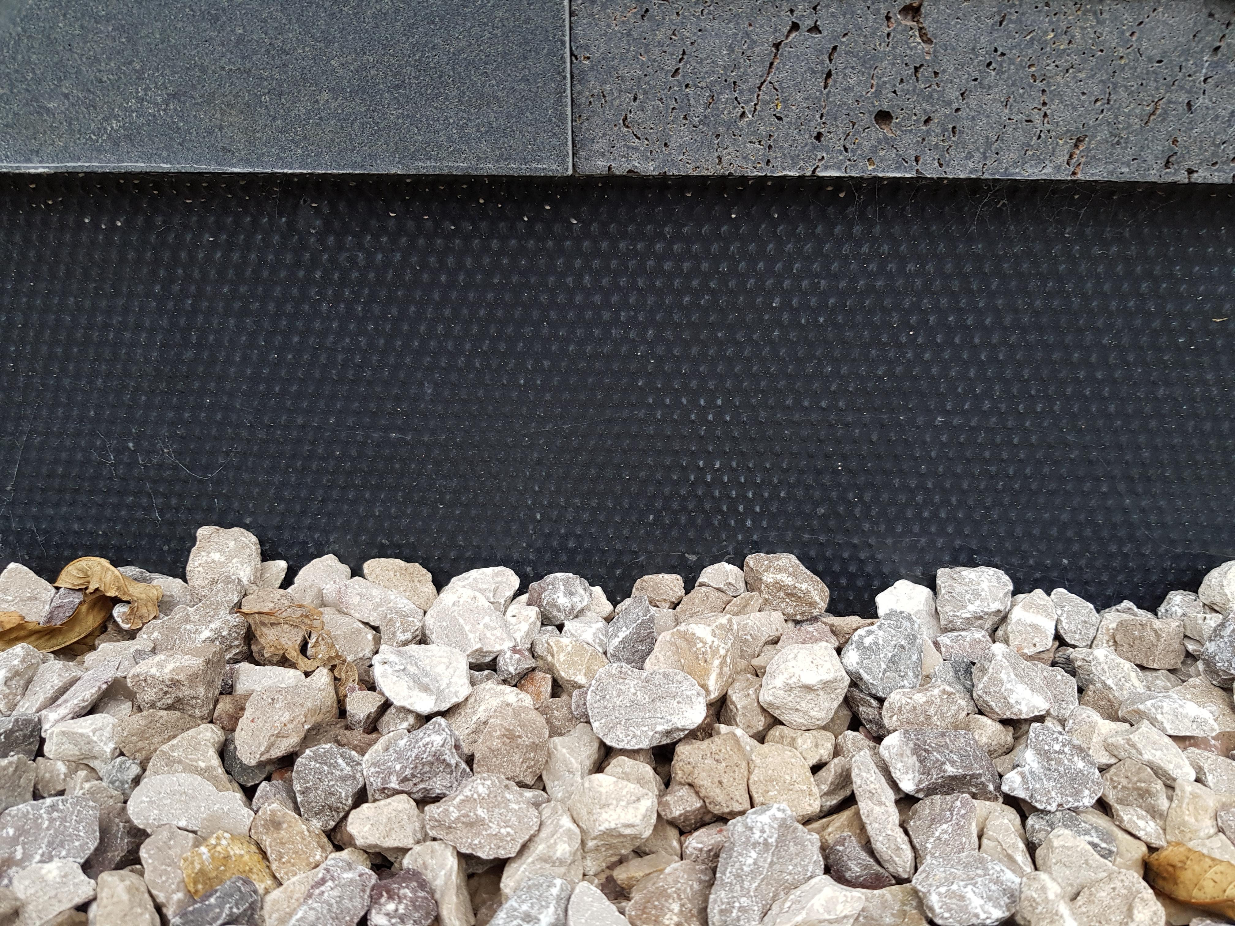

We used Ubiflex which is fixed using their adhesive and looks really smart

It looks as if I am late thinking about this as our cladding is already on with the battens cut to suit the cladding.
We have 19mm WRC on 25mm battens above. The DPC has been turned down & taped as it was holding water onto the frame when turned up (how the framers left it).
I assume we need a carrier board if we render, but this looses the majority of the air gap (3mm dot & dab, 12mm board, 3mm render?).
The ubiflex potentially looks great - @Pete do you have pics/ details of how you fixed it on.
I am concerned that if we use long lengths of aluminium that it will ripple & also be easily marked by the gravel margin. It also sounds expensive.
The method @Jeremy Harris used relied on batten continuing down the EPS, which we don’t have. Could the board be glued directly to the EPS, how are they joined - a silicone bead?

I just used the ubiflex adhesive to fix it. Really easy to do, applied a couple of horizontal beads and fixed the Ubiflex. I used some rollers to try and get good adhesion. I will add you can sometimes see a small amount of RIP g but it is very slight and on the overall look of the house looks fine. The Ubiflex is very easy to bend around corners. I butt joined it and will cover with a black Silkaflex. I bought the 900mm wide roll and cut it to size, saved a few pennies!!
@Pete, just to be certain - you used the hi-tack on EPS, it would be disappointing to see it dissolve before my eyes!
No sorry, I have just checked and we had a block plinth to attach to. Really sorry I sent you the wrong info, got to many things going on in my head at the mo. Once again I do apologise.
