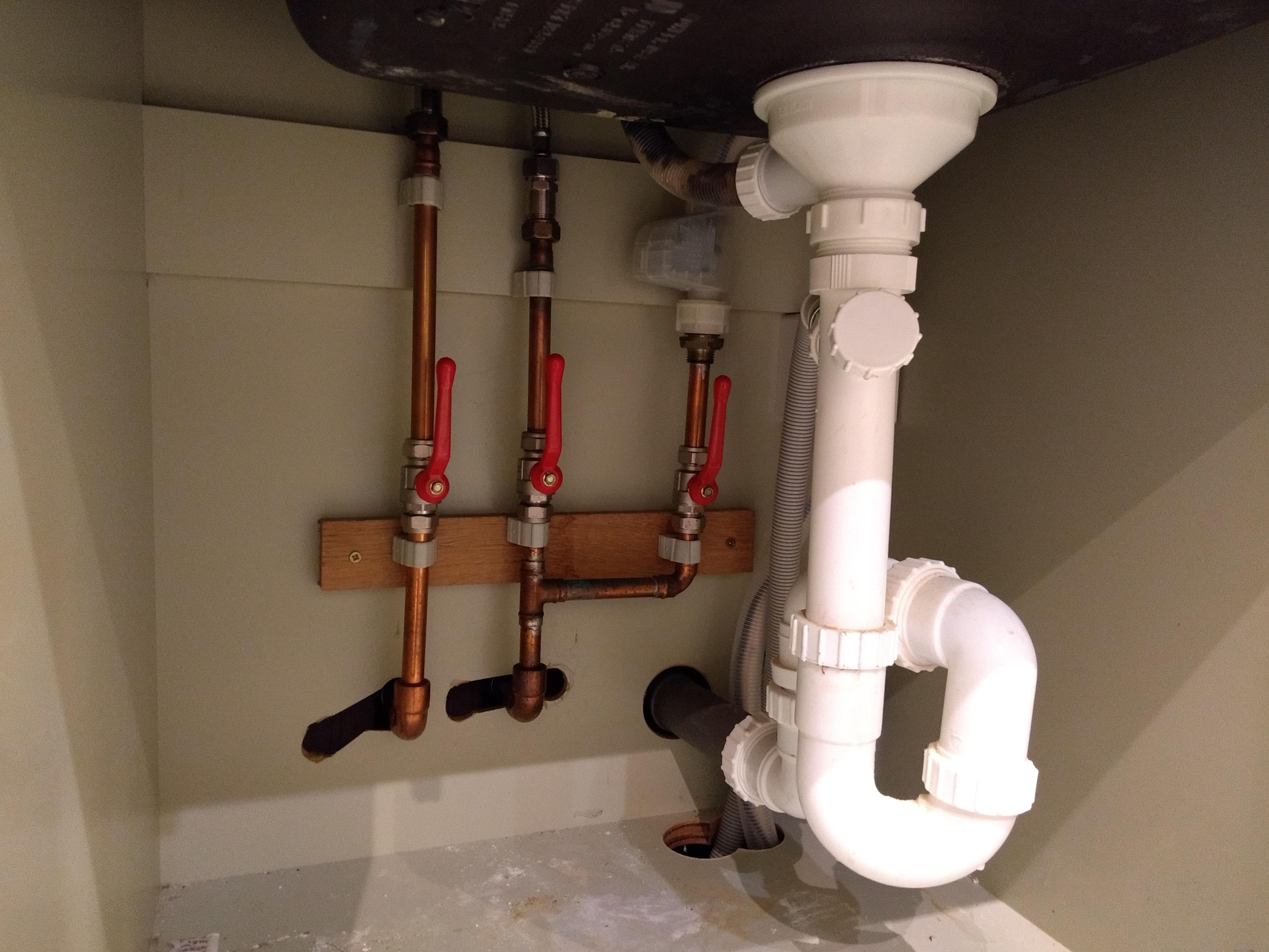

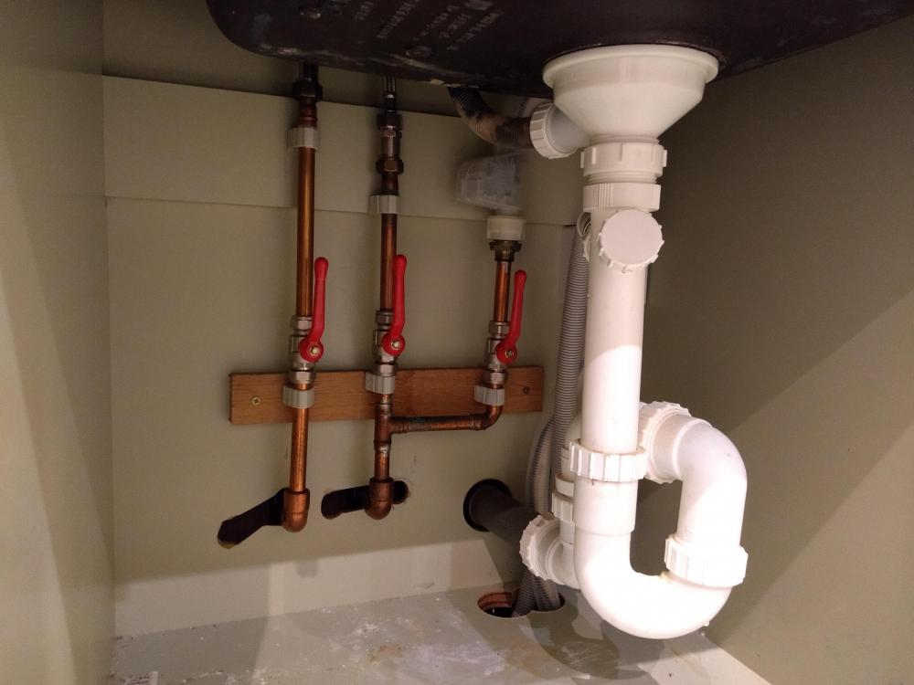

Temp Posted October 2, 2020 Share Posted October 2, 2020 I had similar issue. Just did it myself... Only bit I didn't do was drill the holes through the back.. Link to comment Share on other sites More sharing options...
