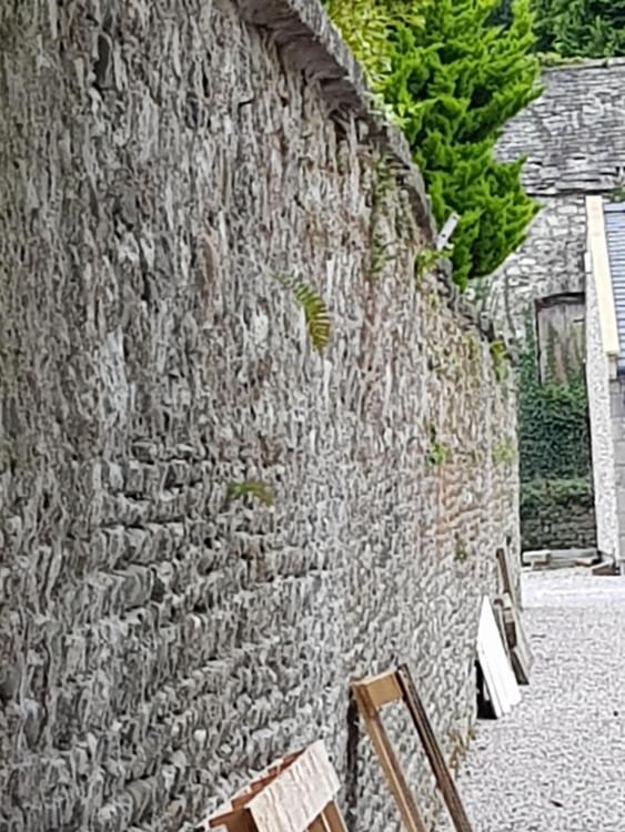

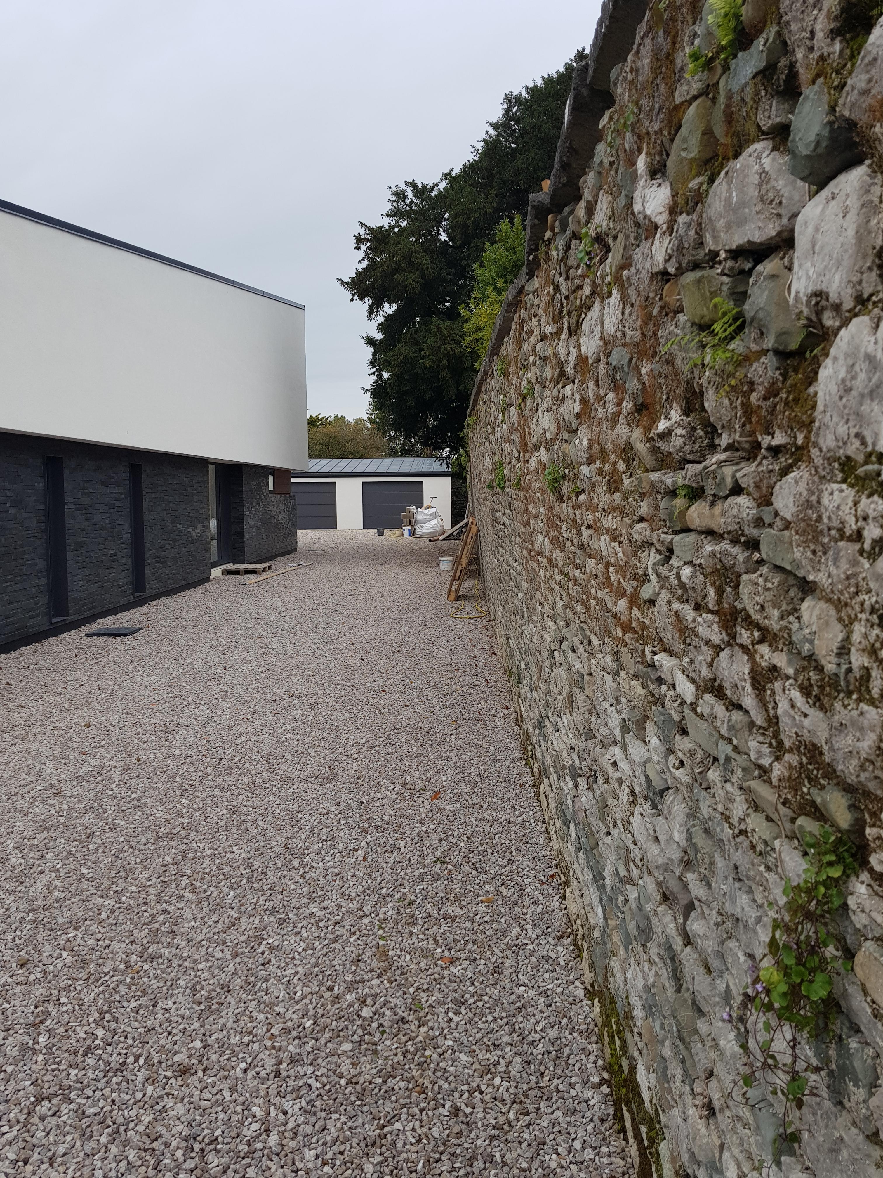

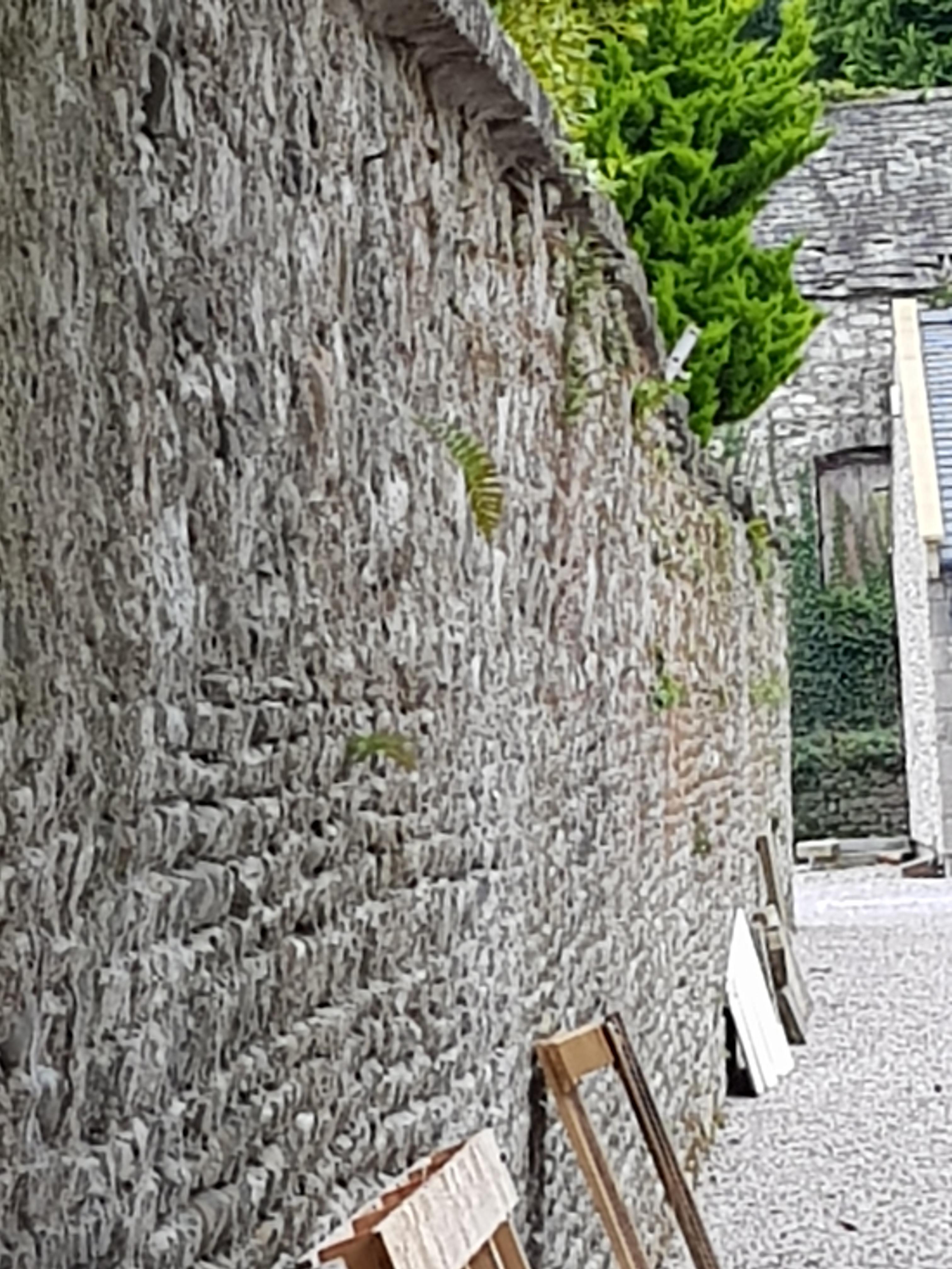

This wall is a dividing wall between us and the neighbours. As you can see it is a fairly substantial wall and very old. Over the years the houses on the other side have raised their ground levels and in some cases it is nearly a metre higher than on our side. The reason for the post is I think it is moving, albeit very slowly. I want to try and involve the neighbours in a nice way to try and avoid very costly repairs. The wall may never need repairing in our lifetime but if it does then I want to ensure that the neighbours are aware of the situation now and what will happen if the wall does need repairing in the future and they do not do anything to mitigate the pressure of the higher ground level on the other side.
I may add that the present neighbours are not responsible for the increase in ground level, it was previous owner's that did this.
I get on well with most of the neighbours except the one were the wall is leaning the most. I am prepared to go and see then to have a chat and then possibly get a solicitors letter so we have proof of contact stating that we think the pressure needs to reduced in order to prevent further movement of the wall.
Can anybody think of anything different without costing the earth in legal fees or really upsetting the neighbours? TIA

The neighbour I do not get on with had a bbq built 2 years ago right next to this wall and when I was doing some work on top of the wall recently I noticed that there is now a gap between the bbq and this wall of about 20mm. I understand I may have to set up some kind of monitoring device to prove we have degree of movement but just wondered what the best course of action would be.
Regarding the deeds, the conversation with our solicitor went something along the lines of " if you want me to spend alot of your well earned cash on determining who owns the walls then I will gladly do so but seen as they are probably over 200 years old I may never be able to give you a definitive answer" so we have left it and assume that if we have any problems in the future then the costs would be split evenly but not if we are not responsible for the wall leaning!

Good point about the bbq. All I would say is the bbq is at one end of the leaning section. When I look over the wall the bulging section almost follows the built up section of land on the other side and were the land is almost at the same level as our side there is no bulge.
