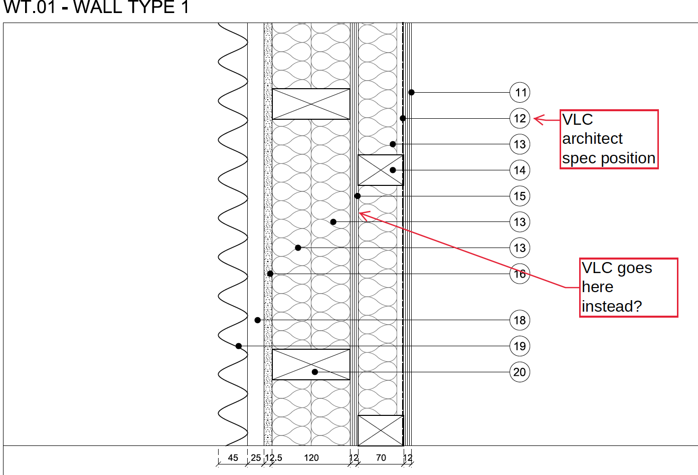

Tony C Posted September 24, 2020 Posted September 24, 2020 (edited) Hi, I have timber frame build up as : (exterior) 12.5mm sheathing 120mm C24 frame with 120mm celotex 12mm ply 70mm C24 for service with 60mm celotex VCL 12mm ply exposed interior (interior) Is this VCL location correct specified by architect? When I see the construction picture on the website, it looks like it goes just after the main timber frame, then add service studs on the VCL layer. Edited September 24, 2020 by Tony C
BMcN Posted September 24, 2020 Posted September 24, 2020 Where achitect specified. Normally it would be before service void but since your service void is filled with insulation it should go on the warm side of this. Is the insulation to be checked out for services to run in? 1
Tony C Posted September 24, 2020 Author Posted September 24, 2020 1 hour ago, BMcN said: Where achitect specified. Normally it would be before service void but since your service void is filled with insulation it should go on the warm side of this. Is the insulation to be checked out for services to run in? Thanks BMcN! What do you mean by "checked out" ? Do you mean the insulation is suitable? In this case VCL needs to be sealed with tapes the around the opening for the electric sockets and switches.
BMcN Posted September 24, 2020 Posted September 24, 2020 You have a 70mm service void but it's filled with celotex - where are you putting the service in? Are you cutting grooves in the celotex? Same goes for the electrical boxes.
ProDave Posted September 24, 2020 Posted September 24, 2020 I don't see that present 70mm as a service void, just an extra insulation later. I would put VCL where architect says, all nicely taped, then 25mm battens for a true service void then plasterboard. 1
A_L Posted September 24, 2020 Posted September 24, 2020 (edited) @Tony C, The VCL could be placed in either position. The deciding factor might be the number of penetrations of the VCL and the method of fixing the Celotex. Properly installed the foil surfaces of the Celotex have a greater vapour resistance than polythene vapour barriers with the usual penetrations and taped joints. Section 7.3 and 7.5 here https://insulation-uk.com/assets/5405_dry-lining_bba-certificate_nov2018.pdf Edited September 24, 2020 by A_L
Tony C Posted September 25, 2020 Author Posted September 25, 2020 Thank you A_L for the useful info! Between 120mm Structural studs would have tightly fitted celotex as it only has Rain water pipes in this void. Between 70mm Service studs, there would be a little less celotex avoiding the area of mains cable, gas, water pipes etc. This gap area to be covered with sheep wool. If I were to place VCL just after the 120mm Studs (the middle option), it will have less penetration. So this could be better option then?
A_L Posted September 25, 2020 Posted September 25, 2020 54 minutes ago, Tony C said: f I were to place VCL just after the 120mm Studs (the middle option), it will have less penetration. So this could be better option then? Whichever side of layer 15 (12mm ply) would give fewer penetrations.

ProDave Posted September 25, 2020 Posted September 25, 2020 Agreed this whole wall make up seems very strange. You do not want to be trying to partly insulate a service void. a service void should be there for services and does not need to be anything like 75mm. 25mm is plenty for cables and 45mm plenty for pipes. All services in an ideal world would be inside the sealed envelope so no penetrations through VCL except where services run outside e.g. to outside lights, sockets or an outside tap and these would be sealed. To even be thinking of sealing around switches etc is madness, you should not need to do that. It seems like your basic frame structure is too thin. use something thicker to get all the insulation you need within the frame, then a thin service void. the 12mm "ply" on the inside of the frame might be the racking layer in a case of externally clad timber frame. Mine is like that, except because we are considered "exposed" the SE specified 2 layers of 12mm OSB3 as the racking layer with staggered joints. Our VCL goes immediately over the racking layer, then the 25mm battens for the service void then the plasterboard.

Tony C Posted November 17, 2020 Author Posted November 17, 2020 On 25/09/2020 at 15:06, the_r_sole said: I know you didn't ask this, but what is the purpose of the inner 12mm plywood? Has the engineer asked for that? I asked SE and architect and now I am omitting this 12mm plywood. Architect thought it might be useful for securing the plumbing pipes etc !?
