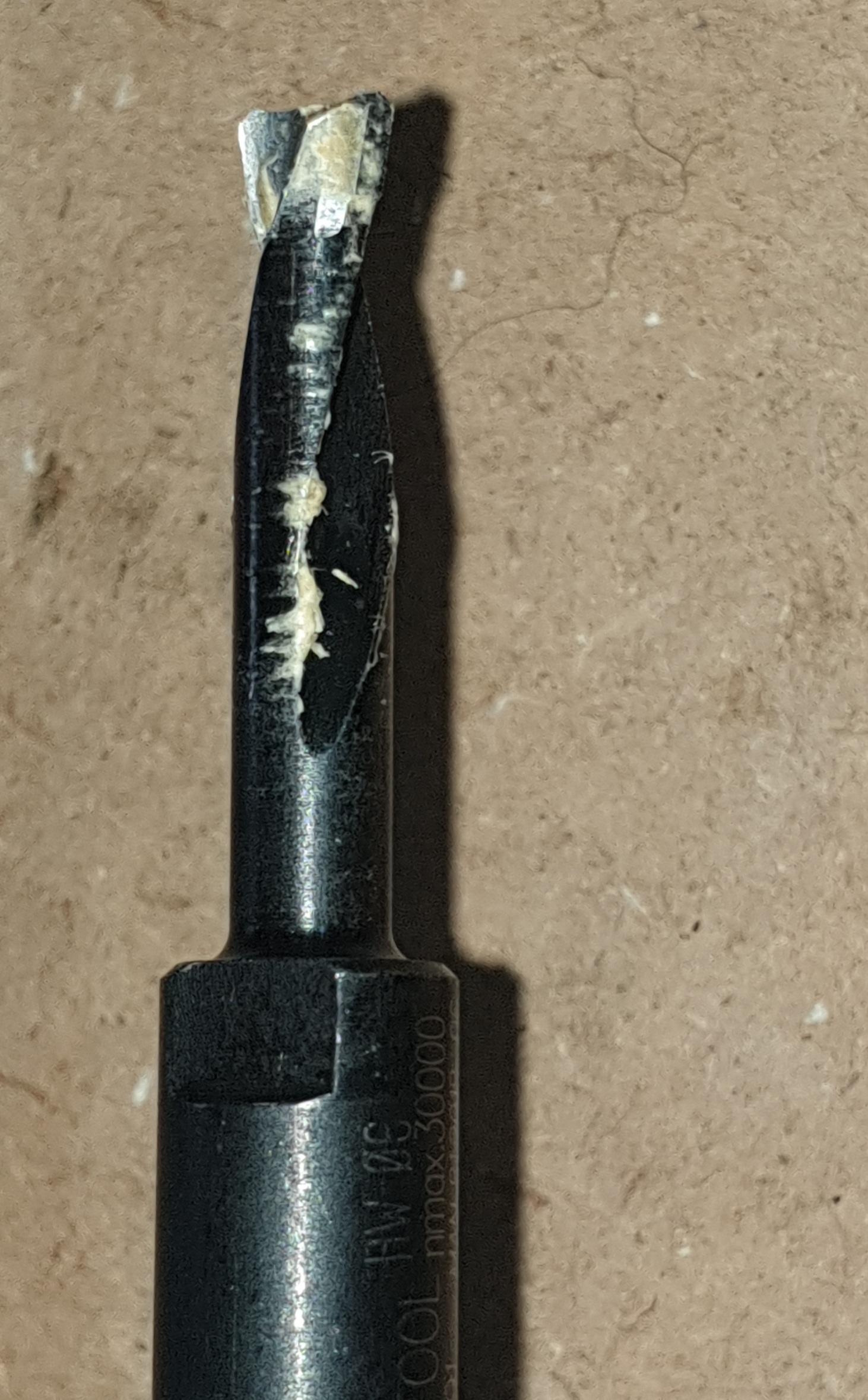

ToughButterCup Posted September 14, 2020 Share Posted September 14, 2020 Using a Domino cutter in siberian larch produces this.... After cutting just 6 slots.... Not good. Dust extraction on full thrutch . Is there anything I can coat the drill with to reduce the amount of cleaning I will need to do? Link to comment Share on other sites More sharing options...
Declan52 Posted September 14, 2020 Share Posted September 14, 2020 You tried vegetable oil or wd40 yet?? Link to comment Share on other sites More sharing options...
Oz07 Posted September 14, 2020 Share Posted September 14, 2020 Silicone spray. Sometimes makes it gum up more but the cutter or tool slides easier....Im not up to speed with the science https://www.google.com/aclk?sa=l&ai=DChcSEwiO6tXmnenrAhXIgFAGHQ5GCHEYABAdGgJkZw&sig=AOD64_2KqP3ORzDwPjdEdv4-kF9RdXxrtQ&ctype=5&q=&ved=2ahUKEwih9c7mnenrAhWSEMAKHdkLCz4Q9aACegUIDRDPAQ&adurl= Link to comment Share on other sites More sharing options...
ToughButterCup Posted September 14, 2020 Author Share Posted September 14, 2020 18 minutes ago, Declan52 said: You tried vegetable oil or wd40 yet?? Tried extra virgin, and butter. Warra friggin mess. 3 minutes ago, Oz07 said: Silicone spray.... like that stuff for push fit foul drains . Tomorrow is going to be like Turkish wrestling methinks. Link to comment Share on other sites More sharing options...
PeterW Posted September 14, 2020 Share Posted September 14, 2020 Turn the speed down on the router. And get some proper router cutter cleaner and lubricant. https://www.trenddirectuk.com/trend-sharpening-and-accessories/trend-lubricants-and-cutter-cleaning 1 Link to comment Share on other sites More sharing options...

ToughButterCup Posted September 15, 2020 Author Share Posted September 15, 2020 Yep. Made 5 meters worth so far today. Interesting variation in the slots created: some dry and clean as a whistle, others apparently 'wet' and jammed with sawdust. So I just have to bloward..... Link to comment Share on other sites More sharing options...
