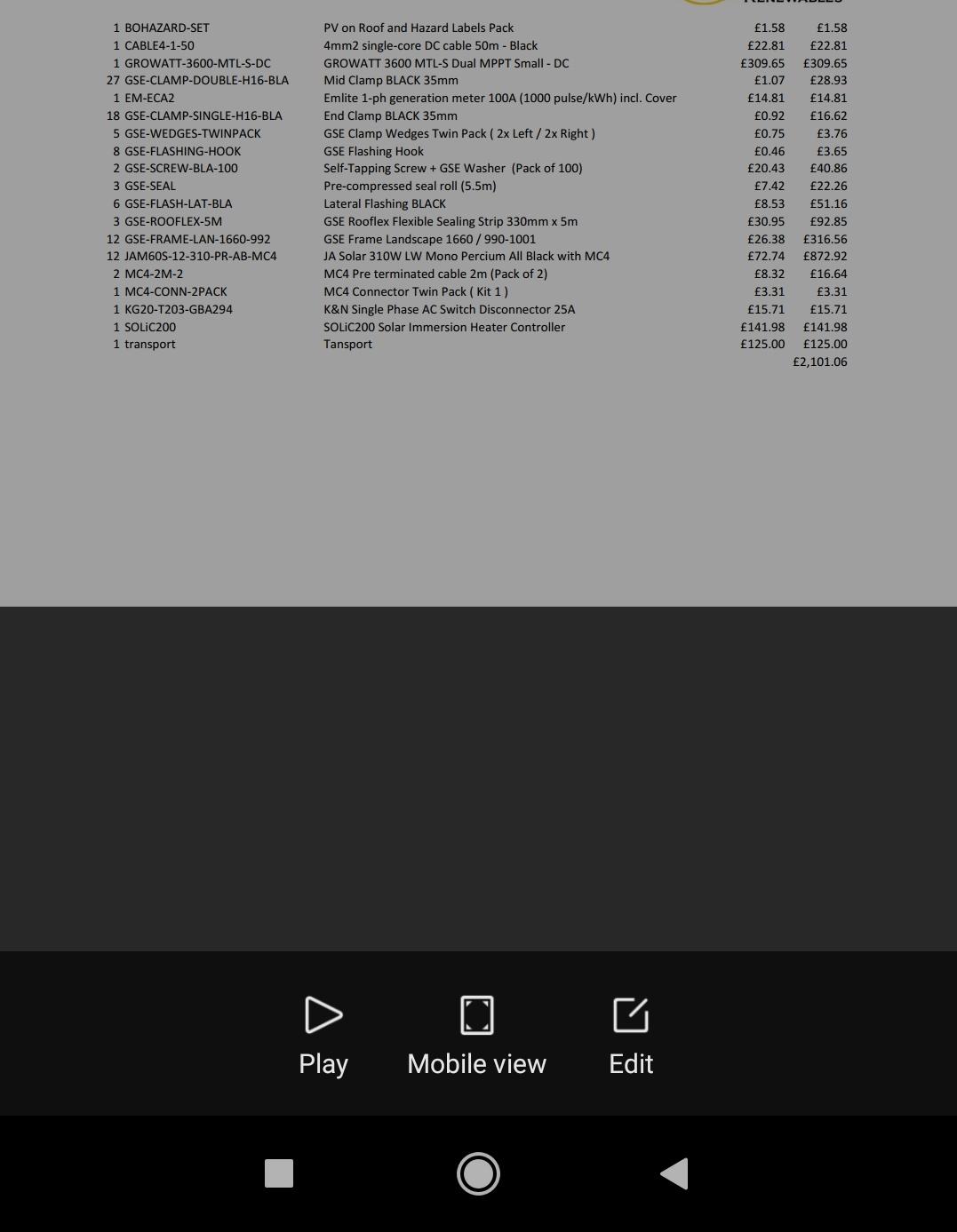

canalsiderenovation Posted September 11, 2020 Share Posted September 11, 2020 So, need to make a decision on which actual solar panels for our in roof system of 12 horizontal panels. It's either the JA Solar 310W LW Mono Percium All Black with MC4 or the JA Solar 320W Mono Percium LW Black Frame with MC4. Aside from the watt, there is difference in the panel itself as the 320w has a white backsheet and the 310w is black. Any advice on which I should choose. There is around a £50 difference with the 310w ones being more expensive so negligible. Link to comment Share on other sites More sharing options...
Dan F Posted September 11, 2020 Share Posted September 11, 2020 From the datasheets the panels look almost identical and only difference I can see is backsheet color and wattage. They have same temperature co-efficient and anual degredation at least from what I saw, which are two other things to look at when comparing panels. The color of the backsheet is purely aesthetic, 1 Link to comment Share on other sites More sharing options...
canalsiderenovation Posted September 11, 2020 Author Share Posted September 11, 2020 (edited) 8 minutes ago, Dan F said: From the datasheets the panels look almost identical and only difference I can see is backsheet color and wattage. They have same temperature co-efficient and anual degredation at least from what I saw, which are two other things to look at when comparing panels. The color of the backsheet is purely aesthetic, Thanks @Dan F it makes more sense I guess to go for the 320w then I guess. The quote is with a Growatt 3600 inverter and Solid 200 immersion controller. Edited September 11, 2020 by canalsiderenovation Link to comment Share on other sites More sharing options...
Dan F Posted September 11, 2020 Share Posted September 11, 2020 How much are the 310W all-black panels? We're about to put an order in for 360W all-black panels at about £180.. Link to comment Share on other sites More sharing options...
canalsiderenovation Posted September 11, 2020 Author Share Posted September 11, 2020 1 minute ago, Dan F said: How much are the 310W all-black panels? We're about to put an order in for 360W all-black panels at about £180.. This is the quote, the 320w ones are cheaper. Link to comment Share on other sites More sharing options...
