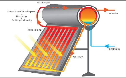

Triassic Posted September 6, 2020 Share Posted September 6, 2020 Here’s a bit of a challenge! I’ve been asked to prepare a design brief for an off grid toilet block on a Scout camp. I’m thinking a concrete raft, block walls, pitched roof, containing 4 self contained toilets with wash sink in each. As it’s off grid I’m struggling to come up with a design for the hot water. Anyone got any suggestions? Link to comment Share on other sites More sharing options...
pdf27 Posted September 6, 2020 Share Posted September 6, 2020 (edited) Does it actually need hot water, or is it just a case of "would be nice"? If it's a bit optional then an all-in-one solar system is probably a good bet. I'm assuming that most scout camping is in reasonable weather, and it'll be shut down in winter - this would be a doddle to drain down and cover over for the winter. Edit: clearer image Edited September 6, 2020 by pdf27 1 Link to comment Share on other sites More sharing options...
PeterW Posted September 6, 2020 Share Posted September 6, 2020 LPG instant hot water heater. If you get one such as the ones used on a canal boat they only need a 12v supply that you can provide using a couple of leisure batteries and a solar panel on the roof keeping it all topped up. Morco and Rinnai are makes to look out for. 1 Link to comment Share on other sites More sharing options...

ProDave Posted September 6, 2020 Share Posted September 6, 2020 One of my more unusual jobs was wiring a public toilet on an off the beaten track location. It was a composting toilet, and the wiring consisted of a 12V battery charged by a solar panel and a small wind turbine, to power a fan to ventilate the toilet, and power an LED light on a motion sensor. the silly thing was building control still insisted on an EIC for the wiring. So something like that and an LPG instant water heater, think caravan equipment. Something like we have in the static caravan that will do up to 10kW water heating. Ours was a Morco. 1 Link to comment Share on other sites More sharing options...
Triassic Posted September 6, 2020 Author Share Posted September 6, 2020 Thanks for all the great suggestions. LPG and 12v lights etc sounds like a workable solution. Link to comment Share on other sites More sharing options...
