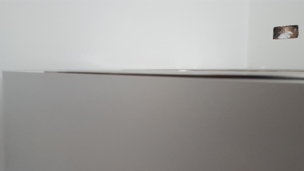

We've opted for a Franke Ariane ARX160 1.5 bowl undermount sink which is to be topped with a 30mm quartz worktop...

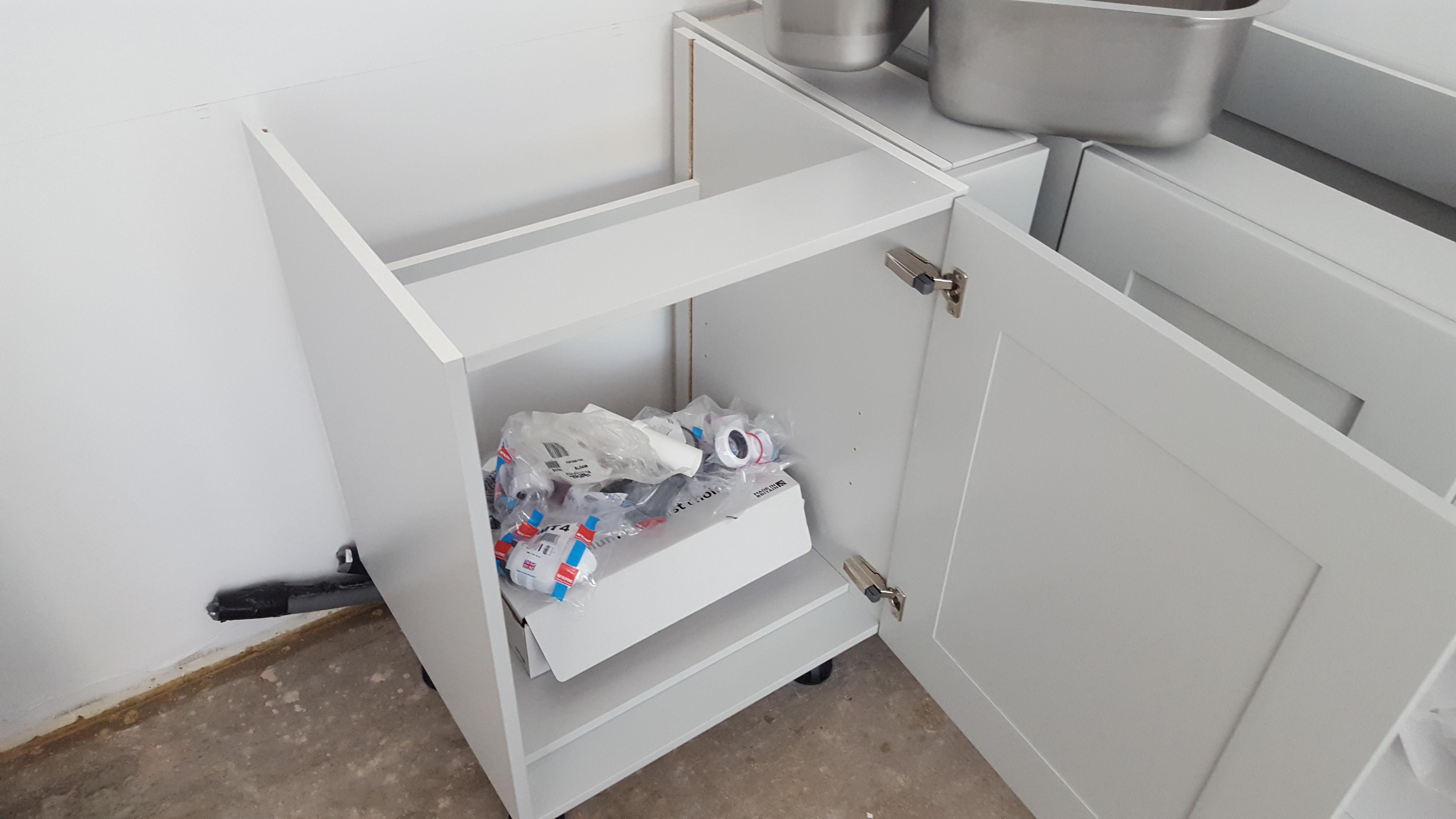

It'll be sitting inside a 600mm wide unit (the minimum specified by Franke):

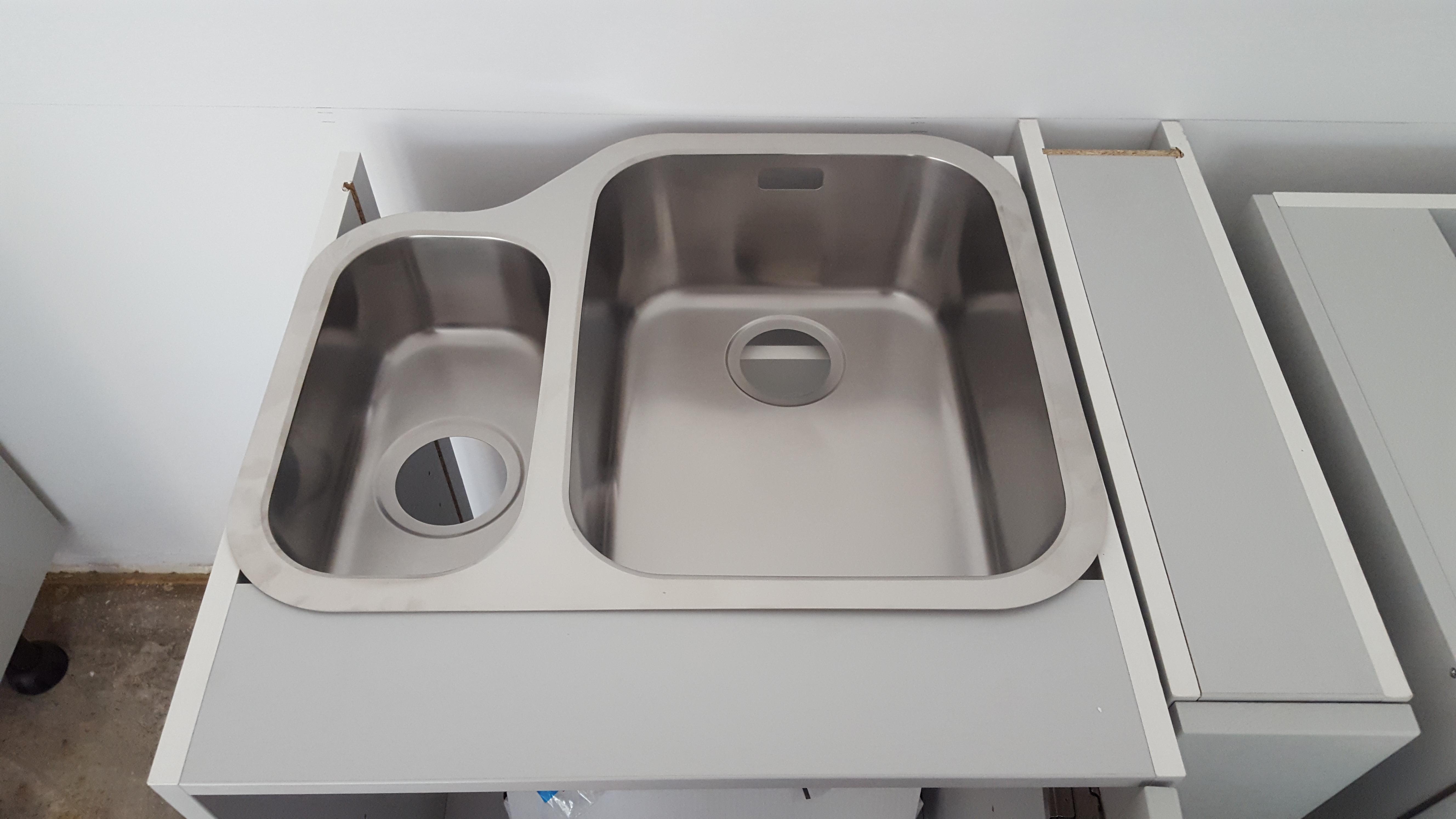

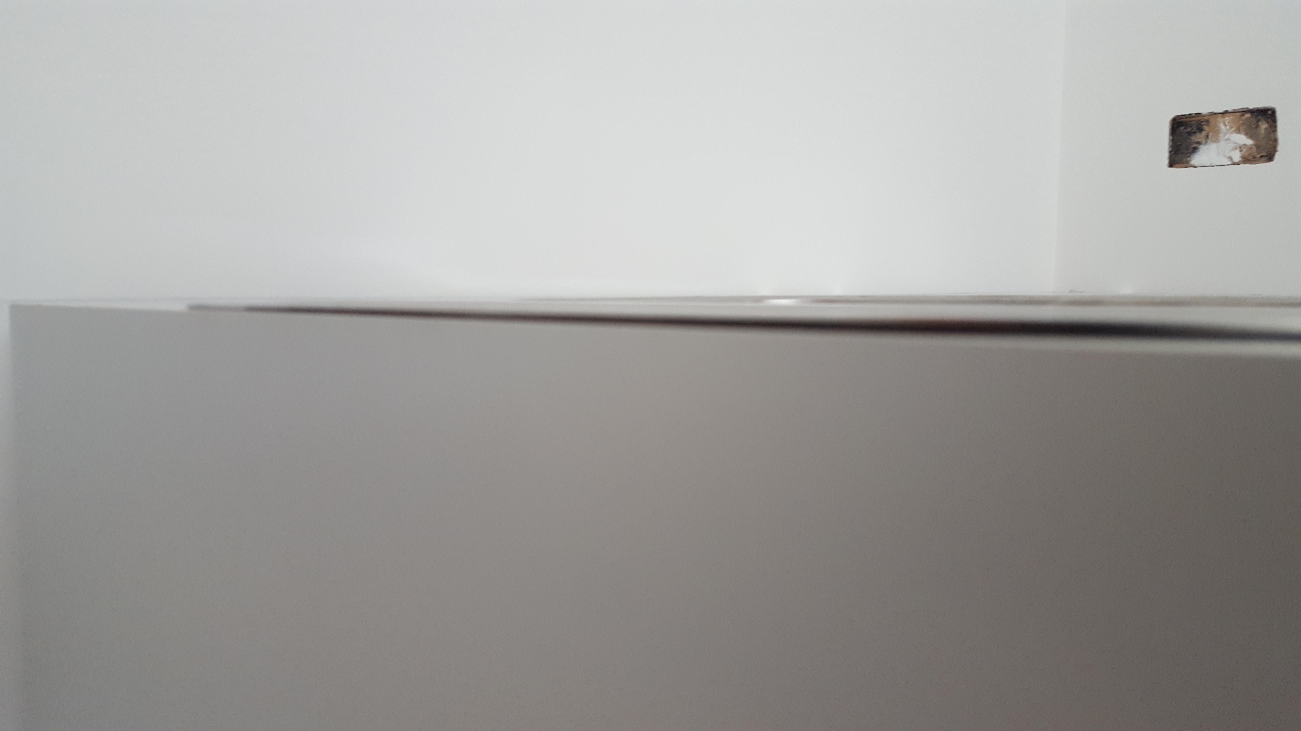

The issue I would welcome some help with is that the sink is also 600mm wide and it sits proud of the side panels (and also fouls the front bar but that's a straightforward fix to allow it so come forward a bit) and thus needs lowering to allow the quartz worktop to sit flush across it and neighbouring units:

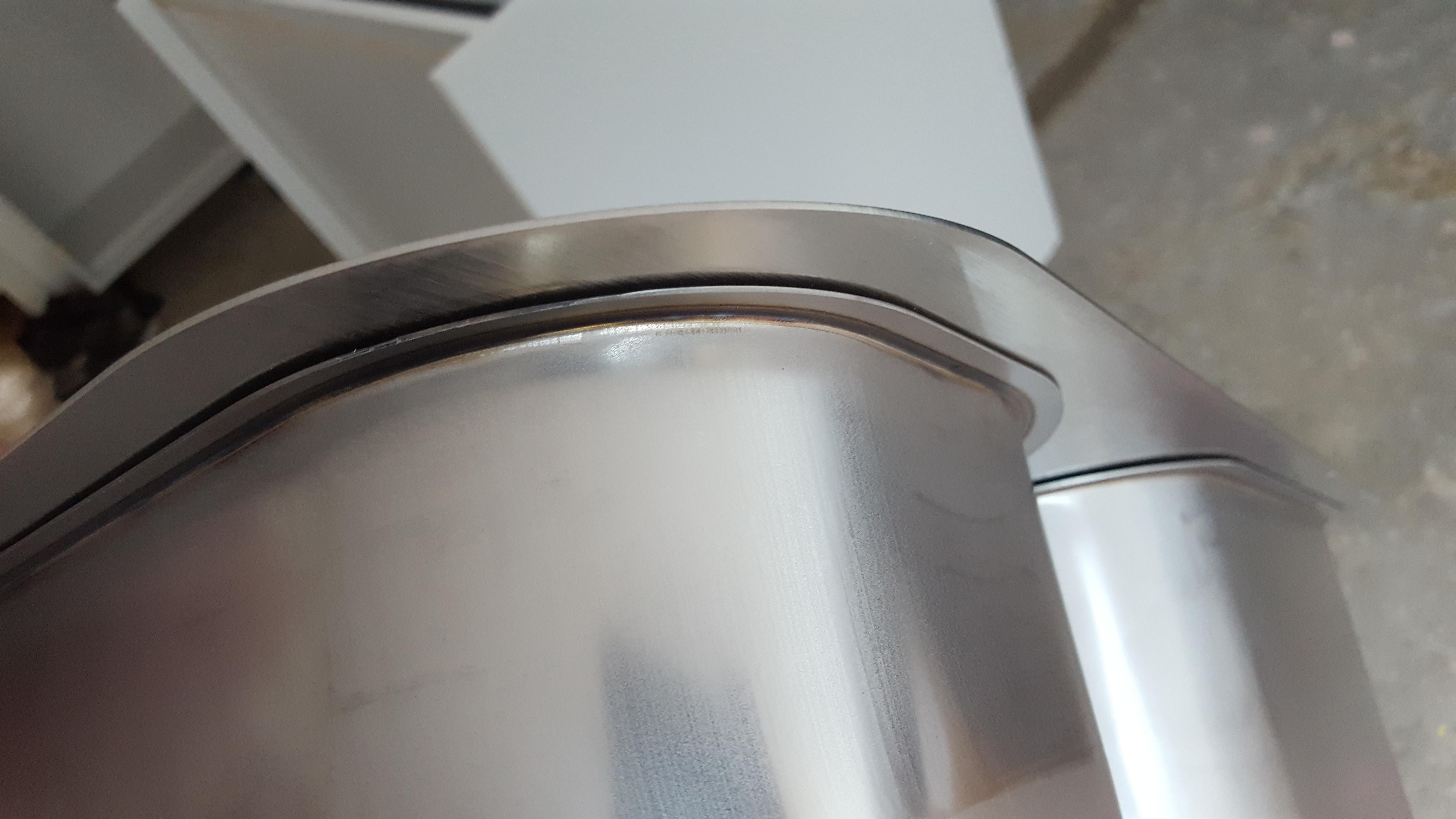

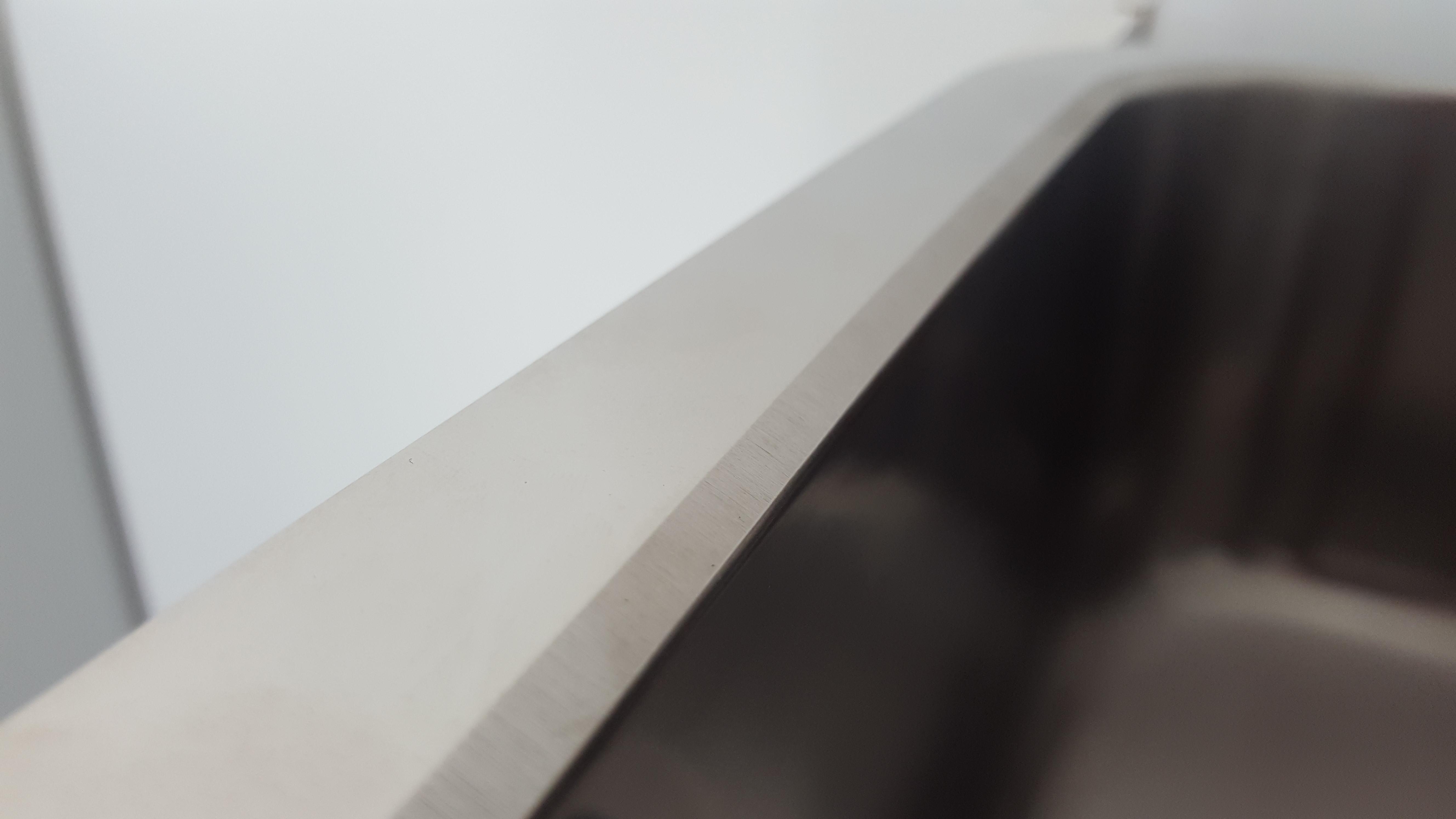

It sits around 2-3mm high, and the sink appears to be a dual-skinned and there's some variability in overall thickness:
Any suggestion how best to deal with this? I was thinking of just rebating the top of the panels to a sufficient depth, whether with a router or (preferably due to lack of routing experience) my multitool with some timber clamped either side to guide the blade?

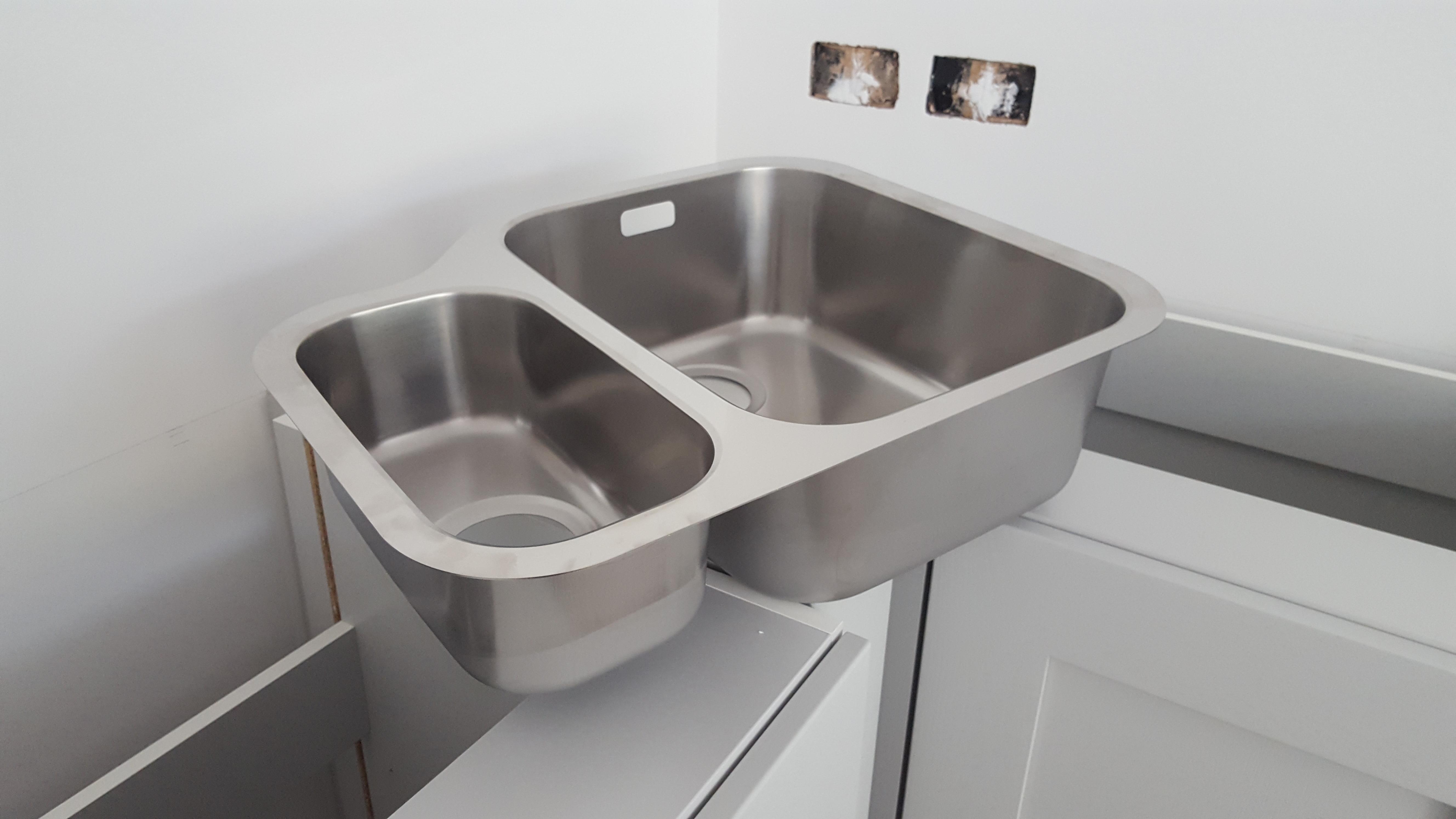

On a related subject, I wasn't sure how much support a sink actually requires - I think it comes with only four clips to mount it (to a timber worktop at least) so perhaps doesn't need much, and I'm sure I've heard of them being siliconed into place directly to the underside of stone worktops with nothing beneath them. That aside, I did think I might fit a baton across the cupboard immediately under the large sink bowl thus adding a bit of support and stability to replace that which I might compromise from hacking the unit down. To the left if this unit will be an integrated dishwasher and so it's not like it can depend on a neighbouring cupboard for strength.
Anyone been here before?

I’ve router the unit down by a couple of mm so the sink is flush with the top of the unit (don’t have to be too careful as you can secure it will silicon if you want. Then I siliconed the sink to the bottom of the work top.
(I mean routered where the sink is only... not the whole unit)
Edited by Gav_P
Been there a thousand times. Used to own a kitchen company..... First you need to cut out most of the front bar . If you have got 20mm doors ? you will want a 30mm overhang on the worktop.You need the drop of the bowl to be between 70 and 100 mm from the front of the worktop. Anymore, and you will be reaching, and bending into the sink. Cut away the front bar to 30mm, then use a router to rebate the sides, and what remains of the front bar. Drop the sink in, on silicon, and aim to get it flush with the top of the cab. The sink will be fully supported by the sides of the cab, so no bar underneath required. IMO, get the stone top overhanging the drop of the bowl by 5mm.

P.S. get the back of that sink unit out or you are never gonna get the tap connected.
Speak to your worktop supplier before you do anything.
Some are happy to have the sink mounted to the unit and then sit the worktop over it.  Ours were not.  Ours the sink is hung from the worktop without getting any support from the unit, which of course means it is in a sink unit large enough to do that.  Your sink unit is not.
+1 to cut the back out of the sink unit for access to the taps, this is what i did:

Can i ask why there were not happy. The only sinks i have ever seen fall off are the ones held up under stone on those poxy little clips.
Okay, thanks, I can do all that. So you are saying I should secure the sink in place before the worktop fitters come?

I guess (they did not give a reason) if the sink was in place and fixed first, then getting the hole in exactly the right place is one more thing to get exactly right.
Basically they said they would not do it that way, and as they were the only stone supplier and fitter in town, I could not just go somewhere else who would fit it a different way.
They threw away the silly clips supplied with the sink, and epoxied on some different fittings that they supplied.
If your stone supplier is happy then I see nothing wrong with fitting it as you suggest, I am just saying check with your stone supplier.

Looking closer at the sink there is a bevelled edge which I am wondering might not lend itself well to having the worktop hanging over it due to the risk of it being a dirt trap?
Perhaps it could be filled with silicone, although it'd have to be out of a tube or via another application method as a conventional gun and tube wouldn't fit inside the sink to get the right angle.

It was more the bevelled edge bit that I was thinking about, but I am sure that could be filled afterwards with a tube of silicone.
