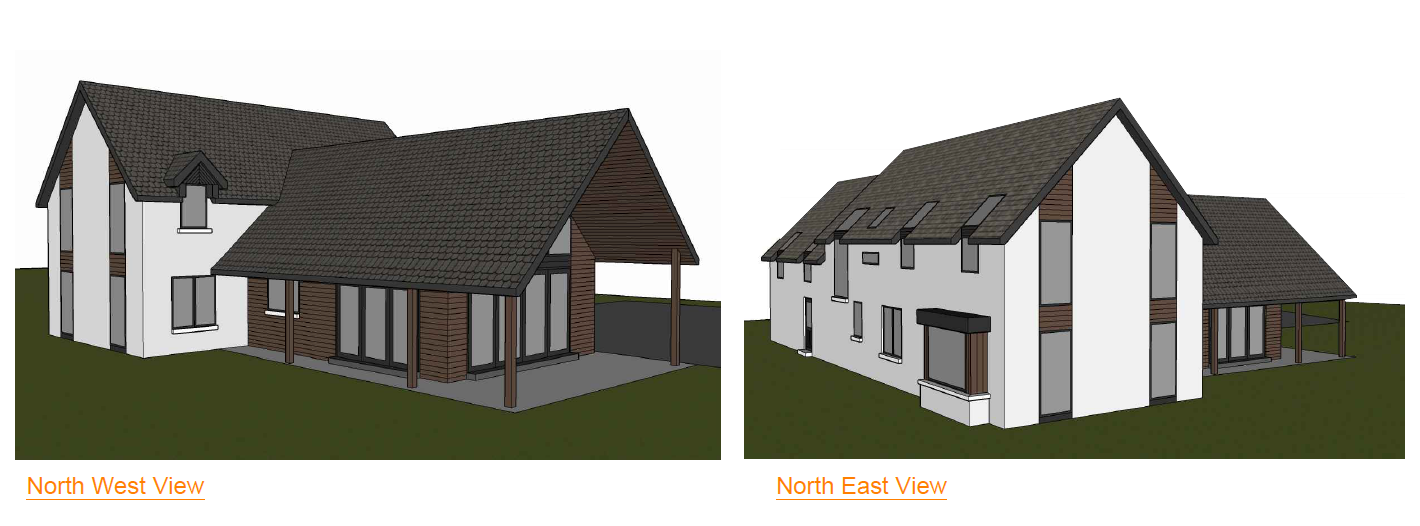

mattp22 Posted August 27, 2020 Share Posted August 27, 2020 Hi, I'm building a house in Scotland using SIP construction for insulation quality, airtightness and speed of build. Plan is to clad in larch externally like image below. But speaking to several mortgage companies who will take on the long term mortgage (after self-build mortgage finishes in 9 months) it seems most are very wary of SIP construction with only timber cladding. A couple of highstreet lenders have said it's a 'possibility' (halifax and santanter) but most want masonry external skin. If i go to non-highstreet lender who are more understanding of purely timber SIP build the interest rate seems to be more like 4% rather than 2% so it makes a major difference to mortgage payments. I've therefore decided (just to satisfy mortgage lender) to add a middle skin of lightweight concrete block between SIP frame and larch cladding. My question is do you think the concrete block can be left painted black behind the larch, or will i need a more substantial finish on the concrete block because the larch installation has such large gaps (15/20mm spacing). I don't want to have issues with moisture travelling through the masonry and condensing on the SIP or at soleplate. Very frustrating to have to add the totally unnecessary masonry but over 5 years i calculate mortgage saving will be around £10k and i think block cost will be around £5k. Thanks. Link to comment Share on other sites More sharing options...
Carrerahill Posted August 27, 2020 Share Posted August 27, 2020 You are going to end up with a substantial house here, so although you are appealing to bankers who don't really get this building with SIPs deal you are also getting to my mind the best of both worlds. So what is your planned make-up? Sip panel wrapped in a membrane then a cavity then block skin? In terms of how you end up cladding the block I would be thinking of the following: Whatever I cover the block in will not be easily repaired or replaced - full cladding off job, so it needs to last. If I paint it, it may flake and bubble in 5-10 years, where does that leave me? If I fix treated battens or possibly galvanised metal etc. to the block with good quality fixings then membrane over that, as long as I use one of these exposed membranes that you often see behind cladding like this then the inner structure is going to be protected and the "consumable" aspect is just the larch and membrane (it will need to be designed for full life exposure, i.e. UV stable) which can be changed out every 30-50 years. I would also be thinking about alternatives, possibly longer lives alternatives. I would also consider having the membrane in direct contact with the block, then stained black battens over the top (like a roof make-up) as this would also mean the membrane didn't get as much moisture coming into contact with it, which could then sit directly behind the cladding and would let the cladding dry out quicker. I have seen this done so many ways from log cabins we have stayed in to modern architectural wonders in the city centre with cladding and I am always that guy poking about looking to see how it was done and have so far never seen "the way" as there seems to be many. Use black bricks! Link to comment Share on other sites More sharing options...

LA3222 Posted August 27, 2020 Share Posted August 27, 2020 29 minutes ago, Temp said: The problem is that there is nobody certifying or approving non traditional construction techniques for life expectancy. What do you mean by certifying? I had no trouble getting a warranty from Protek for my build, likewise I had no issue getting a self build mortgage for it. I have yet to seek a remortgage with a high street bank but maybe I'll hit some walls there?♂️ I have SIP with block outer skin - from what I've read (briefly!) leads me to believe its the amount of timber in a build which adversely affects lenders perceptions I.e. a TF clad in timber not good, TF with masonry outer skin much better perceived? Anyway, off topic slightly - @mattp22 I cant advise on the membrane but I think you've made the right choice to use block outer skin. I have wrapped my SIP build in rendered block. I do have a side abutment which I intend to clad with cedral click onto the blockwork buts it more straightforward than ypur job as i won't have shadow gaps to contend with. As suggested, battening and then wrapping sounds like the best way forward. Link to comment Share on other sites More sharing options...
mattp22 Posted August 27, 2020 Author Share Posted August 27, 2020 46 minutes ago, Carrerahill said: You are going to end up with a substantial house here, so although you are appealing to bankers who don't really get this building with SIPs deal you are also getting to my mind the best of both worlds. So what is your planned make-up? Sip panel wrapped in a membrane then a cavity then block skin? In terms of how you end up cladding the block I would be thinking of the following: Whatever I cover the block in will not be easily repaired or replaced - full cladding off job, so it needs to last. If I paint it, it may flake and bubble in 5-10 years, where does that leave me? If I fix treated battens or possibly galvanised metal etc. to the block with good quality fixings then membrane over that, as long as I use one of these exposed membranes that you often see behind cladding like this then the inner structure is going to be protected and the "consumable" aspect is just the larch and membrane (it will need to be designed for full life exposure, i.e. UV stable) which can be changed out every 30-50 years. I would also be thinking about alternatives, possibly longer lives alternatives. I would also consider having the membrane in direct contact with the block, then stained black battens over the top (like a roof make-up) as this would also mean the membrane didn't get as much moisture coming into contact with it, which could then sit directly behind the cladding and would let the cladding dry out quicker. I have seen this done so many ways from log cabins we have stayed in to modern architectural wonders in the city centre with cladding and I am always that guy poking about looking to see how it was done and have so far never seen "the way" as there seems to be many. Use black bricks! Thanks for your comments. Construction will be 160mm SIP kit, membrane, 50mm cavity, 100mm lightweight block, something black, 18mm batons then 22mm horizontal larch . That link to Proctor Group is great- i've been looking for weeks and hadn't found anything but that product sounds good. Paint flaking was a concern for me too. Ideally larch will be nailed on to batons so yes would be impratical to remove every 5-10 years to paint the blockwork. I had considered corrugated black steel on to blockwork then batons then larch, but i think the mortgage lender will get spooked with use of larch + steel sheet. I could use the Proctor membrane on top of corrugated panel to conceal it i suppose and lender will be none the wiser. Proctor membrane straight on to masonry sounds like the way to go, using black batons to secure membrane down, but Proctor data sheet says 5000 hours UV tested which is only 208 days direct sun. Obviously UV resistance not applicable at night time, and the gaps between larch only 18mm so gap for UV to penetrate is small and position of sun will make angle of 'attack' tight, but still doesnt sound like the Proctor product will be much better than 5-10 years expectancy like paint option. I'll email them to ask rather than blethering here! black bricks are nice- but too expensive unfortunately to then be covered by larch Link to comment Share on other sites More sharing options...
mattp22 Posted August 27, 2020 Author Share Posted August 27, 2020 9 minutes ago, LA3222 said: What do you mean by certifying? I had no trouble getting a warranty from Protek for my build, likewise I had no issue getting a self build mortgage for it. I have yet to seek a remortgage with a high street bank but maybe I'll hit some walls there?♂️ I have SIP with block outer skin - from what I've read (briefly!) leads me to believe its the amount of timber in a build which adversely affects lenders perceptions I.e. a TF clad in timber not good, TF with masonry outer skin much better perceived? Anyway, off topic slightly - @mattp22 I cant advise on the membrane but I think you've made the right choice to use block outer skin. I have wrapped my SIP build in rendered block. I do have a side abutment which I intend to clad with cedral click onto the blockwork buts it more straightforward than ypur job as i won't have shadow gaps to contend with. As suggested, battening and then wrapping sounds like the best way forward. i think with rendered block outer skin you should be fine with highstreet lender and thus lower % rate. My mortgage broker has spoken to about 20 lenders and it seems with masonry element then about half are happy with SIP construction. Timber cladding on masonry reduces pool further though but that's the look we want (and Planners!) Last time i spoke to Protek they wanted £5k for my warranty but that was without masonry element, timber only construction. Hopefully they'll reduce it a bit now. Was your SIP kit BBA approved if you don't mind me asking? I am probably using a company in Fife for kit but they are not BBA approved (yet) and i'm a bit wary of consequences. Link to comment Share on other sites More sharing options...

mattp22 Posted August 27, 2020 Author Share Posted August 27, 2020 44 minutes ago, the_r_sole said: That's adding a big cost onto a build there, worth pricing out the new build up and seeing how long the "payback" is? What broker are you using? And have you spoken to any other brokers? not sure i've got an option unfortunately if comments from lenders are to believed. i've not costed for the blockwork accurately yet but have estimated £6k inc. labour for 160 sq mtrs (based on several online calculators). In terms of mortgage savings- around 2% rate from highstreet lender should be possible given location, non-trad construction and loan to value. Specialist lender who would accept SIP + cladding with no masonry would be 3% if lucky but closer to 4% in reality, and construction type would deter re-sale if i ever had to move. Over 5 years that would cost me an extra £8k @ 3% or £16k @ 4% in repayments so makes sense to go for blockwork now even if it is hugely frustrating and unnecessary. Broker i've used for several mortgages and she has really done a lot of leg work on this construction method for me. Link to comment Share on other sites More sharing options...
mattp22 Posted August 27, 2020 Author Share Posted August 27, 2020 50 minutes ago, Mr Punter said: Would cement based cladding be of interest? thanks, and it is something we looked at, but not quite the style we're after. PP is for larch cladding too. Link to comment Share on other sites More sharing options...
Mr Punter Posted August 27, 2020 Share Posted August 27, 2020 How deep is the SIP? Does it need any extra insulation? I am just trying to work out the overall wall thickness. I would rather be in your place during a severe storm than with rainscreen cladding supported by SIP panels. Link to comment Share on other sites More sharing options...
mattp22 Posted August 27, 2020 Author Share Posted August 27, 2020 2 minutes ago, Mr Punter said: How deep is the SIP? Does it need any extra insulation? I am just trying to work out the overall wall thickness. I would rather be in your place during a severe storm than with rainscreen cladding supported by SIP panels. SIP is 169mm, 0.2 w/M2. I understand with blockwork and cavity this will drop to around 0.16 w/M2. We were going to increase panel thickness/ insulation anyway which added £2k to SIP cost, but no need now that we're adding blockwork- so the £2k can be taken off blockwork cost i guess. good point about protection in a storm, it's not like we're 10 metres from the Atlantic, oh.. no.. wait minute... Link to comment Share on other sites More sharing options...
