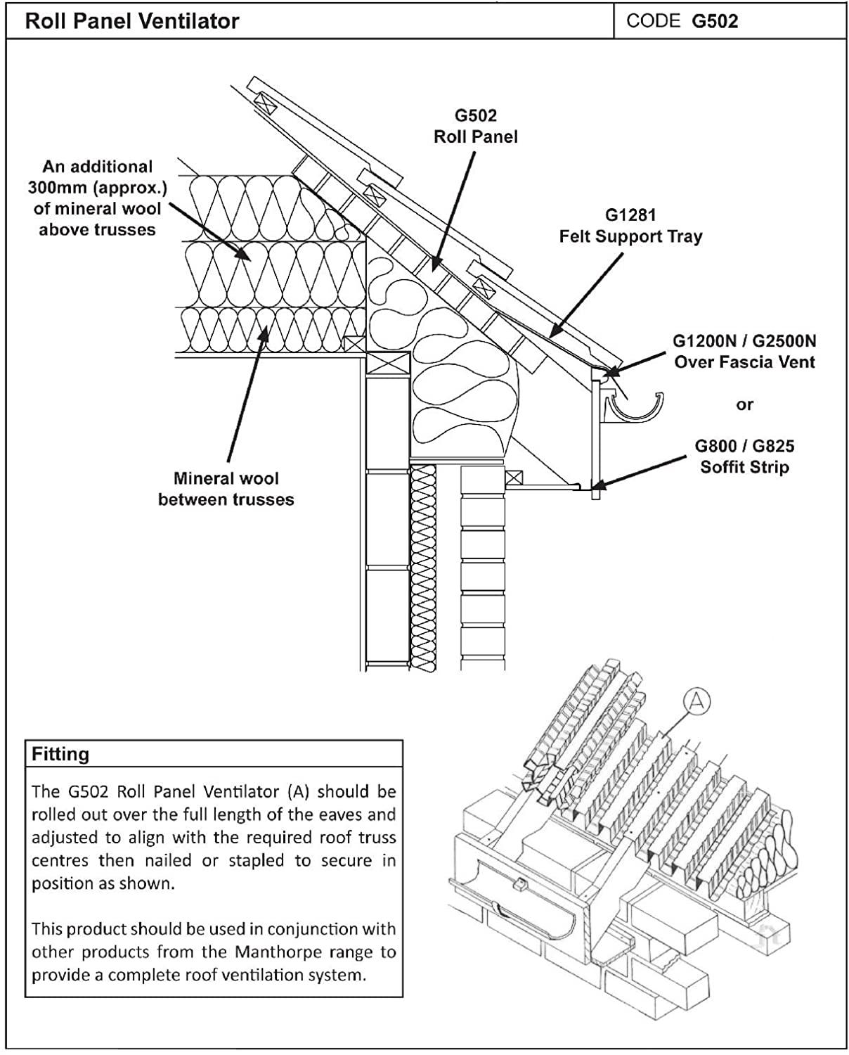

epsilonGreedy Posted August 25, 2020 Share Posted August 25, 2020 I have been delaying trying to get my head around roof space ventilation. There seems to be a prevailing assumption that a modern house requires a ventilated ridge but I do not see these on some new builds near me. Digging deeper I have read that my 30 degree pitch slate roof with hipped ends can meet building regs with just eave ventilation. https://www.wienerberger.co.uk/content/dam/wienerberger/united-kingdom/marketing/documents-magazines/technical/UK_MKT_DOC_TEC_ROF_SAN_Dr_John_notes_roof_space_vent_001.pdf If a put some effort into meeting the "well sealed ceiling" criteria, is a ventilated ridge an avoidable complication? p.s. I am likely to end up with wooden boxed eaves with a 9" to 12" overhang. p.s. The underlay will be conventional felt and battens. Link to comment Share on other sites More sharing options...

Temp Posted August 25, 2020 Share Posted August 25, 2020 (edited) Depends where the roof insulation is. If it's on the floor of the loft you only need eaves ventilation and tunnels to keep it open. If its between the rafters you might need ridge ventilation if the membrane isn't vapour permeable (I think if the membrane is vapour permeable you dont need any ventilation). Edited August 25, 2020 by Temp Link to comment Share on other sites More sharing options...

epsilonGreedy Posted August 25, 2020 Author Share Posted August 25, 2020 14 minutes ago, Temp said: Depends where the roof insulation is. If it's on the floor of the loft you only need eaves ventilation and tunnels to keep it open. If its between the rafters you might need ridge ventilation if the membrane isn't vapour permeable (I think if the membrane is vapour permeable you dont need any ventilation). Thanks it is a cold attic space with insulation at ceiling joist level. I have not made a decision in vapour permeable felt yet. Depending on slater availability the felt might be exposed to the elements for a month or two. I assume an old fashioned impermeable felt is tougher? Link to comment Share on other sites More sharing options...

Temp Posted August 25, 2020 Share Posted August 25, 2020 (edited) 26 minutes ago, epsilonGreedy said: Thanks it is a cold attic space with insulation at ceiling joist level. So the main thing to avoid is insulation blocking the ventilation at the eaves. There are products like this Roll Panel designed to prevent it.. https://www.google.com/search?q=eaves+ventilation+roll+panel&client=tablet-android-samsung-nf-rev1&prmd=sinv&sxsrf=ALeKk02fV26W0P4UCVa6FKBEdZmYUStI2Q:1598367385098&source=lnms&tbm=isch&sa=X&ved=2ahUKEwj9-NXBzrbrAhUCQEEAHThkBGQQ_AUoAnoECAsQAg&biw=1280&bih=800&dpr=1.5 Edited August 25, 2020 by Temp Link to comment Share on other sites More sharing options...
