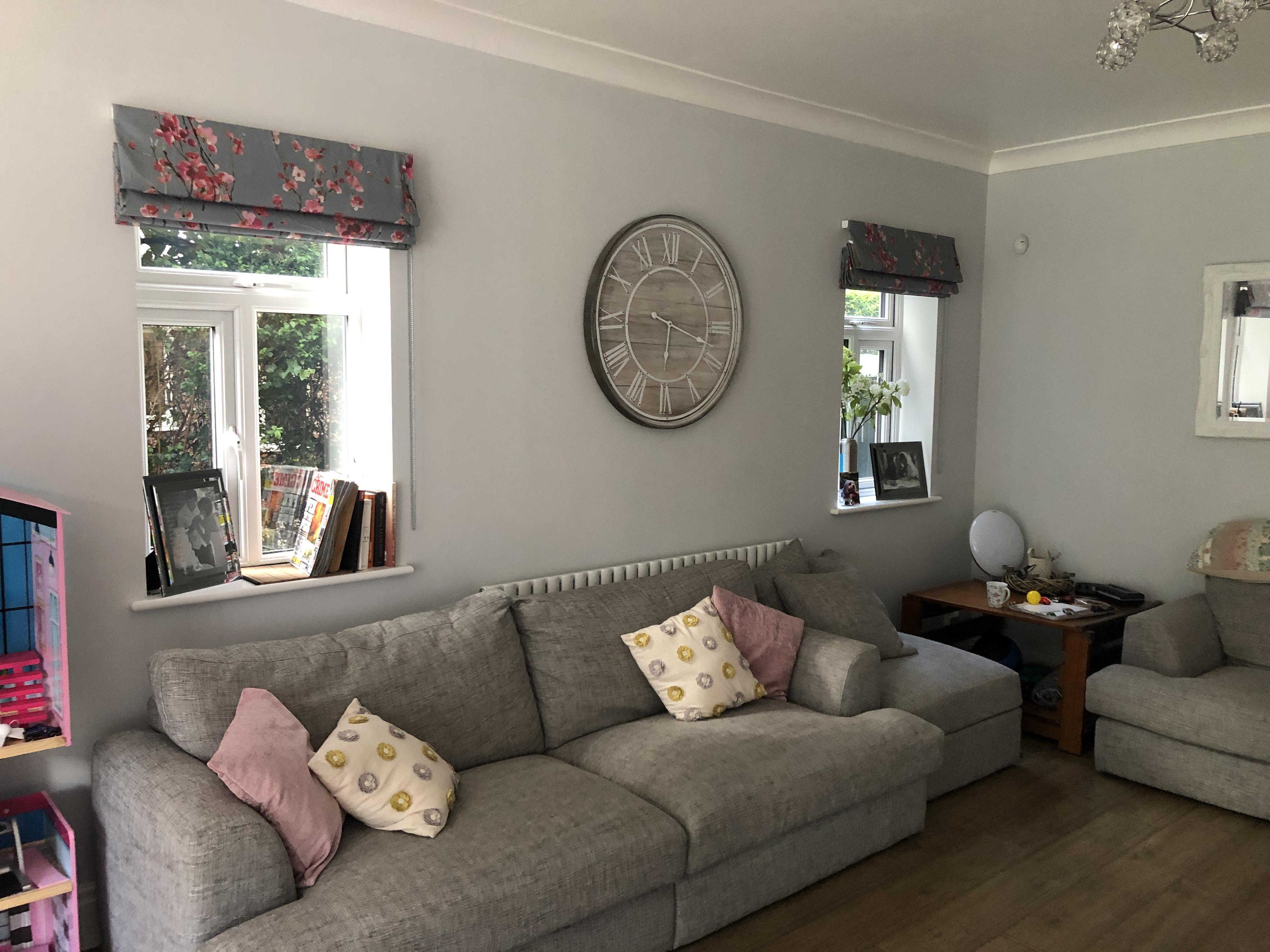

I have a pretty much blind child, she has some residual light / dark sensitivity but no useful sight. A few years ago we had some extra windows put into our living room to add extra natural light to one end as it was very dark, and she really did not like being in there. Since then, she’s been much much better and can navigate around , in and out, and happy using the whole space. I might add it’s quite a long room at about 8 metres, and the end of the room has 4meter wide glass doors. Even with those , the far end is very dark and much improved with the extra windows.

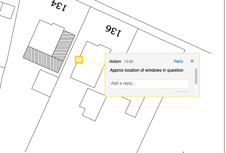

Our neighbours want to build a two storey extension that will come pretty much to the boundary. I’ve found some loose ‘regulations’ that seem to be more like talking points around the 25degree upward angle and 45 degree sideways angle, which don’t seem reason to refuse an application even this I think would fail on both counts. I can’t find anything that links these to a visually impaired / blind persons use of the space.
I also can’t prove the benefit of these additional windows to our daughters ability to navigate, and neither can we realistically prove any material implication of the proposed extension. I mean how can we know, for sure, until it’s actually built ?
The determination of applications will amongst other things take into account the outlook, privacy and daylight imposed on neighbouring properties, in particular primary windows serving habitable rooms. With dual aspect rooms and those windows that are considered secondary, the regulations will be slightly relaxed.

(Aside: take some readings with a suitable light meter now - so you at least know what levels should be OK for your daughter).
I think that some planning measures apply to *main* windows, which may limit the case you can make to planning.
If you consider the current amount of light you get through the side windows to be adequate, then you can probably wholly mitigate the impact of this extension with things under your control ie you may not need to be quite so concerned about the extension. I am making that assumption because there are things currently reducing the light level that you can address but have not done so. That you have not maximised existing potential will make it harder to argue that loss of light from the extension is a material threat.

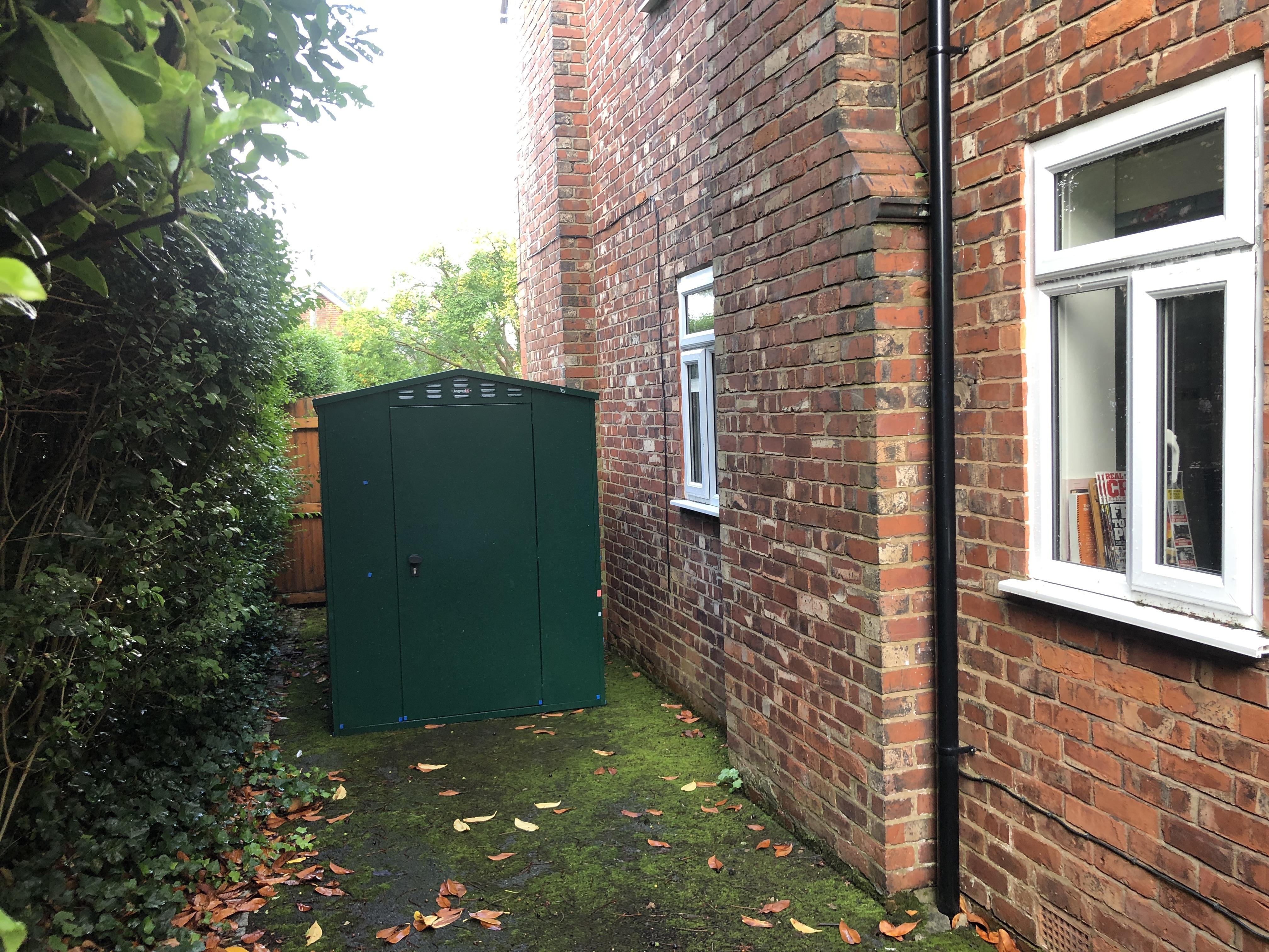

From what we have, I would suggest these are:
1 - That huge hedge which looks to be 9ft high and very long. If that is part yours you can remove it or reduce the height to say 1.5 or 2m.
2 - The glazing bars and surround-frame in those windows take up about 40% of the area. By putting in single panes and mirrors in the reveals and different non-blocking blinds you could probably nearly double the amount of light coming in.
3 - That bike shed is a blockage to some light - albeit minor.
4 - You seem to have about 15% of the windows blocked with a solid blind - surely these should be above the opening for max benefit?
If your N argues from the current position, the impact of the extension will be reduced because these blockages exist now. That smaller impact is in your neighbour's favour, and I would argue from his side that it is obvious that D does not need more light in the room because you have had the capability to provide it for X years and have voluntarily chosen not to do so. I would then say that since no one knows what the benefit of those mitigations would be but it is probably far more than any conceivable impact of my extension, it is absurd to restrict my extension since you have not done the maximum under your control. I would say that has an 70-80% chance of winning the argument with the planners.
If I was being sharp-clawed, I would add that the priority in your design of your windows was obviously not to maximise light coming in (glazing bars etc rather than a single clear pane), so why the sudden fuss now?
I would put the cost of changing the inner frames of those windows to be a single pane design to be about £300-400 the pair, which is eg less than a report will cost.

Ferdinand makes some really strong points here Adam.    The assumption is that the current light levels are satisfactory.  Therefore even clearing the window ledges of stuff could help a lot.
Changing window frames, light reflecting paint, would make a huge difference you never know the applicant maybes could get their builder to replace them for you as part of planning agreement or even install additional windows to mitigate their extension.

Just one thIng from the plans and your description of the space - 8m - and that middle area being dark -  it would appear as if the neighbour would be looking to extend their house to same length as yours.  So I suspect your house has an extension on too creating that darker area in the middle?   Which means you either extended or bought a house with a darker middle area which like you say you added light by installing those two side windows.  Is that right enough?

Is their rear extension also going to be two storeys? I might be more worried about it blocking sun from the south west when it is higher in the sky than the side extenson blocking it from the west as this may already be blocked by the current house and hedge. The south end of the side extension might also be an issue here.
If you think about it though, the windows are entirely shadowed by your house presumably until the afternoon. Only around 2pm would the sun come out of the shadow of your house. Is it appreciably brighter at this point than earlier on? If not the extension will likely not make much difference but the suggestions re narrower frames etc would help at any time of the day. If yes then you have more to worry about.
