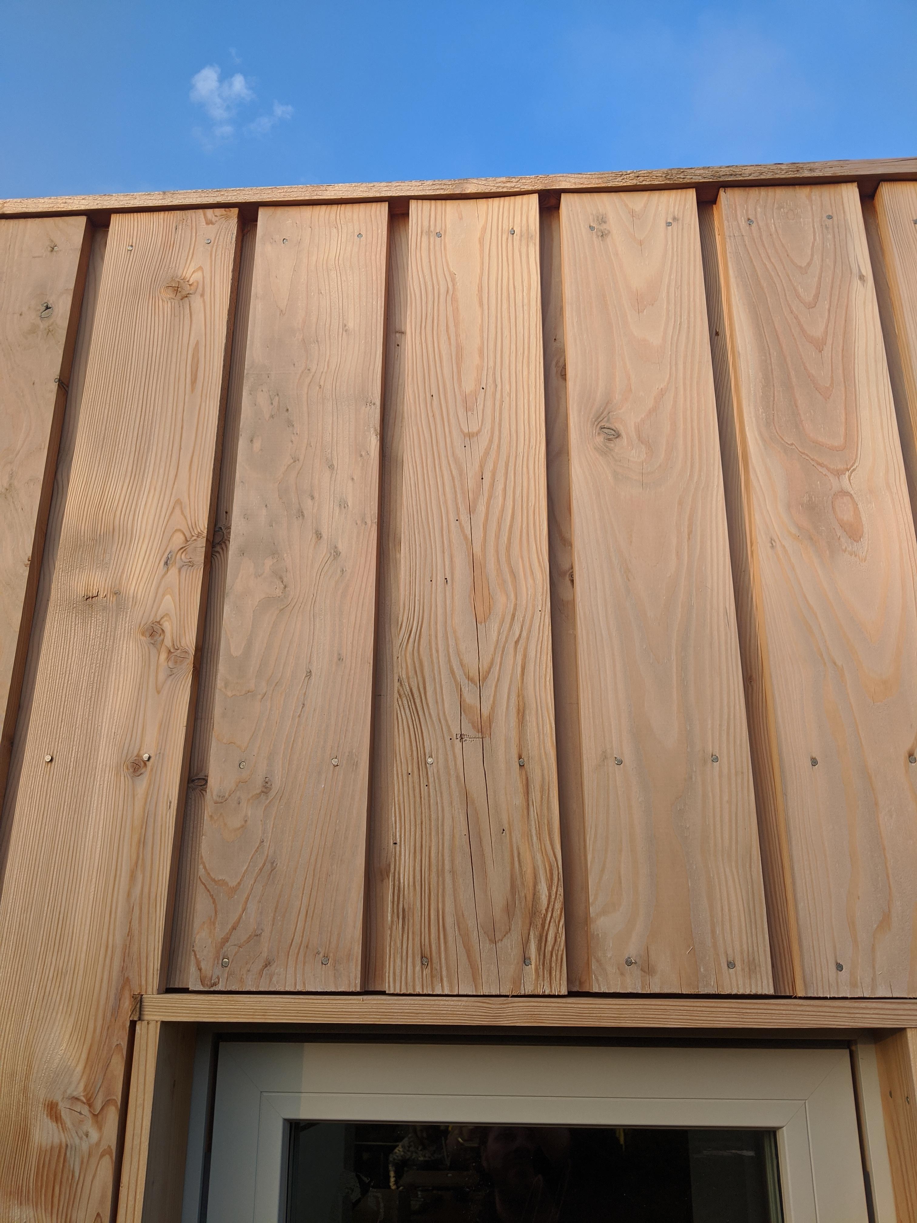

Was looking round my MiL's almost-complete extension yesterday and spotted a cladding plank that has quite pronounced shakes/splits compared to others.
I've not seen enough cladding up this close to know if this is reasonable, I know timber is natural and will split a bit but this one looks quite pronounced, it's the only board like it so really sticks out if you actually look at the wall.
Obviously just don't want it to develop into a bigger crack.
Would I be unreasonable asking the joiner to replace it?
There's also quite a lot of nails that are not fully home (head sitting a few mm proud of the surface) - they gun nailed it and I think under-drove them. You can see two examples on the left hand board. Is it fair enough to ask him to tap them in?

I’m not a cladded but was recently asked to step in over lockdown and clad 4 houses We also encounter planks with splits like yours They seemed to be just on The surface So we used them on less obvious places or for cuts
It wouldn’t be unreasonable to expect the contractor to go round with a punch and drive those nail heads in They shouldn’t be like that The trims around the openings would have looked better  with a mitre also

It's not uncommon for the larch to split and crack when drying out. We screwed all of our cladding so we can remove each piece. Eventually going to replace a few boards that have bad splits but there is not many.

Normal to have splits and cracks. If your house is completely covered with larch then your find that different elevations will adjust differently to it's new surroundings.
South more prone to splits and cracks from Sun/UV and the North might develop some black mold spots.
Are you planning to treat the wood? We were going to leave it to sliver naturally but decided to used Osmo oil with a pigmentation.
