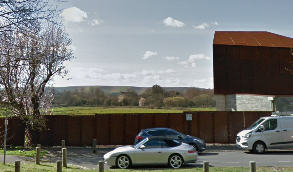

Mr Punter Posted August 12, 2020 Share Posted August 12, 2020 A building near me has used this. They have perforated fence panels with metal posts. A guy I know did some of the house cladding. No fun to work with. It is very heavy , the rust gets everywhere and it may pollute your garden. Can you not render the concrete wall or build a brick facing and finish the top with some alu or stone copings? Link to comment Share on other sites More sharing options...

Savi Posted August 17, 2020 Author Share Posted August 17, 2020 On 12/08/2020 at 18:13, Mr Punter said: A building near me has used this. They have perforated fence panels with metal posts. A guy I know did some of the house cladding. No fun to work with. It is very heavy , the rust gets everywhere and it may pollute your garden. Can you not render the concrete wall or build a brick facing and finish the top with some alu or stone copings? I had thought to render but I want something a bit more impactful. I had considered the rust but it is not anywhere near any grass or planting and I have left a gap for any rust runoff between the wall and decking. Hopefully that will be enough. Love the house cladding! Link to comment Share on other sites More sharing options...
