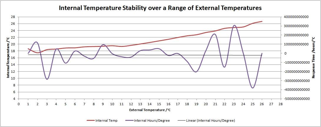

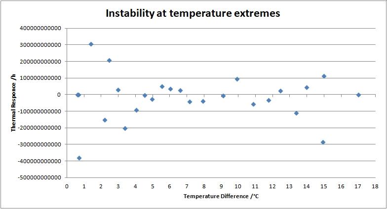

SteamyTea Posted August 12, 2020 Posted August 12, 2020 Have sorted and cleaned up this years temperature data, interesting result. As a house cannot be placed into a lab, one can only work with the prevailing conditions. This can be described as 'normal usage'. What seems to be happening is that the decrement delay runs into the millions of hours, with the only times it is in the sub tens of hours is at the extremes. During the normal external temperature ranges of between 6°C and 18°C (this is Cornwall, so no big extremes), there is very little change in internal temperature , it just tracks external temperature (y = 0.2792x + 16.869, where y in internal temperature and x is external temperature). It increases by 0.28°C for every 1°C external temperature rise. Over the whole temperature range this year so far, it is only 0.34°C for each 1°C rise in external temperature. I suspect that most of this is down to the ventilation i.e. I close windows when it is cold, open them when it is hot, solar gain. I may have a look at night time temperatures later, and at extremes. This may give a fuller picture as it eliminates one element. Deaggregating is not an easy task as the signal to noise ratio is quite low, but I shall see what comes out. But basically my feeling is the adding additional mass to a building makes almost no difference to the thermal response times. This is more affected by ventilation, heating/cooling and solar gain. But to initially answer the question, does 2 hours difference actually make a difference, then no. 1

SteamyTea Posted August 12, 2020 Posted August 12, 2020 (edited) On 12/08/2020 at 21:14, Nickfromwales said: "The longer the better" is the bottom line Expand I am not so sure. Looking at my data, when there is a very small, or very large difference between internal and external temperatures, the instability is greatest. Exactly what one is trying to avoid. Some of this will be down to the low number of samples, 322 for the bottom two temperatures, 43 for the top two, but 52,922 for the ones in the middle. The rest will be down solar gain and heating/ventilation. I am of the opinion that it is almost impossible to design a normal house that can take advantage of time shifting the thermal loads. This is mainly a UK problem as we are above 50° North, which means we have large change in solar gain throughout the year. We are also surrounded by a warm ocean on one side, and a cold sea on the other side and are windy and cloudy. It is also worth remembering that at low temperature difference, there is little capacity to store excess energy, the energy difference is the driver. Then at high differences, losses are greater as there is more energy to disperse. That is why cooling and heating does not follow a straight line, or even a simple sinusoidal curve. Not even solar power follows a sinusoidal curve (it is the sum of at least 4 curves, and then a random element for clouds, Fourier showed us this). I just added a trend line to my chart, the equation is y = -4E+08x - 2E+10. So basically flat. I expect the second part the, -2E+10, to get closer to zero as the year progress, though this is weather dependant, and weather is fickle. Edited August 12, 2020 by SteamyTea
