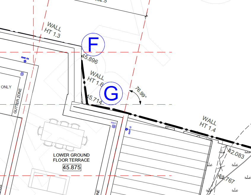

The wall in question is just below the "G" on the site plan. This section of an existing wall has been taken down and trench now poured. The wall continues then down the black dashed line.

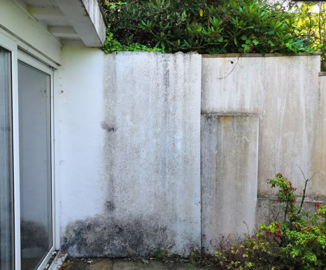

This is a pic of the wall and original house. New house is moved down the garden a couple of meters so now the side of the basement floor (semi basement really) forms the boundary wall

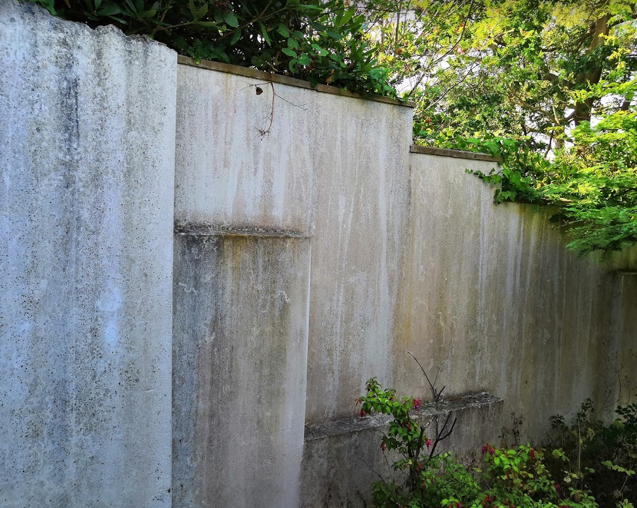

This is a pic of the wall as it continues down the garden, same construction as it passes by the other neighbour's back gardens.
