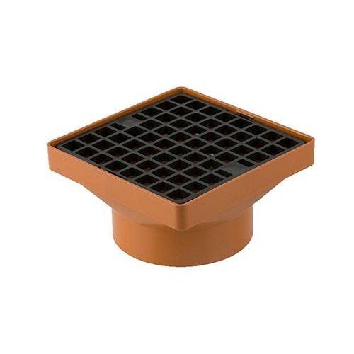

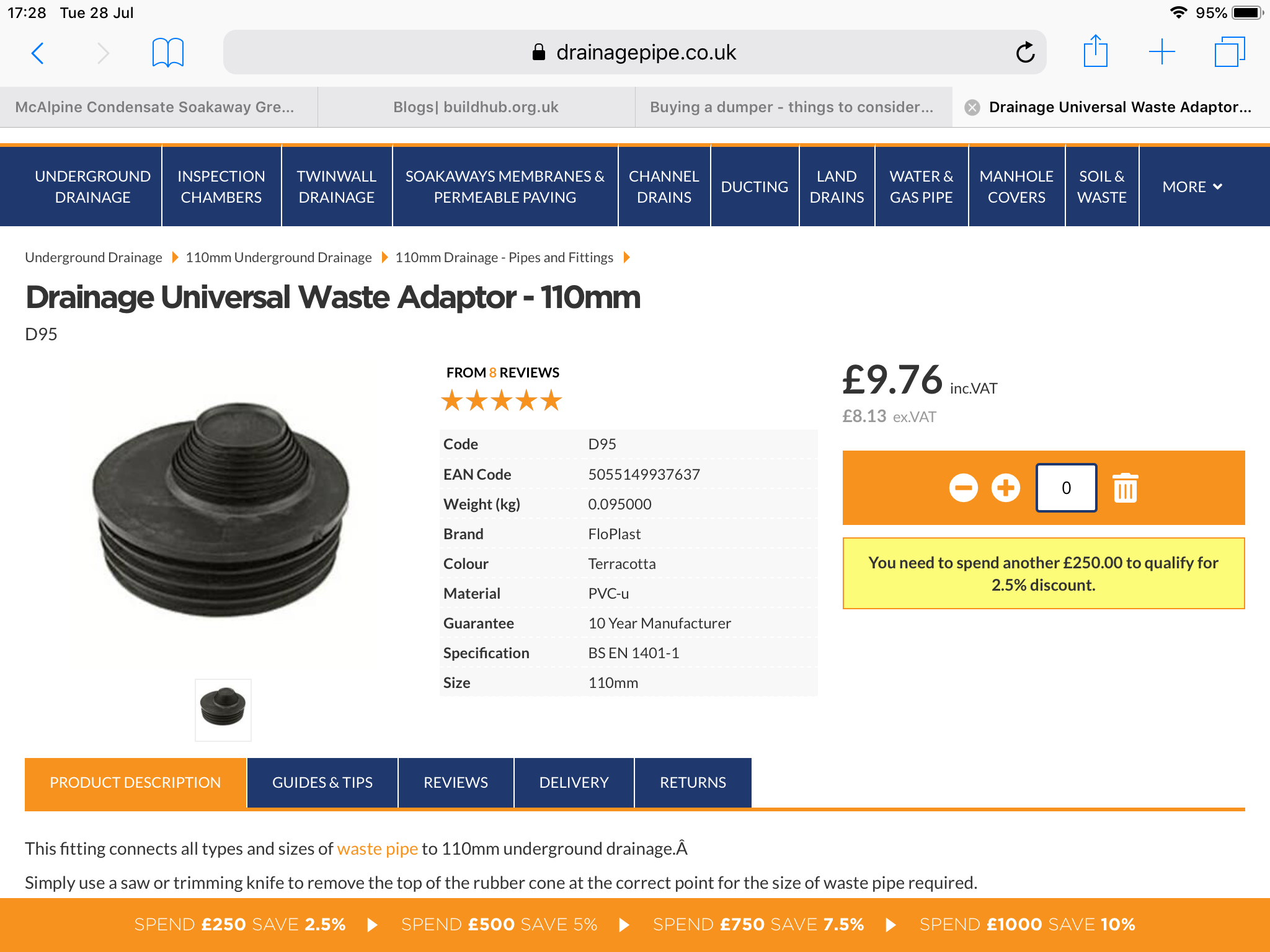

willbish Posted July 27, 2020 Posted July 27, 2020 Very tight for space and I cant quite get a square hopper on top of 110mm pipe without being all cockeyed. Is there anything narrower I can use? This gully is for ASHP condensate only, so could I use an adapter to a 40mm waste pipe and connect directly to the condensate drain?
joe90 Posted July 27, 2020 Posted July 27, 2020 17 minutes ago, willbish said: could I use an adapter to a 40mm waste pipe and connect directly to the condensate drain? I don’t see why not, I tried to find a round grid to fit a 110mm socket unsuccessfully .
willbish Posted July 27, 2020 Author Posted July 27, 2020 Just now, joe90 said: I tried to find a round grid to fit a 110mm socket unsuccessfully . Thats what Im looking around for now, perhaps I should stop! https://www.plastics-express.co.uk/underground-drainage/drainagecastings?product_id=2445
joe90 Posted July 27, 2020 Posted July 27, 2020 Funny how a company called “plastics-express” sell cast iron grids ?, yup, go for the 40mm reducer , no chance of other crap going down there ?

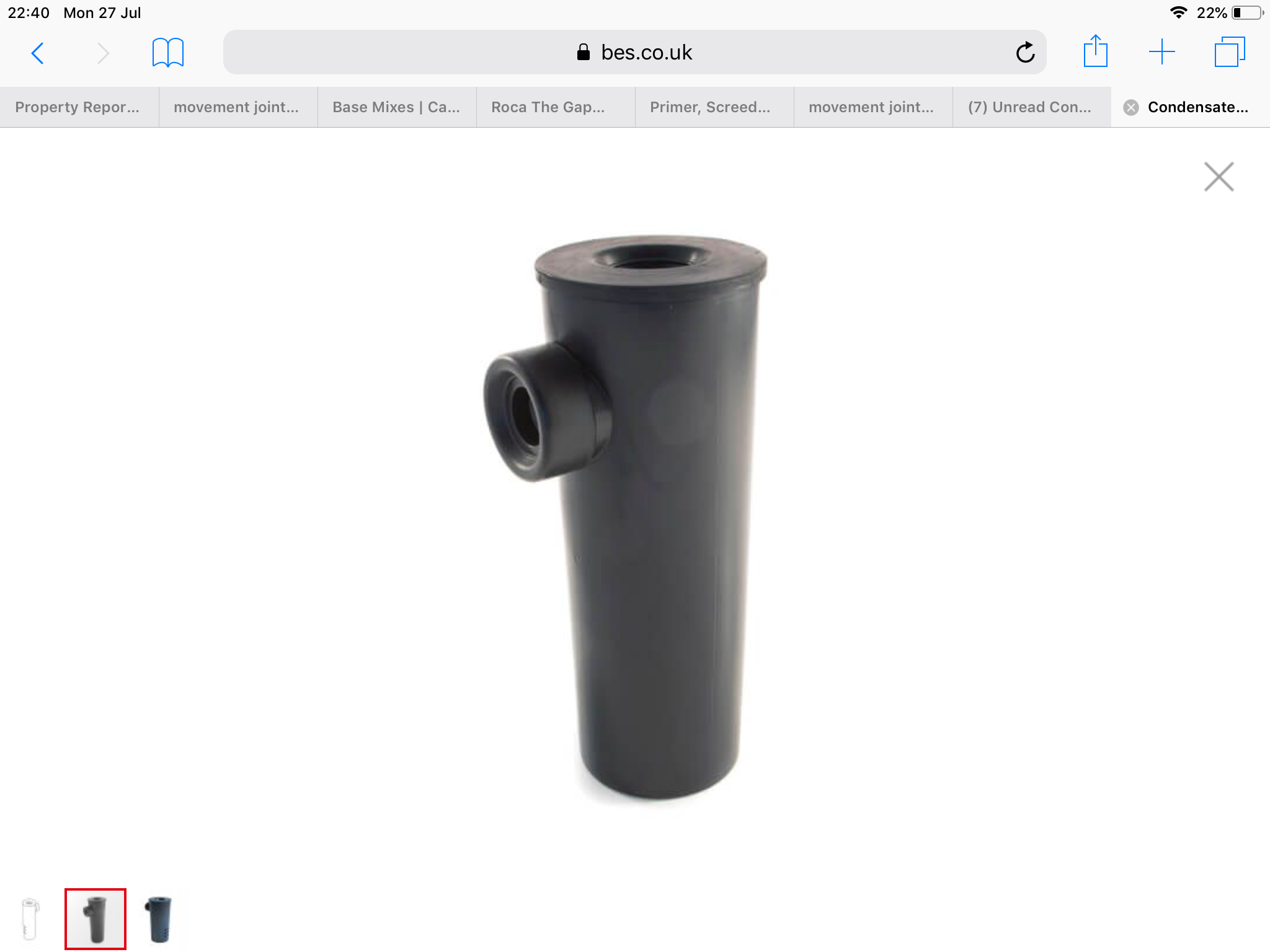

Russell griffiths Posted July 27, 2020 Posted July 27, 2020 (edited) Have you seen the proper condensate gulley, it is like a bottle gulley but tubular with a round grid on top. Edited July 27, 2020 by Russell griffiths

Russell griffiths Posted July 28, 2020 Posted July 28, 2020 You can get a version that has limestone chippings in side it and lots of holes around the outside so it just soaks into the soil. I couldn’t find a pic of that one.

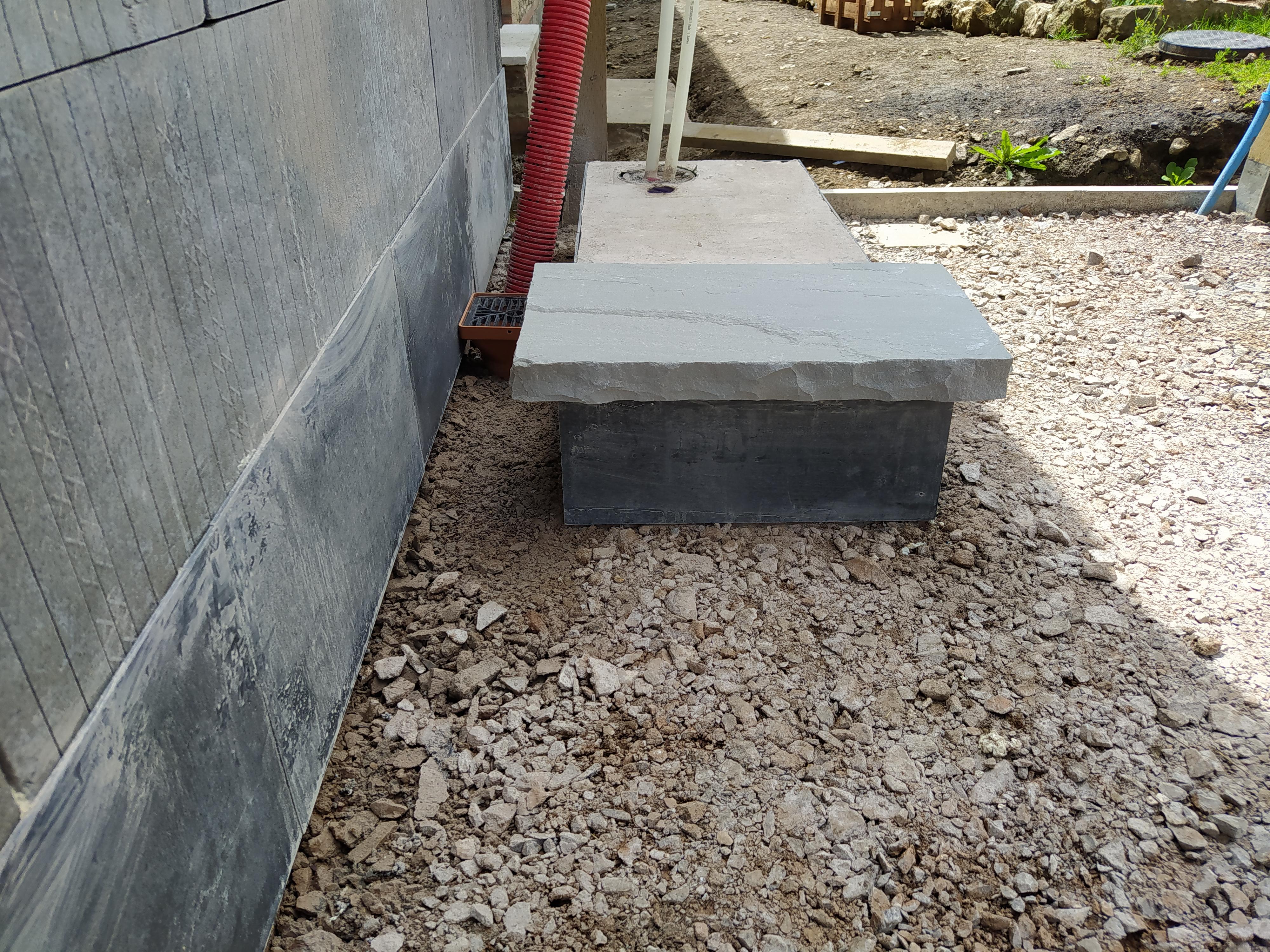

willbish Posted July 28, 2020 Author Posted July 28, 2020 This is the set up I've got Patio drains left to right ASHP pad drains right to left Little gully between house and pad to take condensate to soak away. I'm contemplating bodge: set square hopper in slabs covering 80% of the 110 pipe but not properly connected...
Russell griffiths Posted July 28, 2020 Posted July 28, 2020 (edited) Can you put the round top on that normally takes a down spout. Edited July 28, 2020 by Russell griffiths
