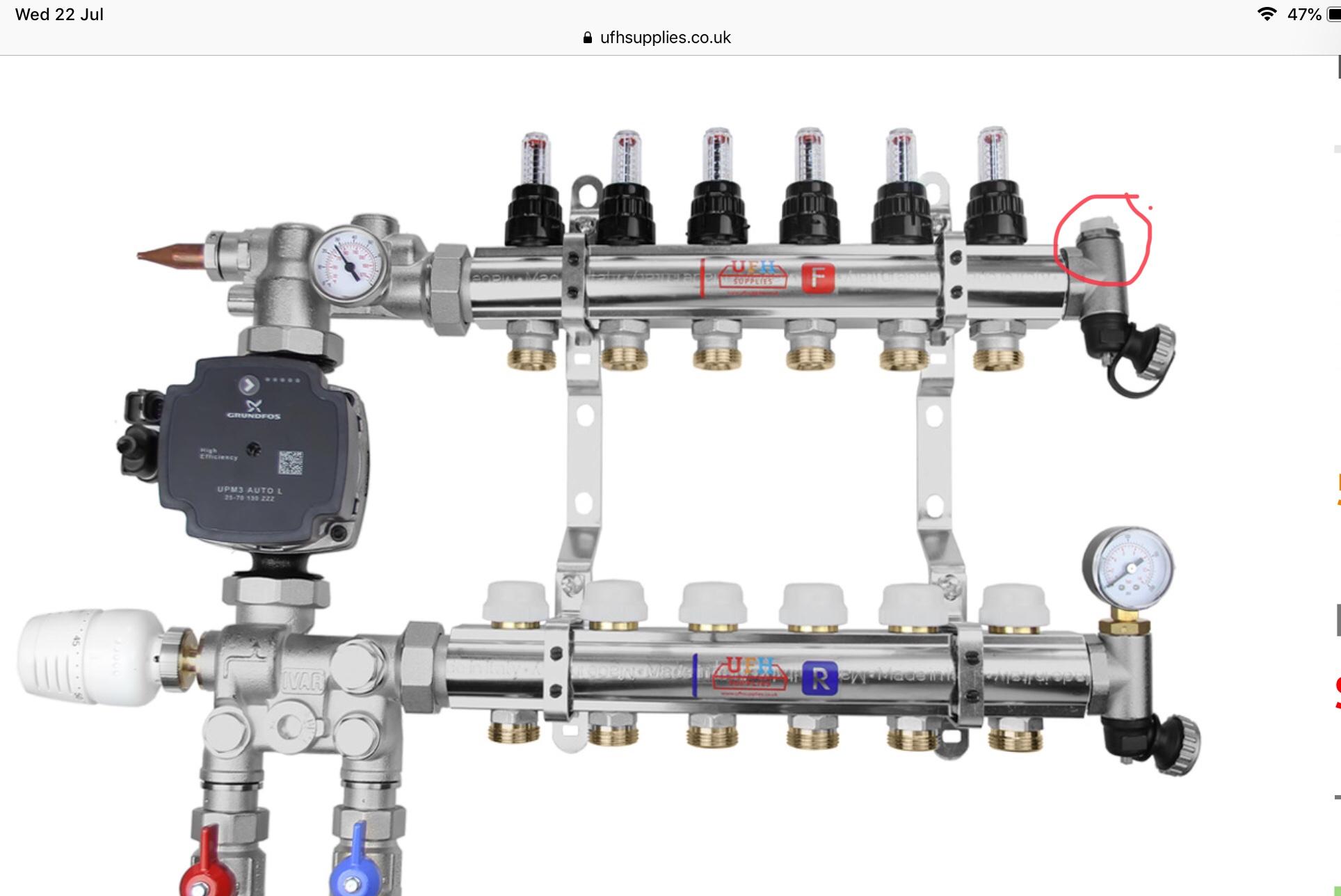

Russell griffiths Posted July 22, 2020 Posted July 22, 2020 Fitted my manifold and it came with a manual bleed valve although an auto valve is available do I need an auto ?? Look at pic it’s the bit circled. @Nickfromwales @PeterW
Nickfromwales Posted July 22, 2020 Posted July 22, 2020 Yup. I'd buy two and ditch the pressure gauge so you have air release ( automatic ) on both rails. 1
Russell griffiths Posted July 22, 2020 Author Posted July 22, 2020 Ok cool, should I have a pressure gauge somewhere else ?? i take it I can add the lower one later as I’m using the pressure gauge to keep pressure up to check for leaks and whilst screeding.
Nickfromwales Posted July 22, 2020 Posted July 22, 2020 (edited) You'll eventually have one of these kits fitted for filling and expansion + PRV;; So you get the pressure reading for the whole heating system from here, typically. Edited July 22, 2020 by Nickfromwales 1

PeterW Posted July 22, 2020 Posted July 22, 2020 (edited) 8 minutes ago, Russell griffiths said: What I don’t understand is those bleed valves are £7 so why not just bloody put one in, instead of it being an extra. £4.29...https://www.bes.co.uk/aladdin-autovent-hv30c-1-ufh-23156/ Edited July 22, 2020 by PeterW right URL 1

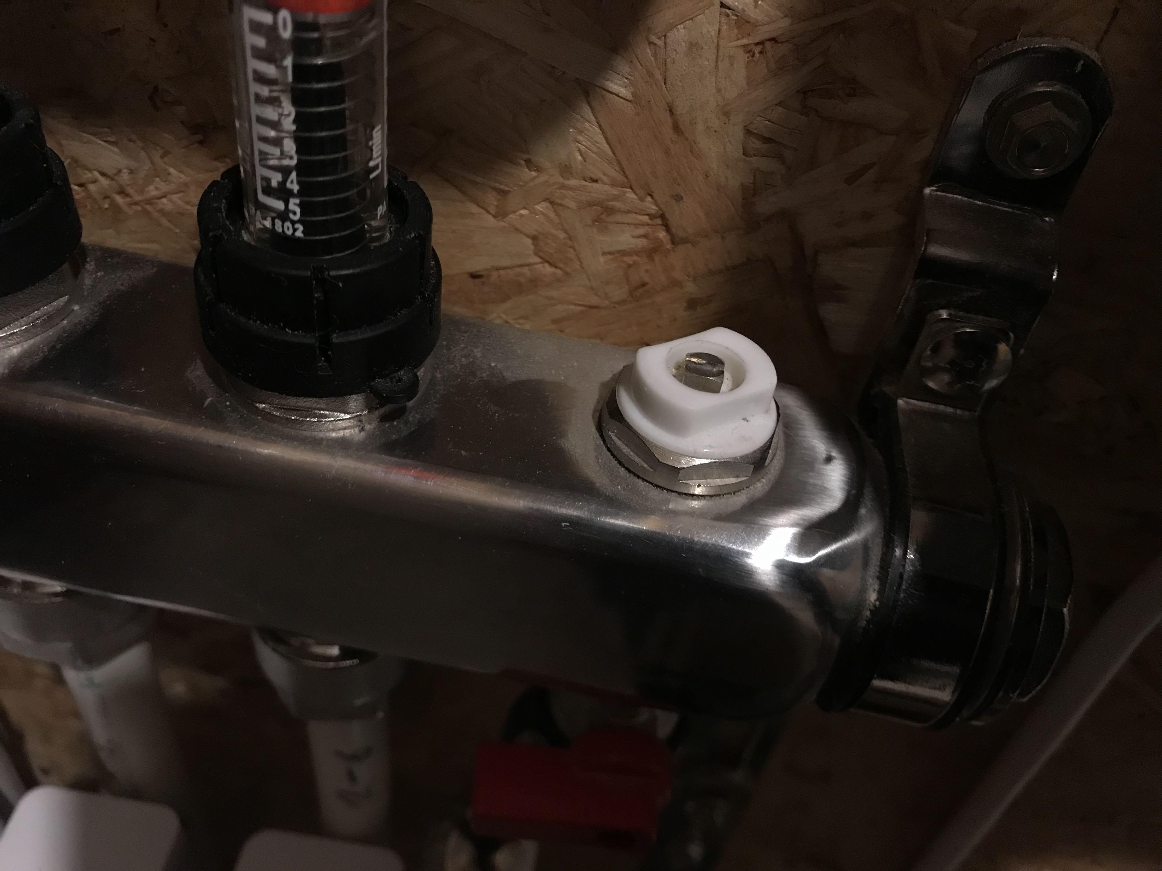

Nestor Posted October 22, 2020 Posted October 22, 2020 @PeterW @Nickfromwales @Russell griffiths Can you advise, my UFH has been off since March and I decided to top up all the loops on the 3 manifolds before we switched the heating on for the autumn / winter as one was gurgling a bit in the spring. Have had the ground floor on and have had some huge pops / bangs in the 50mm Anhydrite screed. The pressure gauge on the manifold is reading 1.2 bar and on the front of the Ecodan cylinder 1.5 bar. At the end of. each flow and return manifold are these, it it a bleed valve. What have I done??
Nickfromwales Posted October 22, 2020 Posted October 22, 2020 Yes, they are manual air bleed points like on a radiator. One turn or so max to allow air out. Water will come out when done, then close without overtightening. Pops and bangs? Can you elaborate?
Nestor Posted October 22, 2020 Posted October 22, 2020 (edited) Hi Nick, I switch the UFH heating on in the main living space and after about half an hour while the manifold is still providing heat a loud pop / bang within the floor happens. Could I have too much pressure in the loops or air? I have just opened the air bleed points, no air just water. Edited October 22, 2020 by JamesP

Nickfromwales Posted October 23, 2020 Posted October 23, 2020 9 hours ago, JamesP said: Hi Nick, I switch the UFH heating on in the main living space and after about half an hour while the manifold is still providing heat a loud pop / bang within the floor happens. Could I have too much pressure in the loops or air? I have just opened the air bleed points, no air just water. Ok, so we can rule out issues with the heat / circulation then? This sounds like the noise is coming from expansion where heat is entering the slab and the pipes are warming up a cold / cool screed. First for me. Do you notice the flow gauges jumping when these noises are occurring? 1
Nestor Posted October 23, 2020 Posted October 23, 2020 The flow temperature at the bar is 55c so I will adjust the blend valve down to 45c, Wunda mentioned thermal shock when introducing heat into the slab. Will observe the flow gauges, thanks.
Nestor Posted October 23, 2020 Posted October 23, 2020 (edited) @Nickfromwales Been running the UFH at 45c today, no loud noises. The final floor has not been laid yet and a crack has appeared in the screed. Also 3 loops provide the heat for that room and I notice the return pipe on one of the loops is not warm like the other 2. The floor area in part of that room is not warm. Flow gauges are all open as have auto balancing actuators on the return. I might remove the actuator and replace with a white return valve manual head and see if the water flows through that loop. Edited October 23, 2020 by JamesP
Nickfromwales Posted October 23, 2020 Posted October 23, 2020 4 hours ago, JamesP said: @Nickfromwales Been running the UFH at 45c today, no loud noises. The final floor has not been laid yet and a crack has appeared in the screed. Also 3 loops provide the heat for that room and I notice the return pipe on one of the loops is not warm like the other 2. The floor area in part of that room is not warm. Flow gauges are all open as have auto balancing actuators on the return. I might remove the actuator and replace with a white return valve manual head and see if the water flows through that loop. Shut off flow to all which are working and try to purge the lazy one/s through 1 1
