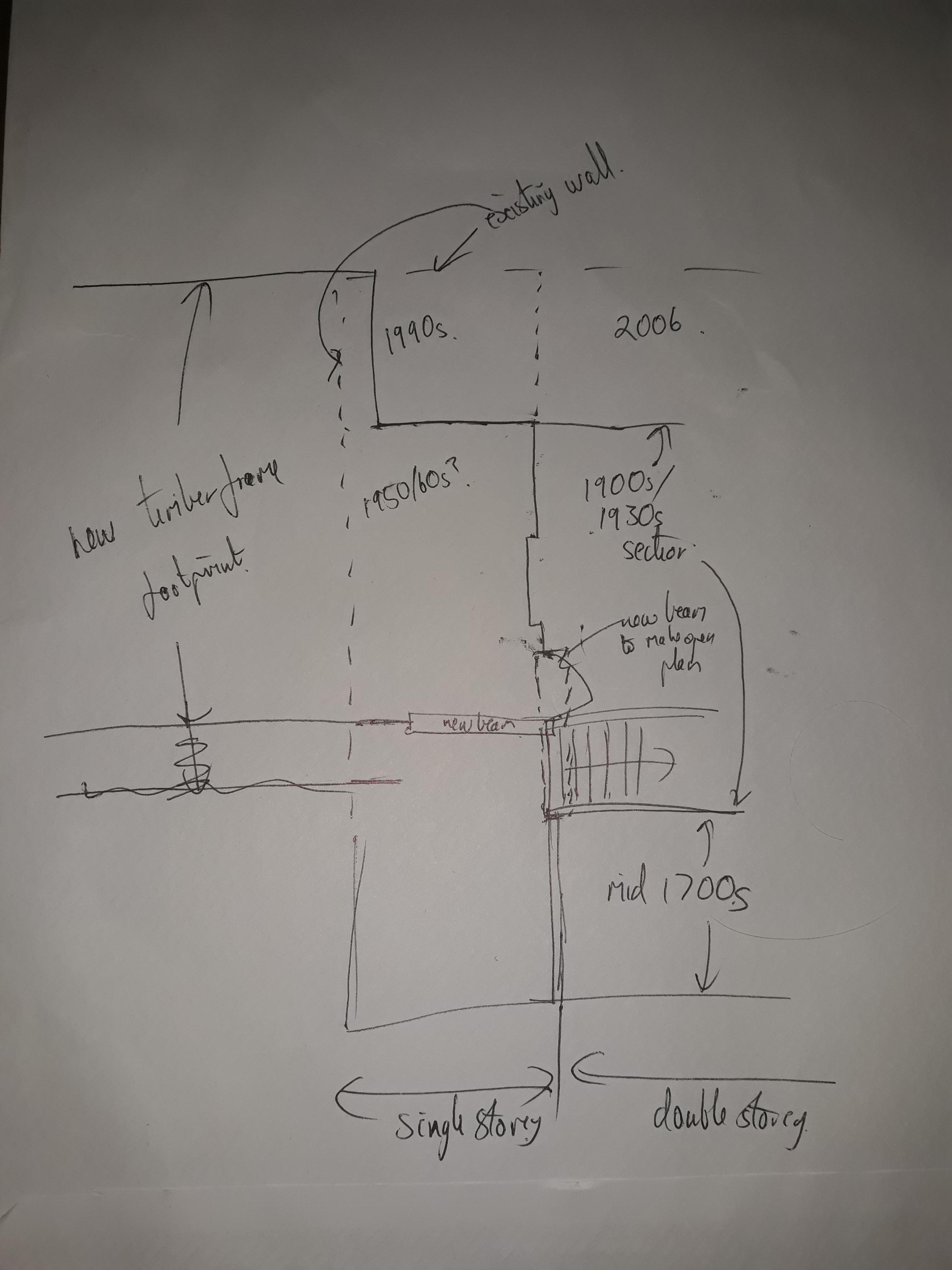

SugarPlum Posted July 21, 2020 Author Posted July 21, 2020 I don't think so. In terms of the join from extension to 2 storey part of the house, we are opening up a doorway to make the existing room more open plan which happens to be where the timber frame will join. It is a 7kN point load apparently, at first floor joist level. The load point would be above where the foundations would be underpinned, but given that this load point will be in the middle of another beam approx 1.5m wide, surely any load distributed to the foundations would not benefit from the underpinning? In terms of the existing footings, very little of the extension will rest on these, 95% of the frame is outside the footprint of the existing house. Hard to describe really, I could upload a sketch or two if it helps?
SugarPlum Posted July 21, 2020 Author Posted July 21, 2020 A very quick sketch... hopefully makes some sense... I have tried to show two beams in a T shape, one is designed by the timber frame company as the mechanism to join to the existing house. The other is to remove a doorway and open up the stairs to be open plan to the room. The suggested underpinning would be directly under the beam designed by the timber frame folks, as would new footings. The dotted line by 1950s/60s and 1998 etc is the current external wall ( the house has a very complicated extension history...)

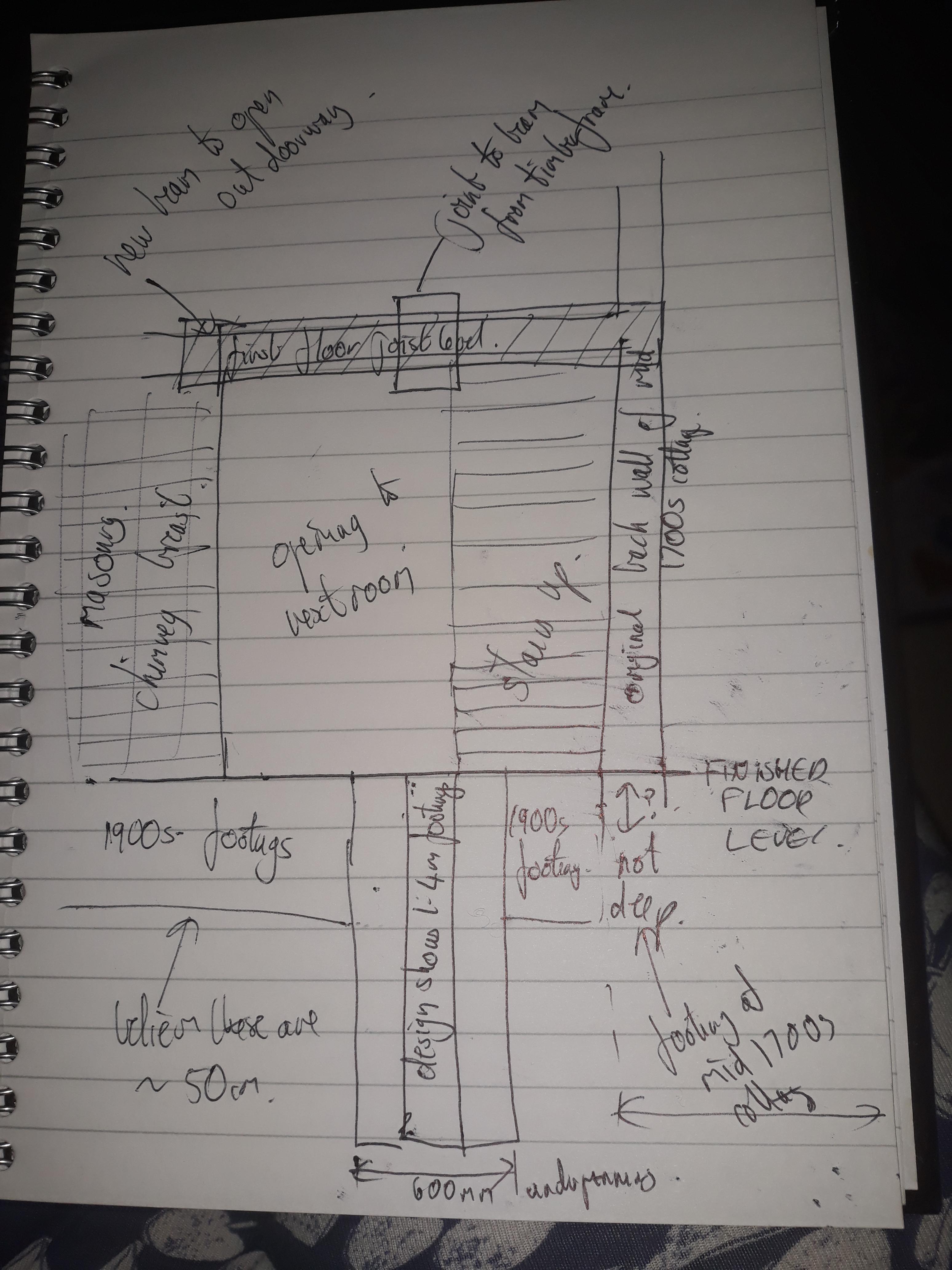

SugarPlum Posted July 21, 2020 Author Posted July 21, 2020 (edited) Another sketch from an elevation perspective. The more I draw, the more it makes no sense.... surely this shows that all the new weight will bear on the original foundations? And the underpinning is doing nothing (other than introducing differential movement)? Edited July 21, 2020 by SugarPlum
Gus Potter Posted July 22, 2020 Posted July 22, 2020 Interesting job this. A few initial thoughts, you have maybe covered this already though. The differential settlement could well be an issue. Worth looking to see (you may already have) if you can decouple / simplify the problem to avoid underpinning, creating a stiff point in the old house and so on. If you can you could allow the new extension to move independantly from the older structure and detail for this - tricky though! The 7.0 kN point load is not too onerous a reaction from the beam framing into the beam over the slapping. It may be that this is just carrying some floor load rather than floor and roof load etc. You may be able to under sling this beam from the roof above and transfer this load somewhere else where it is more easily dealt with. This now leaves you with just the slapping. What might be able to do here is to create a steel box frame. Beam over the top, two columns each side and a heavier beam at the bottom. The bottom beam goes just below ground floor level. The load comes down the columns and the bottom beam spreads the load more evenly over the whole length of the existing found which you don’t touch. Simplfying - the existing found still experiences roughly the same loading regime. You’ll lose a bit on the width of the opening but this is less disruptive. I saw a chimney breast in there. Worth thinking about but if you are using an old chimney to support say a pad stone / beam. Consider the integrity of the masonry. It may have some form of sulphate attack from soot so it looks ok on the outside but less so on the in. The box frame column can resolve any potential issues here. You can also use the columns of the steel box to provide lateral restraint to the walls where you cut an opening. Can come in handy. With a box frame you can then get really keen if you have to with the analysis by changing the stiffness of the connections, you can shift the load about this way a little to fine tune. There seems to be a wall at the back of the stair to come down. This will unload the found so maybe opportunity to add a bit of load back in here. Temp makes a good point about the existing single storey found in that the extra storey may overload them. Sugar plum – post some plan view drawings if you want, floor and roof joist layout. Need to nip off now. The trees, foundation depths are probably worth a later look.

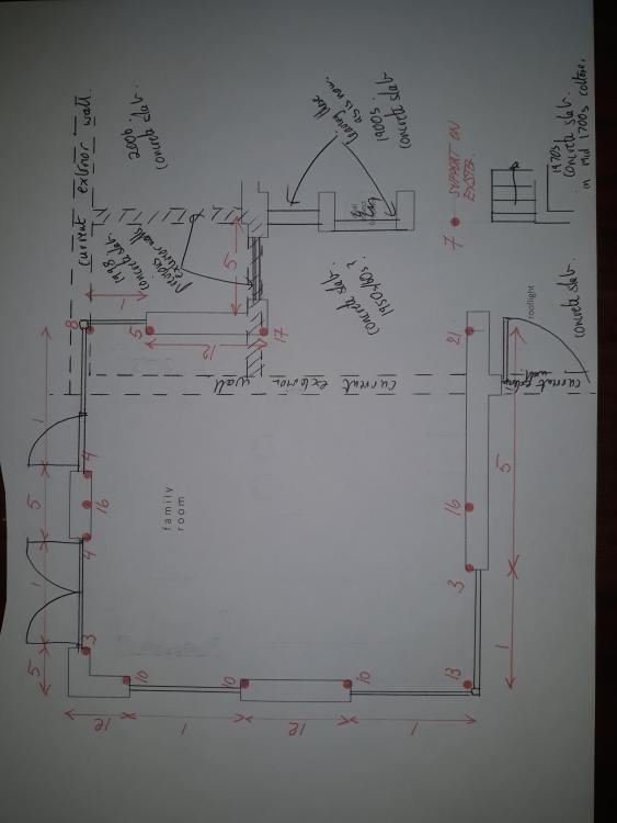

SugarPlum Posted July 22, 2020 Author Posted July 22, 2020 This is the loads from the timber frame, which I have (roughly!) annotated with existing walls/foundations- does that help? The timber frame company have said that the frame will not load the existing house in any other way, which leads me to believe that the floor joists and roof joists run parallel to the 1900s wall with chimney breast. I've already had a conversation with the frame manufacturer about the possibility of shifting the loading points if it makes the foundation/floor design easier, but they were reluctant. I think we could live with not opening up over the stairs if it mean the structure of the extension was able to be independent.
Gus Potter Posted July 22, 2020 Posted July 22, 2020 I have chucked in some other general stuff here but for SugarPlum it’s worth a closer look at the decoupling. The timber frame will also shrink a bit so you have that movement to account for too. Keep it simple – hence the attraction of separating (decoupling) the old and the new. Interesting point about the NHBC guidance. It is guidance though. Once you get a handle on the particular features and behaviour/ nuances of the existing structure you can apply first principles of design and adapt the guidance to fit the particular scheme. You need to put a bit more detailed design work in and think laterally, but it should save you money in the long run. We know every building is different in its own way so one solution fits all. That’s why we love them. Plum, you may well still be able to have the slapping so don’t throw in towel just yet. You could save a lot of money not underpinning so the additional cost of a box frame may not be significant. Had a look a Sugarplums floor plan. Point worth clarifying with the timber frames designer is how the lateral stability works, this is the bit that stops the building moving sideways when say the wind blows. There is a fair bit of glass in plums ground floor so less wall panels to resist the sideways movement. This can start to crop up later especially if you live in a windy spot so best to get this out the way and clarified early as it can transfer down / impact on the foundation design. Aside, if you have a drawing showing loads, if possible find out if they are “unfactored” or “factored loads”. An “unfactored load” has no safety factors applied. The difference between the two is significant. Plums’ ridge beam is worth a look at in general terms. Plum – if you are unlucky and things start to go pear shaped with this then you have a few options so perhaps don’t worry too much. For the curious - If you have a basic roof then roughly the two rafters are tied together at the bottom. This tie forms the ceiling and the whole lot often sits on the outside walls. The rafters want to push the walls out, the ceiling ties hold the two walls together. When you vault the ceiling the tie is often cut out unless you leave them in and make a feature of them. You can solve wall spread often by putting in a beam up at ridge height (as Plum mentions) that say spans gable to gable. But you have now transferred roof weight to the gable. You may have a chimney flue or maybe or small opening, right under where you want to put the end of the ridge beam. Old gable walls can be a bit less stable at times. One way of getting round this is to put in an A frame on the inside of the gable. This supports the end of the ridge beam. The bottom of the A frame extends down to the attic floor level / main wall head level and you transfer the load back into the wall here. What you have done is take the load away - down and sideways from say the flue. Here there is a bit more compression in the wall and this can help too, the gable wall is perhaps less weathered etc so the wall can be more sound at this point. This method introduces some horizontal forces (due to what is called an eccentricity) which you need to deal with but it’s all doable. I'll leave the discussion on building regs, the NHBC etc for another time..
