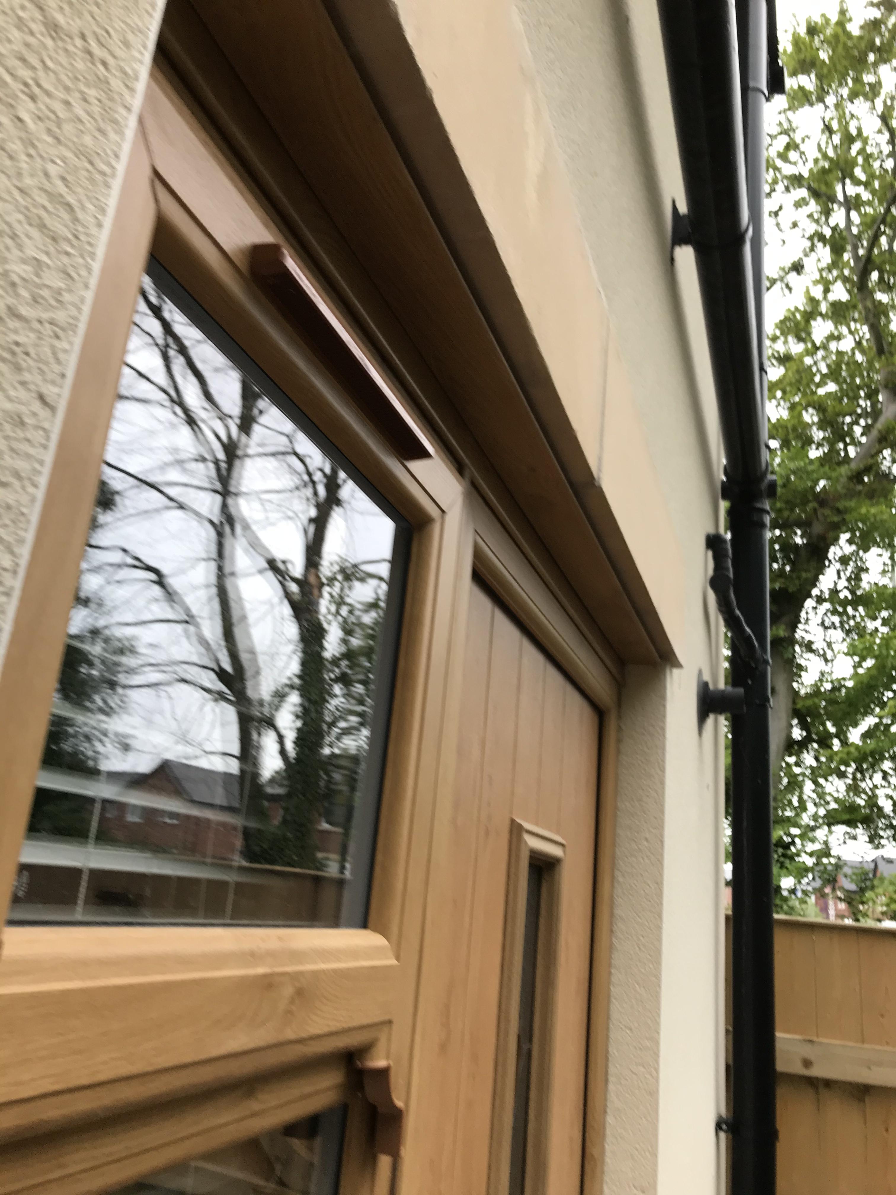

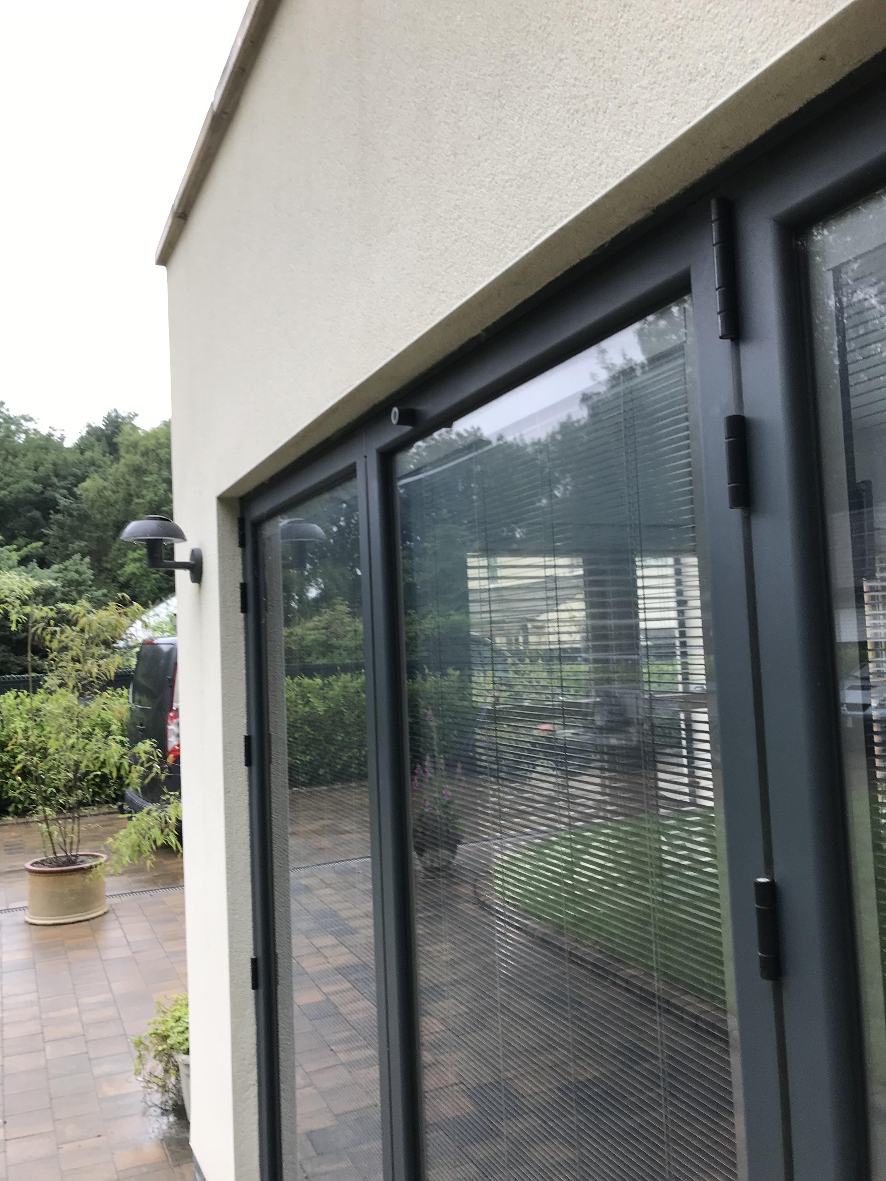

nod Posted July 1, 2020 Posted July 1, 2020 While I stuck a rip of cement board under the ones to be rendered I glued a 45 mil trim that matched the frame on the ones that weren’t rendered 2
MortarThePoint Posted July 1, 2020 Author Posted July 1, 2020 1 hour ago, nod said: While I stuck a rip of cement board under the ones to be rendered I glued a 45 mil trim that matched the frame on the ones that weren’t rendered Looks very smart, good job! 1

AliG Posted July 1, 2020 Posted July 1, 2020 My last two developer built houses had lintels showing above the windows and I hated it. In the current place where lintels were on show we stuck render board to them and took the render into the reveal as @nod has done
Matt Davey Posted July 12, 2020 Posted July 12, 2020 With some mesh applied these can be rendered upto the widow frame, but I have also seen PVC flat strip glued to cover it up too. I agree that it is a raw building material, often with blemishes that is not desirable to be on show if it can be helped. Doesn't seem to bother most by the seems of it though! Perhaps just the more OCD of us! ?

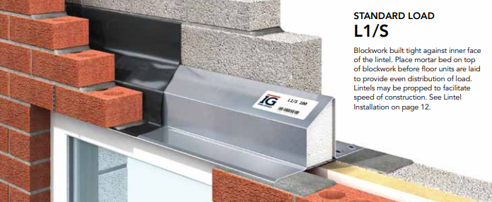

epsilonGreedy Posted July 21, 2020 Posted July 21, 2020 @MortarThePointHas your architect specified full 100mm brick reveals? As you can see in the thread this finishing detail is an issue for some of us. Catnic lintels are black but unfortunately these were a special order to Lincolnshire. Catnic is a dosy provincial outfit to try and deal direct with. Keystone lintels have a galvanized colour finish. I might try and disguise my Keystones once the full brick reveal windows are fitted.
