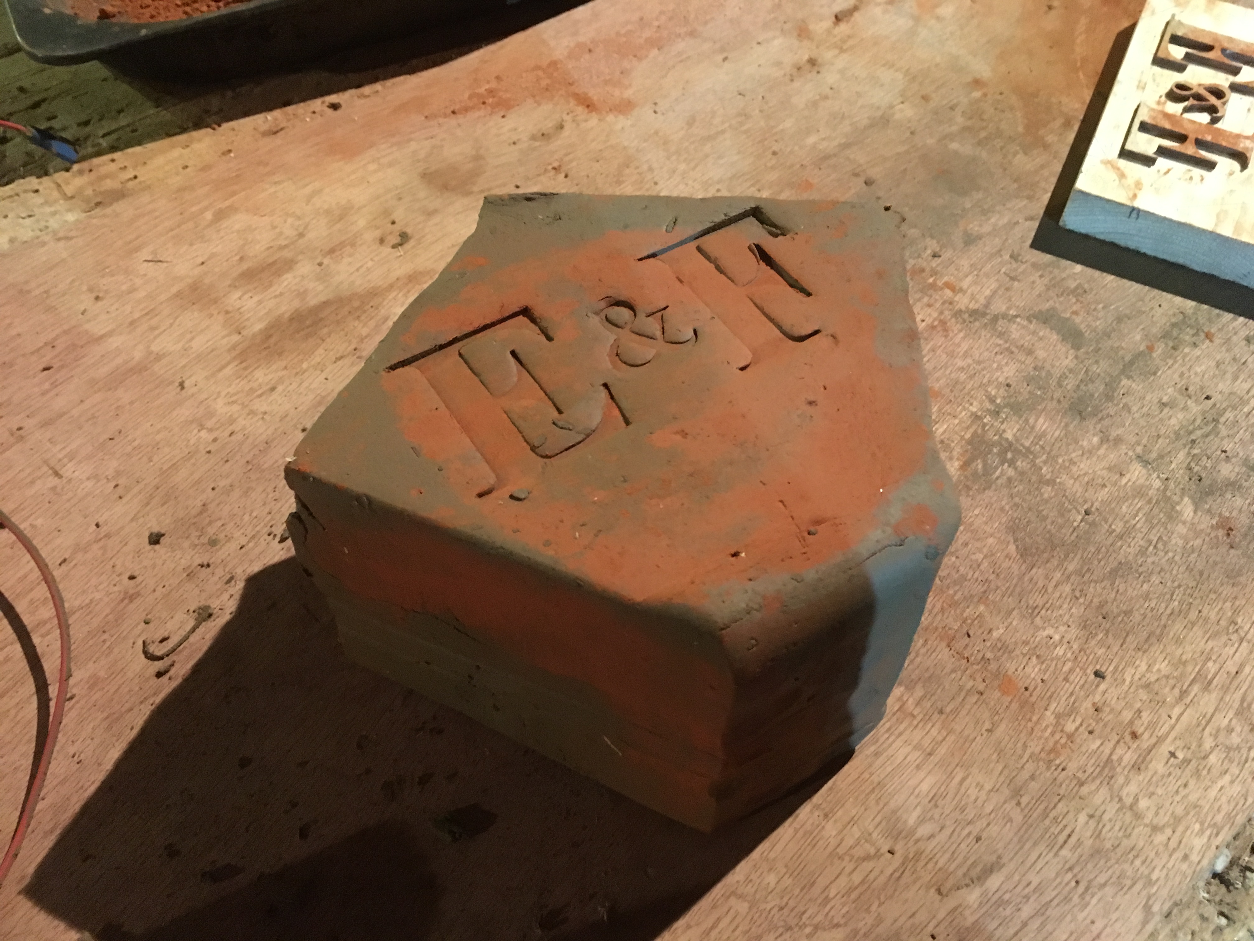

Construction Channel Posted February 22, 2017 Author Share Posted February 22, 2017 Just to wet all your appetites I'll show you attempt 2 before destroy it 1 Link to comment Share on other sites More sharing options...
Onoff Posted February 22, 2017 Share Posted February 22, 2017 6 minutes ago, Construction Channel said: Just to wet all your appetites I'll show you attempt 2 before destroy it Wonderful! Really looks like "a brick". Why are you going to destroy it, to look at the internal formation / structure? Will you glaze it later? Just wondering if the letters are recessed enough? Has Faye says she doesn't feel you've gone deep enough! Link to comment Share on other sites More sharing options...

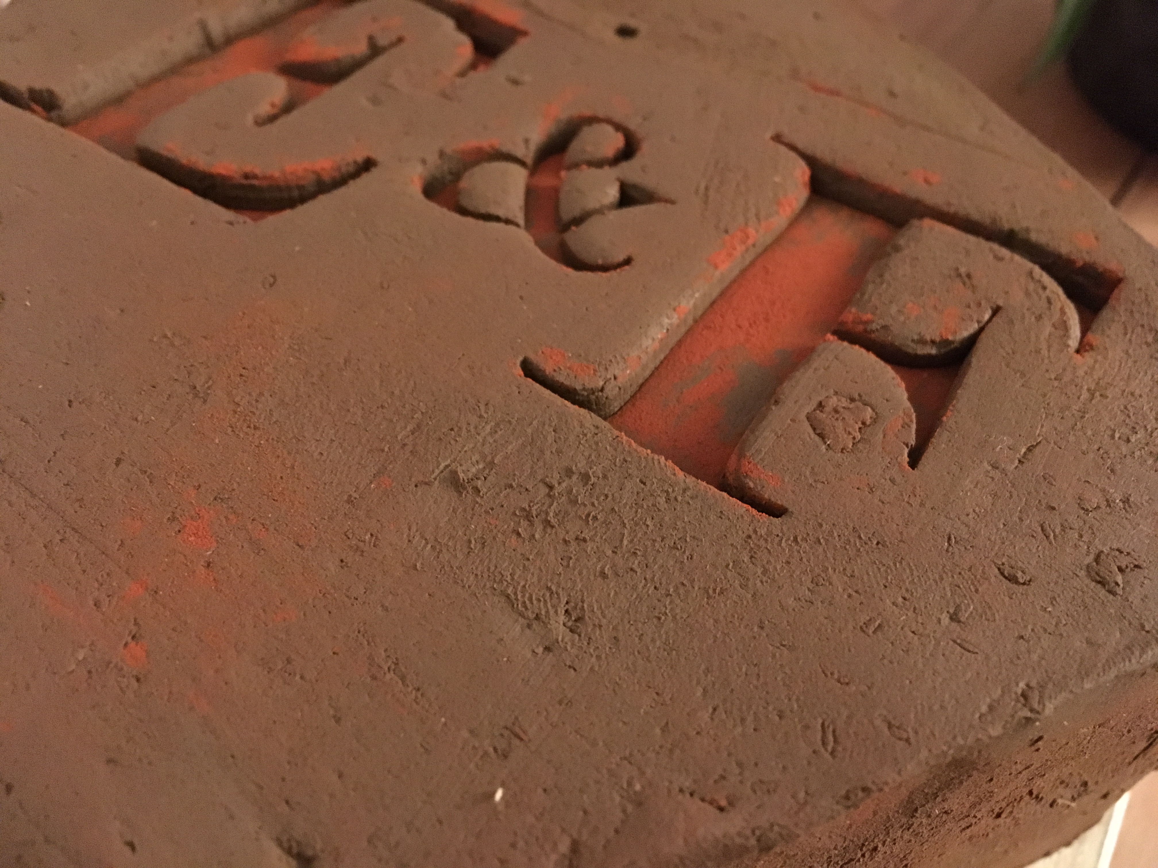

Construction Channel Posted February 22, 2017 Author Share Posted February 22, 2017 1 hour ago, Onoff said: Wonderful! Really looks like "a brick". Why are you going to destroy it, to look at the internal formation / structure? Will you glaze it later? Just wondering if the letters are recessed enough? Has Faye says she doesn't feel you've gone deep enough! Thank you, but funny you should ask, I destroyed it because i wasn't happy with it. the lettering wasn't deep enough so i doubled the stamp, also i wanted to redo it as i made the bottom slump when i tapped it out of the mould. I dont intend to glaze it at all, I'm going to leave the 2 finished ones to dry for a week, put them in the slow oven for a few days and then try and get the buggers up to 900 DegC Link to comment Share on other sites More sharing options...

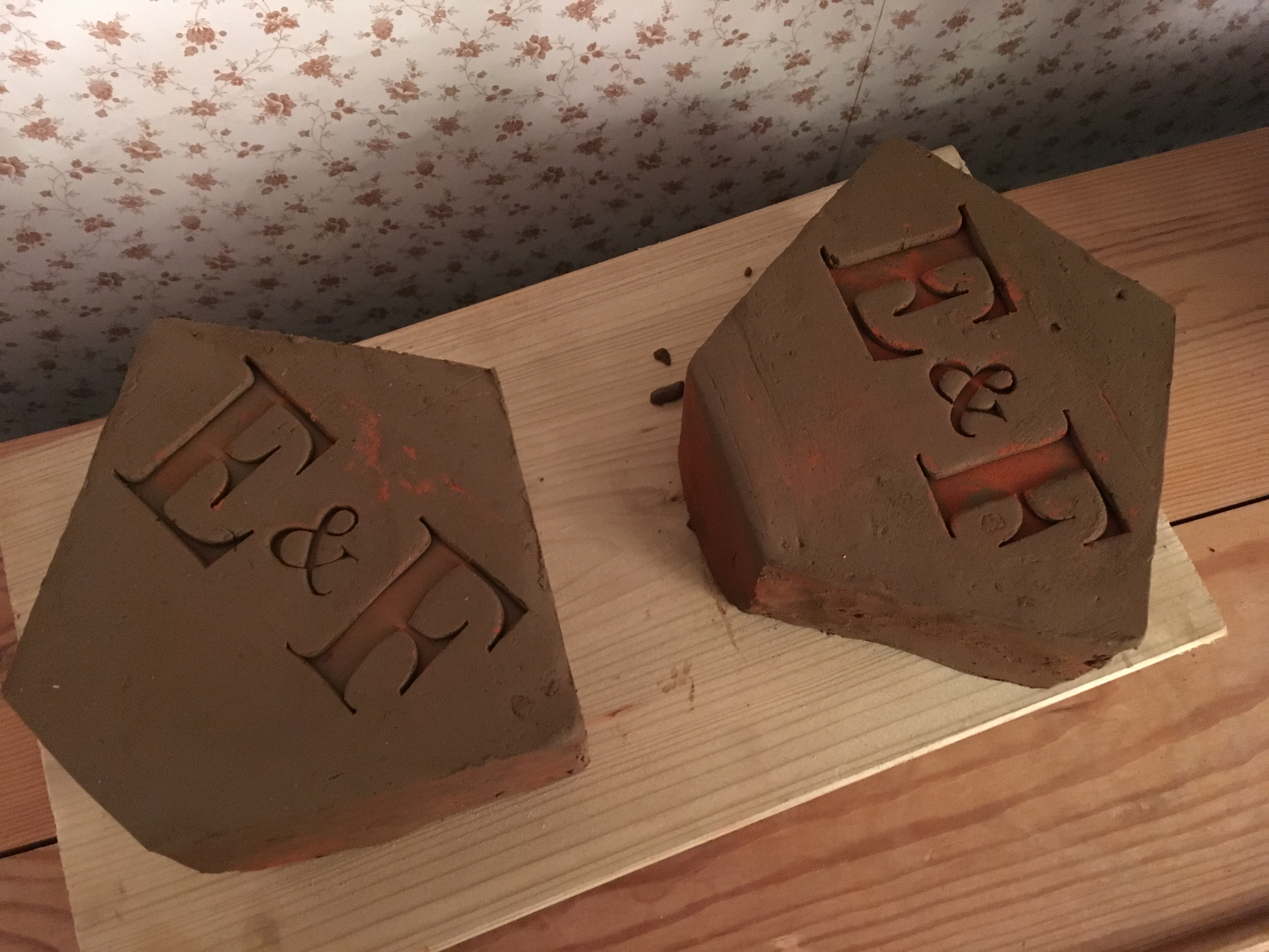

Construction Channel Posted February 22, 2017 Author Share Posted February 22, 2017 These are what I am going to call batch 1.0. They now have a 6mm stamp and an inch cut off the back. and i scooped a "frog" out of the back with a big hole saw Link to comment Share on other sites More sharing options...

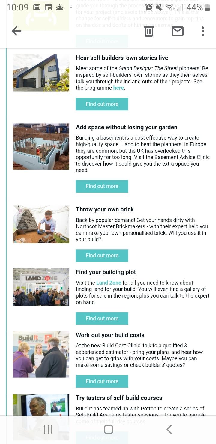

Onoff Posted June 2, 2019 Share Posted June 2, 2019 Learn how to throw you own brick at Bicester Buildit: Link to comment Share on other sites More sharing options...
Construction Channel Posted June 2, 2019 Author Share Posted June 2, 2019 19 minutes ago, Onoff said: Learn how to throw you own brick at Bicester Buildit: Maybe...... One day... For the time being that brick is at the bottom of a very long list Link to comment Share on other sites More sharing options...
Onoff Posted June 2, 2019 Share Posted June 2, 2019 2 hours ago, Construction Channel said: Maybe...... One day... For the time being that brick is at the bottom of a very long list Bicester would be a day out? Link to comment Share on other sites More sharing options...
