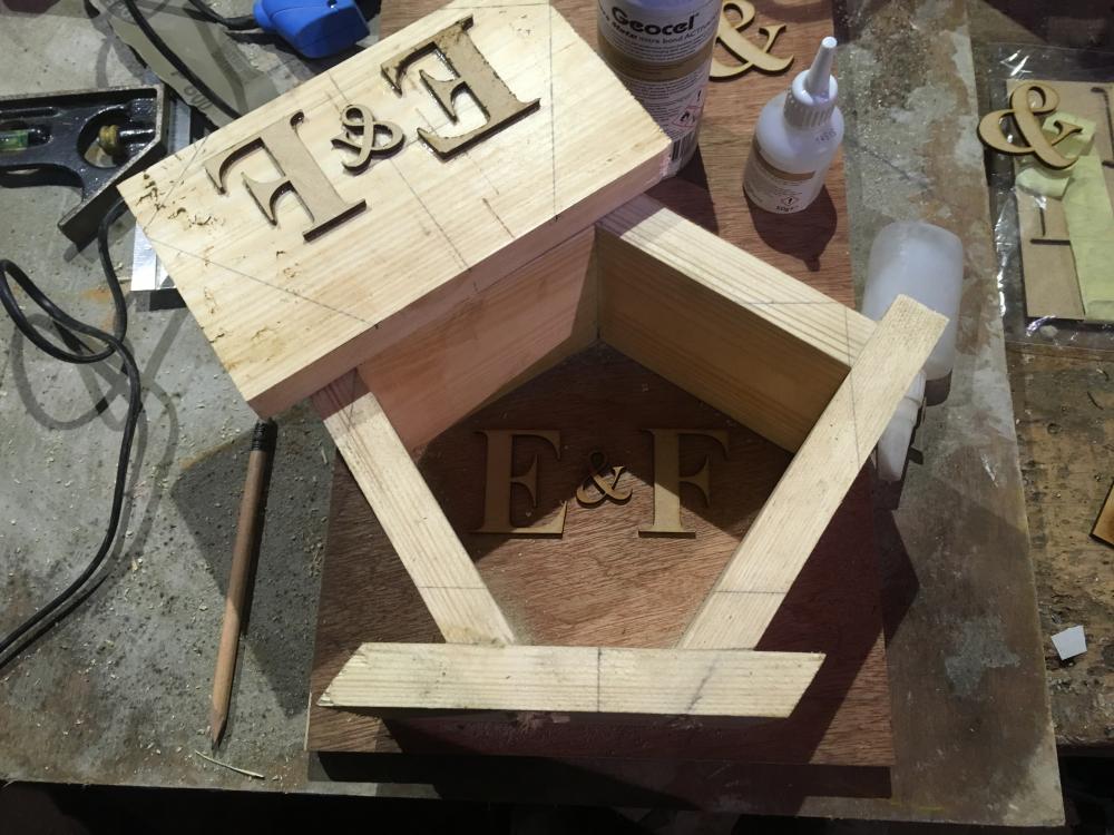

Construction Channel Posted February 17, 2017 Author Posted February 17, 2017 This is all you're allowed. The clay has been taking a while to dry but I think it is very nearly ready. There is a small chance I might have a first attempt this weekend ? 1
Triassic Posted February 17, 2017 Posted February 17, 2017 (edited) Shouldn't the letters be mirror image? edit .. just realised one set are! Edited February 17, 2017 by Triassic
Onoff Posted February 17, 2017 Posted February 17, 2017 20 minutes ago, Construction Channel said: This is all you're allowed. The clay has been taking a while to dry but I think it is very nearly ready. There is a small chance I might have a first attempt this weekend ? Bet you're bricking it..... 1
TerryE Posted February 17, 2017 Posted February 17, 2017 Ed, just a warning: physics is against you. Bricks are the aspect ratio they are to help minimise the distance from the centre to an outside surface to help make it easier to dry out. They often have holes running through them for the same reason. Your brick has a pretty uniform aspect so it is going to take a long time to dry out, and the inside will still be surprisingly damp when the surface looks bone dry. Bricks are often baked at low temperature for a bit or put in special drying ovens to remove the residual moisture before being fired properly. If you don't achieve this level of internal dryness, then the internal stream being generated when you attempt to fire it will probably cause it to crack up or at worst explode. Your lettering looks about 8-10mm deep, so one way of minimising all this is to make a brick that is only 25mm deep or so. As soon as it is dry enough, break it out if the mould and leave on a baking grid in a well aired place, but protected from rain etc., and since the moisture only has 12mm or so to travel to get out, then it should dry better. Once fired , there is nothing stopping you pouring in a 2:1 or even stronger mix into the mould and leaving 25mm gap at the top. Then wet the fired brick and lay it on it on top of the wet mix to bring it up to full width. No one will know the difference once it is cured and up. Any, carry on with what you are doing but just have this option as a back-pocket one.
Construction Channel Posted February 17, 2017 Author Posted February 17, 2017 Don't panic Terry I have already got a cunning plan for that issue. Essentially once I have got the brick and stamped the front I plan on cutting a fairly deep "frog" out of the back of it. ?

Construction Channel Posted February 17, 2017 Author Posted February 17, 2017 I have been considering release agent. But I haven't seen anyone else use it for bricks. All they seem to use is sand. I was intending to use brick dust for the first attempt. We will see how we get on. I'm not expecting this to work perfectly first time. It might which would be nice but I'm not holding my breath.
TerryE Posted February 17, 2017 Posted February 17, 2017 1 hour ago, Construction Channel said: I have been considering release agent. Cling film?
Construction Channel Posted February 17, 2017 Author Posted February 17, 2017 11 minutes ago, TerryE said: Cling film? lets not be silly about things.... in fairness it probably would work but i can almost guarantee it would leave a texture / the wrong look, If all else fails i will keep it in mind
