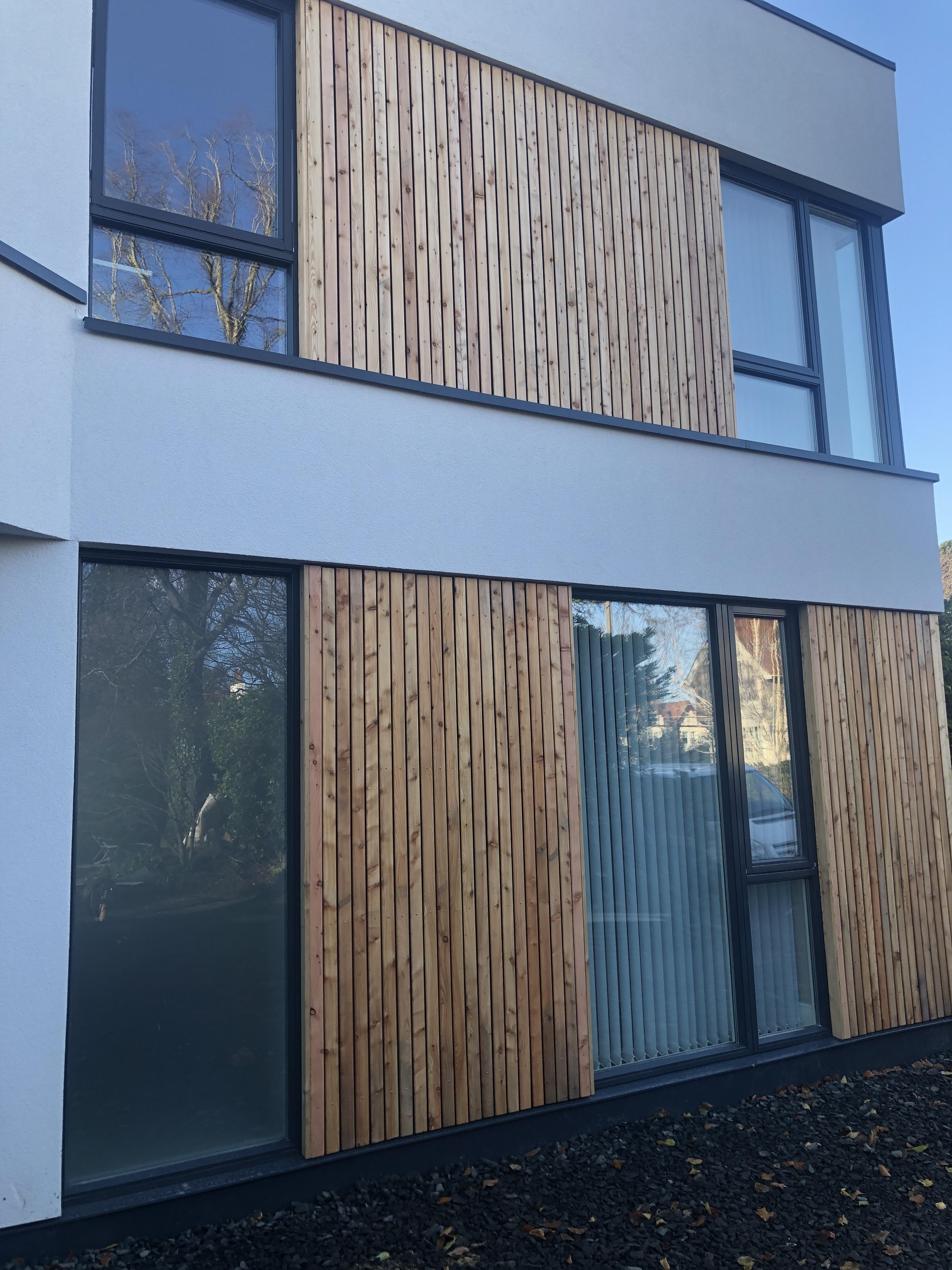

SuperJohnG Posted February 22, 2023 Author Posted February 22, 2023 Went perfect and looks mega. (Don't have a pic to hand). You can look on out Instagram self_build_ayrshire I used knauff aquapanel boards and TC15 k rend silicone render. It was expensive but I think worth it. I paid approx 50 sqm to have it rendered labour only. Was 25 quid per sqm for material. Those prices do not include the knauff boards or screws.
AliG Posted February 23, 2023 Posted February 23, 2023 We have done render on renderboards on my parent's house. Main reason was that we were limited on the width of the house and this saved space. Also we have a mixture of wood cladding and render and it makes it easier to see the wood behind the render. Looks great, however the cost of battening the frame and putting the boards on was crazy and I think it ended up considerably more expensive than blockwork would have been.
