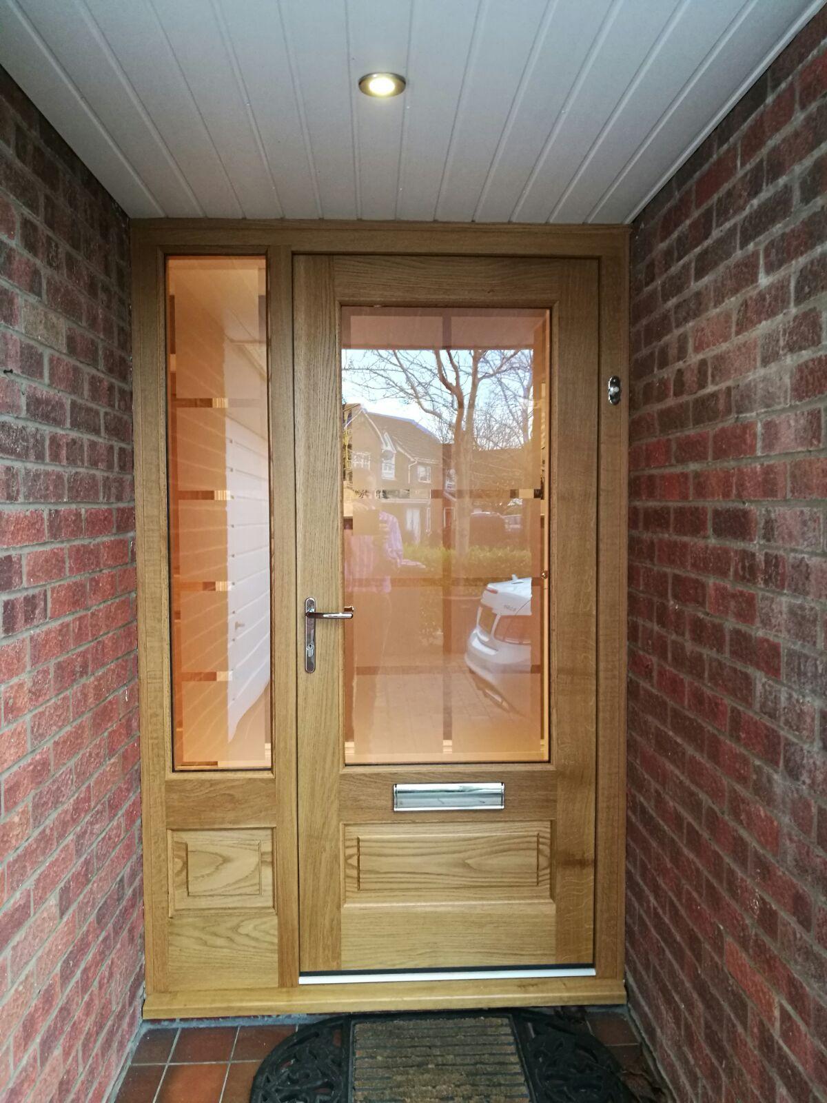

nod Posted June 27, 2020 Posted June 27, 2020 41 minutes ago, Bitpipe said: Ok, I concede the point - a good joiner could do it but you will need to be be clear on the requirements. This is one my friend made for me at our last house Cost me £300 plus the glass It sealed up pretty well But like Joe mine was under cover While we have a large oak canopy on our new house The front door is open to the elements and would be likely to sell or contract One advantage with a timber frame is if the seals become damaged or crack they are very easily replaced Unlike UPVC 2
