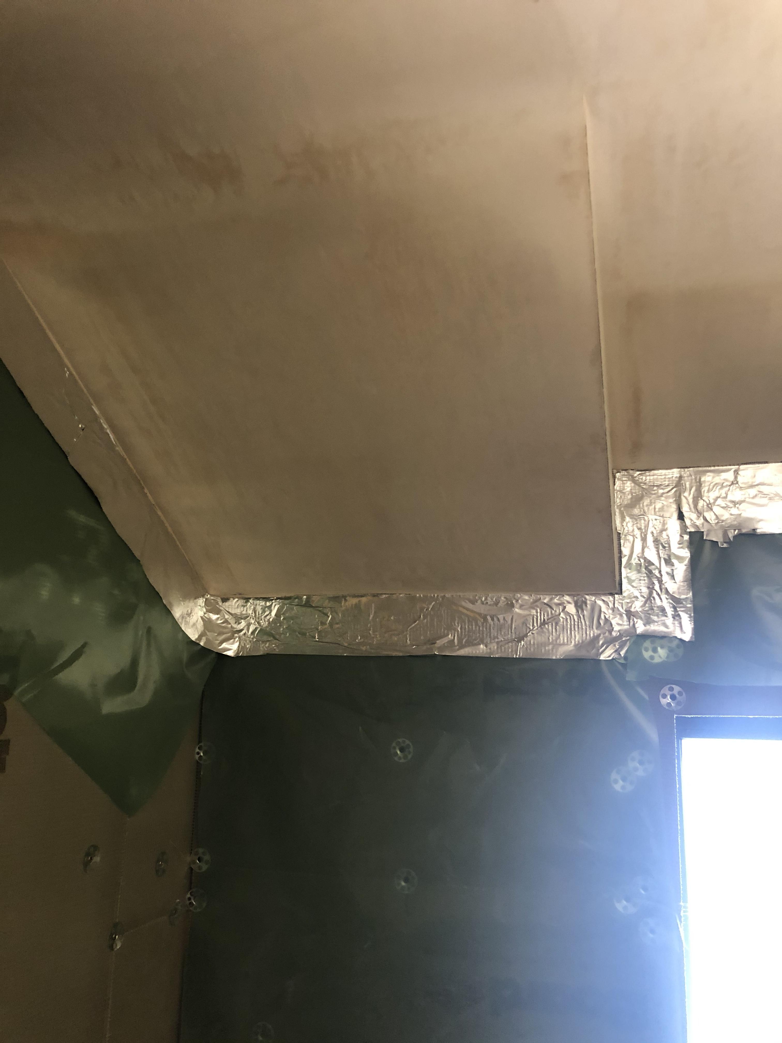

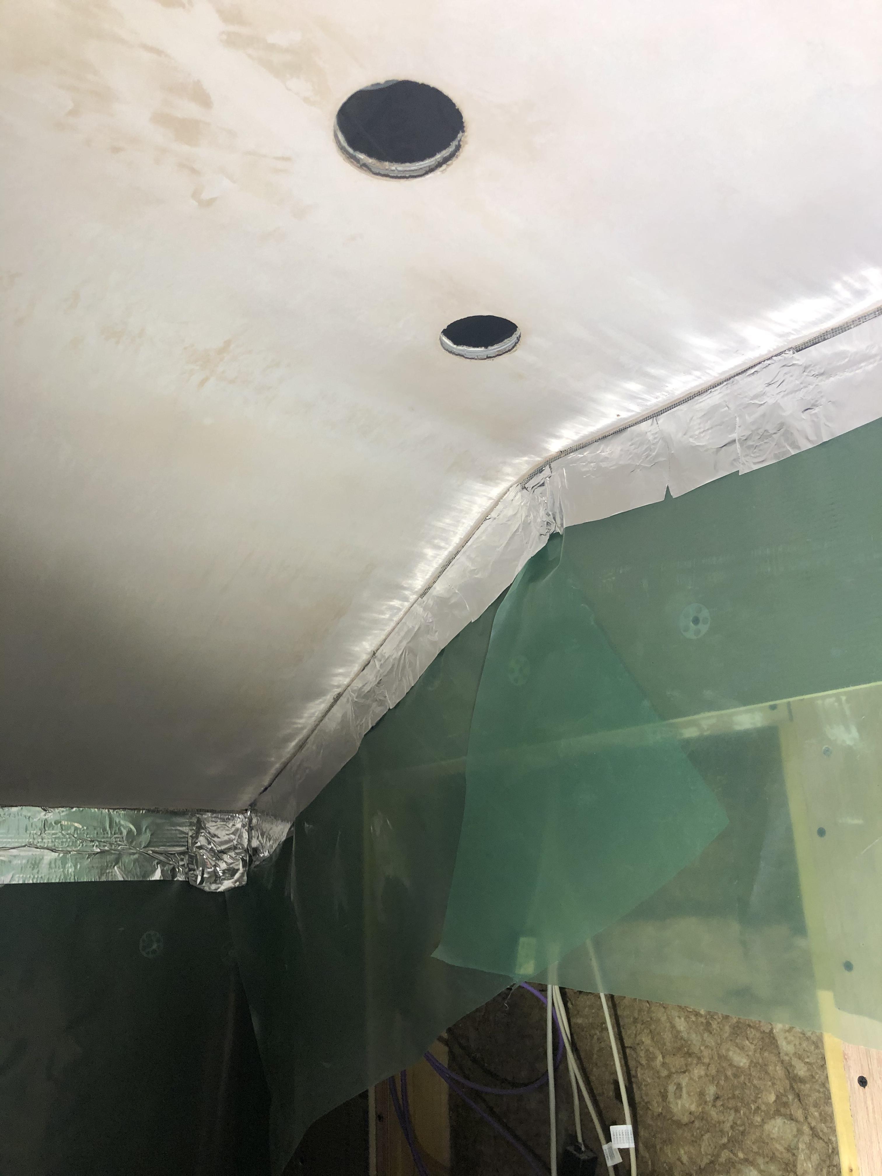

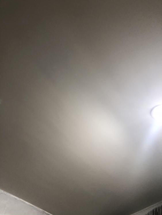

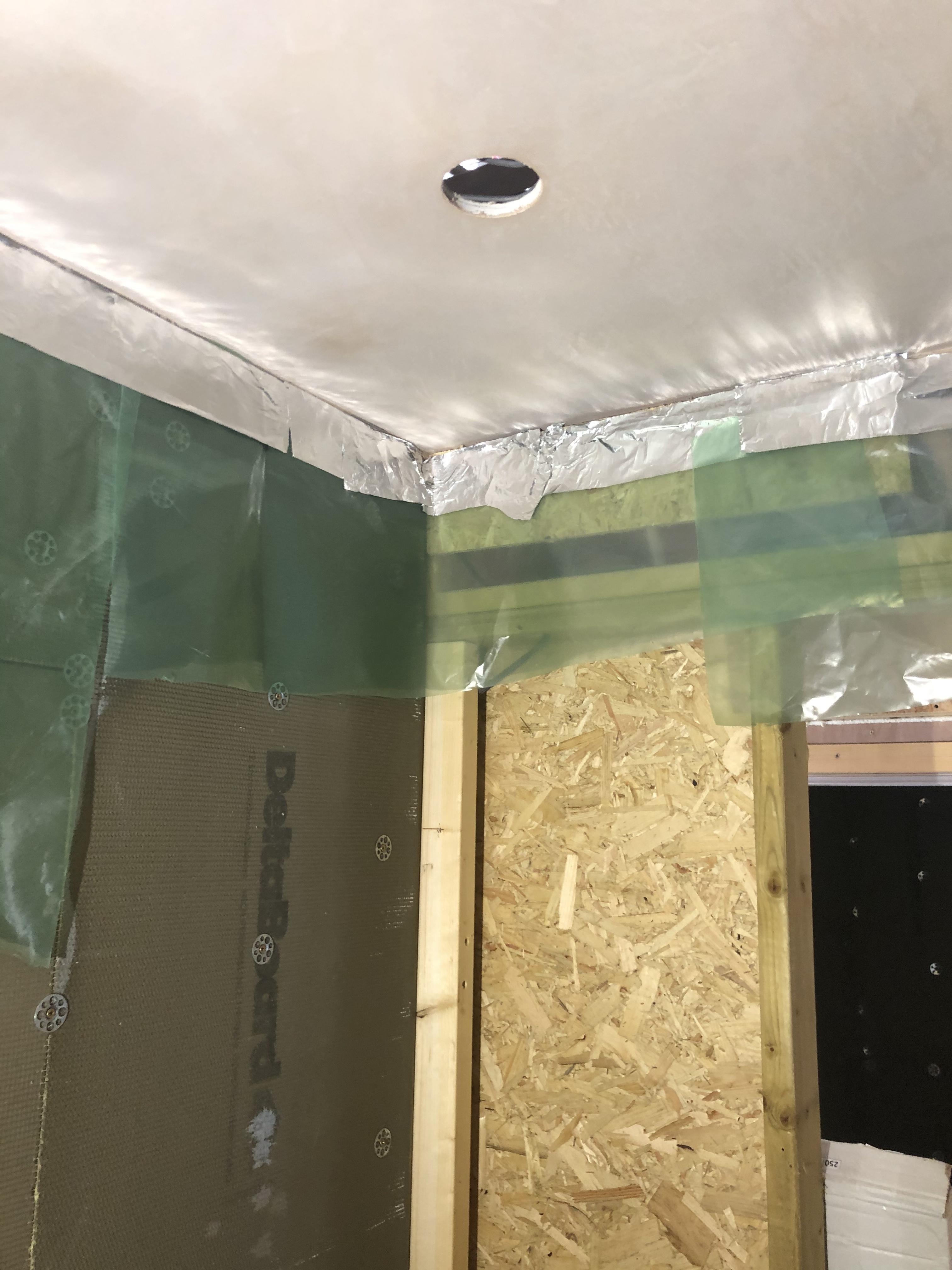

Pocster Posted June 23, 2020 Share Posted June 23, 2020 So ! I’ve probably gone overboard but have prep’d my bathroom ceiling and ensuite for spray painting . I’m assuming it will spray further than I think ! . Was worried if I got the paint on the delta board would prevent tiles from bonding to it . Going to use silk white paint from https://www.little-knights.co.uk antibacterial and wipe able . They suggested watering down by 10% for initial coats . I’m tempted to go 50/50 for initial 2 coats to seal the plaster . Link to comment Share on other sites More sharing options...
Pocster Posted June 23, 2020 Author Share Posted June 23, 2020 Filled all the holes Link to comment Share on other sites More sharing options...

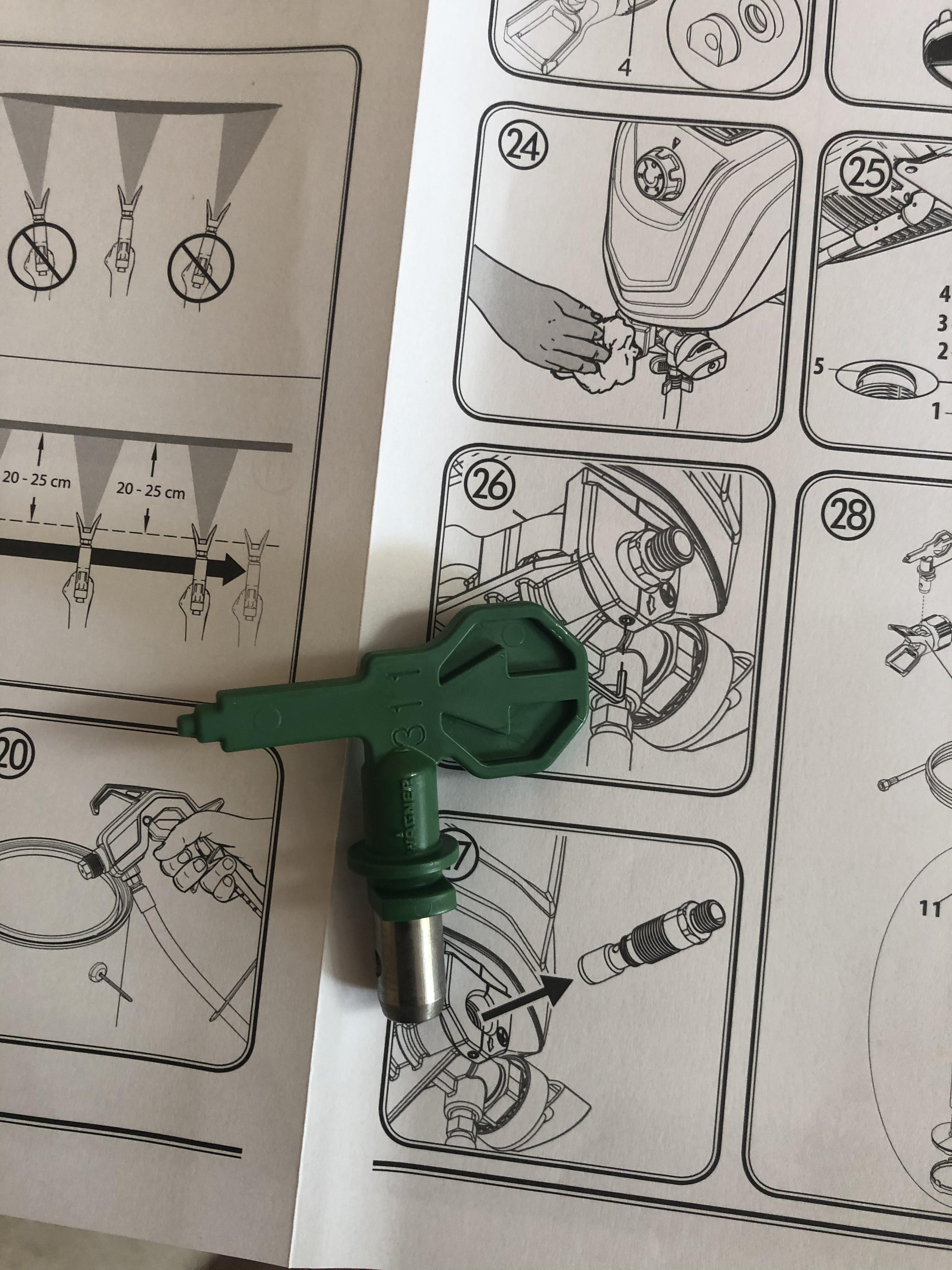

Pocster Posted June 23, 2020 Author Share Posted June 23, 2020 I don’t get the point of this key ? It doesn’t seem to fit in the hole above the nozzle and I don’t want to force it . Am I ok to just put water through this as a test ? Link to comment Share on other sites More sharing options...
bassanclan Posted June 23, 2020 Share Posted June 23, 2020 That "key" determines the spray flow and pattern. Usually you loosen the very end of the spray gun and it slots in from above. Water is fine to test Link to comment Share on other sites More sharing options...
Pocster Posted June 23, 2020 Author Share Posted June 23, 2020 1 minute ago, bassanclan said: That "key" determines the spray flow and pattern. Usually you loosen the very end of the spray gun and it slots in from above. Water is fine to test Thanks . I just worked out how to get it in . So it just faces forwards whilst spraying ? If turned completely ( arrow facing at user ) what’s it do then ? Any other advice before I commit ?? Notice the hose to gun fitting can unscrew as flex moves .... Link to comment Share on other sites More sharing options...

Pocster Posted June 23, 2020 Author Share Posted June 23, 2020 An email to super helpful Wagner clear up a few mistakes . The green ‘key’ actually effects the spray and you use the correct one for the thickness of paint / liquid . Obviously I had the wrong one installed . Also in the instructions they connect the gun straight to the hose . But it would seem you need to put the hea filter inbetween them ! . Now the hea filter may be red or white - struggling to open it without force too see what filters in there A few more Wagner questions then I’ll be ready for a water test .... ?? Link to comment Share on other sites More sharing options...
Ferdinand Posted June 23, 2020 Share Posted June 23, 2020 17 minutes ago, pocster said: An email to super helpful Wagner clear up a few mistakes . The green ‘key’ actually effects the spray and you use the correct one for the thickness of paint / liquid . Obviously I had the wrong one installed . Also in the instructions they connect the gun straight to the hose . But it would seem you need to put the hea filter inbetween them ! . Now the hea filter may be red or white - struggling to open it without force too see what filters in there A few more Wagner questions then I’ll be ready for a water test .... ?? So that is te various sizes of pinhole the paint goes through. 1 Link to comment Share on other sites More sharing options...

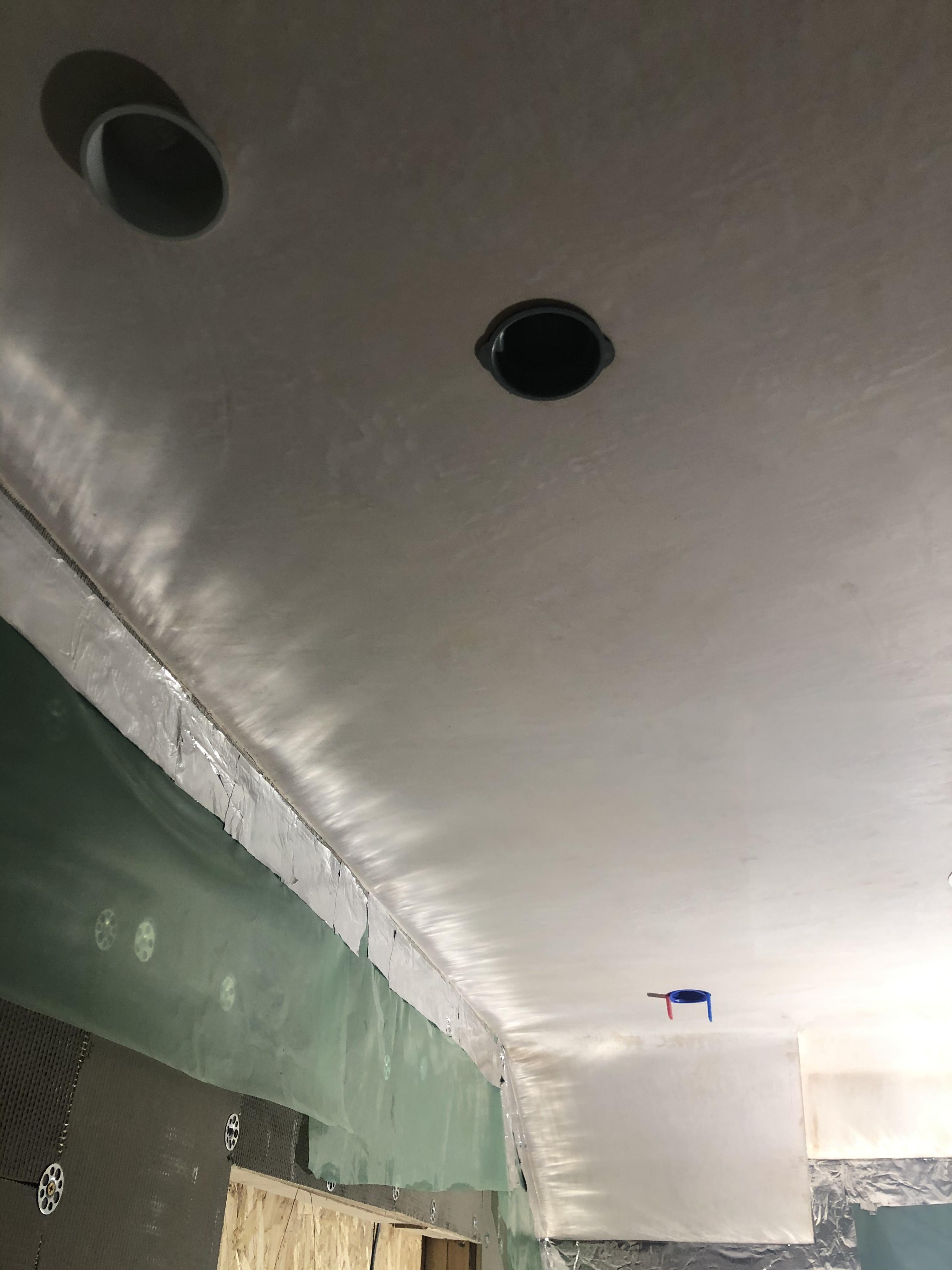

Pocster Posted June 24, 2020 Author Share Posted June 24, 2020 (edited) Well ! Glad I did a water test ! Initially you hold the gun over a bucket as you prime . Instructions say once the fluid comes out to stop and attach the nozzle . Needless to say I continued holding until the gentle stream turned into a Niagra falls under pressure ! . Just got a bit wet - if it had been paint then I would have painted the room I think in about 2 seconds in a rather uncontrolled manner !! Will run through the procedure once more . Surprised how wide the spray is ( against some ply as a test ) but can also see how even it is !! Edited June 24, 2020 by pocster 1 Link to comment Share on other sites More sharing options...
bassanclan Posted June 24, 2020 Share Posted June 24, 2020 The width of the spray is determined by the "key" or spraying tip you have. You need the right tip for the right paint/application 1 Link to comment Share on other sites More sharing options...
