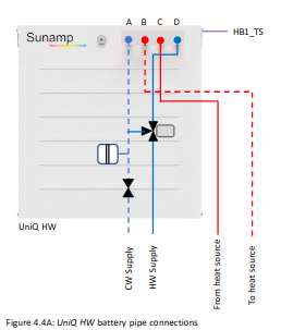

Marco Van Bowden Posted June 22, 2020 Share Posted June 22, 2020 Hi, Looking at a Sunamp and not really getting anywhere fast ? Hoping to tap into people's knowledge please!?? I have a 3 bed semi that is effectively morphing to six bed 3.5 bathroom home. I want a Sunamp, after having seem them via fully charged years ago. The corgi registered plumber (via the builder) is a nice enough chap, but not really interested in reading page after page of manuals about a product he has never heard of vs putting in a megaflo that's he's done hundreds of. The plan is to use the existing 24kw combi to charge the Sunamp, and have the Sunamp do the hot water for the house. The combi itself (as I'm on mains gas) doing the heating. Plumber wants to know how to plumb things in. Which seems pretty reasonable to me! Sunamp seems to want to sell me a solution, whereas, I just need a product, if that makes sense? Anyway, what does your respective collective knowledge say? And is there a way to private message people on here?? As I see a few threads from 2017, 2018 and thought best to start a new vs trying to bring them back to life. Any all help welcome Link to comment Share on other sites More sharing options...
PeterW Posted June 22, 2020 Share Posted June 22, 2020 Welcome.. That may need more than one sunamp if you're after enough hot water to service 3 showers in a six bed house. This also assumes you have enough water pressure and flow rate to service that sort of arrangement. Assuming you want 2 UniqHW12 then it is as simple as having a pair of zone valves and the correct settings in the controller which is effectively setting a few DIP switches. As per the manual this is the schematic for the one UniqHW, 2 is just do it in parallel. Your only restriction may be the boiler will not provide enough heat as you cannot use the hot water circuit, you will be using the heating circuit to supply heat to the sunamps and it will be close as to whether it can give you the flow - and the heating to the house - from an old 24kw combi. If you're doing this as big extension etc, and are prepared to pay north of £4,500 for the sunamps, why not upgrade to a system boiler for an extra £12-1500..?? Link to comment Share on other sites More sharing options...

PeterW Posted June 22, 2020 Share Posted June 22, 2020 2 minutes ago, Marco Van Bowden said: Octopus tells me the grid is giving away free electricity again, and I'll charge the Sunamp from electric instead. Or will I? More reading to be done... ? Not with a Uniq12HW, you would need a Uniq12HW+i to use the electric heater, and then I'm not 100% sure how you can override it to call for electric heating not gas. A 12kw has a theoretical supply of 370 litres at 40c. The downside is a lot of new showers expect the water at a minimum 45c so you're borderline getting 280 litres out of it. Could use 2 9's but it is the control that will be the hardest. Other than the gadget factor, any reason for not going with a 400 litre UVC..? Link to comment Share on other sites More sharing options...

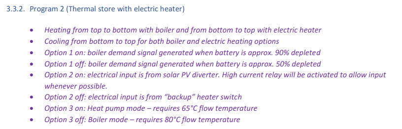

Marco Van Bowden Posted June 23, 2020 Author Share Posted June 23, 2020 (edited) WOW! You boys have been busy, I feel honoured! Thanks lads ? @Nick, on the assumption you know, when does the SA call for more heat? Straight away, or as PeterW has suggested?? And with in that, if the LPC is being used to charge the SA (vs the +i) what is the charge time? Conversely, what is the charge time via the +i? For a SA 12?? @PeterW you make a good point, but as I've already said, we don't use a massive amount of water. In the last year we have never gone over 1,100 liters in a day, and only gone over 1,000 liters one a handful of occasions. I freely admit that the main draw card for me is "set and forgot" so if we say the SA is what, round numbers, £2,500 and a 300L megaflo is what... £1,250 it's the maintenance thing. I do like the scalability of the thing, so if (and I do honestly doubt this) I find I need more hot water, surely the SA is more scalable, yes? Oh, and the combi is only being retained as it's done very little work, and well... When it dies perhaps it'll be upgraded, but until then... Why not use it?? ...and yeah, the combi will feed the kitchen sink. PS - House is a long way off passive, but it is over regs. Edited June 23, 2020 by newhome Edited out quote as requested Link to comment Share on other sites More sharing options...
PeterW Posted June 23, 2020 Share Posted June 23, 2020 37 minutes ago, Marco Van Bowden said: @Nick, on the assumption you know, when does the SA call for more heat? Straight away, or as PeterW has suggested?? It is in the MIs that I linked, see the extract below from page 10 - you set it to call for heat at either 50% or 90% Link to comment Share on other sites More sharing options...
Nickfromwales Posted June 23, 2020 Share Posted June 23, 2020 4 hours ago, Marco Van Bowden said: what is the charge time? From a boiler, it’s subject to / affected by the flow temp. With the immersion it’s roughly a kW in per hour so via the ~3kW immersion heater a 12 should reheat from zilch in a bit over 4 hours, in practice I think it’s a bit quicker, but then it does hold around 14kWh of heat energy when heated by a premium heat input. Well matched to be sucked dry by the evening bathing and reheated at midnight on Octopus, or other cheap tariff. If you have any PV then that reliance on the full recharge should reduce in the summer. Link to comment Share on other sites More sharing options...
