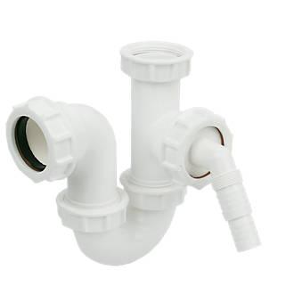

Roz Posted June 21, 2020 Share Posted June 21, 2020 Is there a maximum run a dishwasher waste can run? Can you get extenders? I need to run around a corner and haven't got the dishwasher yet so not sure about the hose length. And am I right in thinking it doesn't need to follow the same fall guidelines as normal waste? And it can just pop straight into this if I fitted this ready for it? Thanks Link to comment Share on other sites More sharing options...
PeterW Posted June 21, 2020 Share Posted June 21, 2020 You can buy hose extensions but make sure you can access the joint just in case. Can you not run a 32mm waste to where you want and add a running trap that is accessible..? You can always use a hose connector on the trap to connect the dishwasher waste 1 Link to comment Share on other sites More sharing options...
Roz Posted June 22, 2020 Author Share Posted June 22, 2020 15 hours ago, PeterW said: You can buy hose extensions but make sure you can access the joint just in case. Can you not run a 32mm waste to where you want and add a running trap that is accessible..? You can always use a hose connector on the trap to connect the dishwasher waste I could run it a little way but not sure I would get around the corner, I'll have a look! Link to comment Share on other sites More sharing options...
ProDave Posted June 22, 2020 Share Posted June 22, 2020 1 minute ago, Roz said: I could run it a little way but not sure I would get around the corner, I'll have a look! Where does the waste pipe originate from? Usually it comes up out of the floor, so you have plenty of room to run the waste under the kitchen units. 1 Link to comment Share on other sites More sharing options...
Roz Posted June 22, 2020 Author Share Posted June 22, 2020 1 minute ago, ProDave said: Where does the waste pipe originate from? Usually it comes up out of the floor, so you have plenty of room to run the waste under the kitchen units. It's not there yet, so I might be able to make that work actually! Link to comment Share on other sites More sharing options...
ProDave Posted June 22, 2020 Share Posted June 22, 2020 3 minutes ago, Roz said: It's not there yet, so I might be able to make that work actually! You might be able to do it under the units as a straight run, avoiding a tight bend round the corner. 1 Link to comment Share on other sites More sharing options...
Russell griffiths Posted June 22, 2020 Share Posted June 22, 2020 When you get the dishwasher in the instructions it normally has a pic of pipe orientation, some manufacturers like a certain route for the pipe, like on a washing machine. 1 Link to comment Share on other sites More sharing options...
MikeGrahamT21 Posted June 22, 2020 Share Posted June 22, 2020 I got an extension for mine to plumb into kitchen waste, so that I only have a single penetration through the structure, runs under the units and then up the back of sink unit, seems to work quite well. 1 Link to comment Share on other sites More sharing options...
