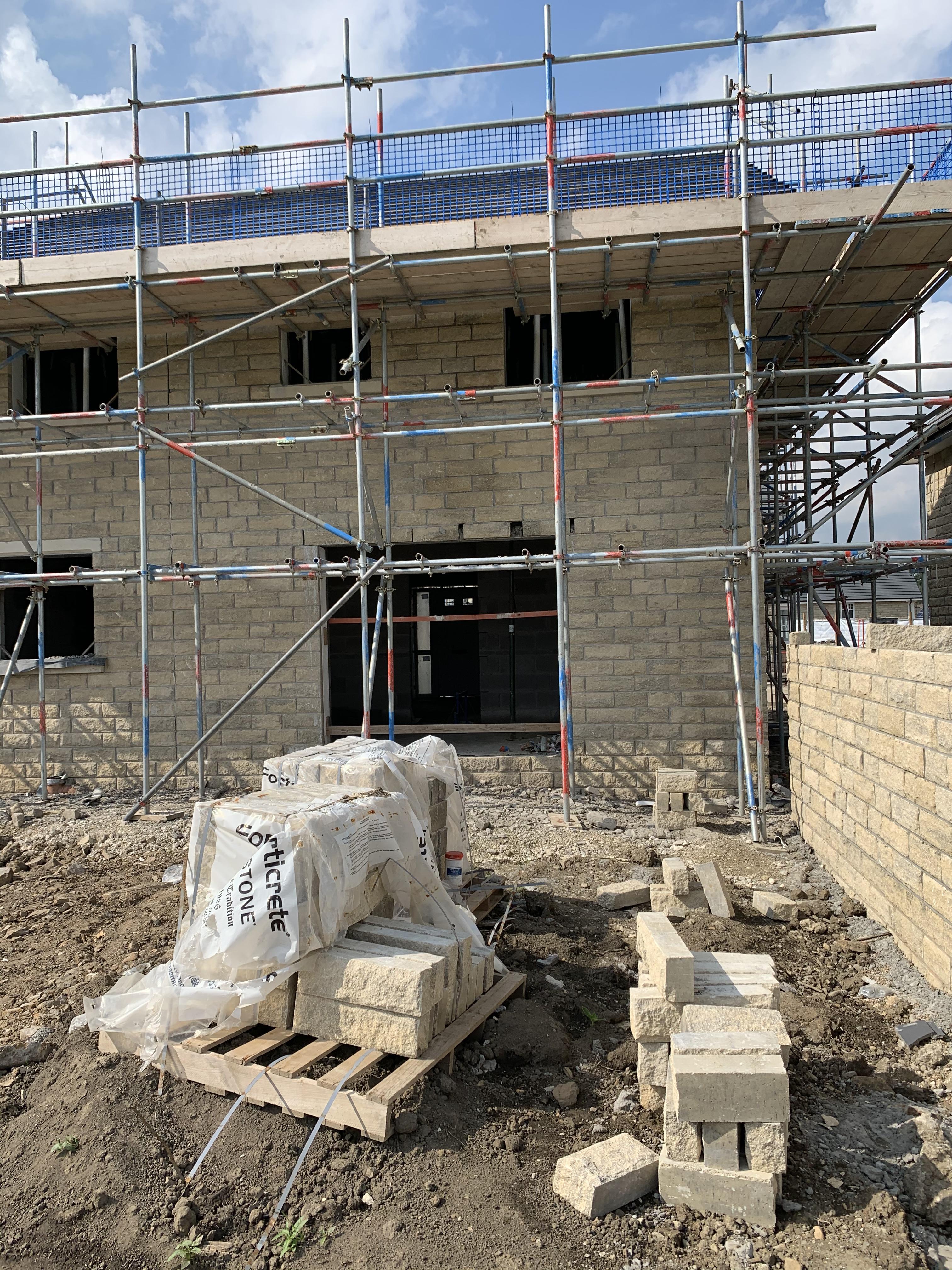

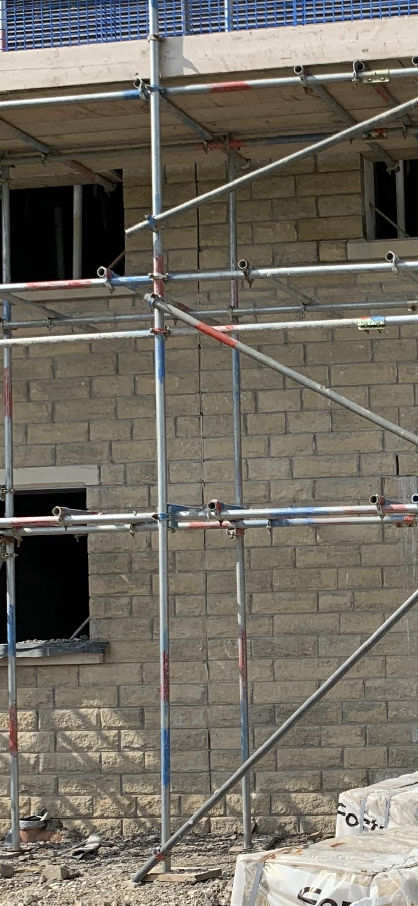

Bigeara87 Posted June 19, 2020 Share Posted June 19, 2020 Hello all, my partner and I have recently bought a new build house, and she asked me a question about the build which I had no idea about... There is part of the external wall, to left of the french door opening, where it appears that there is a vertical line in the bricks from the top of the house to the bottom. Does anybody no what this is for? Why is this part stacked differently to all the rest? Could this affect the integrity of the build? Thanks for any replies Link to comment Share on other sites More sharing options...
Patrick Posted June 19, 2020 Share Posted June 19, 2020 Doesn't look quite right. But brickies on here might know more. Also above the French doors. Gap in the brick work that (hopefully) covers the lintel. Link to comment Share on other sites More sharing options...
ProDave Posted June 19, 2020 Share Posted June 19, 2020 Isn't that an expansion gap? Link to comment Share on other sites More sharing options...
MikeGrahamT21 Posted June 19, 2020 Share Posted June 19, 2020 (edited) Looking at the size of the facade, i'd say expansion gap, should be every 6m. Gaps above the french doors, will be for weep vents, though why there is random size and place gaps further to the right is beyond me, thats poor workmanship Edited June 19, 2020 by MikeGrahamT21 Link to comment Share on other sites More sharing options...
Temp Posted June 19, 2020 Share Posted June 19, 2020 Our BCO said walls over 11-12 meters long need an expansion gap so we have one on the back of our house. (Elsewhere I've seen 15m mentioned). Makes sense for it to be more or less down the middle. Link to comment Share on other sites More sharing options...

Temp Posted June 19, 2020 Share Posted June 19, 2020 (edited) I notice you have a stone lintel above the window on the left. It's possible they plan to insert another above the patio door later. (Eg they didn't have one when they were building that section hence the untidy spacing and gaps). I would question them on this and make sure it gets done. Wouldn't want them to go out of stock so you get one that doesn't match. Edited June 19, 2020 by Temp Link to comment Share on other sites More sharing options...
nod Posted June 19, 2020 Share Posted June 19, 2020 Expansion join Every 8mtres Link to comment Share on other sites More sharing options...
