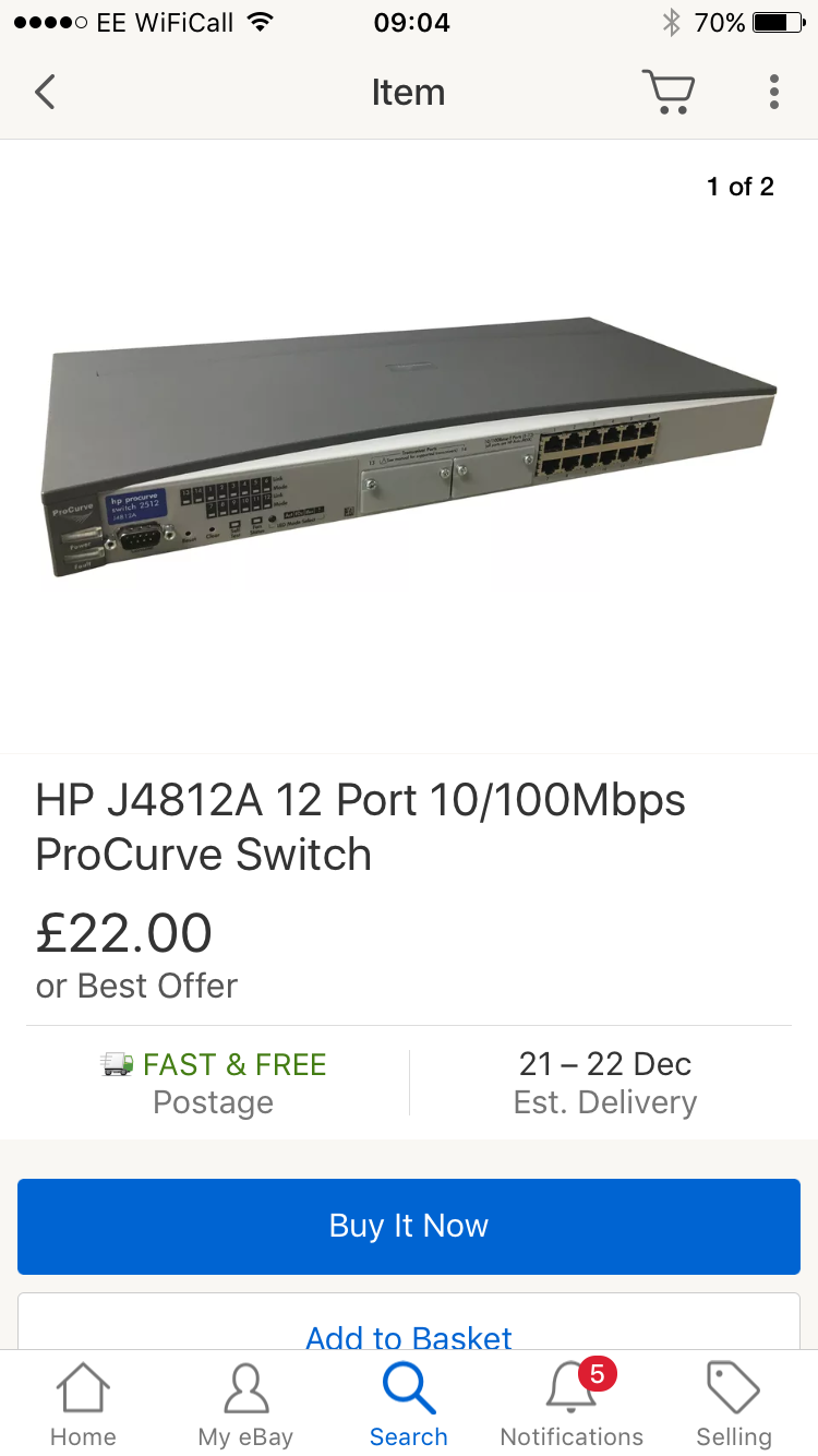

Nickfromwales Posted December 19, 2016 Author Share Posted December 19, 2016 How about this? 8 ports prob won't suffice. Seller refirbished with returns ? Link to comment Share on other sites More sharing options...
Guest Alphonsox Posted December 19, 2016 Share Posted December 19, 2016 5 hours ago, Nickfromwales said: How about this? 8 ports prob won't suffice. Seller refirbished with returns ? Link to comment Share on other sites More sharing options...

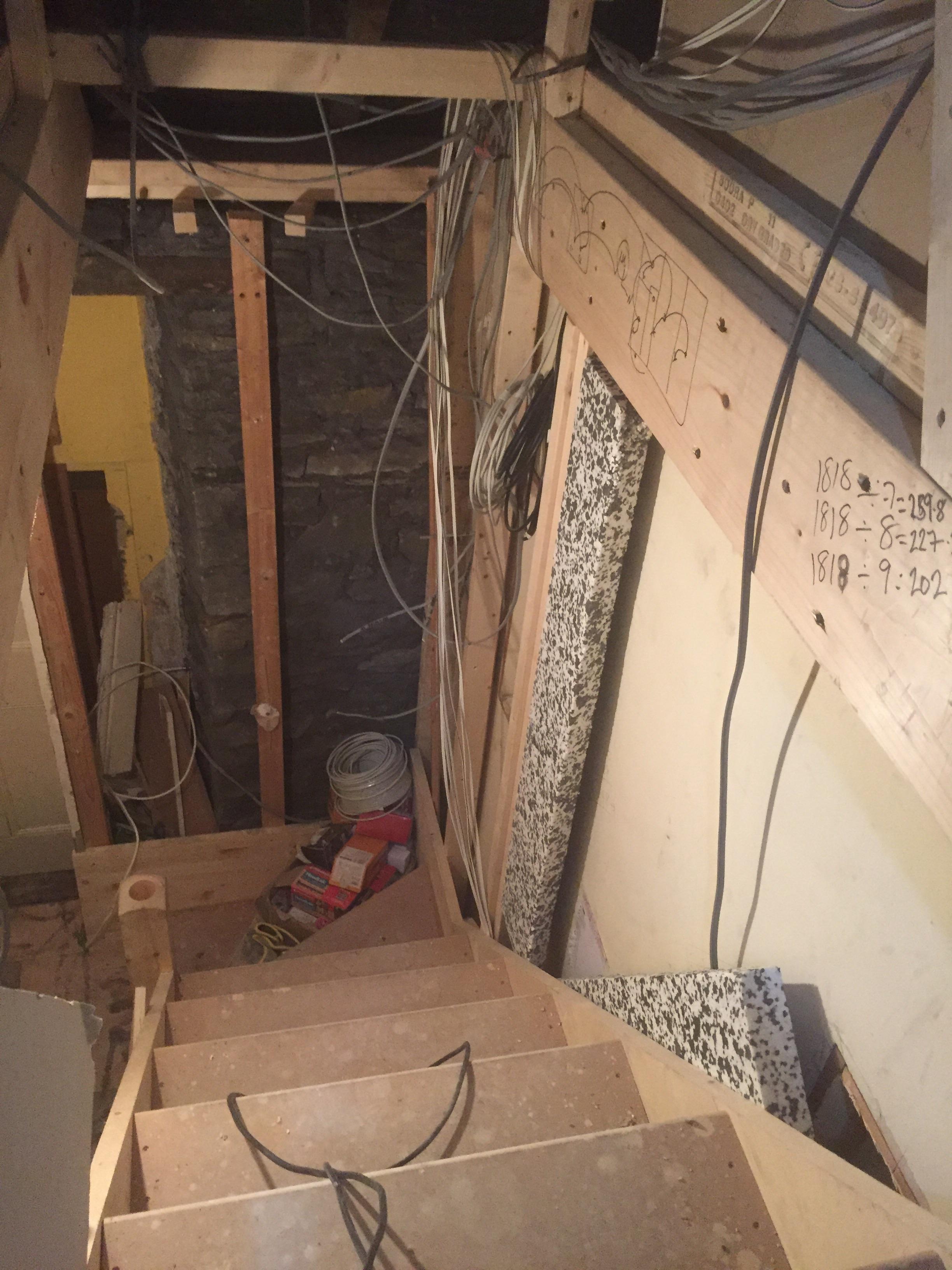

Nickfromwales Posted December 19, 2016 Author Share Posted December 19, 2016 Cat5 coming out and cat 6 going in If I don't get my finger out I'll be neck n neck with @Onoff's bathroom Link to comment Share on other sites More sharing options...
Guest Alphonsox Posted December 19, 2016 Share Posted December 19, 2016 Not a good choice - this is a managed switch as used in professional set-ups. They are complete overkill for what you need and require networking knowledge to set up and control. The ones linked to above are unmanaged and are "plug and play" Link to comment Share on other sites More sharing options...
Nickfromwales Posted December 19, 2016 Author Share Posted December 19, 2016 Many thanks. So 'unmanaged' is the one for me. Few heads better than one ☝️ Link to comment Share on other sites More sharing options...

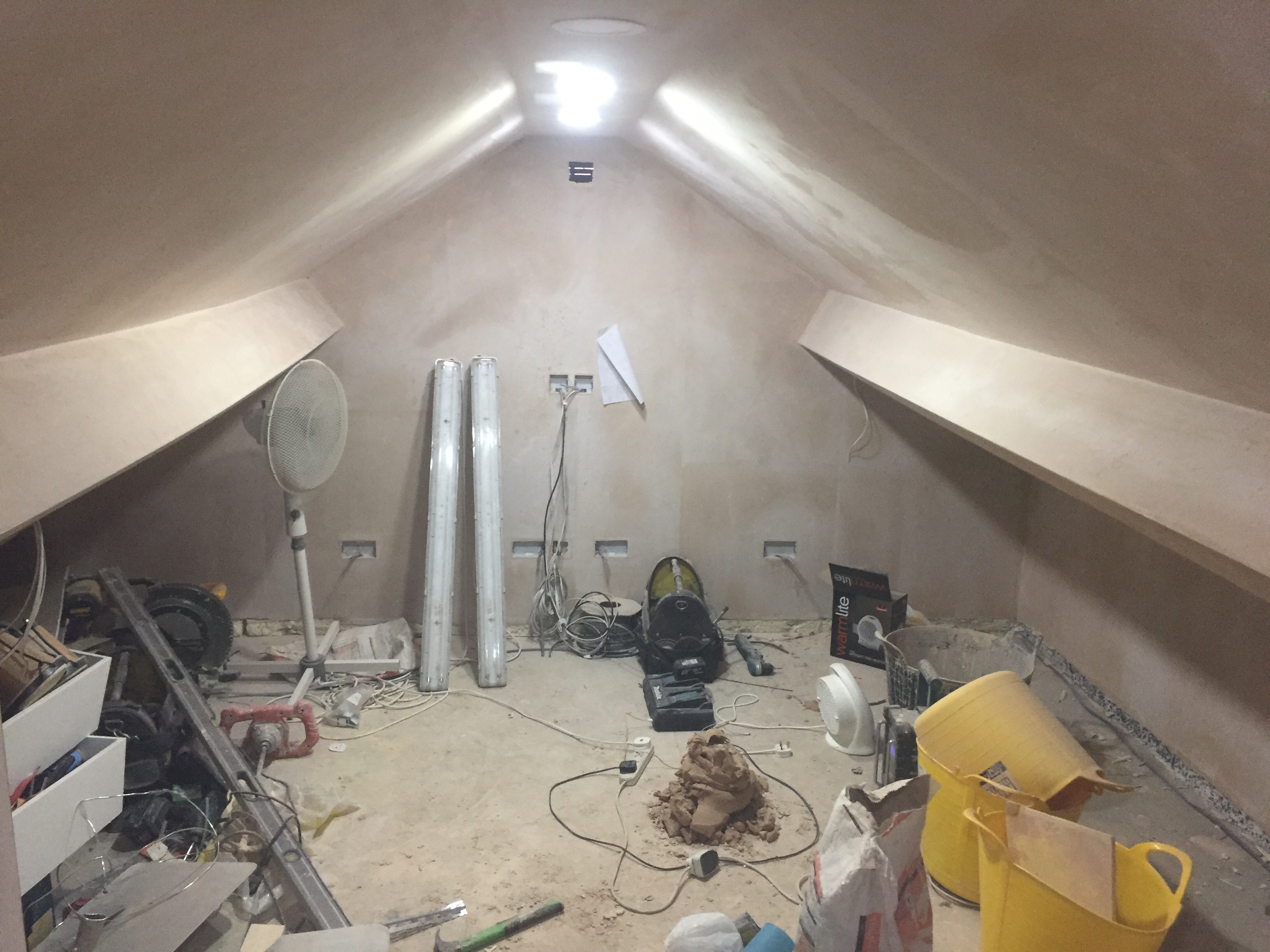

Nickfromwales Posted December 20, 2016 Author Share Posted December 20, 2016 Just checked the bank. Soldering iron is coming out later and I'm hooking up the original ones for January. F@@@ it, only so much I can do. In 4 weeks this went from rockwool and junk to this Not bad considering I kept regular job going as well. Has a good mate help in evenings and weekends. Bribed sufficiently ???? Back to sanding ?????? 1 Link to comment Share on other sites More sharing options...

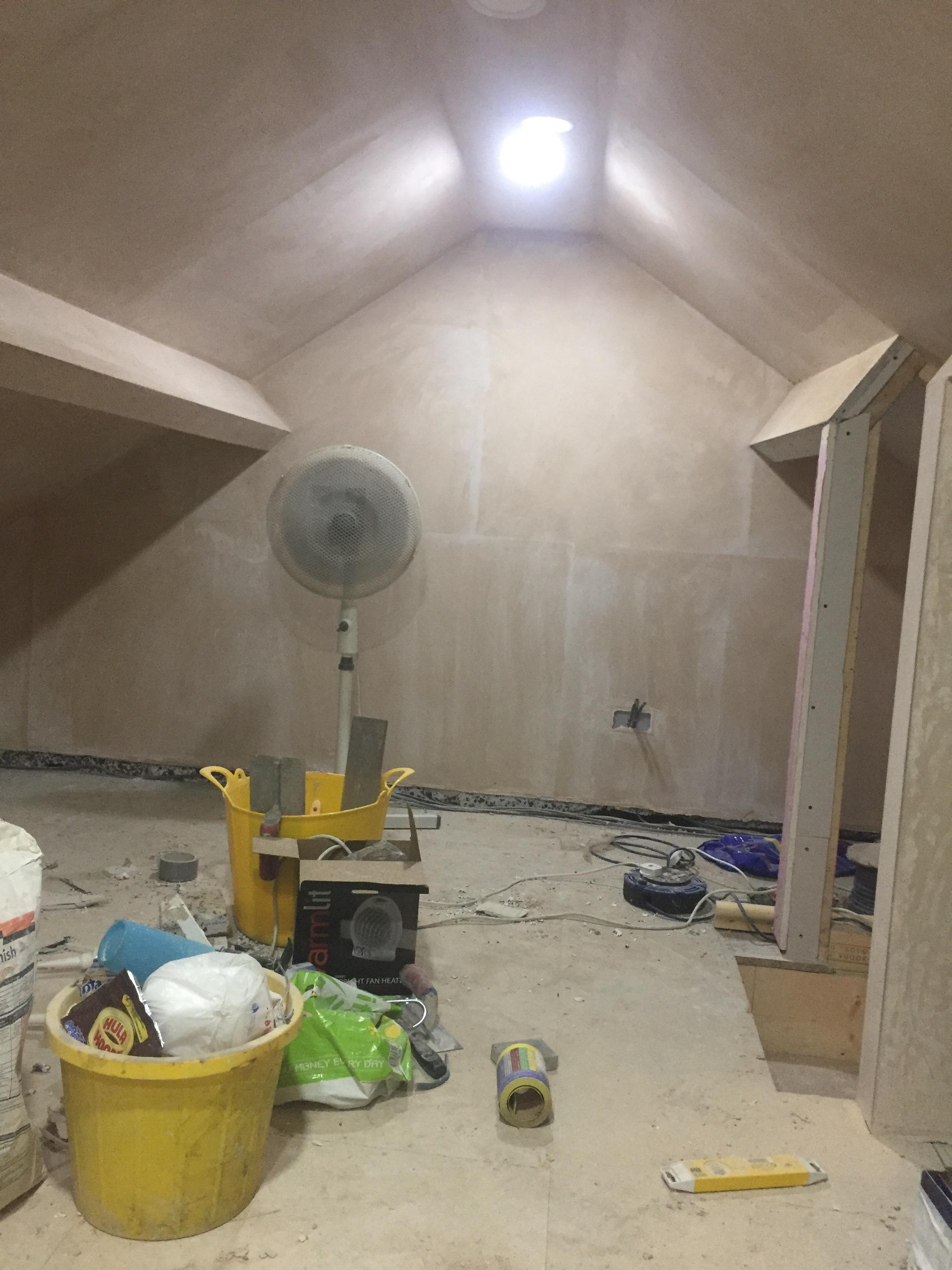

Nickfromwales Posted December 20, 2016 Author Share Posted December 20, 2016 Sanding done. Now to clean, and clean, and clean ...........? Link to comment Share on other sites More sharing options...
