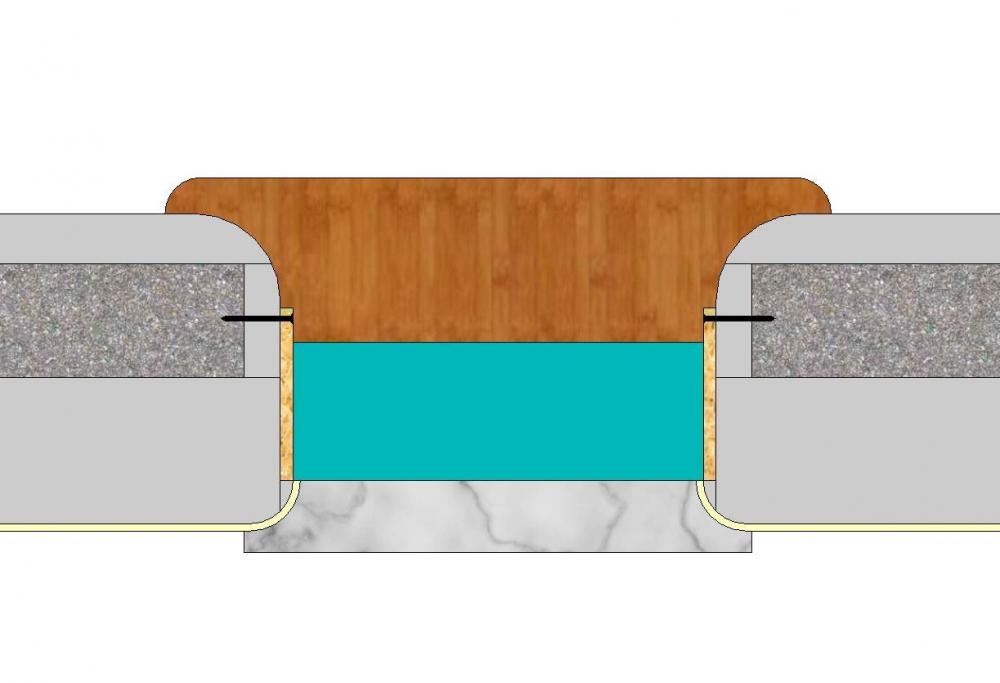

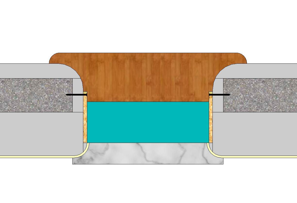

Reiver Posted June 19, 2020 Author Posted June 19, 2020 So I sketched up what might be needed to give a decent splay and it's a fair thickness of material, between 100 and 150mm depending on the angle and the exact position of the window in the aperture, the larger thicknesses look better but eat up more aperture obviously. This is going to make fixing direct into a solid part of the ICF somewhat difficult, so whatever "packing" material is used either side of the frame to make the splays will have to be strong enough to support them, and I guess will need to have suitable insulating properties. Would the lightweight (0.11 W/mK) AAC blocks do I wonder?? or wood? HD polyurethane foam (like tooling board) would be another option and strong enough to take fixings, but is fearfully expensive.
