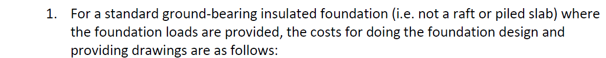

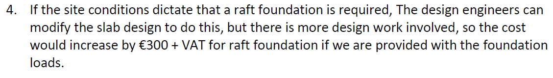

SuperJohnG Posted June 12, 2020 Share Posted June 12, 2020 I have been gathering prices from the usual suspects (Kore, isoquick, Izodom) for my insulated raft foundation. I thought i was up to speed however Kore has just thrown me off a little with the engineering costs sheet they supplied. (See attached) and below for the two specific paragraphs. So when we are talking Kore type - insulated foundations, when is a ground bearing insulated foundation, not a insulated raft? Insulated Foundation Engineering costs (One off).pdf Link to comment Share on other sites More sharing options...
nod Posted June 12, 2020 Share Posted June 12, 2020 Looks expensive just for design I would gave thought calcs would be in the first figure Link to comment Share on other sites More sharing options...
PeterW Posted June 12, 2020 Share Posted June 12, 2020 They mean if they have to calculate complex loads across mixed substrates such as made ground or different gravels etc. TBH that is a very good price anyway - £1000 all in, even if you need a raft..?? Link to comment Share on other sites More sharing options...
SuperJohnG Posted June 12, 2020 Author Share Posted June 12, 2020 It costs for engineering hence it is calcs. Cheaper than what I had been told to budget at £2500 by everyone. But still nobody any difference between the two things.? Link to comment Share on other sites More sharing options...
PeterW Posted June 12, 2020 Share Posted June 12, 2020 A raft is normally a thickened edge with steel etc that is designed to work as a stressed member. An insulated slab is just that - a slab of concrete with mesh in it and pretty much that’s it. 1 Link to comment Share on other sites More sharing options...
