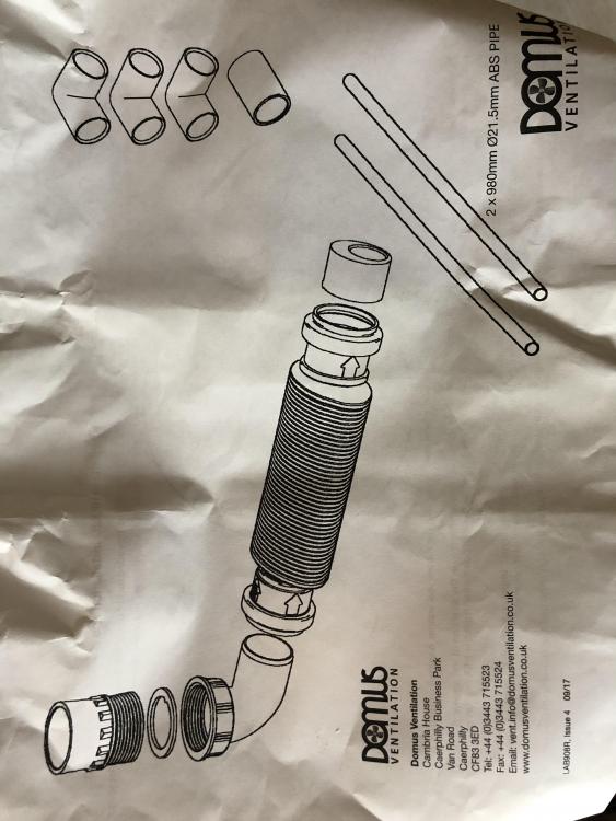

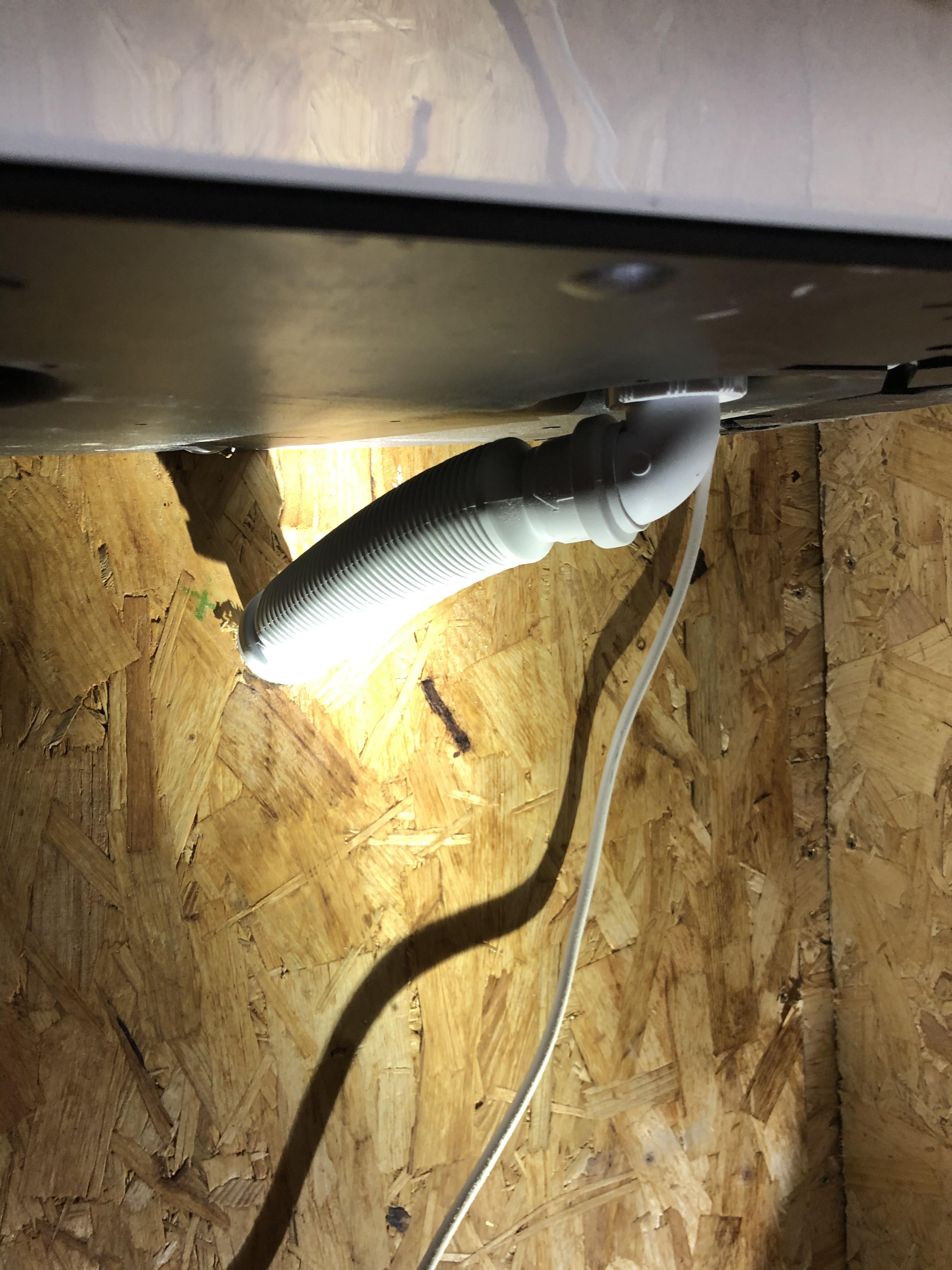

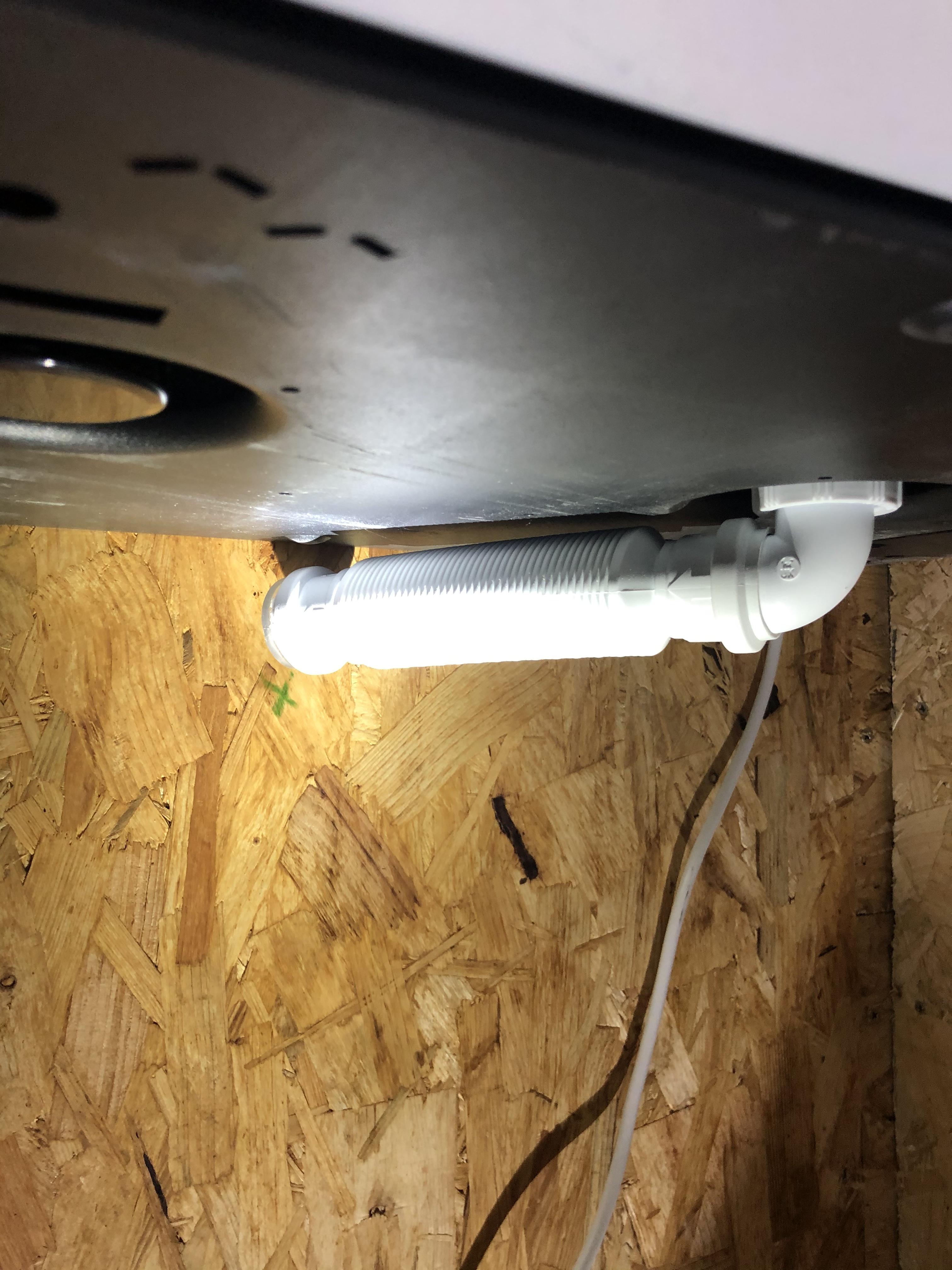

Pocster Posted June 3, 2020 Author Posted June 3, 2020 The parts supplied for the drain don’t fit ( always worries me when official parts don’t seem right ) Anyway this is the drain ( yes , the arrow is facing the right direction ? ) . Green X marks my drill hole to the outside world

CC45 Posted June 3, 2020 Posted June 3, 2020 I'd make the pipe exiting the warmer area to the outside much bigger than 21.5mm - prob adapt it up to 40mm. Just in case it freezes as it hits the outside, I wouldn't want it backing up .... 1

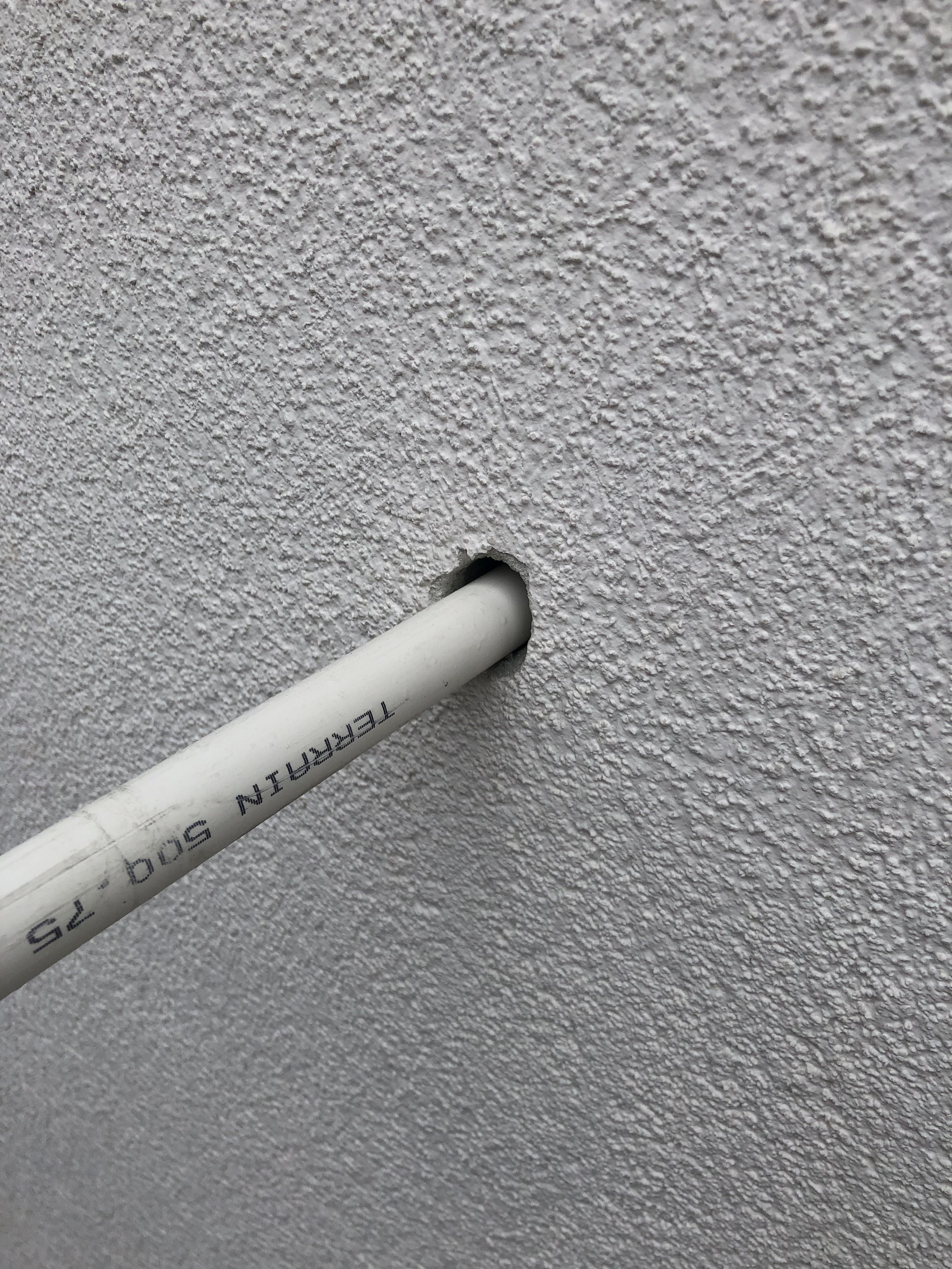

Pocster Posted June 3, 2020 Author Posted June 3, 2020 All done . I’ll just glue a 90 on the end outside . What’s the best way to patch round the hole ? Or is the answer white ct1 ?
PeterW Posted June 3, 2020 Posted June 3, 2020 6 minutes ago, pocster said: All done . I’ll just glue a 90 on the end outside It is supposed to run to a drain..? That will run and stain the wall
Bitpipe Posted June 3, 2020 Posted June 3, 2020 My MVHR condensate joins the gas boiler condensate in a chamber pump in basement plant room and is then delivered to foul drain at ground level. Airtightness and cold bridging aside, I know that external condensate pipes are prone to freezing in winter and this is a frequent cause of gas boiler failures. Easy to fix by warming the external pipe if you remember that this is the issue. Question is whether a MVHR would be similarly impacted.
Pocster Posted June 3, 2020 Author Posted June 3, 2020 13 minutes ago, PeterW said: It is supposed to run to a drain..? That will run and stain the wall I’ll 90 it then pipe down the external wall
