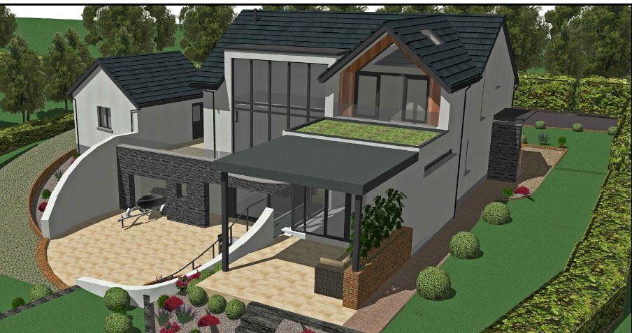

Conor Posted May 28, 2020 Posted May 28, 2020 (edited) Our build start is hopefully impending in the next few weeks... as we're doing ICF, we'll be at roof level before we know it! So I need to have a PV design sorted sooner rather than later. We're using a Thermohouse EPS roof panel system - approx 250mm think EPS sheets with steel reinforcement. We'll have a narrow service void below this (max 50mm, more like 25mm), but otherwise all ceilings will be vaulted and no attic space. Panels will be mounted in a GSE in roof system. We'll have 8 panels on our south facing roof, and 8 more split between east/west roofs - 5kWp total. (this is because we can only fit 8 on the main roof due to a dormer, and we've no garage roof option) So I'm likely to go with micro inverters. I looks like these clip on to the panels? Can they be located remotely? E.g. in a remote location like you would a standard inverter? Or are optimisers with a central inverter a better option? I'm really reluctant to have anything serviceable on the roof, as it will be very difficult to access due to balconies below and it being basically three stories up. Edited May 28, 2020 by Conor

Conor Posted May 28, 2020 Author Posted May 28, 2020 36 minutes ago, Mr Punter said: Not a clue about PV but I am really interested to see the project as it progresses. Will you do a blog? Yes. Should have started already as we've done demolition and recovery of materials from the original house. I'll have to do it retrospectively. 6 minutes ago, joth said: Microinverters are convenient (maintenance wise) placed inside the loft, but should be as close to each panel as possible (ideally just using the short retained flylead that comes with each panel, no extensions). This is awkward if doing a "warm loft" as it means lots of penetrations through the thermal & airtight boundary on the pitched roof. For this reason we're doing micro-optimizers on the back of each panel, then we'll chain them to have high-voltage DC connection to the ground-level inverter. Sounds good - after I posted I spotted micro optimisers that replace the control boxes in Perlite panels and seems like a good option. Using them brings the whole installation in at about £5.5k. FYI rear view of house attached. Won't be putting the skylights in to the bedroom outshoot, so have chance to fit 4 panels on each side. Main roof with dormer faces due south. Other option is the flat roof, but I'm not sure on the aesthetics. 2

Mr Punter Posted May 28, 2020 Posted May 28, 2020 I like the design. It looks quite expensive and has some complicated junctions but you have obviously thought it through. Any sharing of GIA and budget (excluding service connections and fees) would be appreciated but really I am just being nosey.
Conor Posted May 28, 2020 Author Posted May 28, 2020 3 minutes ago, Mr Punter said: I like the design. It looks quite expensive and has some complicated junctions but you have obviously thought it through. Any sharing of GIA and budget (excluding service connections and fees) would be appreciated but really I am just being nosey. With the panel roof system and ICF it's quite simple. Only complicated but is a mezzanine on first floor, bit prices have come in good enough. It's 300m² and were hoping to bring it in at £850m². Bit 100m² of that is a basement that will only have a small utility and bedroom finished, rest will be bare. And there won't be a garage and the courtyard, retaining walls and covered areas are greatly paired back from this rendering. And there won't be a boat.
