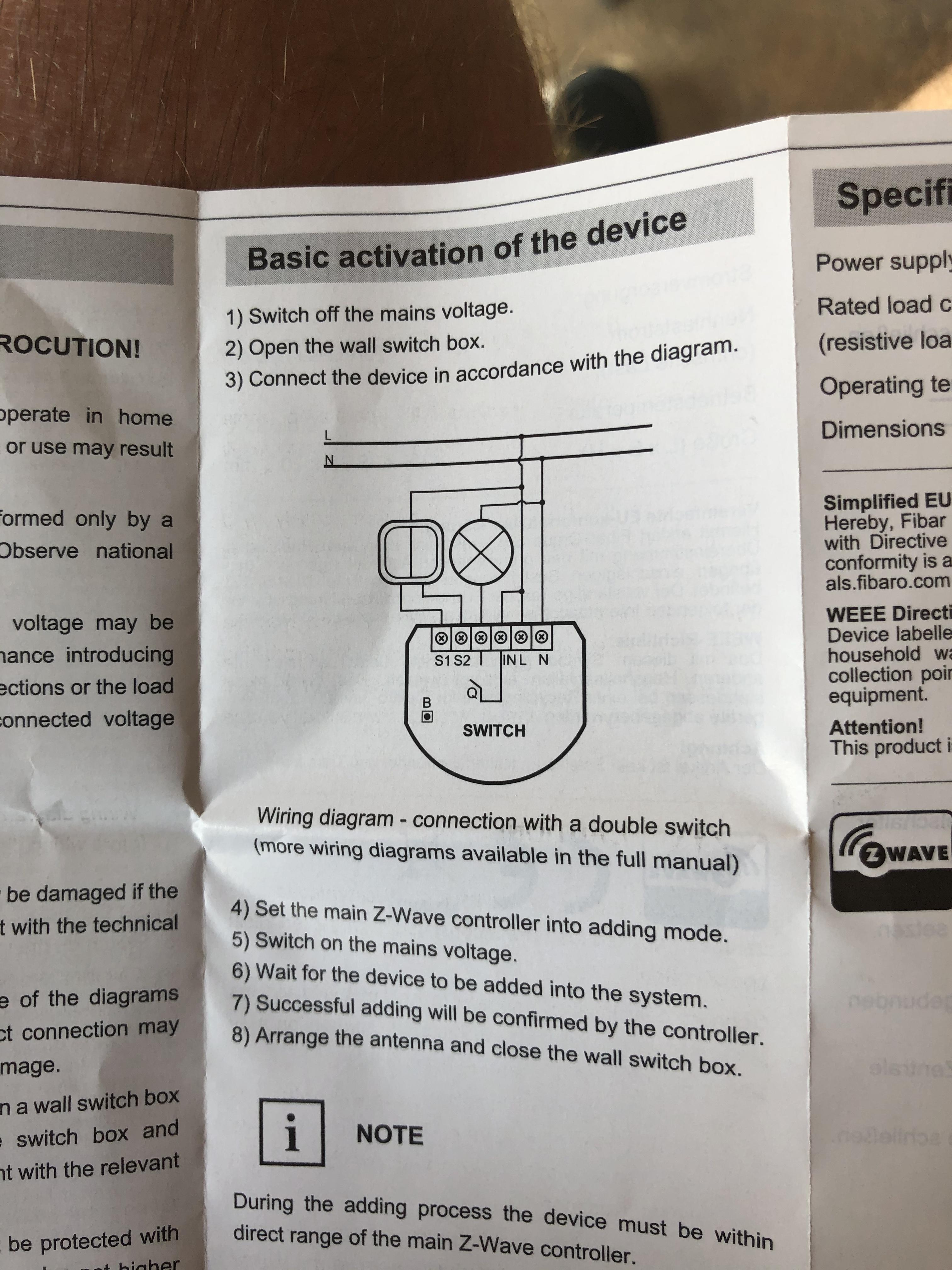

Fibaro switch wiring lack of knowledge!
@ProDave need your assistance again if you don’t mind .
I thought I should ask as this is 240v mains - I’d rather it was 12v
So !
I stick 240v L and N to it no probs
I want to close a dry contact I.e not stick 240v into the attached device !!! ( this is what worries me ! ) BANG ! ?
So , am I correct I put my 12v dc 2 wires on S1 and S2 ? . Simple as that ??
I’m not use to these tiny relays taking 240v - their size makes me think “wont it overheat ? “ or “where’s the big transformer ? “
no, you just leave the "IN" disconnected from L and then your dry contacts are "IN " and the next terminal.
S! and S2 are remote switches, 240V in as triggers.
Thanks
the next terminal is labelled on the unit as Q .
Online says Q is “output terminal of the load “
So dry contacts on in and q ?
Just double checking before I electrocute stuff ( would be much happier if they did a 12v dc powered relay ) .
Big thumbs up to @ProDave ( still awaiting those resistors to arrive ) and @dpmiller !!
Cheers guys ! Almost all the scary mains stuff working for now !

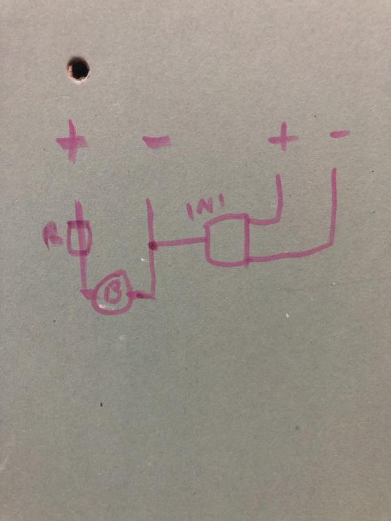

Not quite there !
Got the resistors . Put one on the + output 12v . Psu doesn’t short now .
So button push illuminated . When pressed not illuminated- all great .
The fibaro input sensor doesn’t change state though ( its always on ) . I put the in1 sensor on ground ( which runs to psu , button push switch ) . That’s correct isn’t it ??
The more I think about this the more I don’t think it will work how I want .
I *think* I need to alter the actual doorbell button .
It’s powered for its Led ; when pressed I assume makes an open circuit - which the sensor needs .
But then the sensor isn’t powered ?
Maybe ....
Back to 2 psu’s ? . One so sensor constantly powered . Then sensor in1 just gets connected to door button gnd .Other for door button so it can go ‘open’ on being pressed ?

I don't understand why it does not work.
Door bell not pressed, light is on, sensor input should read high or on.
Door bell button pressed, button shorts out LED, resistor in circuit now protects PSU from going into current limit and input should read low or off.
Put a multimeter between ground and sensor input.  What voltage does it read with the button not pressed?  what voltage does it read with the button pressed?
I think the meter readings suggest what you expect .
No button press 10.5v ish
pressed 0v
So the sensor is wired to 5v - the in1 binary is set on gnd .
Are all the gnds to the same gnd ? I.e all tied together . I know it’s a stupid question ?

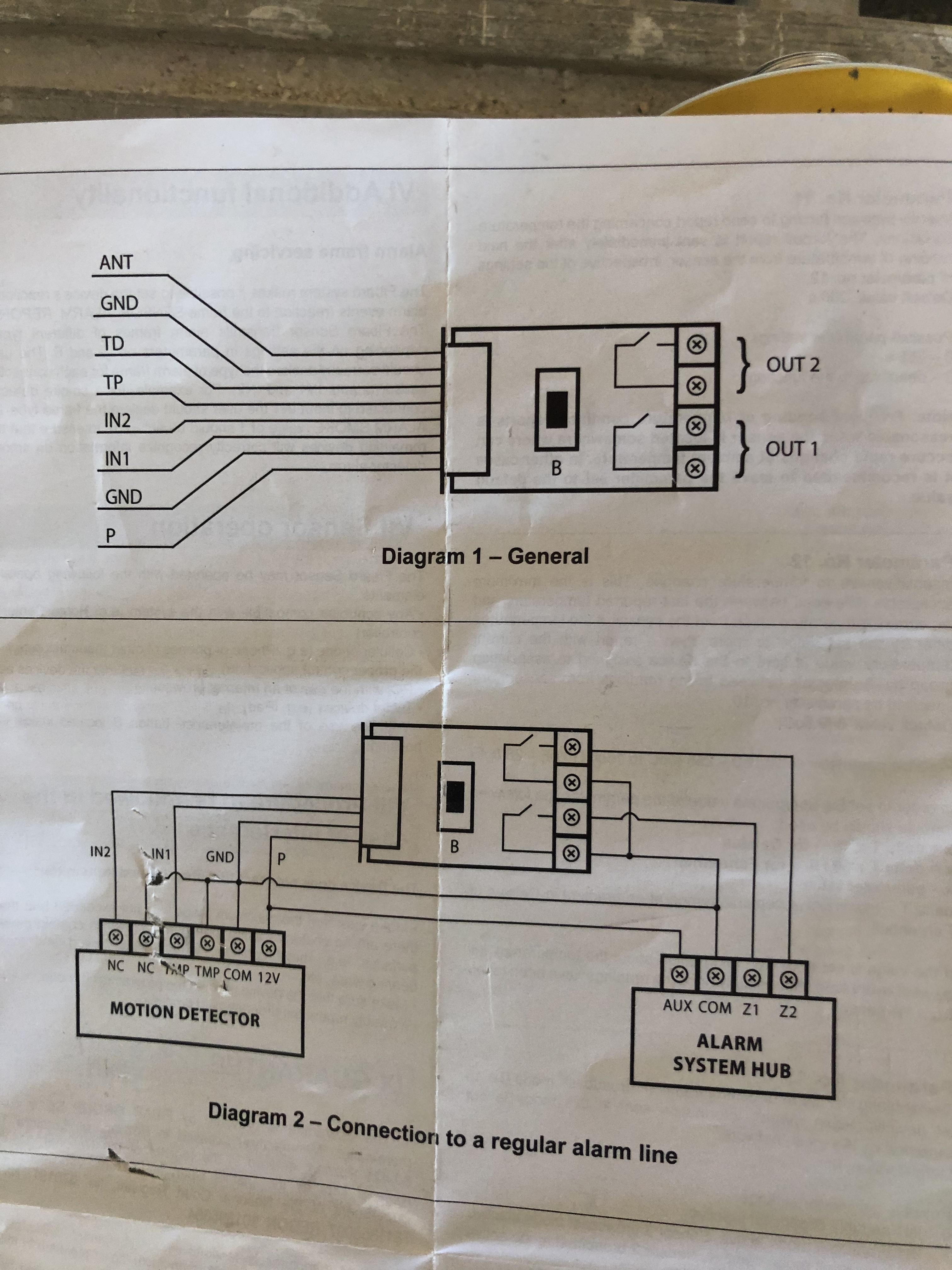

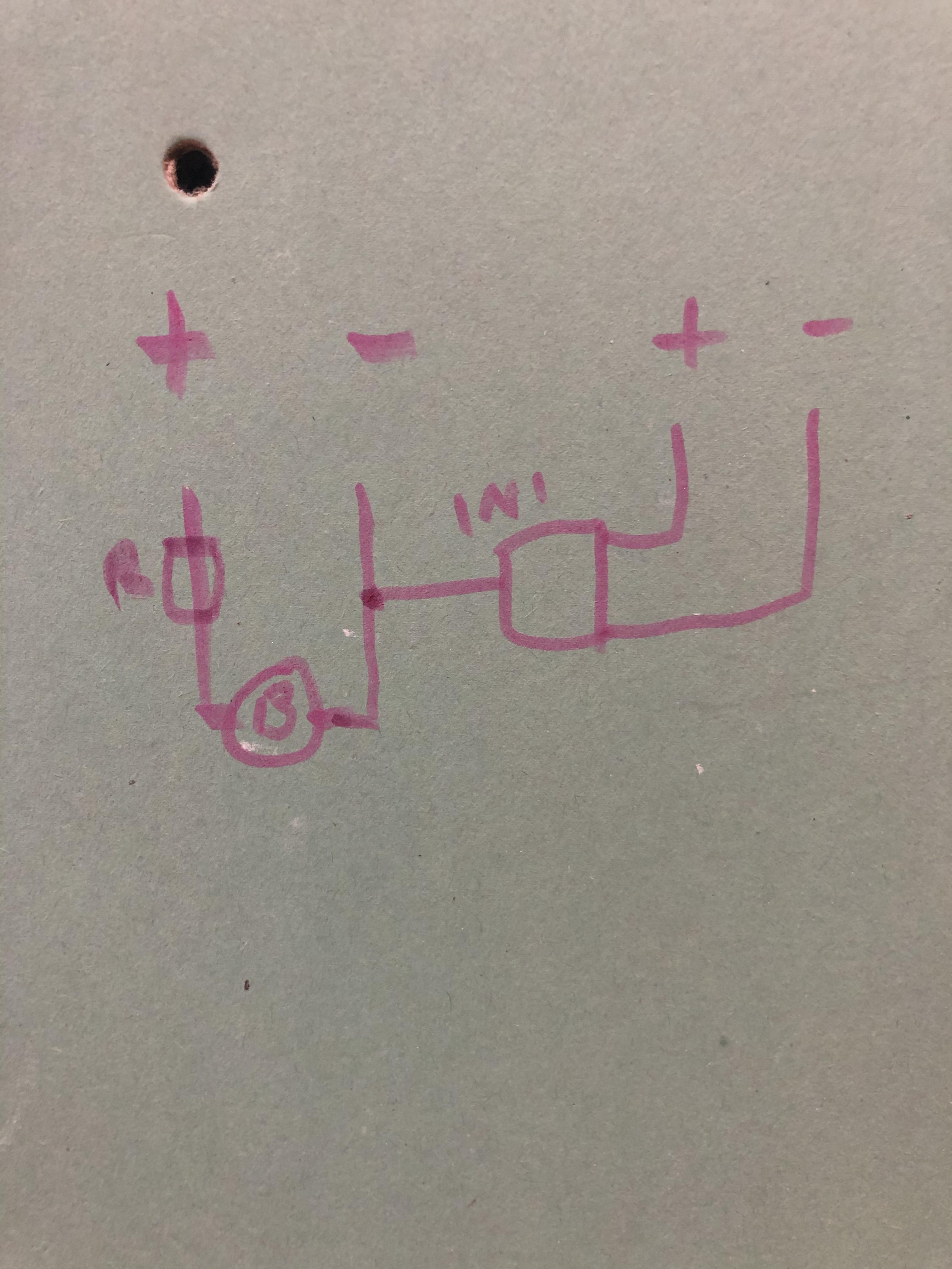

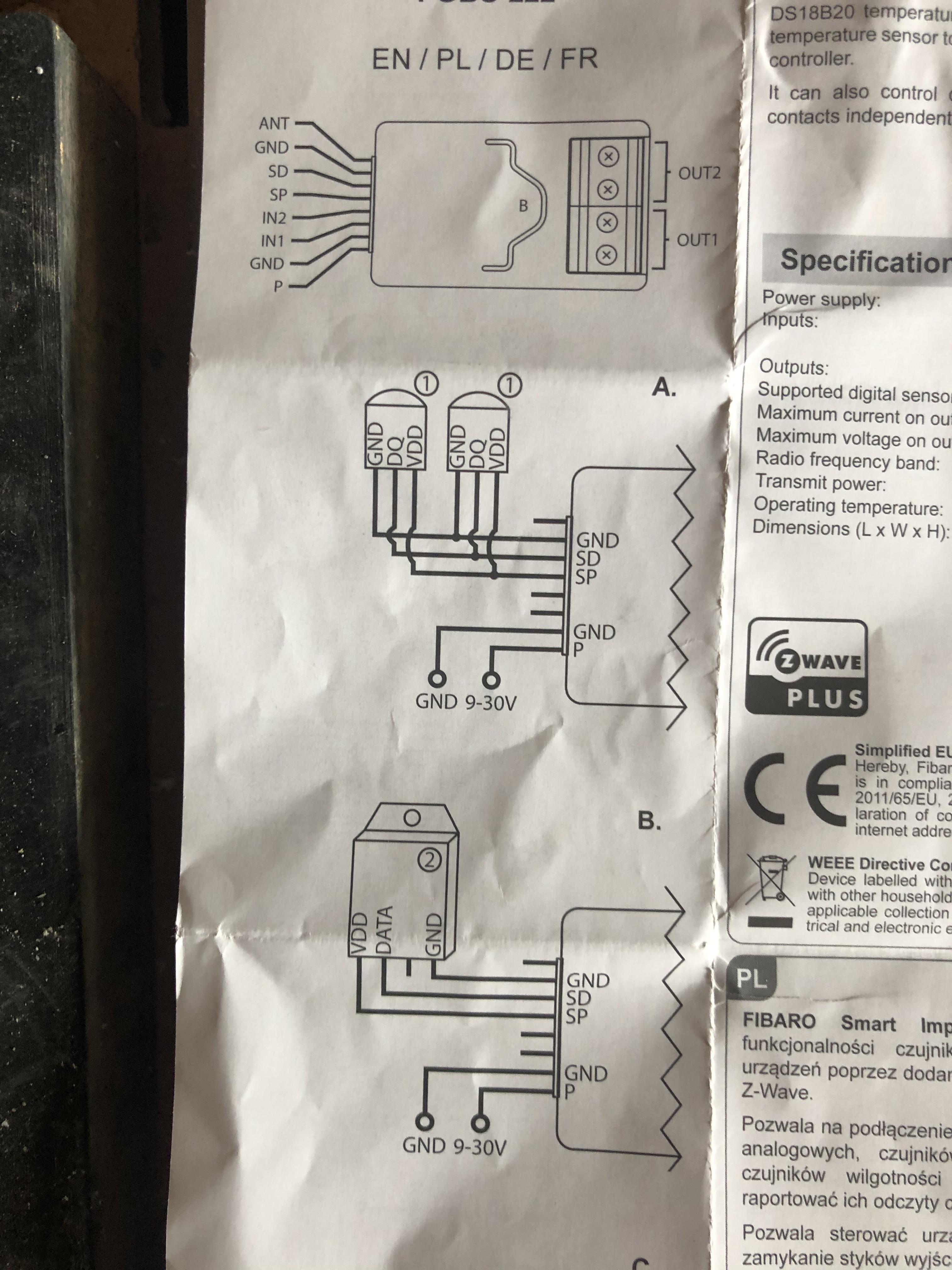

Sigh ! This kind of worked ( well not really ) . I relied on seeing the device powered up rather its status reporting . Anyway - busted that ...Got a fibaro implant .
Door bell is lit . Presume when button pushed a ‘state change’ would happen on its gnd . But in1 on sensor doesn’t change .
I power these separately because it confused me massively with 1 psu and it shorting out ( so implant isn’t powered )
R resistor ( presumably not required now as 2 psu’s ) ?
B lit button
Don’t understand what’s wrong here ???
Edited by pocster
