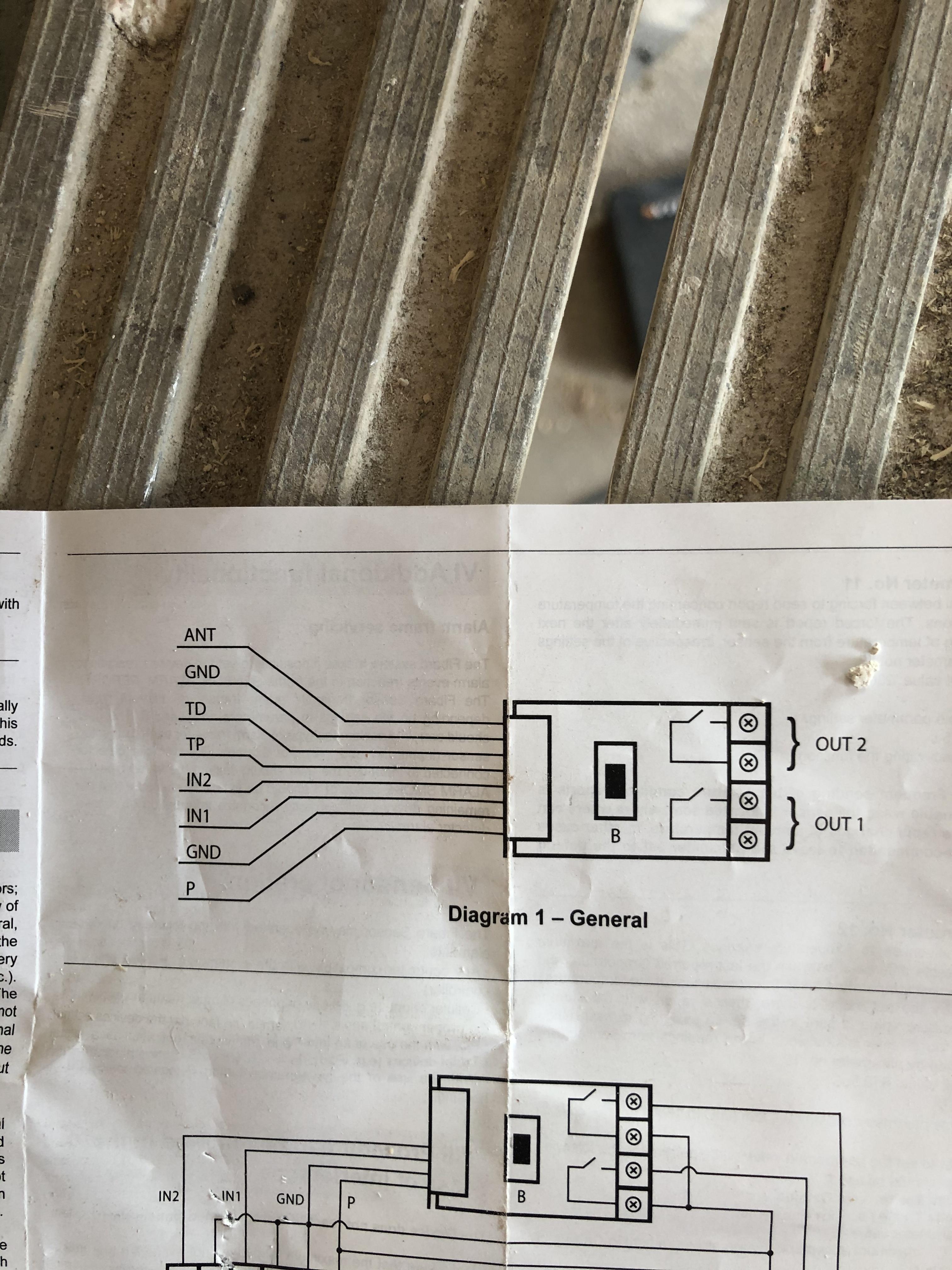

What I don’t understand is my button is meant to be powered to light it up .
How do I wire it so button is powered and lights up - but also only triggers a closed circuit ( no current ) for the fibaro sensor .
Might not be possible. Though they sell an ‘implant’ but I can’t see much difference between that and this universal sensor .
https://manuals.fibaro.com/binary-sensor/

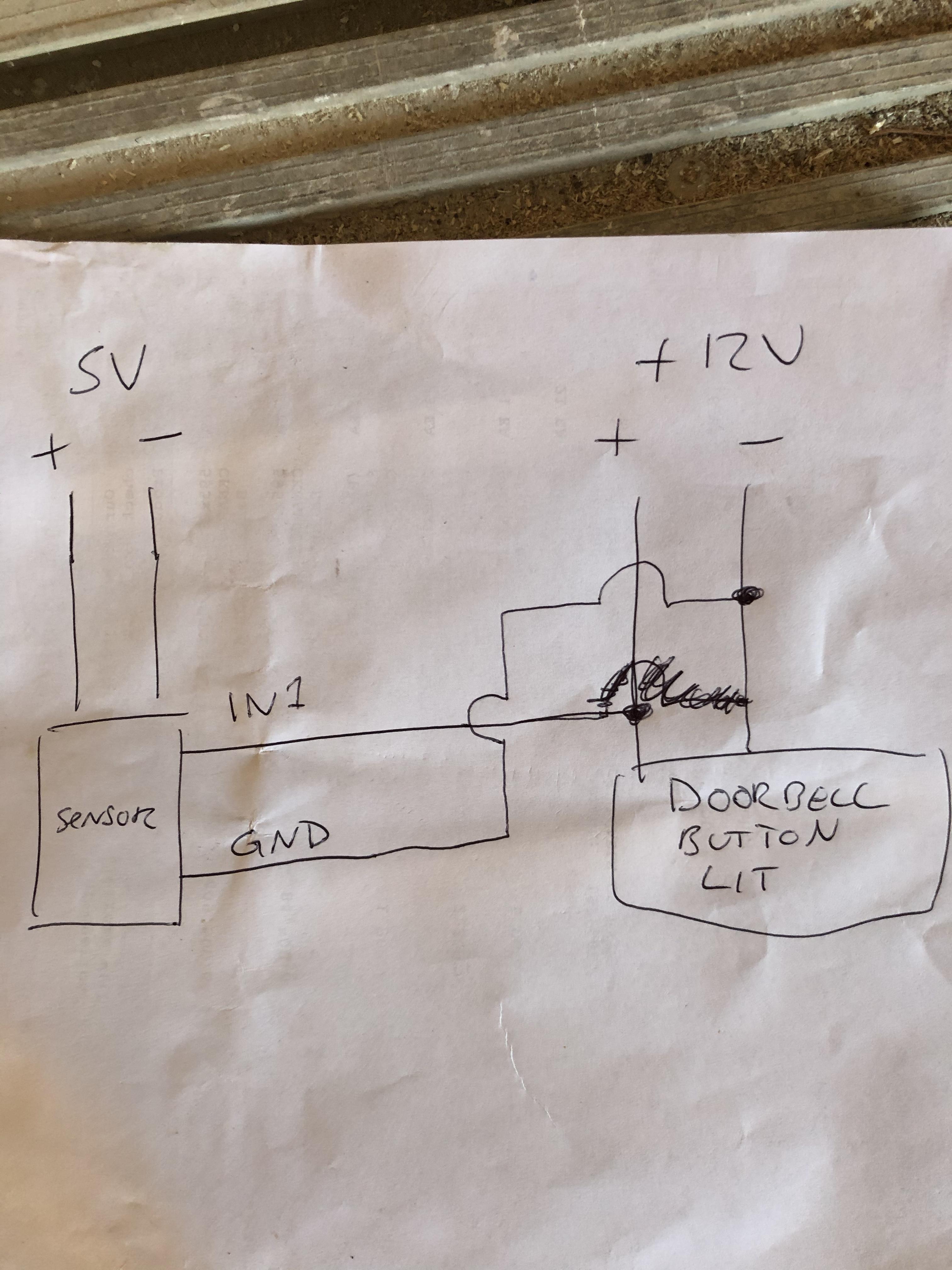

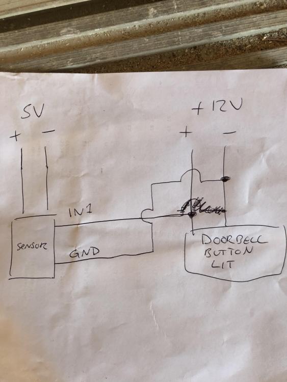

Right !
This is how I think I’ve got it wired !!
I don’t need 2 psu’s . The ‘doorbell’ is in one room ; where I’m fiddling with the sensor another ( long cable inbetween ! ) .
My ‘logic’ is ...
The sensors default state is ‘open’ ; so in1 has no current ( still don’t understand how it works internally ) .
So 12v is flowing to illuminate the door bell and not through the sensor (????)
When you press the door bell ; the 12v is now an open circuit the sensor becomes closed .
erm - I’m confusing myself ?
It works but I’m not confident I’m not sticking 12v into the sensor .
Ran it for a few hours it didn’t get hot ?
Edited by pocster

Moved it all into 1 room. Decided that *obviously* it could all run off 1 psu .
But it doesn't work!!!. Sensor power in is off the same psu that's the only difference ( both are rated at 12v 5A output). Sensor is recognised, but when the doorbell is pushed no 'changed' state occurs. Gone back to 2 psu's and it's ok. I just don't get it. Is it something to do with GND????
You need a resistor in series with the 12V power supply. At the moment when you push the button you short out the power supply. Never a good idea.  It probably has current limiting otherwise it would have already gone bang.  and anything else the power supply is feeding will lose it's power when the button is pressed.
And yes reversing youe meter probes will read -12V why do you think it would read 0?

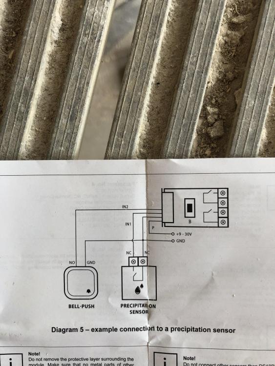

What is the maximum voltage input rating of the sensor?  Is that happy with 12V?  If not then I would be using a resistor and zener diode to limit it to 5V
EDIT you posted your last reply while I was typing.
Yes that explains my point, when the button is pressed you are shorting out the (in that example common single ) power supply so the sensor could not work.

Why do I think when it’s reversed it should read 0 ? Because I don’t understand ?
If it’s shorting out the psu then that explains why I need 2 ?
So it’s a fudged work around ! . Essentially as the psu has some short protection is the only thing making it ‘work’ .
Sensor max in voltage is 24dc I think .
So a resistor on the 12v + psu is all I need ? ( then I can run off 1 psu ? ) .
Erm , by what magic do I compute what resistor value I need ?? ??

3 hours ago, ProDave said:
1 watt @ 12V is about 80mA
Use about a 75 ohm 2 watt resistor in series with the +12V to the bell push.
Simple as that ? . Will stop me shorting the transformer ?
